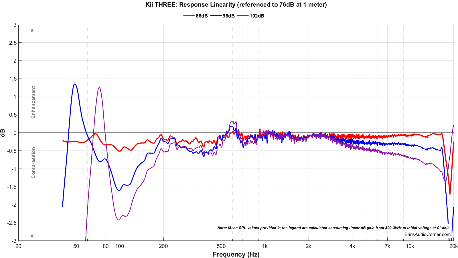

Satanica Posted August 19, 2023 Share Posted August 19, 2023 (edited) 51 minutes ago, sir sanders zingmore said: What about the Kii3+ BXTs in the classifieds? Thats a hellava lot of speaker and amps and DACs for the price. An excellent speaker, but somewhat output limited, especially for the price. The BXT will help the low end, but presumably not the high end. "Based on my results above, it is obvious the output is limited (via internal DSP) somewhere above the 96dB @ 1m output level." https://www.erinsaudiocorner.com/loudspeakers/kii_three/ Note: If anyone gets their feathers ruffled by this, remember I'm only the messenger. Edited August 19, 2023 by Satanica Link to comment Share on other sites More sharing options...
