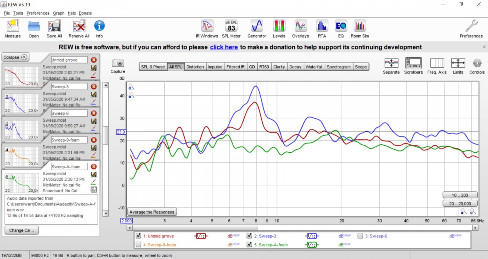

Warren Jones Posted July 9, 2020 Share Posted July 9, 2020 (edited) Here is my solution. My TT is heavy at about 20kg but you could put a lighter TT on a heavy block with springs underneath the block. 4 set of cheap eBay springs sitting under plywood. I set the springs so they are 50% compressed by removing individual springs. Measurement performed with LP spinning on an unmodulated groove. Sweep was done with REW through the speakers at a very high level, hearing protection needed. Here are the measurements. Blue trace is with springs bypassed, Red trace is with springs loaded at 50%, Green trace is with springs loaded 50% with a very small amount of soft foam just touching each spring to dampen resonance. Edited July 9, 2020 by Warren Jones 2 Link to comment Share on other sites More sharing options...
