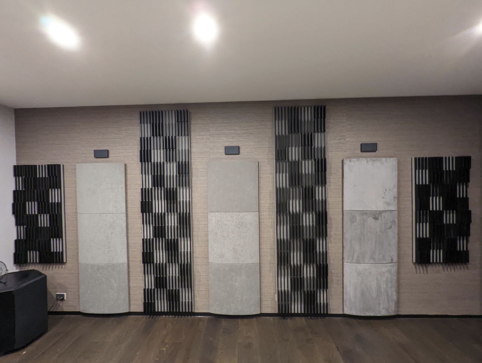

  • Totally garage job to get me started in the new room. Still an awful lot to do, but it's playing music. 11x6.5m room, seat is smack in the middle. Yep, it's so good already I want to cry.
  • Got my extra-wide generously padded soft 3 seater lounge suite and it's made a remarkable impact on the liveliness of the room. I think I should wait till I get the two single seaters that I'm also pu

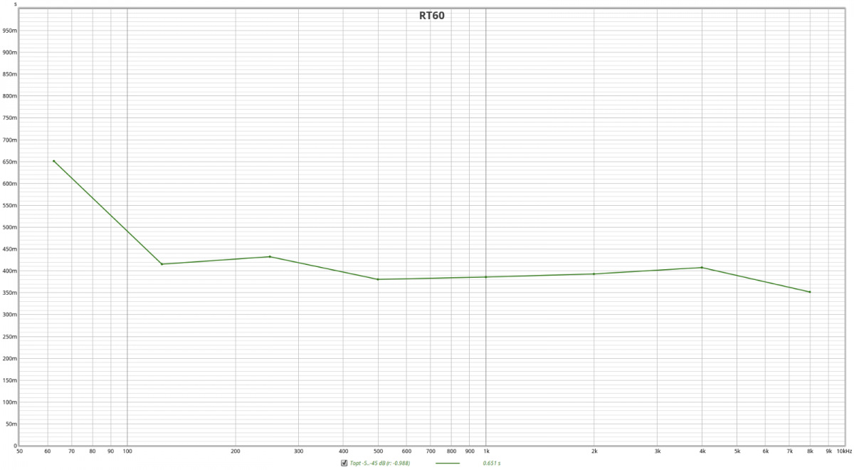

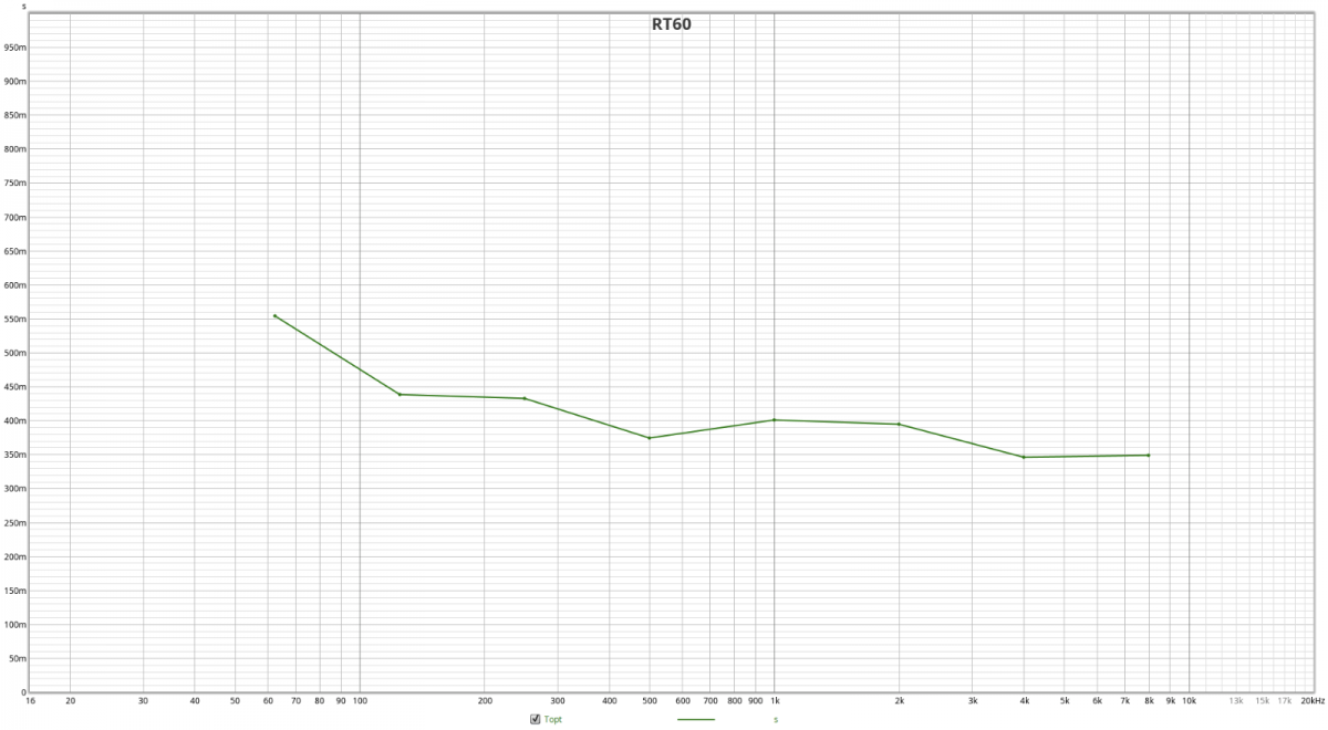

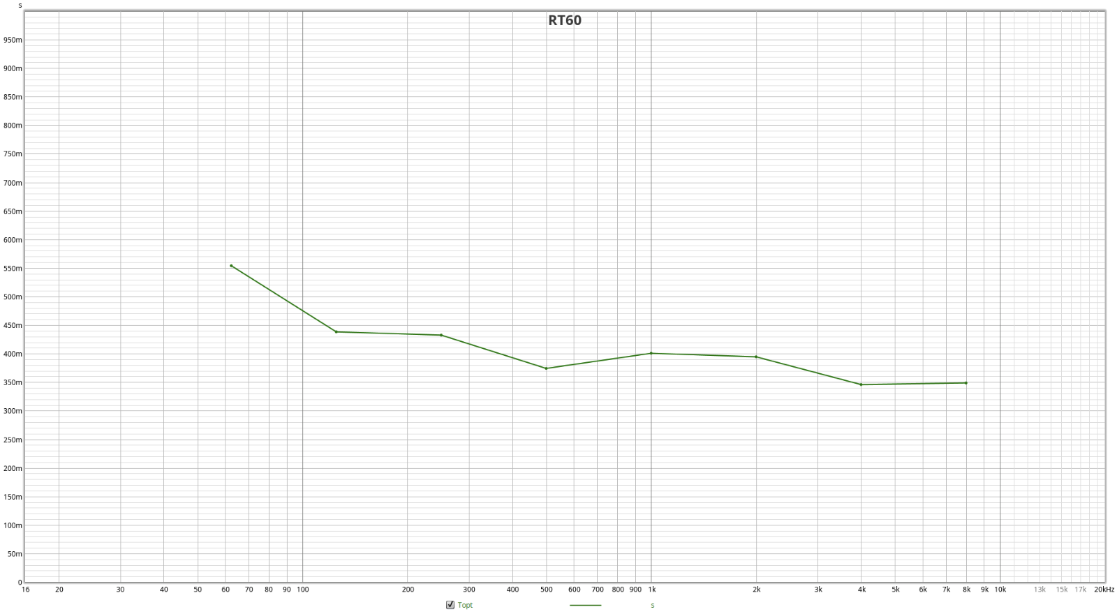

RT60 response with recalibrated DSP. Used to peak at 0.8s, rising between 200Hz and 8k

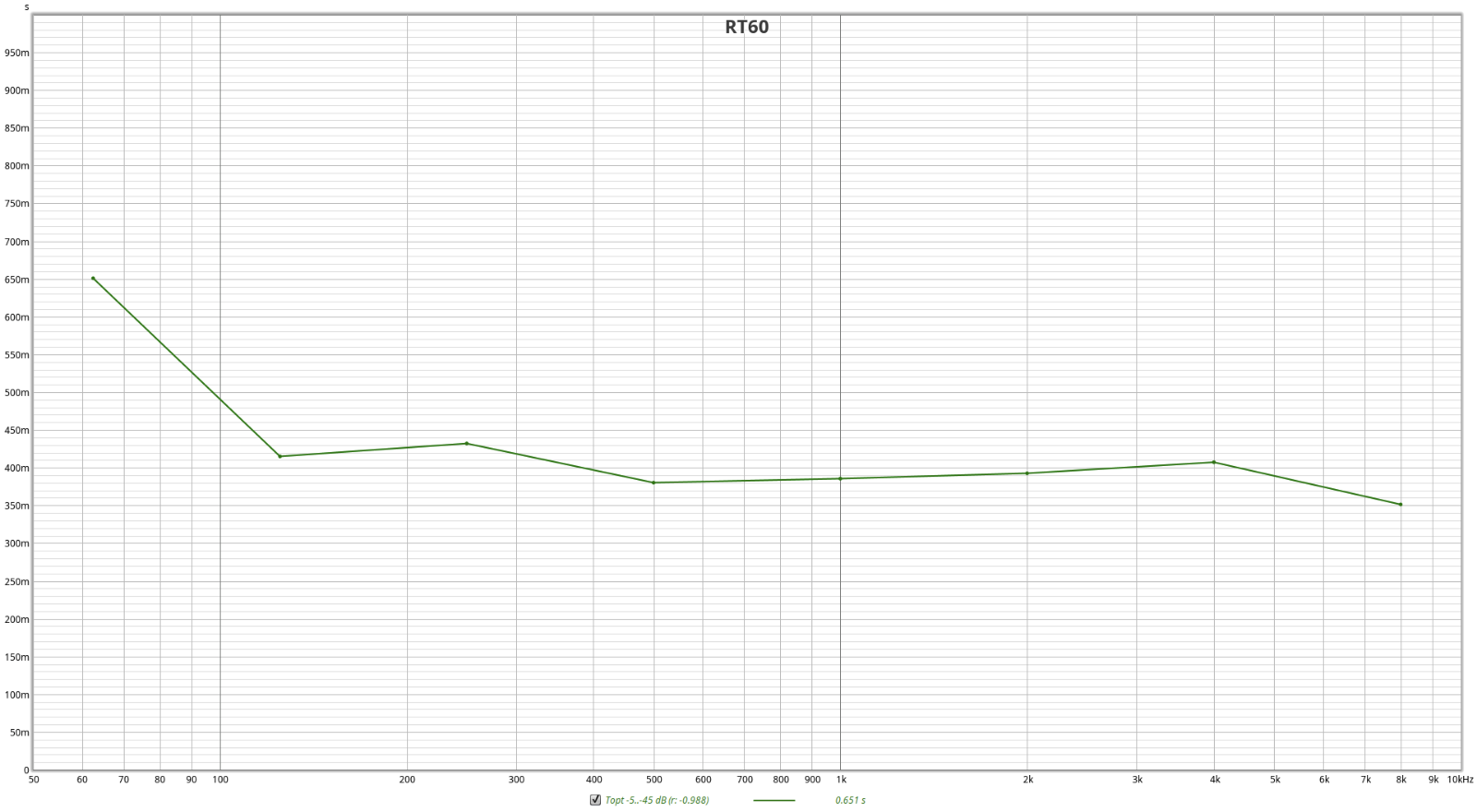

So I assume this is better than before, Con - as:
  • the maximum is much lower than 800ms
  • and it basically decreases to 350ms?
In comparison (the same 'Topt' graph) ... my graph has a totally different shape:
... so what does this say about my room?
Andy
  • Author
I can't say anything from that alone, as I'm no expert with RT60s,  but they're all low numbers so your room is not very echoic at all. Most pundits recommend about .4-.5 for listening rooms, and suggest a bit higher for larger rooms like mine. Mine is on the lower side now which doesn't worry me in the slightest. I can close the front wall cupboard doors if I want to make it a bit livelier. It's still too early to tell which way I prefer it but I can't fault it being better in every way so far. Still need to get my thoughts in order before I can describe the changes.

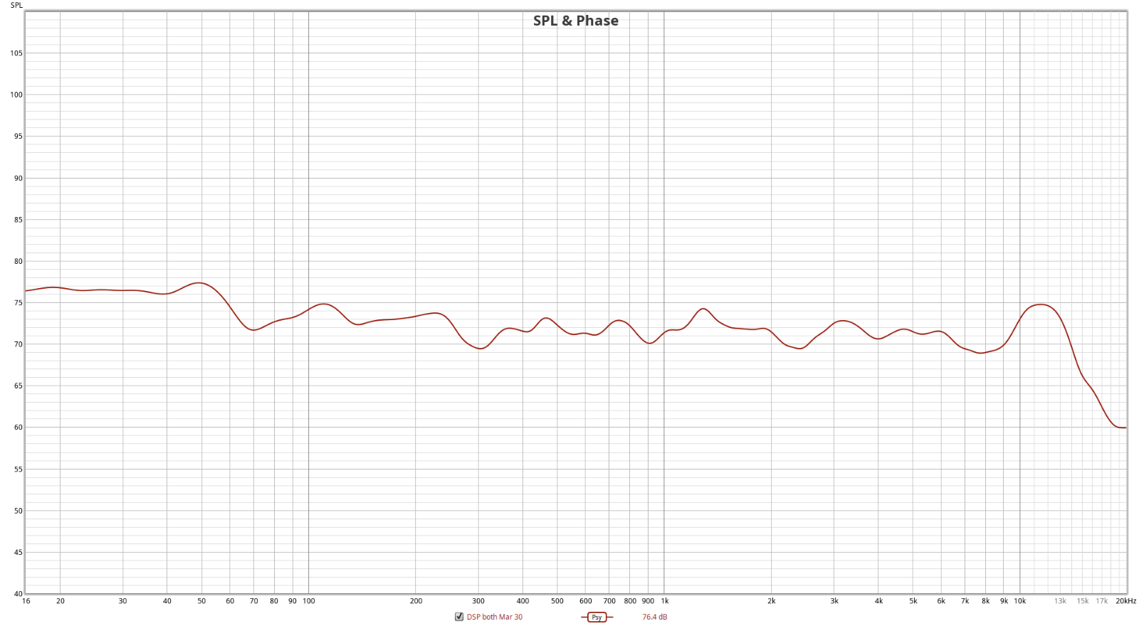

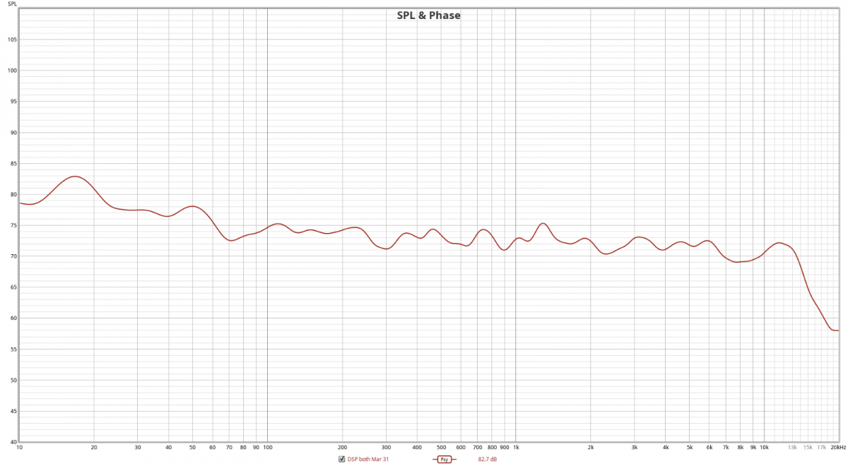

Just for reference, here's what my FR at the listening position looks like down to 16Hz. Bear in mind I optimise it around an average of 9 positions rather than just for the central position, but with more emphasis on getting the bass flat in the centre. The treble peak is intrinsic to the MBLs, as is the dip after that peak, even though they go up to 40k after that; I can't say I notice it, and the fact there's a little peak there probably offsets the fall after it.
Exceptional result, Con!  :thumb:
Andy
  • Author
Thanks! I may have a little crack at gently taming that treble peak just for completeness too.

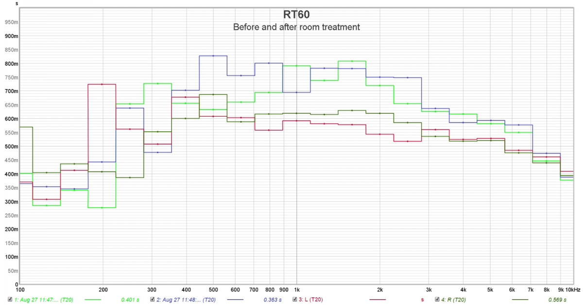

Here we go, tweaked "final" frequency response.

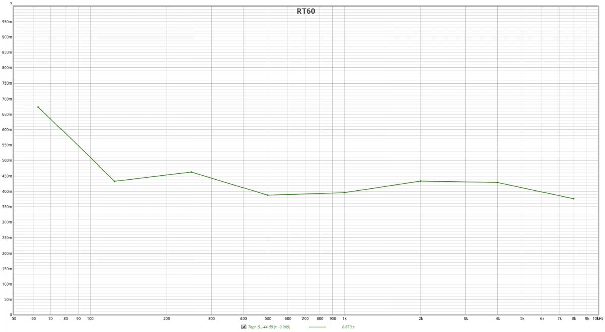

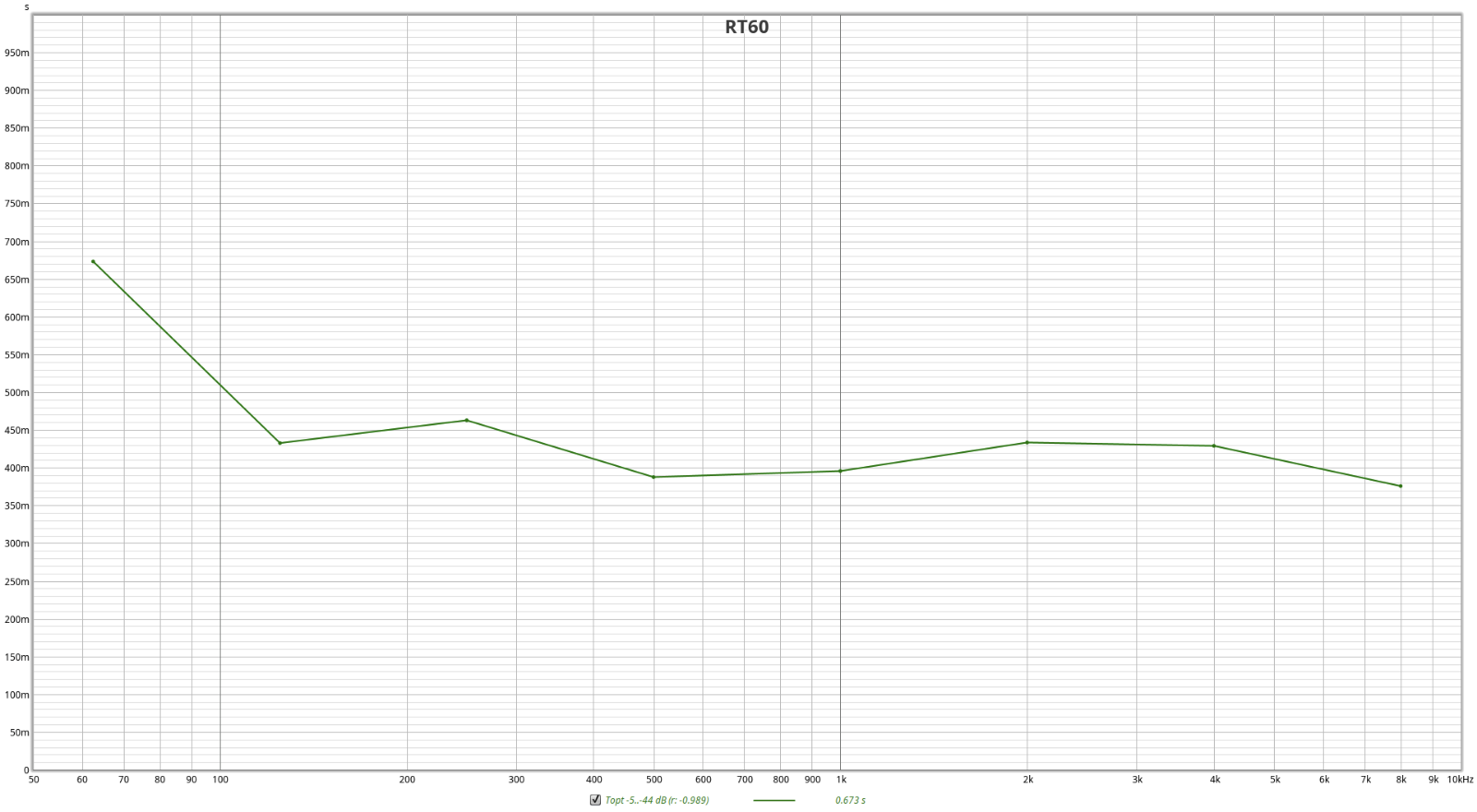

And RT60 with front doors open.
And with front doors closed, showing clear increase in the reflection/echo in some frequencies, though still quite low overall.
A quick listening comparison suggests I prefer the former, but it's splitting hairs.
Nice results @Ittaku. I'm more tempted to think about doing my ceiling right now after seeing this.
I've got a big reverberant space which I've treated a bit but I think I'd like to go a little harder on it. Try and get that circa 600msec down a bit.
It was crazy before, much better now.

13 minutes ago, Ittaku said:
Bass.
Indeed.   It's why there's a lot of disagreement around the best target, as it depends so much on speaker directivity and room size, etc.
Quote
RT60
Those RT60 numbers are great (very flat) ...  high or low, again depends on room and speaker directivity (and also taste) so there's no right answer and people should definitely not "copy", aside from that flatter (within +/- 25% or somesuch) is desirable.
BUT... the RT60 really tells very little in such a small room... and there are much better charts to look at.
For the low frequencies (eg. <300Hz), look at a waterfall (or decay, for a more simple representation).
For the rest, you are really interested in much shorter errors... and so you want to look at the ETC.

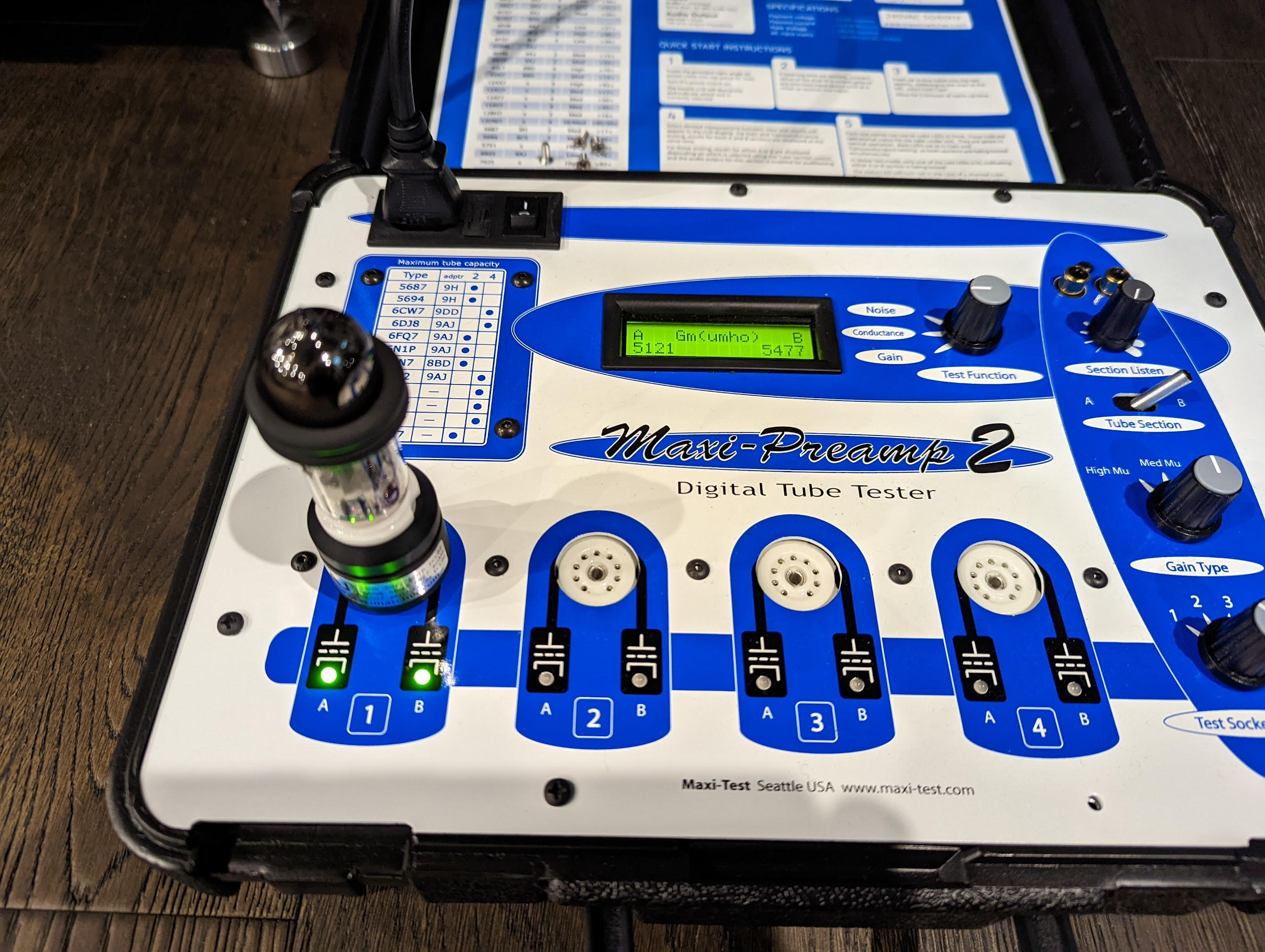

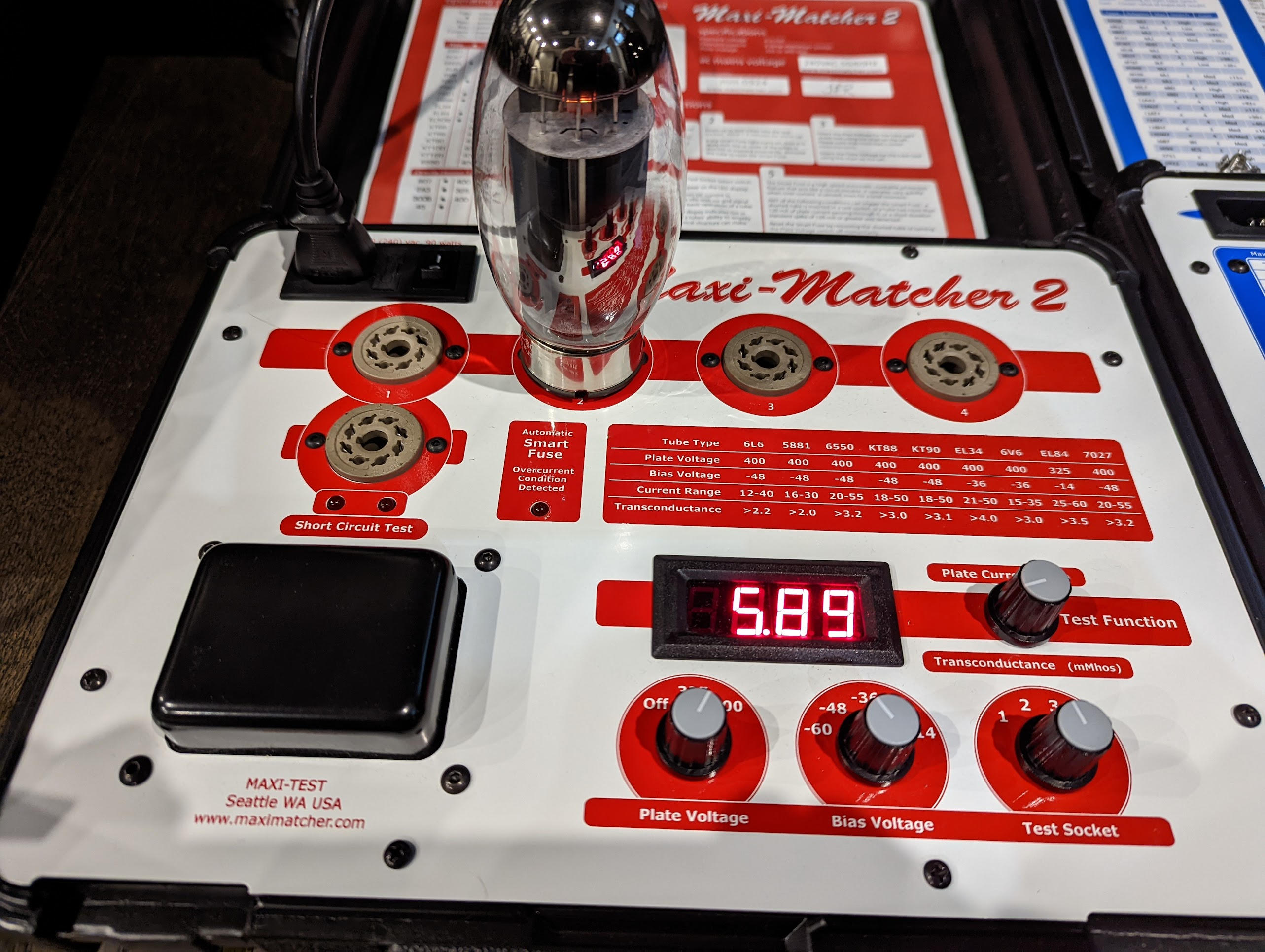

Valve testing time now that 2,000 hours is up.
Replaced one small signal regulator tube in the preamp and shuffled the power tubes in the power amp for better matching. No I can't hear the difference, but I've fixed a bias imbalance I couldn't correct previously.
PXL_20220829_233306503.thumb.jpg.ccc3e2c0e649c56df9ddccc6608efe80.jpgPXL_20220829_231415206.thumb.jpg.32b02ae2cf9c70be244ae1a79fb75968.jpg
yeah, regulators just burn and burn, sometimes at nearly full power, every moment they are switched on.  Not surprising they go first.
