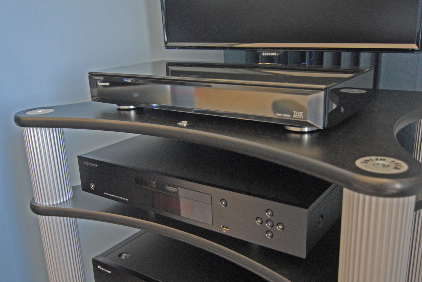

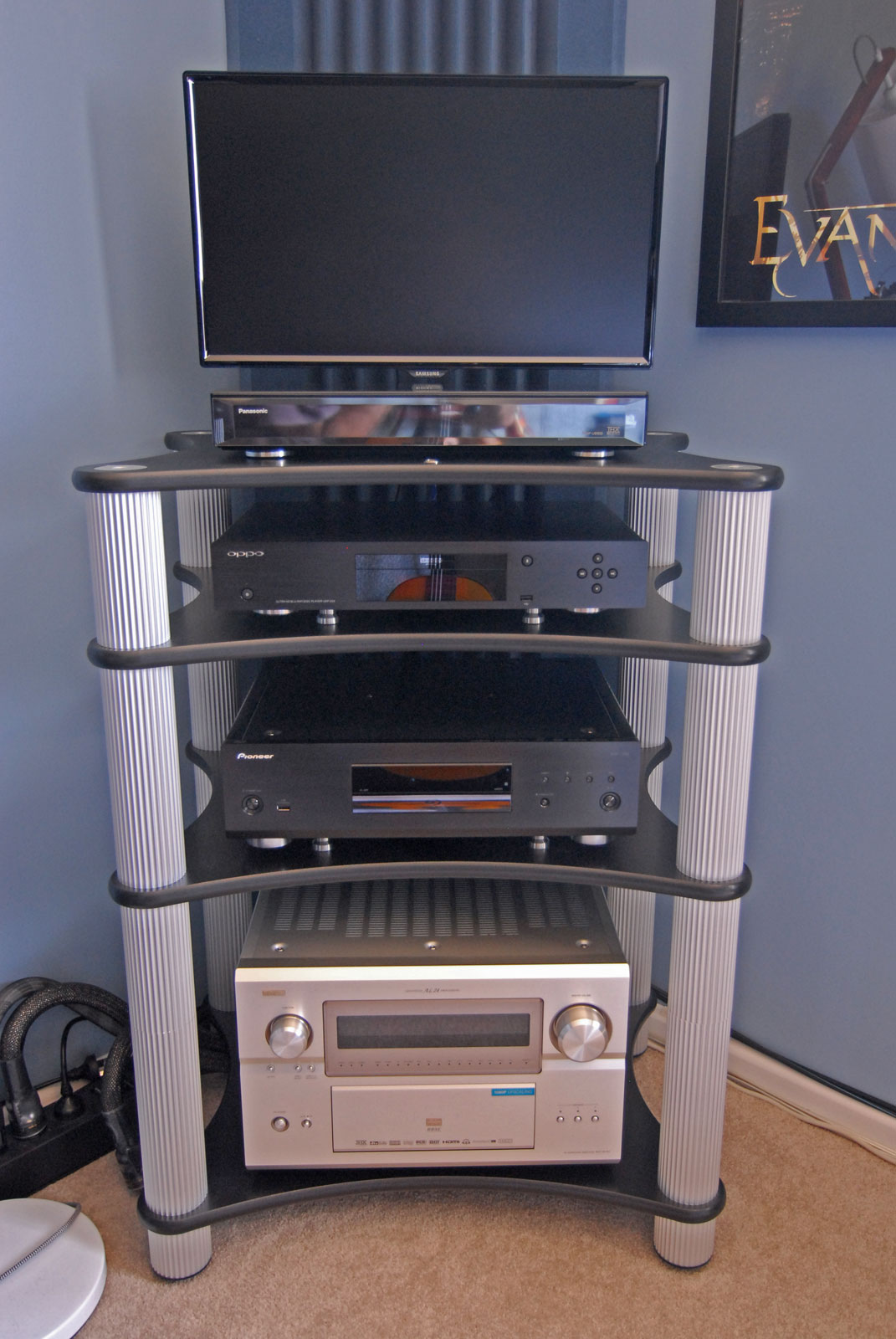

Having spent some days with the pana, and a month with the Oppo 203 time for some comparative thoughts,
Construction, Remote what comes in the box and initial impressions
the oppo comes in quite elaborate box, vs the much more compact panasonic which is packaged in a much more utilitarian manner. Both come with decent sized remotes and with ~2m 18gbps hdmi cables. The oppo cable is premium certified with the sticker to identify as such. not that cables at 2m really matters whether premium certified or not in my experience.
Some things blindingly obvious looking at the players... the Oppo is a very swish looking machine...full component width typical component depth. Nice solid case, stylish and polished looking piece of AV gear. Minimum of buttons. The styling overall I very much like vs the older 103. The pana... my god it is a tiny thing ! :D quite short in component depth but atleast component width, quite low profile. Very much a box mover style disc player but to be fair it is much better built than most of those. They are sure trying wiht a nice shiny top, metal case, with just one bit of useless form over function bling in the plastic crystal look front flap ..couldnt help them selves I guess !  anyways it does look better in the rack vs the sammy uhd player which was a bit more of a challenge with its curvy front and quite low profile case !
The remote on the pana is very nice... nice its back lit and the buttons have a positive feel to them.... using it ....I do miss the motion sensitive remote of the oppo though .... the oppo remote does seem cheaper and more generic by comparison though. these things do matter... in a projector setup and a dark room you want to quickly press a button on the oppo can do that ...on the pana have to hit the light button bottom left hand corner ... having used an oppo for a month...funny the things you get used to...
Getting going and basic settings
On first boot up of the panasonic...hey I could see a main menu ! and this straight through my marantz av8802a processor and through to either my jvc x7000 projector or pioneer kuro krp-500M. I noticed straight off the main menu on the  panasonic was in 1080p50 res which is such a much better idea than oppo with their menu using max hdmi bandwidth that most people are going to struggle with existing hdmi cables and those longer than 7m. As some might know currently no premium certified hdmi cables exist over 7m to guarantee most will see the main menu with the oppo, but with the pana no one will have any issue with the menu. So out of box even switching on people are going to find things working with the pana but many I suspect will get caught out with the oppo and find they have to work around this crazy need of oppo to push a menu through at max hdmi bandwidth.
The first evening I spent with the Pana...I mainly just spent setting things up/basic calibration and a few test discs and such. I tend to like to do this with a new player to make sure things are right.
