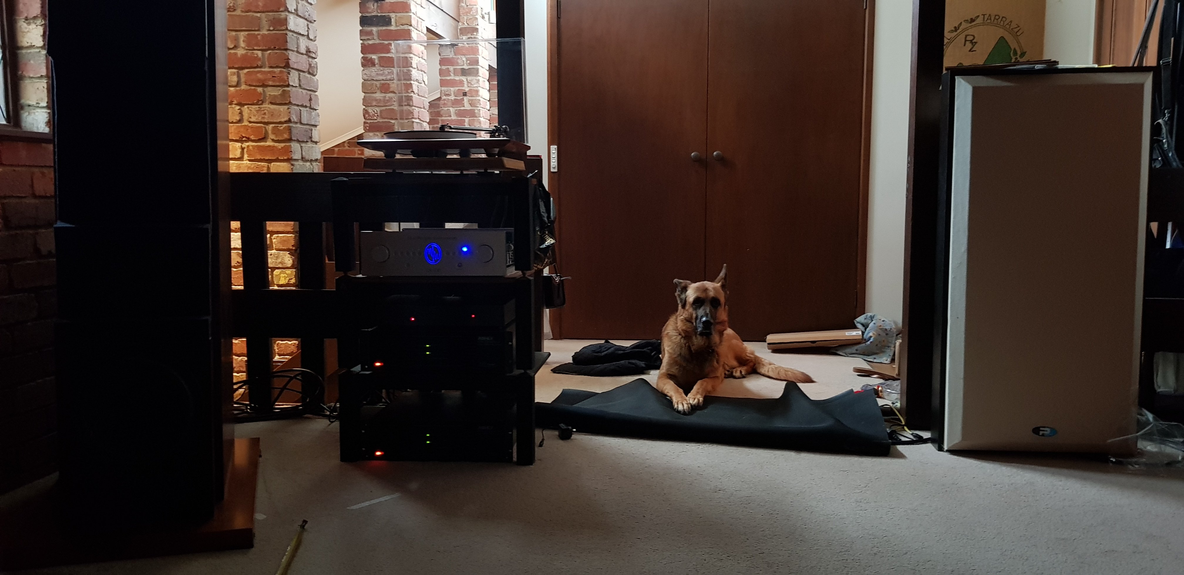

Guest Muon N' Posted October 18, 2019 Share Posted October 18, 2019 On 07/10/2019 at 6:14 PM, Tubularbells said: This was my second of what I originally thought were my only two options. Dismissed it on Sat. as I felt I'd already put you all through enough already and the old JBL possie was sounding mighty fine. This though I feel might be even better. Certainly much more space around the speaker and listener. Also bridged the amps which seem to yield an improvement. 1450w into 4 ohms now according to the spec sheet but I thought the bass would bloat due to the damping factor halving but for some reason bass sounds tighter now. New speakers look great, but couldn't help noticing the lovely Shepherd! I used to sometimes feed and water some guard dogs years ago as some were often kept where I lived, mostly Shepherds. Link to comment Share on other sites More sharing options...
Martykt Posted October 19, 2019 Share Posted October 19, 2019 On 18/10/2019 at 8:13 PM, Muon N' said: New speakers look great, but couldn't help noticing the lovely Shepherd! I used to sometimes feed and water some guard dogs years ago as some were often kept where I lived, mostly Shepherds. Careful Red... Panzer is a vicious killer.... 1 Link to comment Share on other sites More sharing options...

tubularbells Posted October 21, 2019 Author Share Posted October 21, 2019 23 hours ago, kelossus said: How's it getting on in the room now after a few weeks of ownership? Do you feel they are too large for the room? I am considering a pair of Sovereigns now and our rooms are the same size albeit mine has a rather high raked ceiling. I am all about excess and getting away with the largest speaker possible...They just sound better. To be absolutely honest....im struggling. Put on a few albums yesterday and had disappointment after disappointment (particularly Underworlds - Barbara Barbara) where the 50hz peak was obnoxiously present. Decided no more tunes in the church until the rooms has been sorted so am listening to the downstairs HT system So I don't end up throwing a speaker into hell's abyss! I managed to tame the JBL's to some degree in the same position however the Duntech's will have none of it!!! Link to comment Share on other sites More sharing options...
betty boop Posted October 21, 2019 Share Posted October 21, 2019 14 minutes ago, Tubularbells said: To be absolutely honest....im struggling. Put on a few albums yesterday and had disappointment after disappointment (particularly Underworlds - Barbara Barbara) where the 50hz peak was obnoxiously present. Decided no more tunes in the church until the rooms has been sorted so am listening to the downstairs HT system So I don't end up throwing a speaker into hell's abyss! I managed to tame the JBL's to some degree in the same position however the Duntech's will have none of it!!! Gosh this is heartbreaking to hear ! I hope there is a rapid resolve !!!! 1 Link to comment Share on other sites More sharing options...
Peter_F Posted October 21, 2019 Share Posted October 21, 2019 1 hour ago, Tubularbells said: To be absolutely honest....im struggling. Put on a few albums yesterday and had disappointment after disappointment (particularly Underworlds - Barbara Barbara) where the 50hz peak was obnoxiously present. Decided no more tunes in the church until the rooms has been sorted so am listening to the downstairs HT system So I don't end up throwing a speaker into hell's abyss! I managed to tame the JBL's to some degree in the same position however the Duntech's will have none of it!!! Bugger! The Sovereigns can be an acoustic disaster if the room and amplification aren't matched. I see you're using ME amps, what power output are they? Link to comment Share on other sites More sharing options...
Guest jakeyb77 Posted October 21, 2019 Share Posted October 21, 2019 5 minutes ago, Peter_F said: Bugger! The Sovereigns can be an acoustic disaster if the room and amplification aren't matched. I see you're using ME amps, what power output are they? Over 300W at 8 ohms Link to comment Share on other sites More sharing options...
Peter_F Posted October 21, 2019 Share Posted October 21, 2019 1 minute ago, jakeyb77 said: Over 300W at 8 ohms I've heard 3 x systems with Sovereigns and all were using amps 500 + WPC @ 8 ohms. I've heard Gale 401's perform their very best on 500 WPC amps as it completely changed the presence and dynamics of the sound. Considering the enormous Sovereigns, it would be very productive if the OP could borrow something almost double the output he's presently using to help identify power and/or room issues. From this side of the country and not having heard the system, my first consideration with Sovereigns is amplification. Link to comment Share on other sites More sharing options...

metal beat Posted October 21, 2019 Share Posted October 21, 2019 (edited) If you want to keep the speakers, imo you have two choices as no amplifier is going to fix humps and nulls in the bass region. You will only piss $$ up against the wall and create heartbreak. I have been there. Large full range speakers are very hard to get right when the room ain't helping. eq or new room. What is the issue with the sound that is the biggest problem in listening long term?. Is there too much bass creating a muddy boomy sound or does the null create something that is lean/bright lack of tone and presence. the good news is your preamp has a tape monitor loop, so you can get a Deqx have it calibrated and eq'd to what you prefer in the bass. You can insert it into the music when you want and remove it by turning off the tape loop on the remote - best of both worlds as it does not have to be always in the system. It's not perfect but it does work better than any passive bass traps etc as you just cannot get low enough with enough of them. Edited October 21, 2019 by metal beat 6 Link to comment Share on other sites More sharing options...
evil c Posted October 21, 2019 Share Posted October 21, 2019 (edited) 3 hours ago, Tubularbells said: To be absolutely honest....im struggling. Put on a few albums yesterday and had disappointment after disappointment (particularly Underworlds - Barbara Barbara) where the 50hz peak was obnoxiously present. Decided no more tunes in the church until the rooms has been sorted so am listening to the downstairs HT system So I don't end up throwing a speaker into hell's abyss! I managed to tame the JBL's to some degree in the same position however the Duntech's will have none of it!!! Hmmm buyers remorse with a twist! When I heard the Sovereigns after setup on first day oriented along the fireplace side, was highly impressed with the result so quickly. Just way too fussy for your own good Doug, Took me months till I was entirely happy with the Hulgichs, don't lose hope or your temper so fast! I'll bring over my pre and Bryston for a session, wouldn't hurt surely. Need more snags anyway! If that doesn't work , sell them - you probably are suffering from over active, grass is greener mindset syndrome! Edited October 21, 2019 by evil c 4 Link to comment Share on other sites More sharing options...

joz Posted October 21, 2019 Share Posted October 21, 2019 Doug. At my place I suggested that it was most likely an eq issue rather than an amp. Need something to absorb/ pull down the peak. 1 Link to comment Share on other sites More sharing options...
