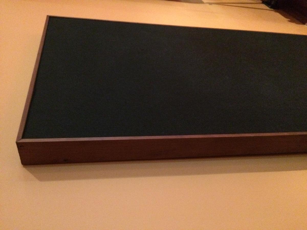

I have had my 50mm sheets leaning up against 3 walls for nearly a year and even casually placed like this they made a fantastic improvement to sound.
I was fortunate enough to place an order at the right time as they had some spare sheets lying around, any attempted correspondence since then fell on deaf ears so I left it at that. (was thinking about some white for ceiling)
I have just recently placed them in MDF frames, covered them in fabric and hung them properly and this is definitely an improvement visually and something that I should have done ages ago.
Not content with that I am now making Jarrah surrounds for these panels as well.
Initially it was about covering up a window but I am glad that I bought the extra sheets as they have come in very handy, even with the few left over I can now double up thickness into the rear of these panels.
It may be a P.I.T.A to get them but I believe it is worth the perseverance. :thumb: .

just for interests sake here a pics of how I framed my 1200 x 600 panels (which I cut from 2400 x 1200 sheets), I used wrc 65 x 8mm & the corner blocks (on back) are 14mm thick wrc.  I just screwed all the joints and stained the timber to match my skirtings/architrves, a very amateur diy but looks OK.
