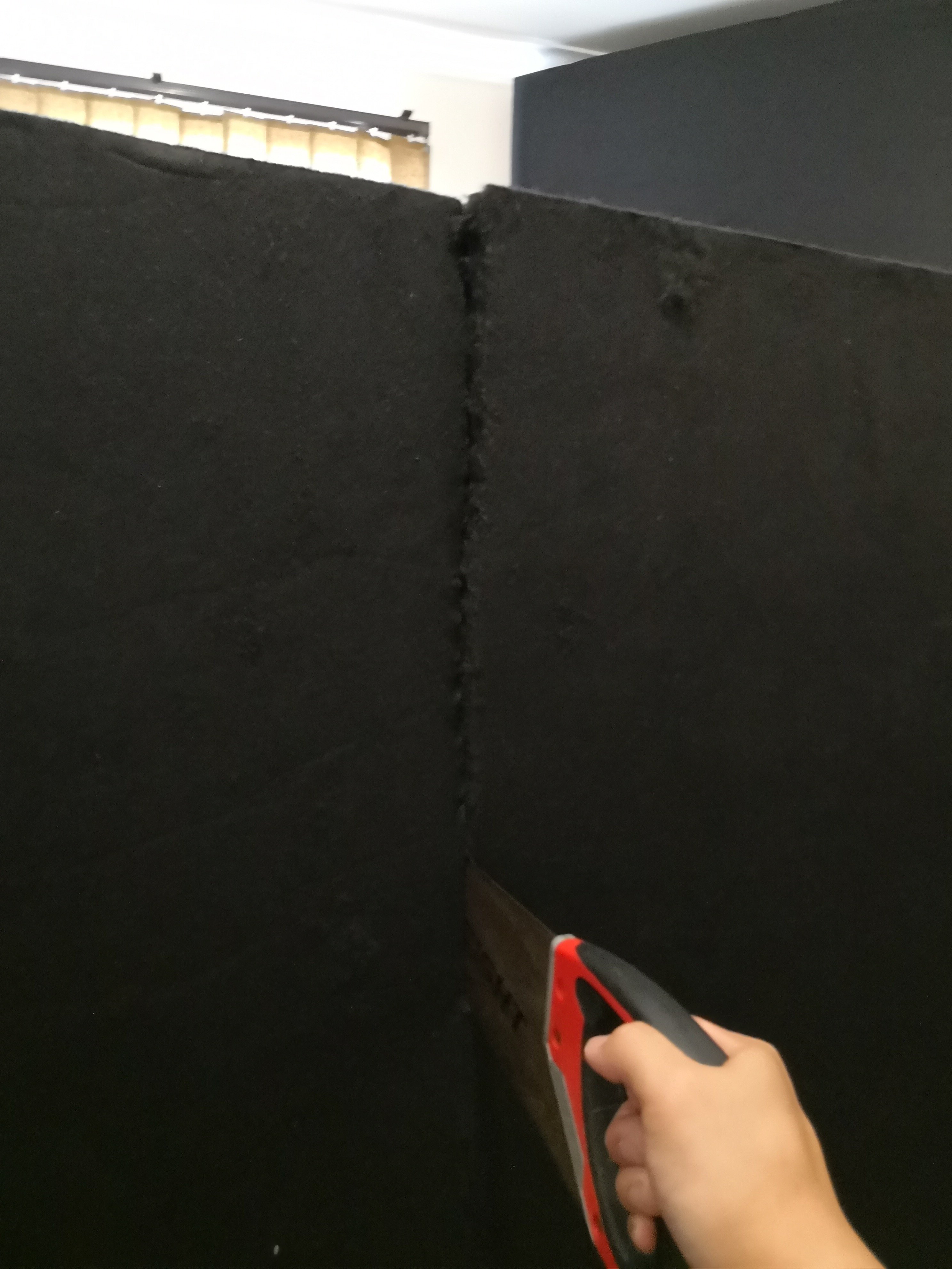

Gradenko Posted August 5, 2018 Share Posted August 5, 2018 (edited) So quick update, tried this insulation reciprocating saw blade on my Milwaukee M12 Hackzall: http://www.suttontools.com/products/specialty-reciprocating-blades-insulation-ultra-h534/ And it didn't do sh*t. Even with the piece clamped on one side and me holding the other, I still had to physically saw to get it to cut. Maybe with a reciprocating saw with more travel it would work. I then gave the circular saw a go with the wood blade. This worked, except the off cuts blocked up the guard and there was polyester flying everywhere. After that we looked at angle grinder blades for the circular saw, as bjc suggested. This would work great, except for my application I needed the sides smooth and not melted so the absorption qualities wouldn't change. Toolmart recommended a hand held insulation saw for $45. I wasn't keen but tried it anyway. By gosh, this thing is sweet. Weighs nothing and cuts through it like butter. Highly recommended for when you need clean edges that aren't glazed. Edited August 5, 2018 by Gradenko 3 Link to comment Share on other sites More sharing options...

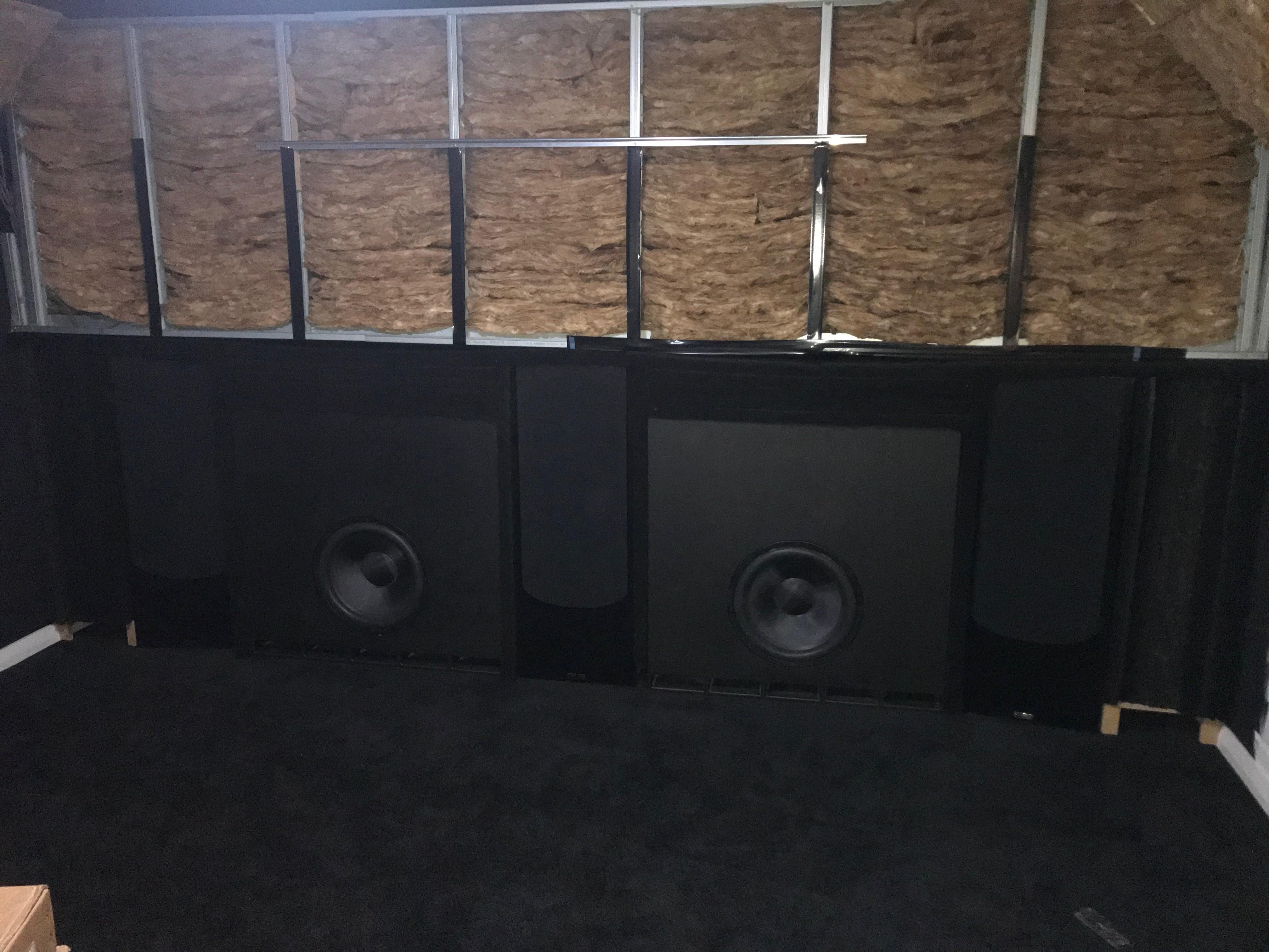

Gradenko Posted August 5, 2018 Share Posted August 5, 2018 And this is the finished product. I've filled in all the gaps between the speakers and themselves and the walls. This should solve my SBIR and 100Hz suck out issues. The insulation above the speakers is a bass trap which was there previously. 7 Link to comment Share on other sites More sharing options...

jamiebosco Posted August 6, 2018 Share Posted August 6, 2018 (edited) On 6/08/2018 at 12:21 AM, Gradenko said: And this is the finished product. I've filled in all the gaps between the speakers and themselves and the walls. This should solve my SBIR and 100Hz suck out issues. The insulation above the speakers is a bass trap which was there previously. Agree with @bjc - very nicely done! Do you have a build/showcase thread on here? Any info on what speakers/subs are in the pic ? I put 2.4m x 1.2m x 20cm of black QuietStuff polyester insulation (Autex equivalent of Polymax) behind my speakers and subs to help with SBIR as well, worked very well Edited August 6, 2018 by jamiebosco Link to comment Share on other sites More sharing options...
Gradenko Posted August 7, 2018 Share Posted August 7, 2018 48 minutes ago, jamiebosco said: Do you have a build/showcase thread on here? Any info on what speakers/subs are in the pic ? Mains are Ascension C1503DAMTL (Adelaide Speakers high-power speakers). Sub drivers are Mach5 UXL-18's. No build thread for the room but have a build thread for the subs over here: https://www.avsforum.com/forum/155-diy-speakers-subs/2923958-grad-sub-ported-uxl-18-a.html Link to comment Share on other sites More sharing options...

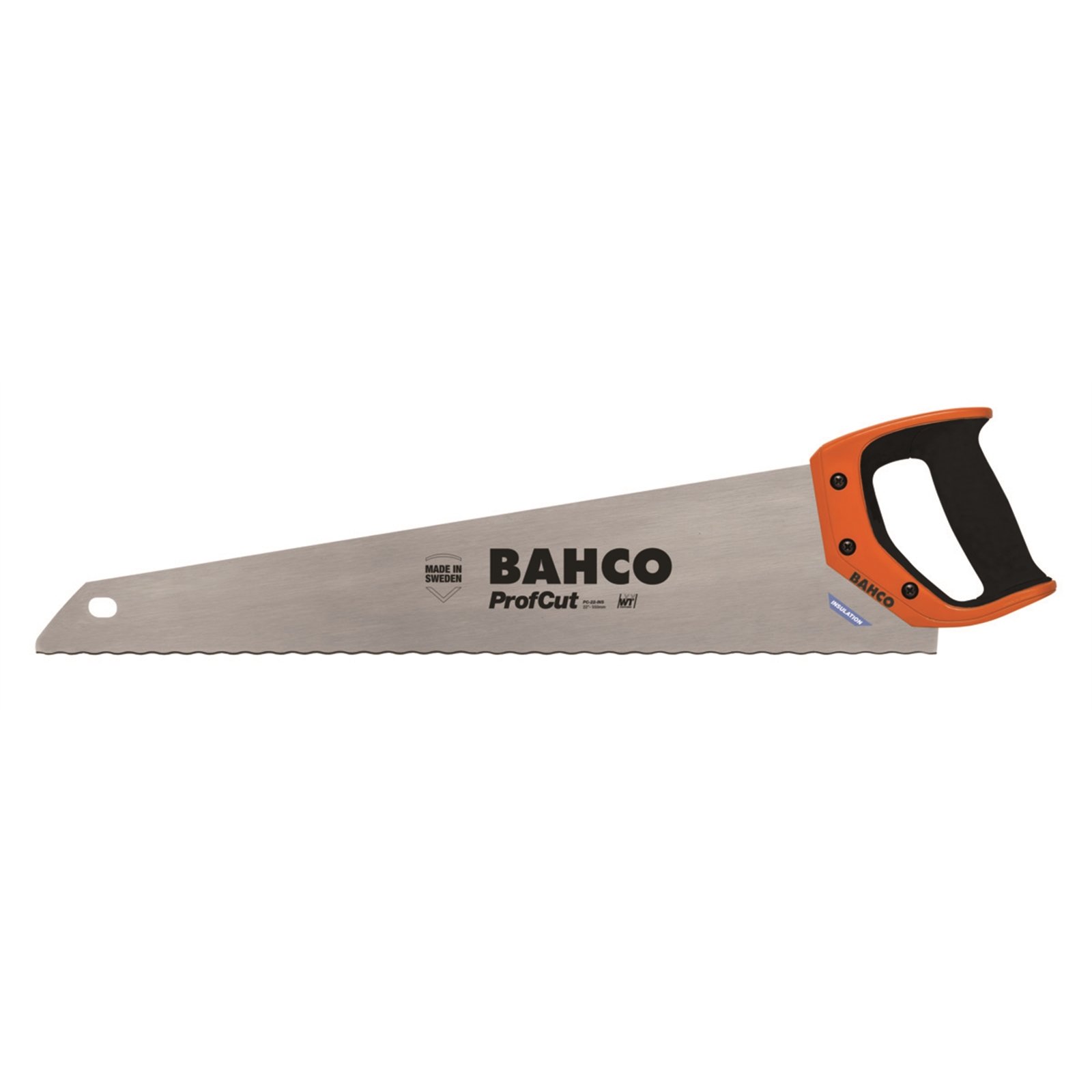

Setiawan Posted August 7, 2018 Share Posted August 7, 2018 (edited) On 05/08/2018 at 11:33 PM, Gradenko said: Toolmart recommended a hand held insulation saw for $45. I wasn't keen but tried it anyway. Thanks Gradenko. I've made quite a number of cuts to my batts in the past (maybe 16?) using just a hand saw, and it took about 10 minutes each time, not to mention the heap of fluff it produces for each cut: I still have a few fresh batts that I may cut up in the future, so this is good to know. Looks like Bunnings also stocks them for about $35: https://www.bunnings.com.au/bahco-550mm-insulation-hand-saw_p5710254 Edited August 7, 2018 by Setiawan Link to comment Share on other sites More sharing options...
almikel Posted August 8, 2018 Share Posted August 8, 2018 On 05/08/2018 at 11:33 PM, Gradenko said: I wasn't keen but tried it anyway. By gosh, this thing is sweet. Weighs nothing and cuts through it like butter. Highly recommended for when you need clean edges that aren't glazed. Awesome - will try it - just checking, it was poly not fibreglass you were cutting? I'm assuming poly since you refer to edges remaining unglazed? Bunnings web says, "designed for cutting mineral wool, polystyrene & styrofoam." If it works well on dense poly also - woohoo! FWIW, glazed edges won't impact absorption of lower frequencies, but you need a big disk to cut through 100mm thick polymax XHD in one go, so this tool is great. cheers Mke Link to comment Share on other sites More sharing options...

richiey Posted August 13, 2018 Share Posted August 13, 2018 On 05/08/2018 at 11:33 PM, Gradenko said: After that we looked at angle grinder blades for the circular saw, as bjc suggested. This would work great, except for my application I needed the sides smooth and not melted so the absorption qualities wouldn't change. Toolmart recommended a hand held insulation saw for $45. I wasn't keen but tried it anyway. By gosh, this thing is sweet. Weighs nothing and cuts through it like butter. Highly recommended for when you need clean edges that aren't glazed. Thanks for this suggestion! I was looking for something to cut the batts, ended up using a long bread like knife , which sorta work. Still have a few sheets to cut so might pop down to my local bunnings store On 10/08/2018 at 11:44 PM, iversons13 said: Has anyone been able to source black XHD recently? I tried through an insulation mob here in WA and got the common response that it's made to order for commercial quantities only. Group buy anyone? If you were in Sydney I have the Martini Absorb HD Black 2.4m x 1.2m x 50mm (pack of 6) might have a total of 1.5 packs (9 sheets) of these available soon - i am just in the middle of building my corner bass traps , I ordered 4 packs (24 sheets) have used 2 packs so far as I doubled them up to make 100mm thick for corner bass traps . Being black colour also they charge a premium extra 10% ! Link to comment Share on other sites More sharing options...
