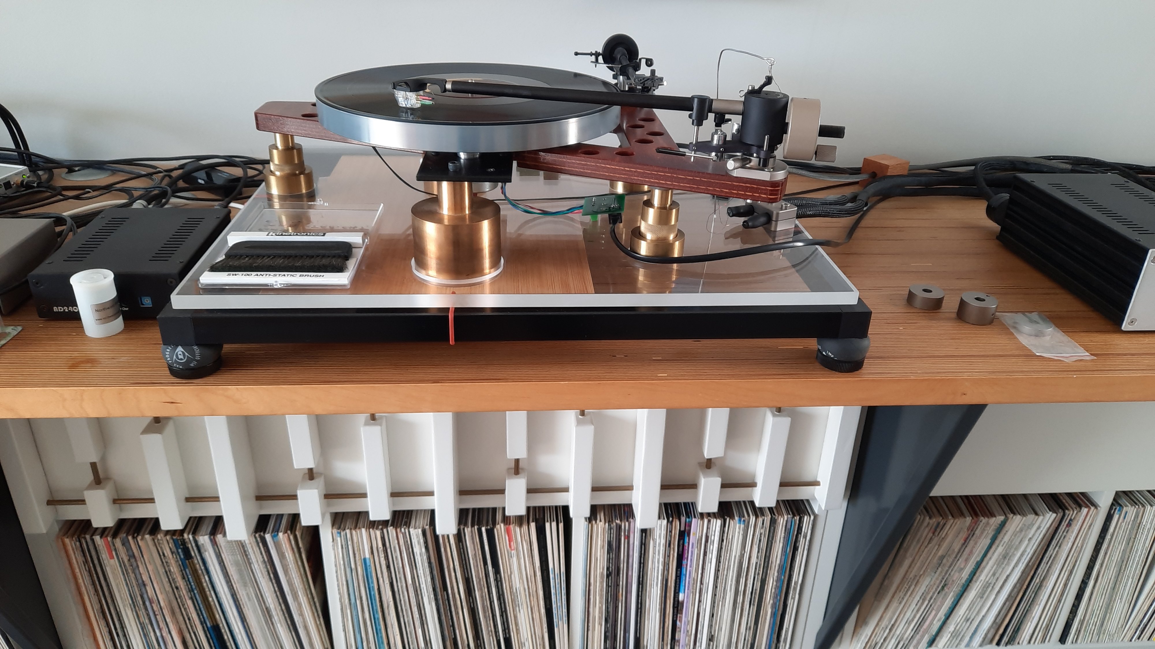

Well, it's taken a month but the two TT enhancements mentioned above ... are now in place!  👍
See here - with the recent MoFi 45rpm version of the 1st Dire Straits LP on the platter:

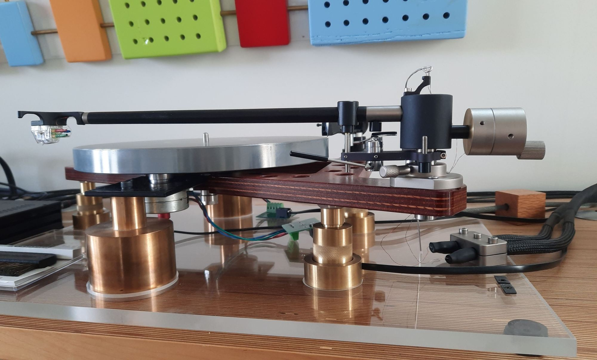

The c'weight was machined beautifully by Mark ( @SonicArt ) - and, with my current ZYX cart (which is light), is located about as close to the pivot housing as it can be.  (Haha, so I am still able to do mathematical calculations (to work out the required weight) correctly - albeit I now need to use a calculator ... not do it in my head!  :lol: )
Compare the position of the new c'weight ... to the pic I posted earlier, with the old c'weight:
The lightweight support frame in the 1st pic (which the perspex base of my 'SkeletaLinn' now sits on) deserves some description.  As an LP12 has always been described as sounding better if it sits on a light table (the 'Dekstand' of the 80's ... or the more recent IKEA 'Lack' table), I wanted a lightweight frame for the perspex base to rest on - as per the Dekstand!  Yet, as it is always advised to damp metal tubing ... what should I use?  :shocked:
I'm pretty sure the Dekstand used nothing - but to damp a lightweight structure ... I could've used foam-from-a-can ... or kitty litter.  But @Hawkeye suggested a silicone ring - like what are put round tubes to suppress microphony.  I thought that was a brilliant idea - so that's what I did.  (Renseal, in Dandenong, supply silicone O-rings.)  There is a silicone O-ring around each piece of tubing - 0.618 of the length of the tubing from one end ... the Golden Ratio!  :shocked:
As well as - hopefully - damping the tube, the top of the O-ring provides a nice, compliant yet grippy surface for the perspex base to rest on ... better than it resting on the metal tubing, I reckon!

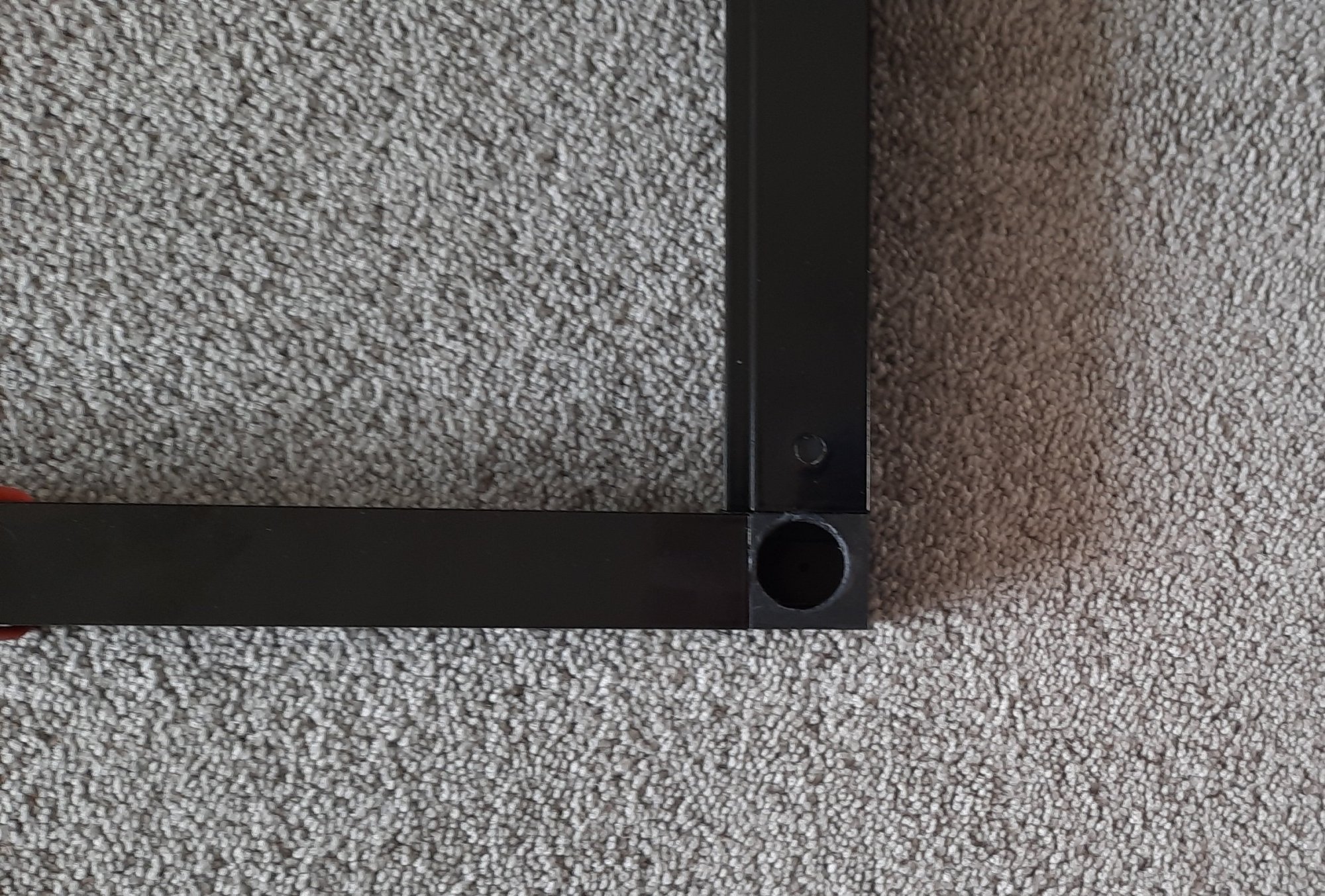

Underneath the Al tubing frame is a squash ball at each corner; these are held in place by:
*  a 16mm hole which I cut into each plastic corner-connector - see here:
*  and a plastic milk bottle top under each squash ball (to stop it rolling around).
So it's all quite sturdy!  :smile:
