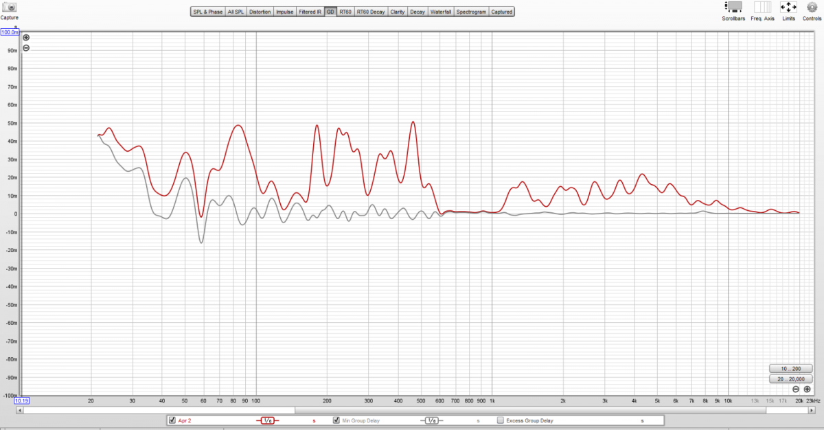

1 hour ago, Warren Jones said:
@andyr what does the group delay plot look like? can you post it.
See below, Warren.
I built another new pair of speakers (yes it's your fault after I heard yours LOL)
Sorry 'bout dat!  :classic_laugh:
and it took me a while to get the GD flat but this makes a huge improvement in clarity and tonal accuracy. From my measurements and listening flat GD is more important than absolutely flat on axis FR.
Here's mine - red is GD:
  • sub-to-mid/bass XO is 48dB L-R @ 90Hz
  • mid/bass-to-tweeter XO is 24dB L-R @ 2800Hz.
The grey line is what happened when I then clicked "Generate Minimum Phase":
I'd be very interested to know what I need to do to flatten it out.  :thumb:
Andy

Andy try gating the measurement as some of the ripple could be room, it'll increase the minimum frequency that will show on the plot. 8ms will give you results to about 125Hz.

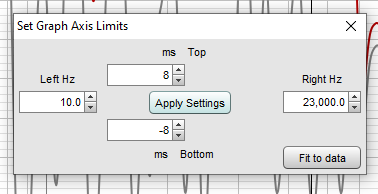

By "Gating" ... do you mean this, Warren?
Andy

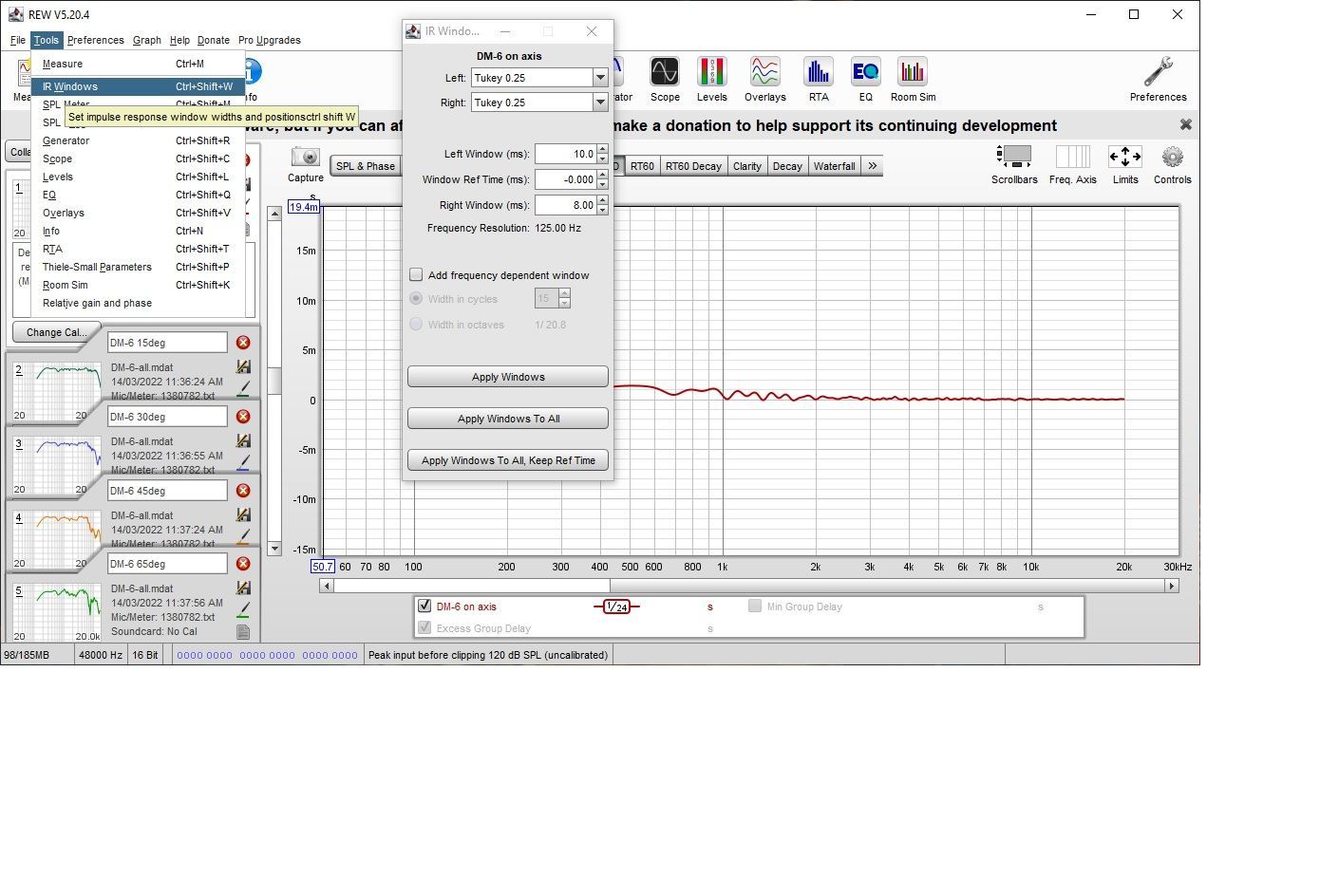

That's X and Y axis limits.
Go to tools, IR Windows. The Right Window ms is the one you you want to change. Ive set mine to 8.00ms
  • Author
Aah, OK - thanks @Warren Jones.
This is what I get when I set "Right Windows" to 8ms.  but, note, I have:
  • Left Window's default setting is 312ms - whereas yours is 10ms.
  • and Window Ref Time's default setting is 0.019ms - whereas yours is 0ms.
Don't know what effect these differences have:
Andy
The Left window starts the recording X ms before the sweep commences and the Right window is the measurement resolution, I set the Right window so the SW filters the reflections.
Look at the impulse response and identify the first reflection. Then set the Right window to filter this reflection that is why my Right window is 8ms. I had the speakers in the shed elevated with the microphone 1.4m off the floor.

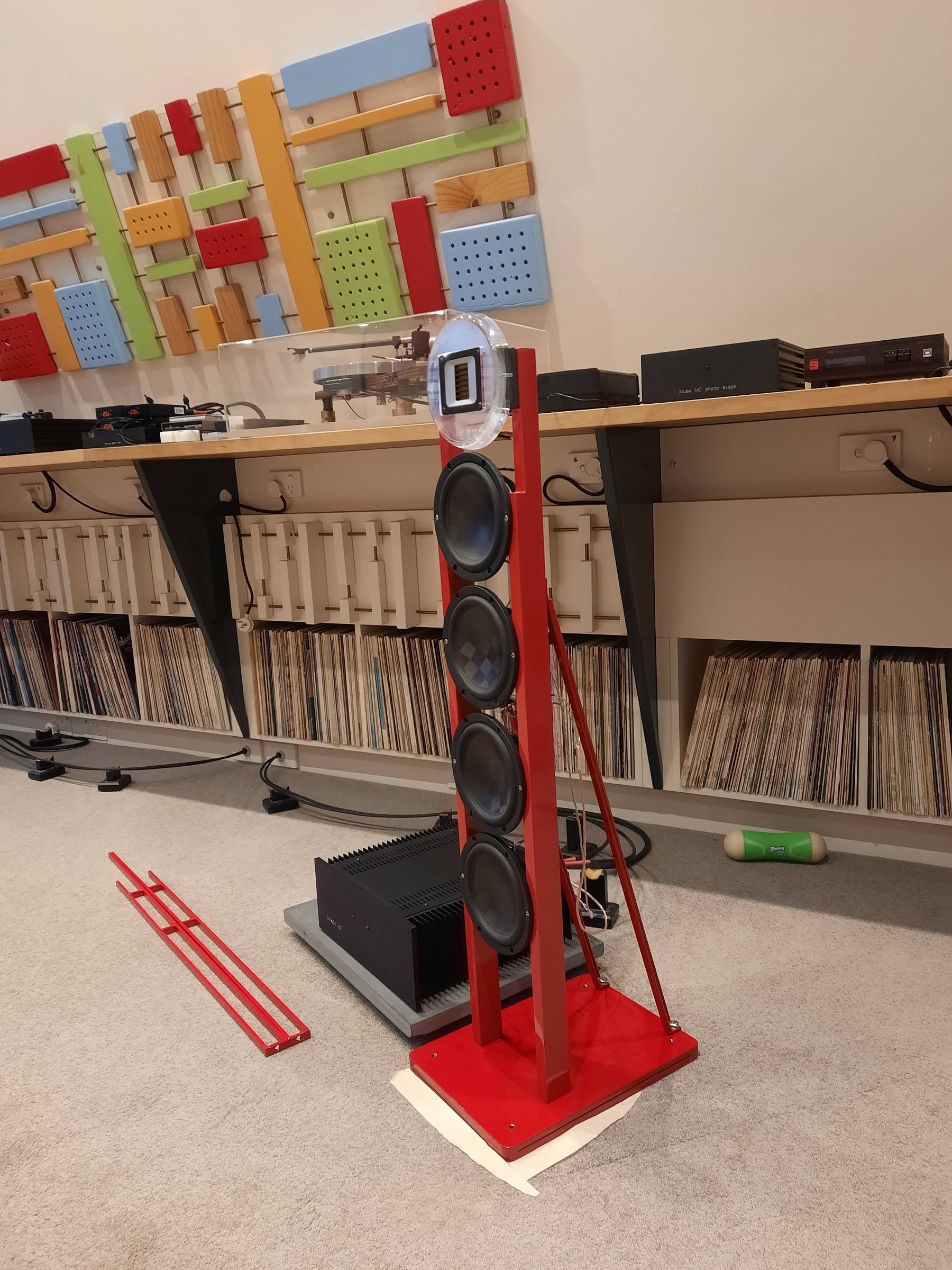

#1 was the fact that when someone came over for his first listen to non-box spkrs, a CD track we played revealed that the steel U-frames which my drivers are bolted to ... resonated.  Despite this - he must've liked the OB sound bcoz he then went and bought himself some!  :thumb:
After his visit, I used my sig-gen to feed different frequencies through the spkrs - and, sure enough, I could hear a 'buzz' develop @ 130Hz.  So then followed a couple of changes - CLD'ing my steel U-frames ... followed by aluminium U-frames.  Neither seemed to completely eliminate resonance from the U-frames - so I had some driver supports made to the same overall dimensions as the metal U-frames ... but made from birch play.  See here:
Happily, this solved the resonance problem!  The ply frames do vibrate - but they do not make a noise.  :thumb:

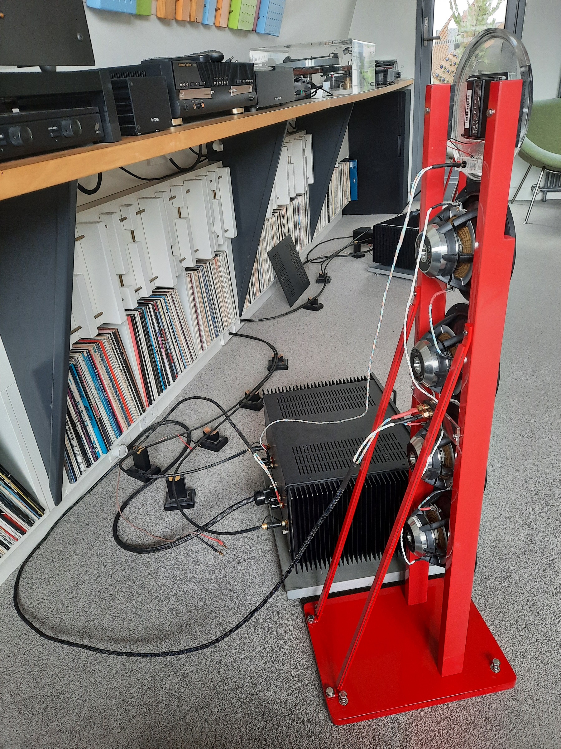

#2 was swapping over my 2x stereo Class A amps from active cooled cases (2x fans for each case) to 5RU passive cases (so no fans).  This ended up being quite an extended and fiddly job.  :(
There were a couple of mis-steps along the way ... but they are finally working the way they should!  Hallelujah!  :thumb:

Today, I finished making a pair of my Litz spkr cables (2,5m long) for someone who wanted to replace his "Bill's cables".
Here they are ... running in on my mid/bass drivers (as he can't pick them up till next Wednesday):
My normal mid/bass Litz cables are on the floor behind the amp (they're much shorter).
Andy
