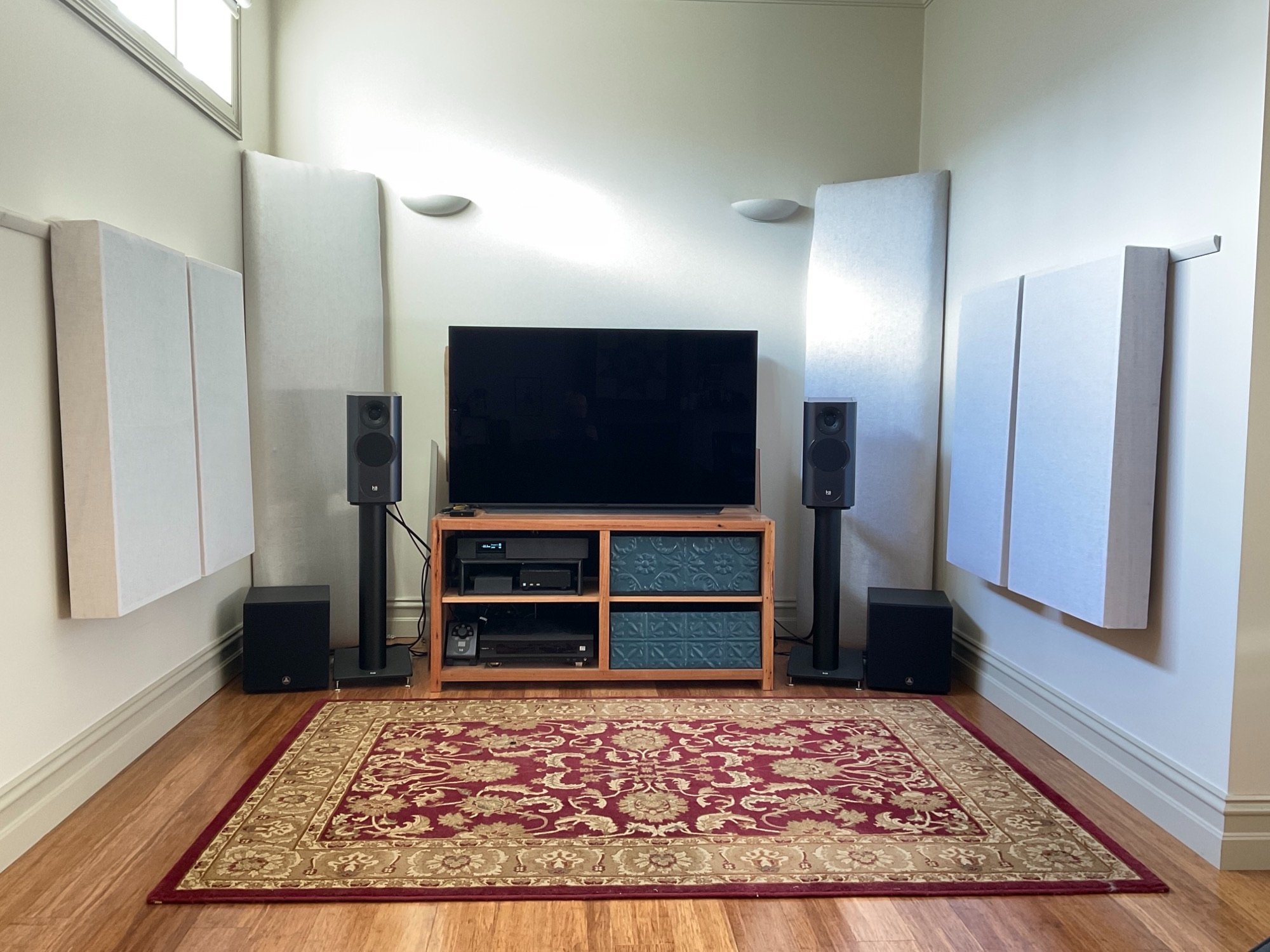

The Mirror Trick works well.   You might need a mate to help.   Size wise - may I suggest - measure from top cone to top of speaker.   Say it is 250 mm.    Take that measurement and measure from bottom cone down 250mm.   Have the panel that total distance from the top of the speaker down to 250mm below the bottom cone.     Maybe 600mm wide.
The idea of the 1st reflection is to absorb the frequencies and not let it bounce off any surface to your ears.    That way, the only sound your ears pick up on are those coming from the cones and not a milisec delay bouncing off a wall etc.
Likewise, a thick carpet, as suggested, infront of the speakers, to stop floor reflection.
I used Tontine  Acoustisorb 3
Regards Cazzesman
This is my room.
Regards Cazzesman

Some points to make.
1. Don't deploy room treatments without the help of a measurement microphone. There is a very high risk that you will skew your room response by deploying treatment willy-nilly. The thickness and density of the foam determines what frequencies will be absorbed, and by how much. The total attenuation also depends on the total surface area. Foam typically absorbs short wavelengths (higher freqs) whilst leaving long wavelengths alone. If you simply slap room treatment on without knowing what you are doing, the result will be: muted, dead sounding top end with bloated tubby bass. I have been to many listening rooms like this.
2. The target RT60 for your room varies according to room volume (larger room = higher RT60), application (studio = lower RT60, listening = higher RT60), and personal preference.
3. This target is achievable in most listening rooms without any room treatment. All you need is normal furniture.
The "less reflections! More reflections!" debate has been going on for a long time, and that is because it has not been backed up by proper controlled psychoacoustic studies. In general, there are two camps with opposing philosophies - the first camp believes that "the room creates the soundstage". If you believe this, then you want wider radiating speakers and less room treatment, if not none. The second camp believes that "the soundstage is in the recording". If this is you, then you want narrower directivity and more room treatment. Toole is in the former camp, and people like Griesinger and Choueri are in the latter camp.
FWIW I met David at Selby Acoustics over the weekend at the SNA show. He is an acoustician, and we got into an interesting chat about how he recommends products. He manually calculates what is needed. I asked him whether he uses EASE (professional acoustics software which requires a $3000/year subscription) and he said it's too expensive. So I showed him a free open source alternative.
In short: DON'T DIY your own room treatment unless you know what you are doing, and especially DON'T try to do it without a microphone. You need to know what the problem frequencies are, and determine the products you need by calculation. You can get 90% there with a few simple measurements, but for best results - hire an acoustician.
Why can't people DIY their own treatment?   It is their money.   It is their ears.   Surely, people can spend a small amount of money and 'Give it a whirl'.   No harm, no foul.   If it sounds worse, such is life.   If it sounds okay, then woohoo.
I'm sorry Sijo, that it has come to this.    Read it all and work out what works best for your circumstances.
In the world of Internet forum's please remember.........."Opinions aren't facts".     Sometimes facts might not even be facts because for every fact raised, someone will present their own expert, who will argue an opposite fact.
Regards Cazzesman
Sure. Just like you can DIY your own parachute.
I'm not saying that he can't. I'm suggesting that if he's going to do that, he needs to learn a bit about how it works.
Edited by Keith_W
  • Author
Hey everyone,
Wow, my room treatment thread turned into an AI cage match! 😄 Thanks for all the passionate input—cazzesman, Grant, MrC, Satanica, and the whole crew. I’m loving the debate, but I think my speakers are getting jealous of all the attention AI’s stealing!
So, I asked my new AI overlord (let’s call it Grok the Room Whisperer) for advice, and it suggested I cover my walls in velvet, hang disco balls for diffusion, and train my cat to sit perfectly still as a bass trap. I mean, who am I to argue with a million stolen—er, collated—opinions? 😜 But don’t worry, Grant, I’ll fact-check that with Floyd Toole and my cat before I start redecorating.
I’m gonna build those DIY panels (thanks, cazzesman!) and play with placement, maybe leaving those first reflections alone for that sweet soundstage vibe (nod to Satanica and Grant). If it all goes wrong, I’ll just blame AI and tell it to take a hike… or a byte. 😎
Cheers for the wisdom, and let’s keep the good vibes (and soundwaves) flowing!
Sijo
