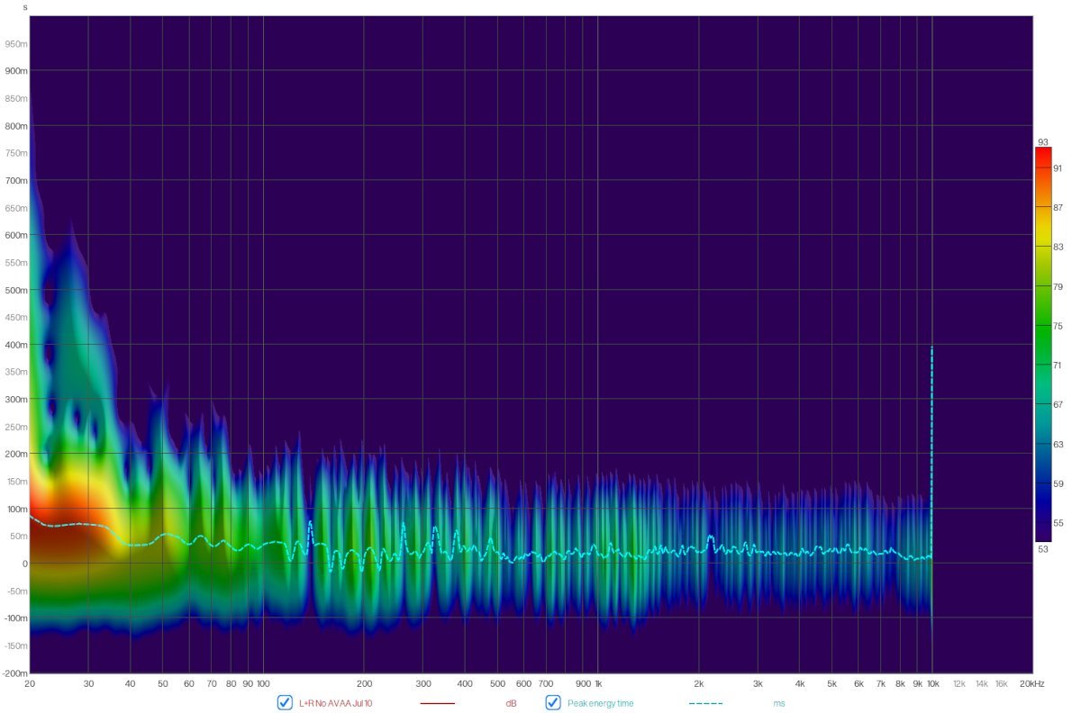

As a followup, Keith had a look at the measurements from the AVAAs as well, and reminded me of where the difference was most "obvious" in the spectrogram. You can see how subtle the difference is, and bear in mind this is before my DSP FIR convolution is applied, so there is a good chance the difference is even smaller.  As they are in colour, I also created spectrograms in pure brightness and created a diff image from them showing only the difference between the two. The AVAAs are only active up to 160Hz so anything after that is just randomness in measurements. The "white flame" on the left is the attenuated component.

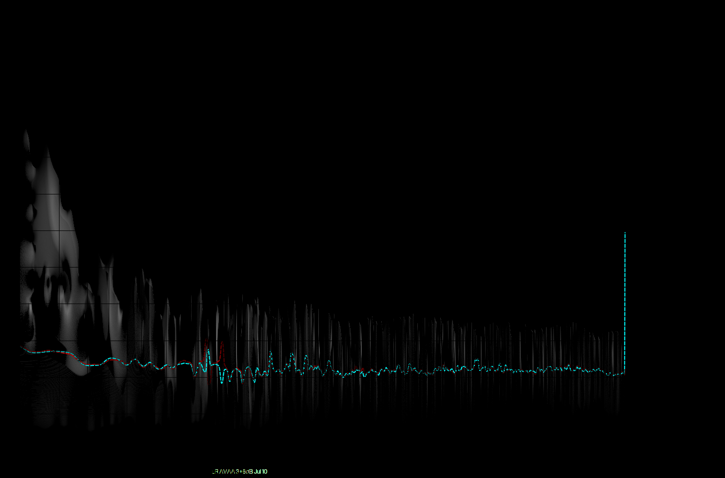

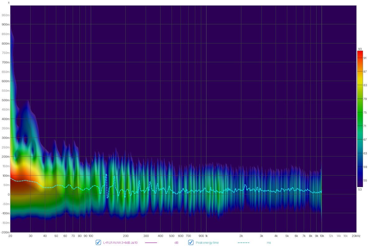

Okay let's try again. It appears to be a new firefox version problem, so I'm using chromium to upload the images. Before, after, and difference. As you can see they're definitely doing something, but how minor it is, and how audible that is corresponds with my experience.
avaa0.jpg.b6fbf1a4e435d522e137635a850b1245.jpgavaa1.jpg.a179a5dc4d97ba20f30d2026850f634d.jpgavaa_diff.png.42b6e59c39fd4eedcacaad45fa826b08.png
Edited by Ittaku
Looks like effect is mostly below 60, not easy to achieve even this low level reduction.  so definitely doing something. I wonder if it will become more evident as you listen more. Also interesting increase in GD in the mid one hundreds.
What about RT60's , is it noticeable on those?
Edited by frednork
  • Author
4 minutes ago, frednork said:
Looks like effect is mostly below 60, not easy to achieve even this low level reduction. a so definitely doing something. I wonder if it will become more evident as you listen more. Also interesting increase in GD in the mid one hundreds.
RT60 only measures from 60Hz upwards, and it shows a slight increase overall  - a decrease with just the left channel engaged and an increase with the right channel, which is why I wondered if having the right sub at the back right corner is responsible. RT60 is probably useless in a normal listening environment at very low frequencies. The GD at mid 100s is interesting given that's where they stop being active.
The fact it's most noticeable (though still very subtle) with low piano notes is consistent with them starting at 24Hz and being in the range where it's affected.
Edited by Ittaku

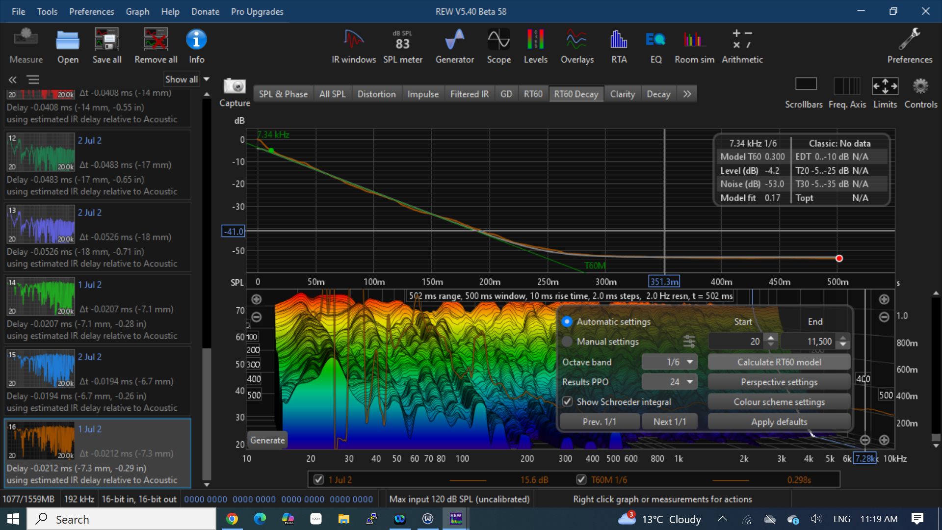

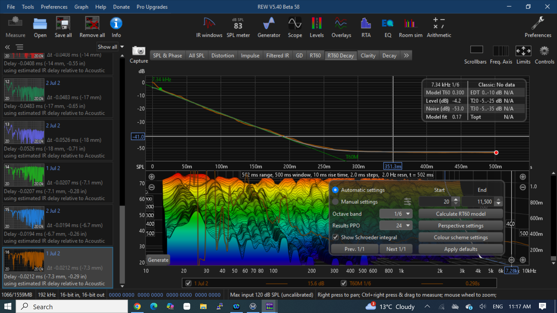

The newer versions (or maybe beta) of REW do a more granular rt60 calculation which is not over large frequency ranges and will go as low as the measurement allows. Whilst perhaps not theoretically correct or comparable across different rooms or positions, in your use case (ie same room same mic position) I think you can still use it reliably for comparison purposes.
There may be newer versions but mine is 5.40 Beta 58 and includes this. To use it go to the RT60decay tab and click the generate button (bottom left)
Then ensure the controls dialogue is on and click Calculate RT60 model image.png.7230219de7f9c2958bb821c857730309.png
Then you can easily compare measurements in the Overlays section on the RT60 tab and select the T60M trace.image.png.81e5b6004147e228040ba462c0f266ba.png
The above show 2 slightly different filters in my new digs in which I have a lot of work to do . The room is a bit of concrete bunker like yours but without the overly generous dimensions you have.
Thanks, I'm on the latest stable which is 5.31.3, will investigate when time permits.
