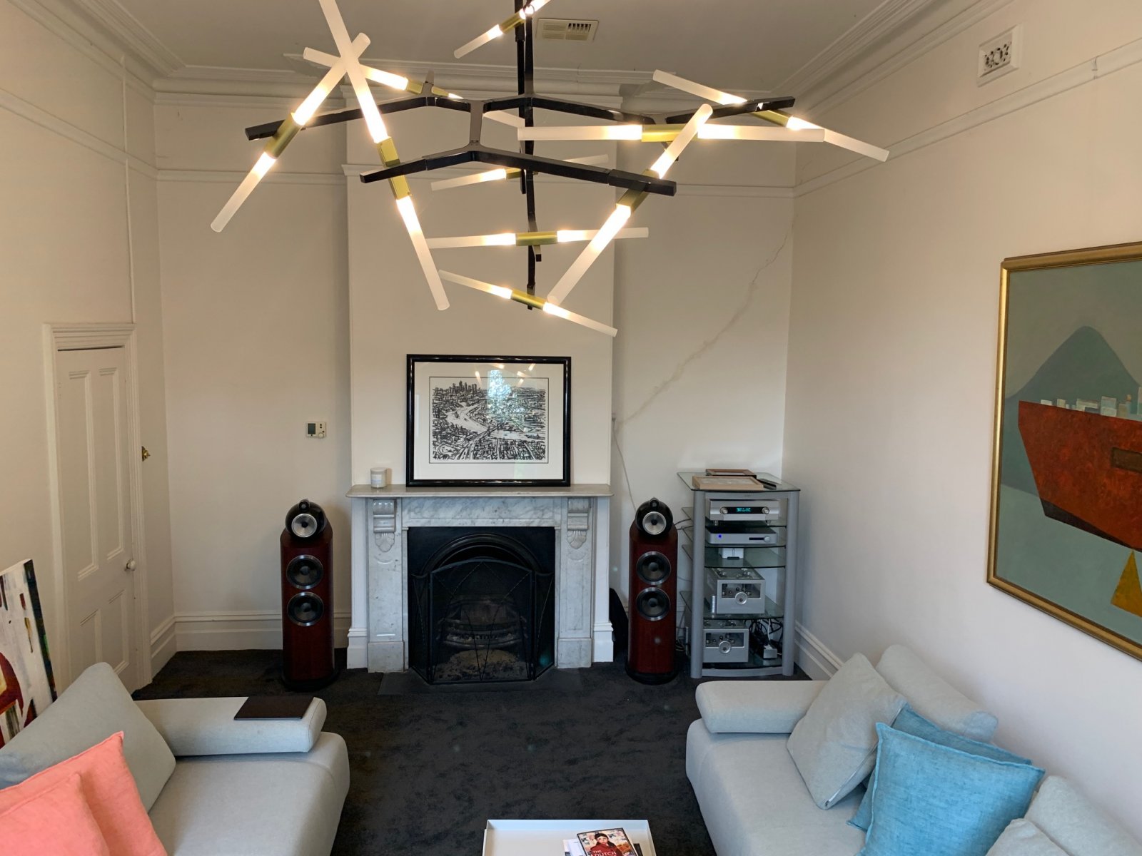

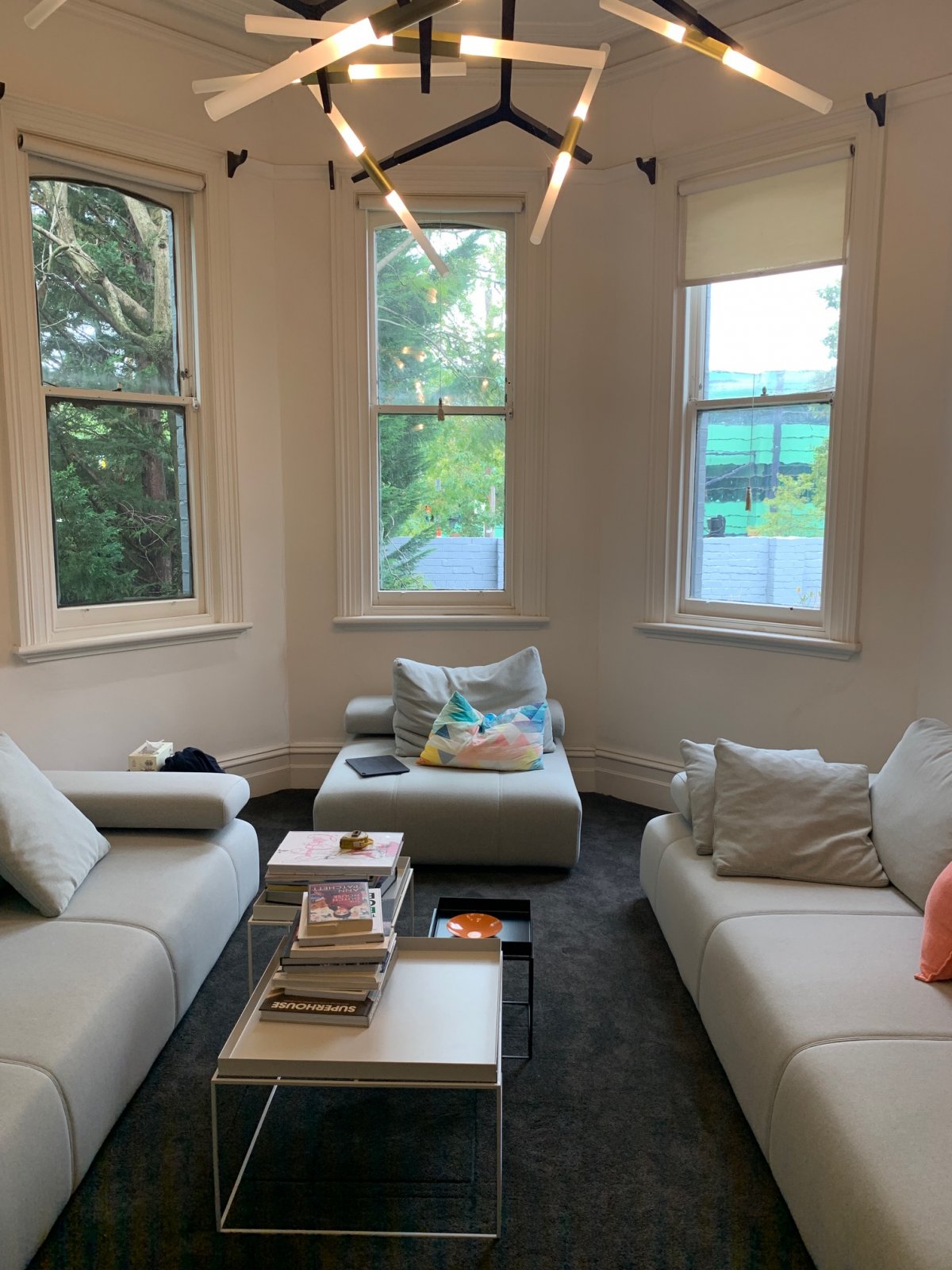

Couj Posted April 4, 2020 Author Share Posted April 4, 2020 For those who are interested in the room accoustics, I've attached some pictures of the room. The room is approx 4m wide x 6m long with 3.5m ceillings. Unfortuantely, because one of the speakers is near the door to the room, the back of the speakers are only about 30 cm from the front wall (to allow clearance between the door when it is open and the speakers (with enough space for someone to enter the rooom without falling over the relevant speaker)). To keep the wife happy, this is the best I could do with placement. Link to comment Share on other sites More sharing options...
betty boop Posted April 4, 2020 Share Posted April 4, 2020 @Couj I dont think that setup is doing your speakers any favours... you get about +3db bass boost just with a wall +6 in a corner, in your case it looks like both being in alcoves will be likely in order of +9db quite possibly not sure ! in essence near two walls and rear wall. 300mm behind speaker like this just isnt enough... likely getting about 12db+ of gain just in the bass making it stick out from rest and becoming obvious. the speakers themselves also look too far close together depending on where main listening position will be ? is it the chair/single seater couch all way back ? additionally thew single seater couch looks like close to the rear wall there and by hexagonal nature of it also adding as a corner so more bass gain ? I'd personally look to relocate the rack on the right...get out of way ? perhaps up other end where listening position is ... jsut to clear the front stage so gives speakers more room to work with., move speakers more forward well clear of the corner and fire place, well ahead of fire place and wider apart once rack out the ways... if all that is not possible maybe consider relocating speakers to maybe other end of room ? ie window side ? though the couches look far too big and will likely have to move back and not leave much room other end either ... anyways just some thoughts am sure others will have more ... 2 Link to comment Share on other sites More sharing options...
