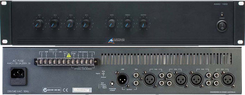

powerav Posted December 1, 2016 Posted December 1, 2016 You probably need what is in Clubs and Pubs a amplifier like this. and a lot of 100V speakers all wired up together so you get a even spread right across, can even plug in a mic and make announcements. 1
