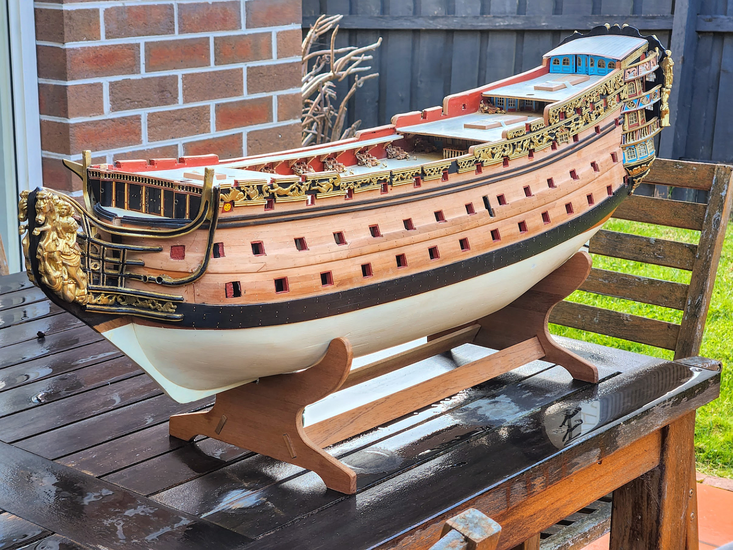

There is quite a lot to do. But for the time being, I have gone back to my old hobby of model ship making 🙂  This is the HMS Royal William, launced in 1719:
It started off life as a Euromodel kit 10 years ago. I have replaced half of the kit parts and scratchbuilt my own replacements. The only parts of the kit that remain on the model are the skeleton and all the metal castings that you can see. The windows and galleries were metal castings - I did not use them. I made my own. Those oval decorations at the rear are silver soldered rings which I made myself with a jeweller's soldering torch and jeweller's solder.
Ship modelling is a very slow hobby. Well, so is DSP ... but DSP is a fast hobby if you know what you are doing. I don't (or rather, I didn't). So for me DSP was a years long learning curve so it qualifies as a "slow hobby". Ship modelling is slow by nature, even if I took shortcuts, used the kit parts, it would still be slow. It is also rare to encounter other wooden ship modellers, I suspect I am the only one on SNA

Work on my new "room treatment" continues ;) . The shrouds have been served and are waiting to be attached to deadeyes. For those who don't know, "serving" a rope means wrapping a small rope around a larger one to prevent chafing. This is incredibly time consuming to do, given that some ropes are served for the entire length. Good thing I have friends who are ship modellers and I managed to borrow a serving machine from one of them. Even then it's still a manual process and it took days to serve all the rope that you see here (56 lengths of rope!), and we are less than halfway through.
Once the sails are on (a good few months away) the model will be at the first reflection point. I am curious as to how it would affect the measurements, so I will do some before and after sweeps when it is done. At the moment I can't measure anything because I loaned my measurement setup to a friend so that he can get his active system up and running. Come to think of it, he doesn't have a system thread on SNA, maybe I should encourage him to start one!
