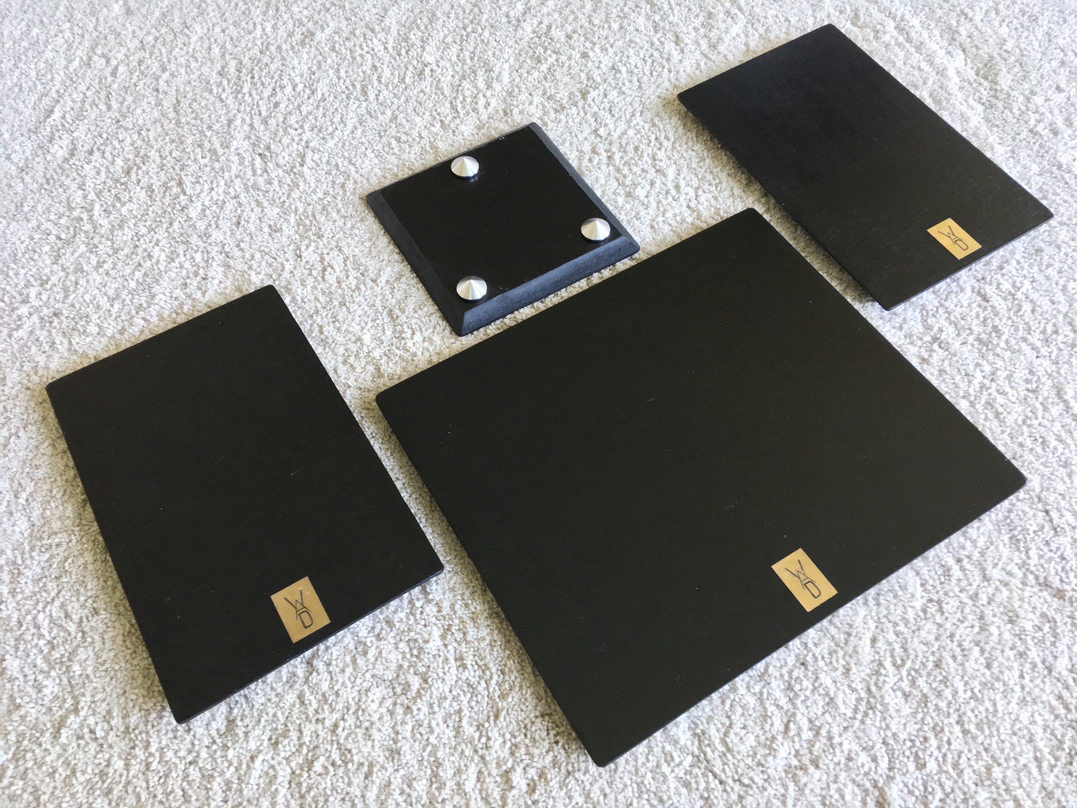

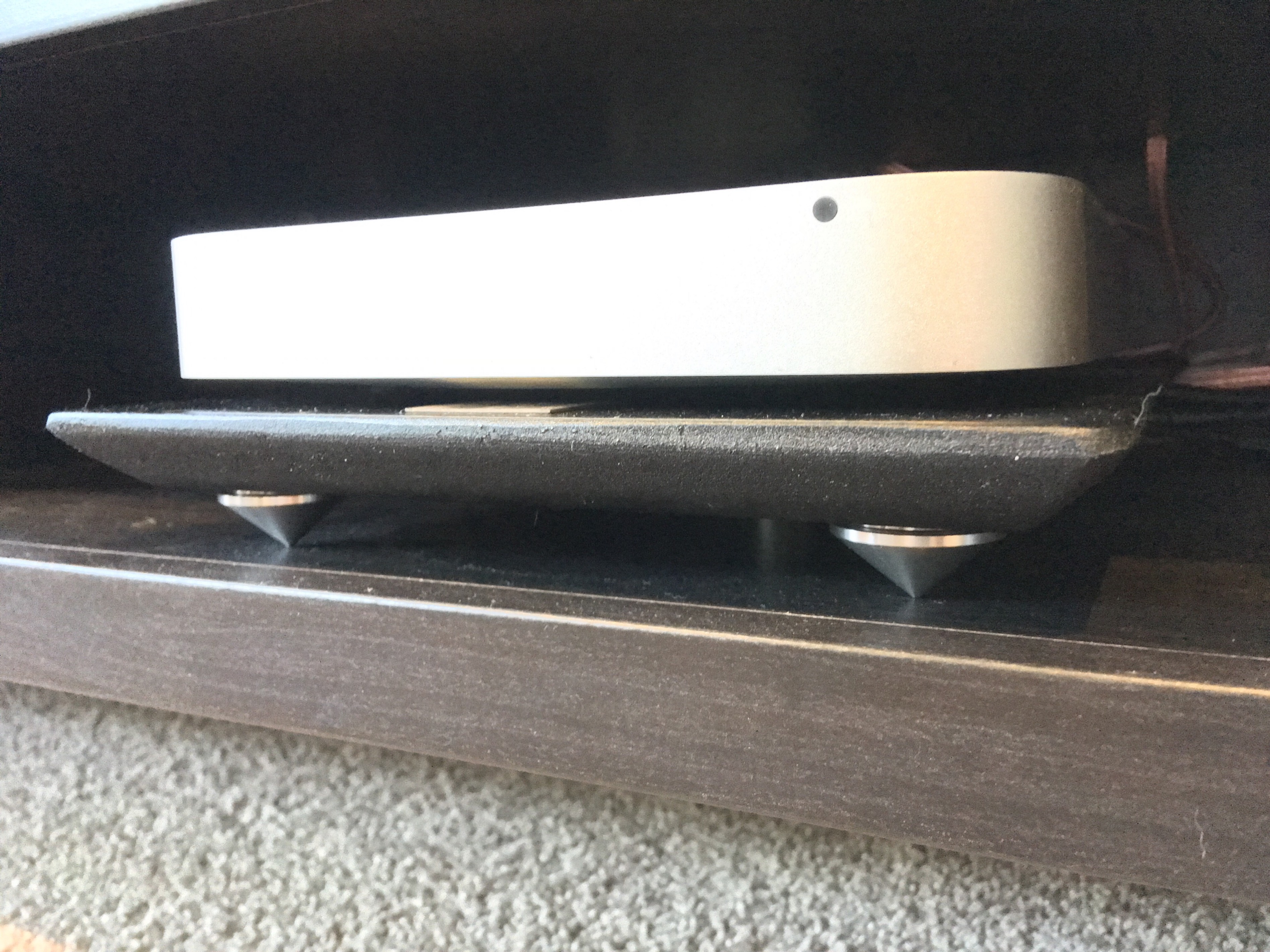

For a little while I have wanted to play with isolation to help improve things. My first venture into this field was with a Mission Isoplat and then Audioquest Sorbofeet, then Mitchel Tenderfeet and Target and other stands.
Generally speaking, I have preferred lighter mass*, "rigid", and inert supports as they have helped improve things in my various systems through the years while maintaining my systems' liveliness and dynamics.
(*speaker stands excluded)
More recently I have been using Vibrapods and Vibracones directly under my equipment.
The trouble is, the slightest movement of my gear can and has resulted in things falling off their cone supports onto shelves. It's not been steady, safe, or easy to set up.

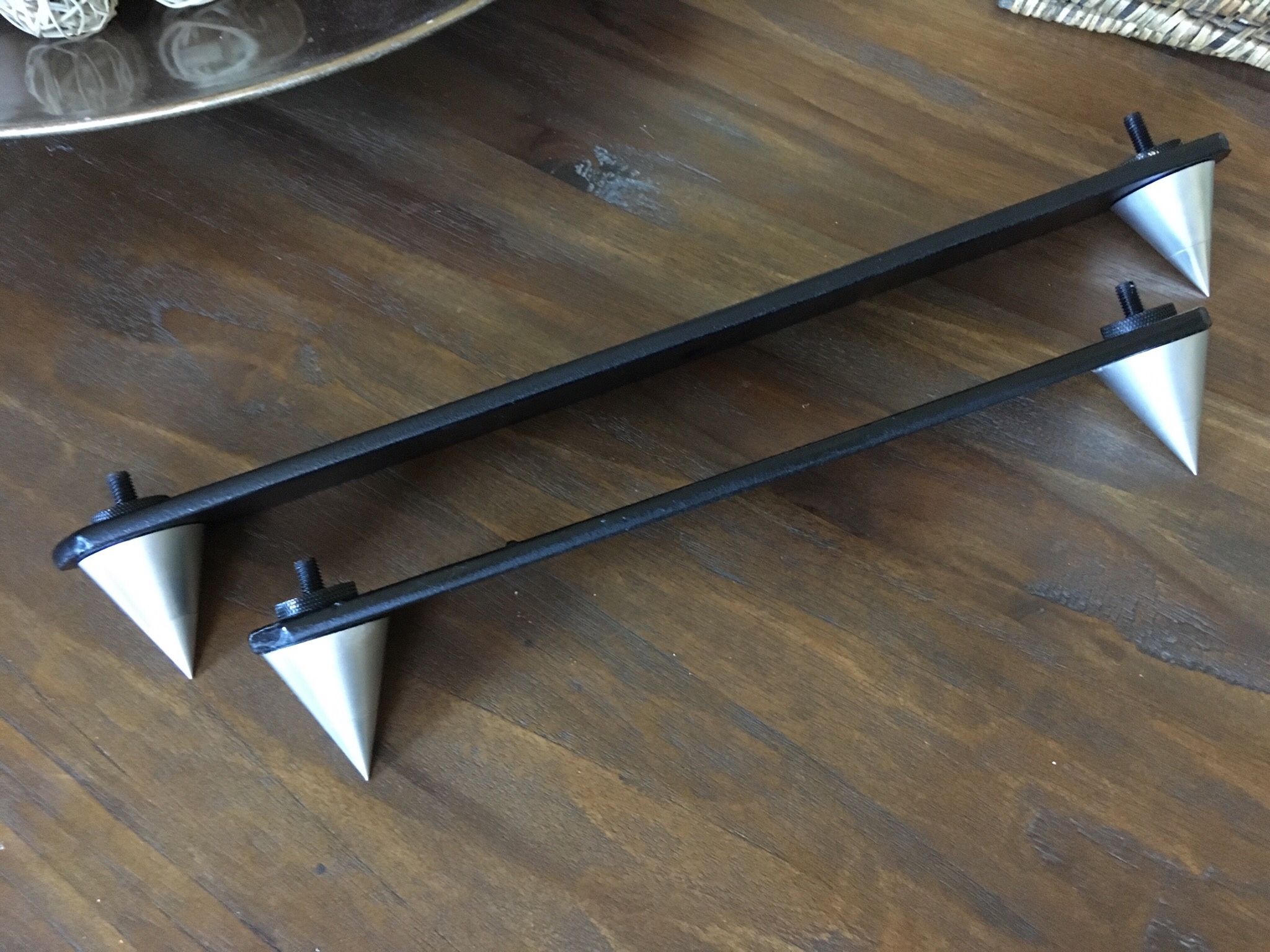

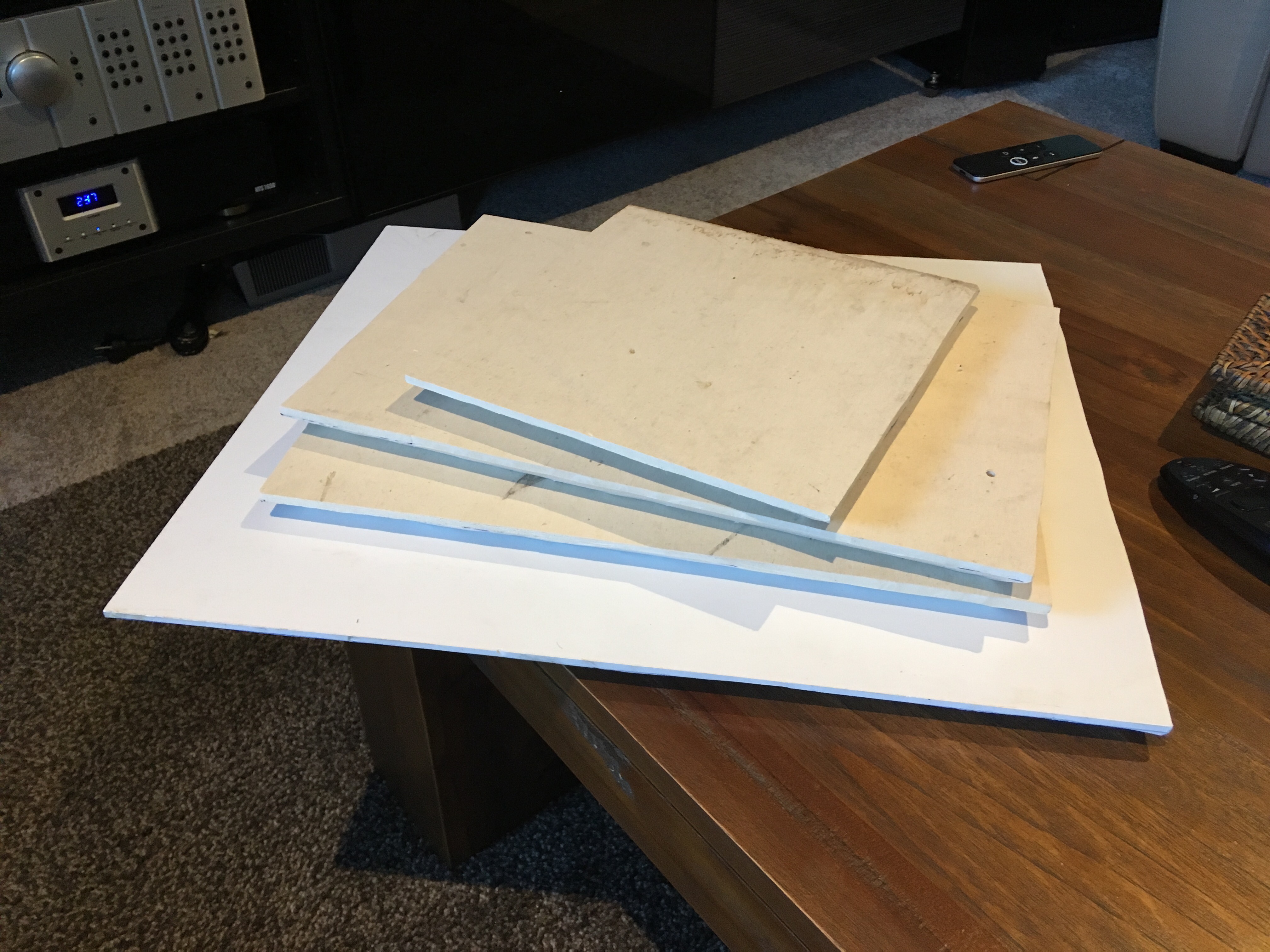

So, in keeping with light, stiff, and inert, I started fabricating up some support boards that my Vibrapods and Vibracones can be screwed to and also offer more adjustment of where feet sit in the event I decide to try other products.
I was going to use IKEA bamboo boards but I didn't like the results from previous use of them. I actually preferred glass to bamboo.
I was given some plastic type board to use for car speaker door spacers but decided to try it for under my pre and pc as I can get more board if I need to easily enough.
This stuff is very light - a fraction of the mass of MDF , is very, very inert to knuckle raps - it doesn't ring like MDF or granite - it really is very "dead" sounding. It's also very stiff.
And you can also cut it with a jigsaw and a knife.
This is tonight's work;
They'll get a couple more coats of flat black and have the Vibrapods afixed and then should be ready to go.
??for a sonic improvement while making it easy to set the gear up.
[edit] ok, I'm impatient so the drying flatforms were put under the heat lamp to speed up drying. This worked well and the Vibrapod feet were screwed to the bottoms of each platform.

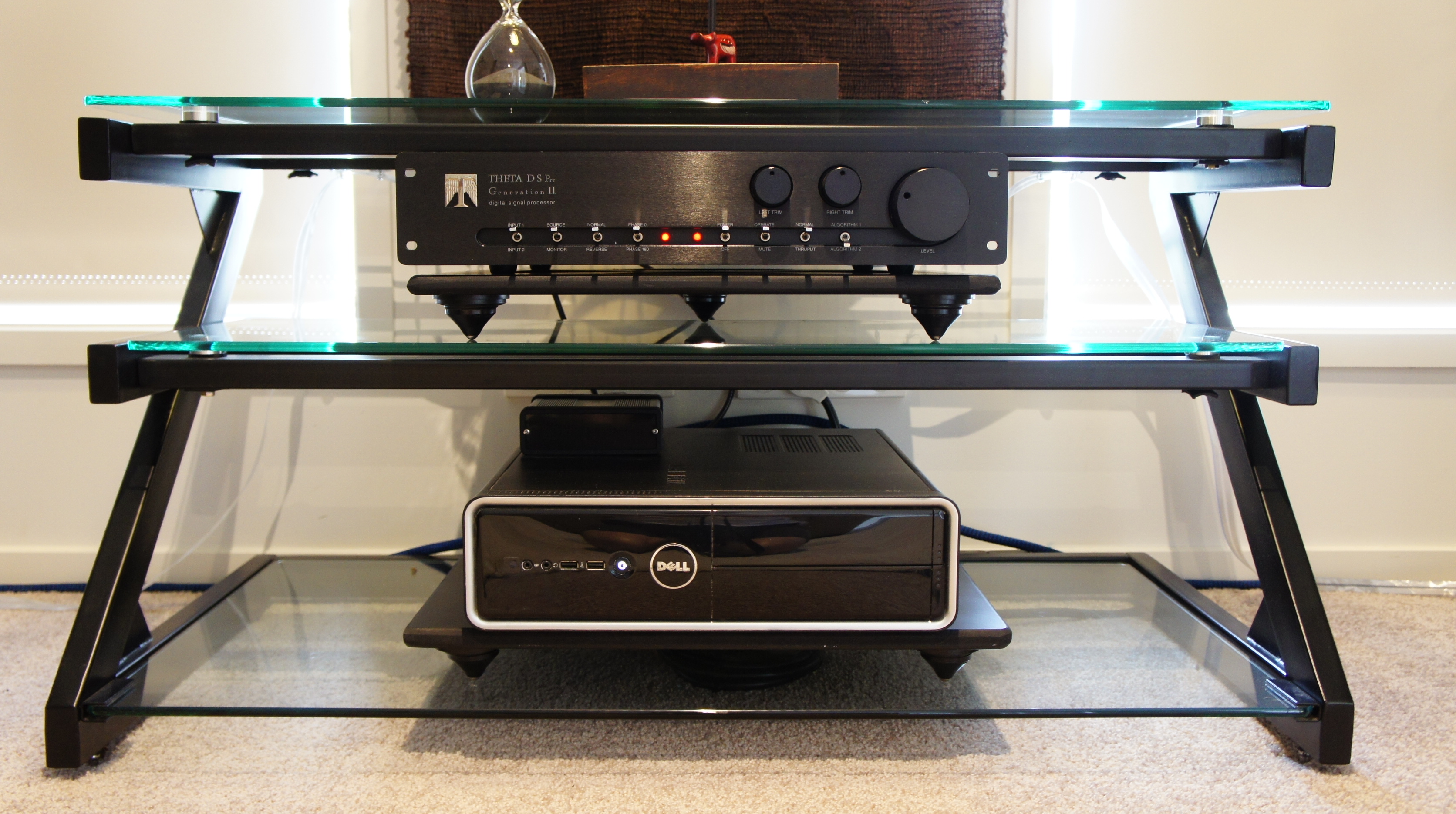

With this arrangement increasing security, I could move back to three feet per shelf now instead of four. I should point out that while these shelves are relatively stiff relative to their mass (the material will snap if flexed too far), as they are here, they are actually ever so slightly compliant.
Here are the shelves in-situ;
There's about 1-2mm clearance between the top of the Theta and the top shelf cross bars.
I should also point out, the shelves are toughened glass bolted to a low mass, hollow steel frame. The glass is decoupled from the supports with sorbothane washers.
The whole thing sits on four stainless steel M8 spikes through carpet onto the concrete slab below.

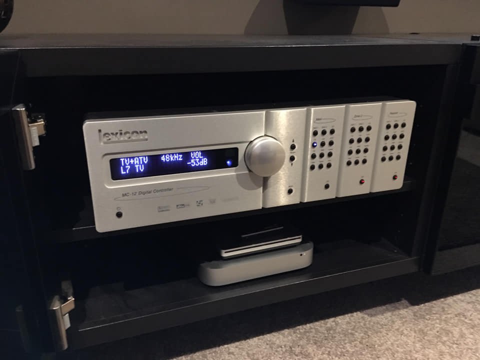

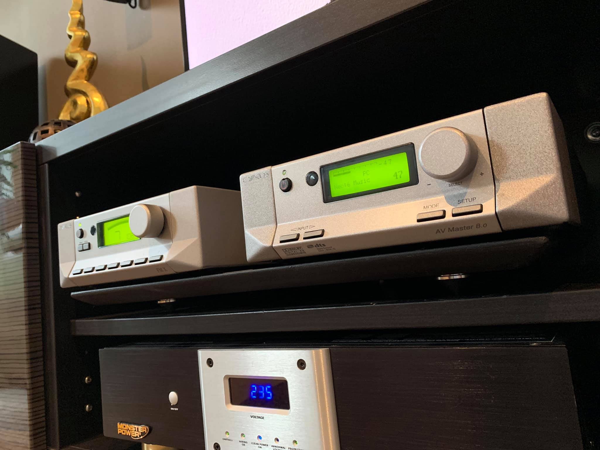

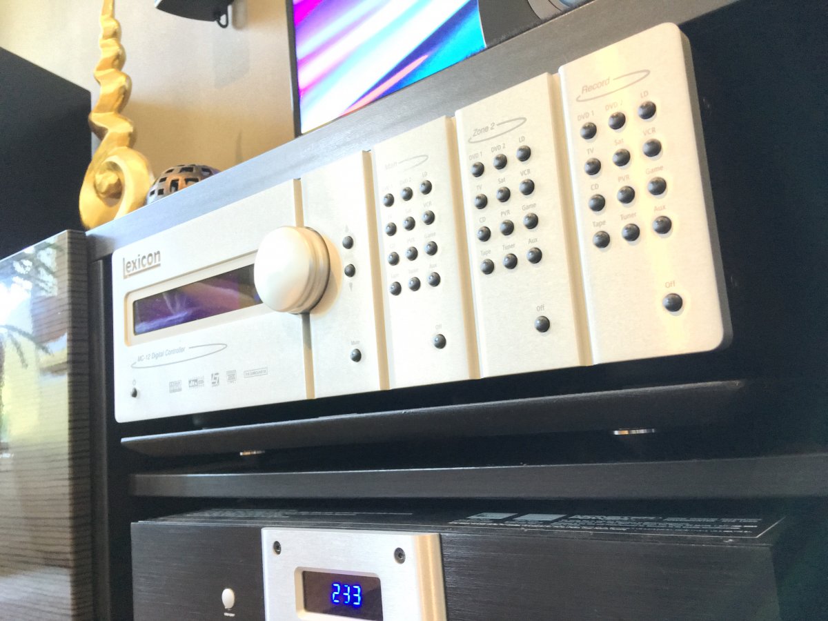

I sold my Cambridge Audio 751R HTR for quite good money and purchased a Lexicon MC-12 V3 from a local seller via Ebay. I got it stupid cheap and I kinda felt bad not paying what I thought it would have cost me but, oh well...
48357071_10216843268810674_6280481602644475904_n.jpg.395f9c41a370454d3a5ee635edf4abc0.jpg
This only passes up to component video for switching but I'd decided to run video direct from sources (terrestrial digital TV, Apple TV for Tidal hifi/Netflix/Apple Movies, and Apple Mac for everything else) via HDMI to the Samsung LCD anyway. In so doing, I was rewarded with a much sharper image, with more vibrant colours, etc. This was a very noticeable improvement over the switching/precessing done by the Cambridge previously.

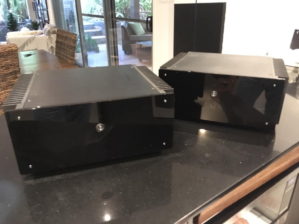

My father also decided to part with his Benchmark Vortex monoblocks and they arrived today (apologies for the poor image quality).
48368899_10216842827759648_6072210057116778496_n.jpg.4f03bec6bb53cffa52570fe7bca871f9.jpg
48017147_10216843252010254_2070625869663043584_n.jpg.7b04b6c31f2dc7a1563329aff68540bf.jpg

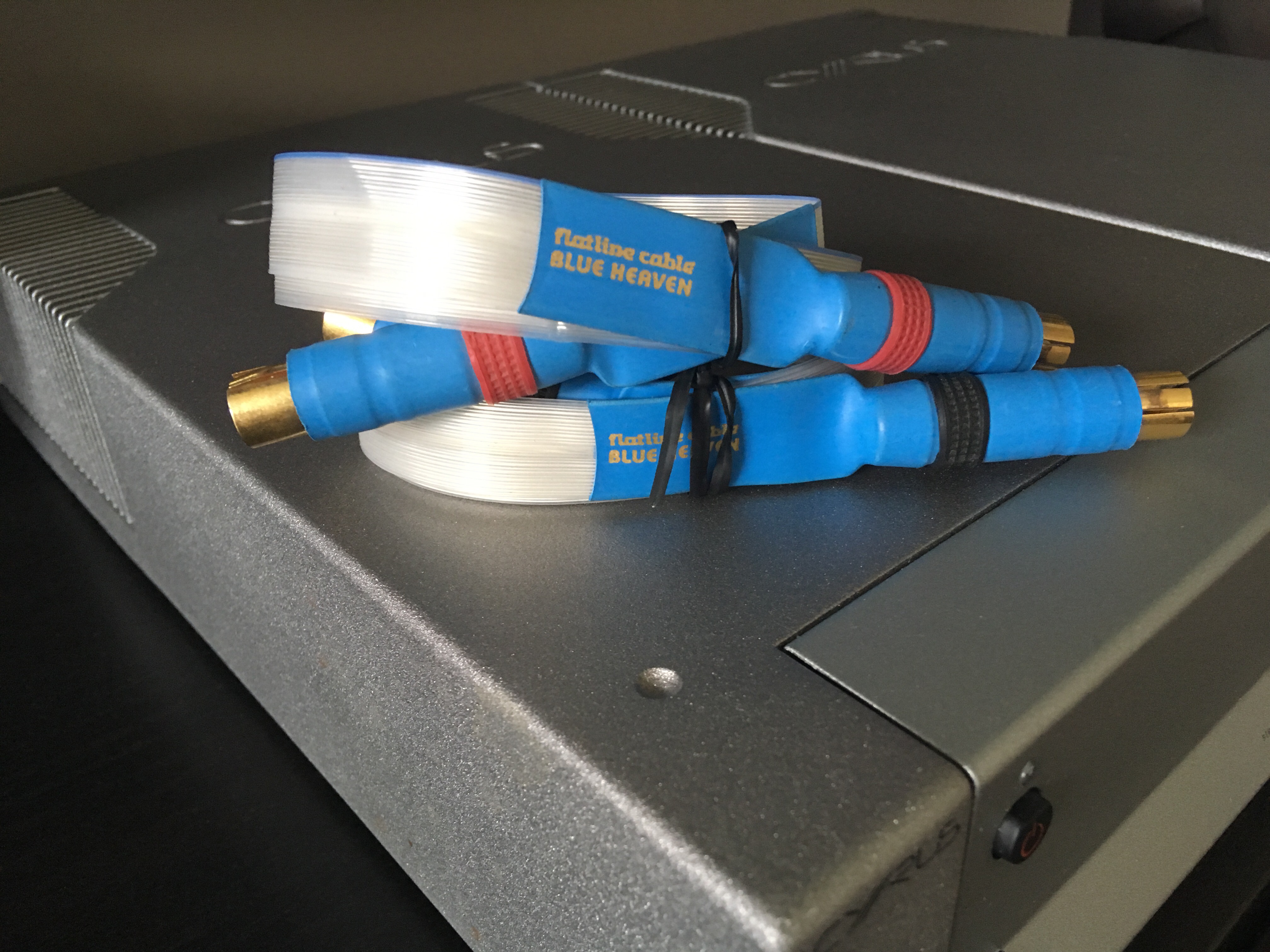

I'd also sourced another set of long Nordost Blue Heaven RCA cables and made up some short bi-wire speaker cable runs with Nordost 2Flat left over for my Alfa Romeo system build.
48369722_10216825227919663_6693547634205917184_o.thumb.jpg.d4d196488366abf85ed3b36a1531dd03.jpg
How does it sound?
Magnificent!
These amps are incredibly dynamic and punchy. Their grip on bass is impressive and the 10" bass drivers in the side of my NHT Classic 4's have never plumbed so deep. No subwoofer needed - seriously!

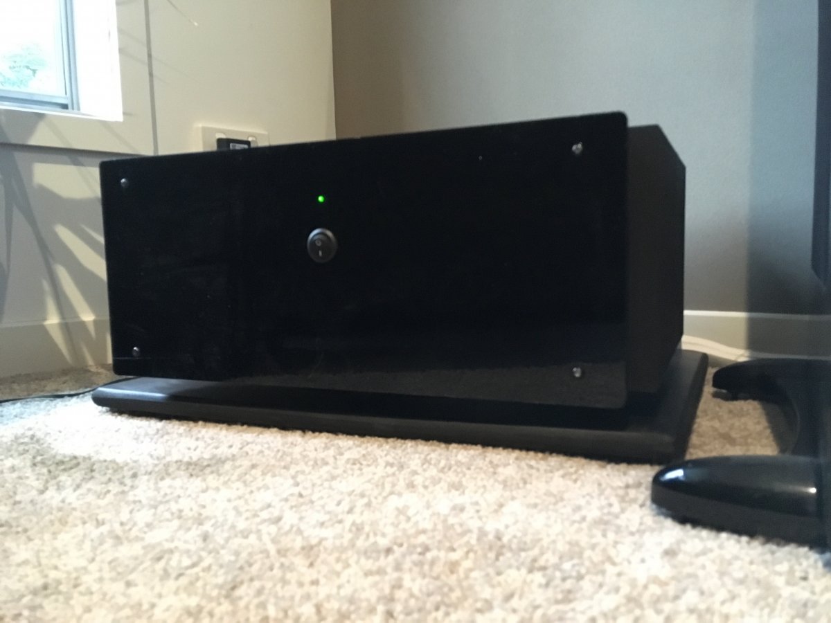

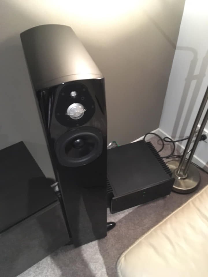

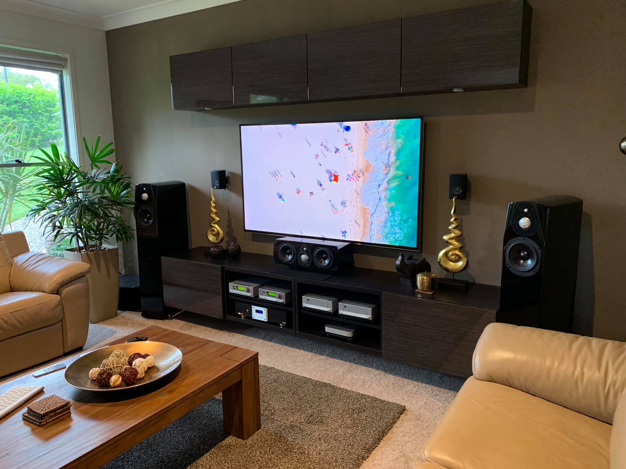

So, my Theta DSPre and Dragons are now listed for sale and I’m definitely focusing on getting the full potential out of my now, combined, home theatre and music system.

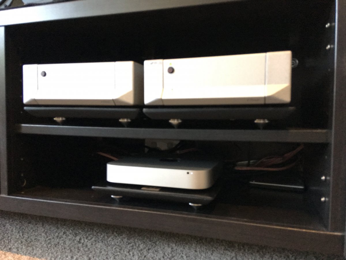

The Benchmark monoblocks have been running for a few days now.

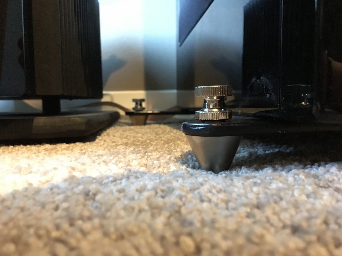

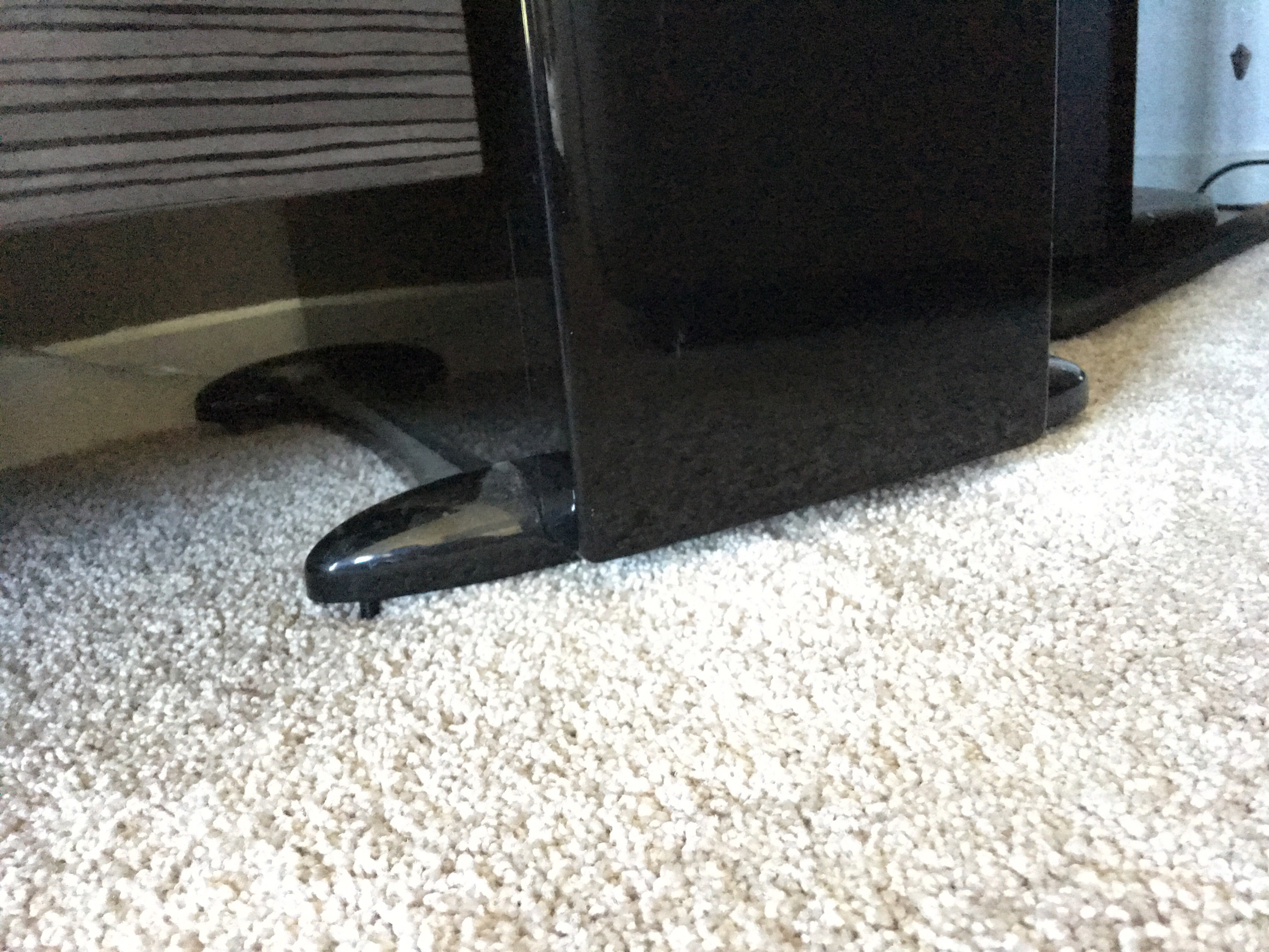

I spiked my two Prolight equipment platforms for use under the amps.
The Classic 4 speakers are performing incredibly well. Their bass is prodigious and so tuneful. It’s amazing what good amplification will do.

The amps and speaker and some of the RCA cables are still on their way but the Nordost Flatline Gold bi-wire speaker cable arrived on Friday. I spent that evening stripping both sides of 96 individual copper conductors. This was for 2 x 1m runs between monoblocks and main speakers and 1.5m from one Cyrus X Power to the centre speaker. As you can see, I don't use banana plugs. Bare wire contacts are free and sound better than any plug.
I've got another 3.5m length aside in my cupboard in case I need it in future...
This is one set of long Nordost Blue Heaven I have and the a 1m run of the Flatline Gold in behind one monoblock.
It offers a significant improvement in tonal differentiation, detail and performer placement over the Nordost 2Flat I had used previously.

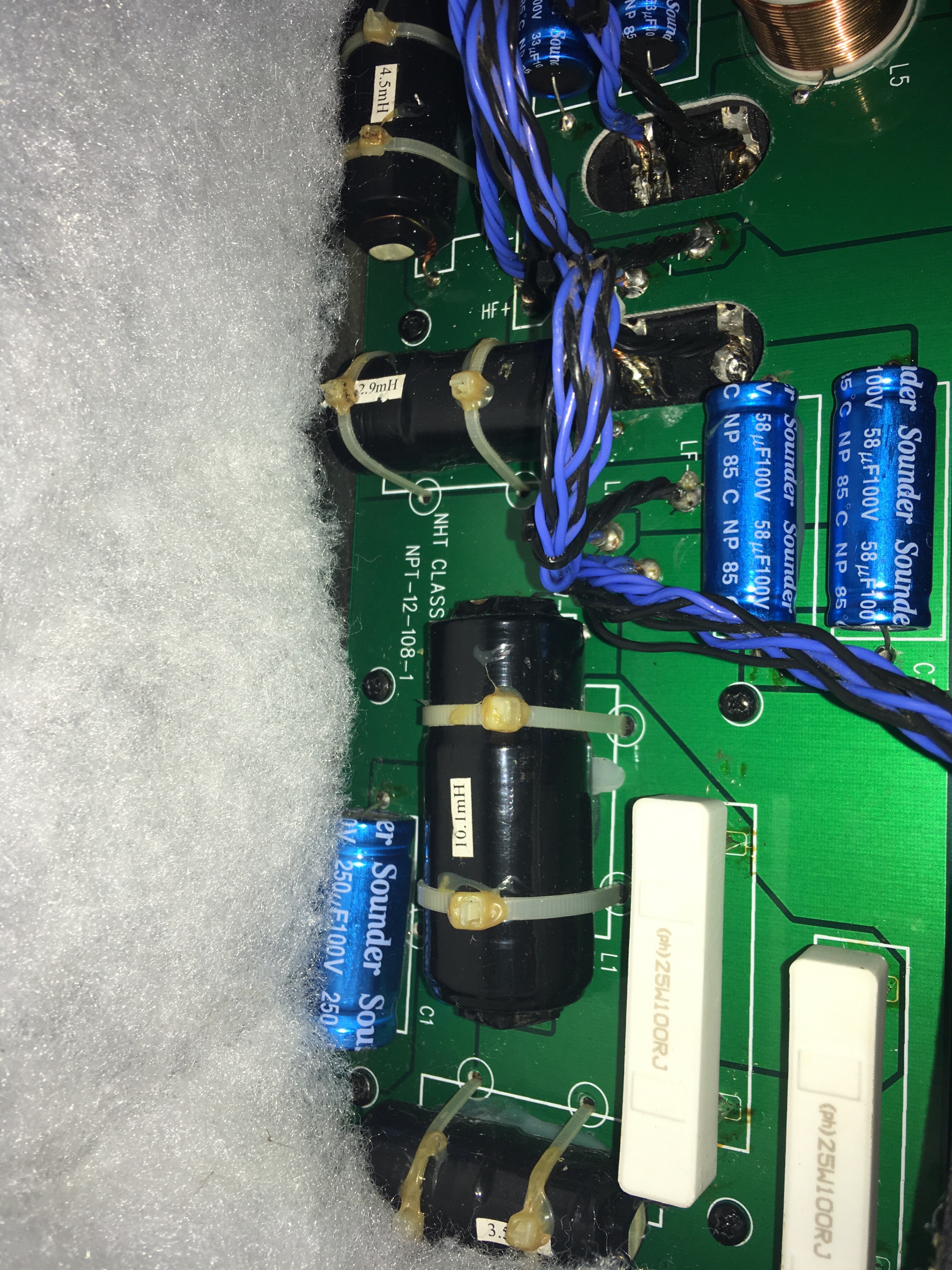

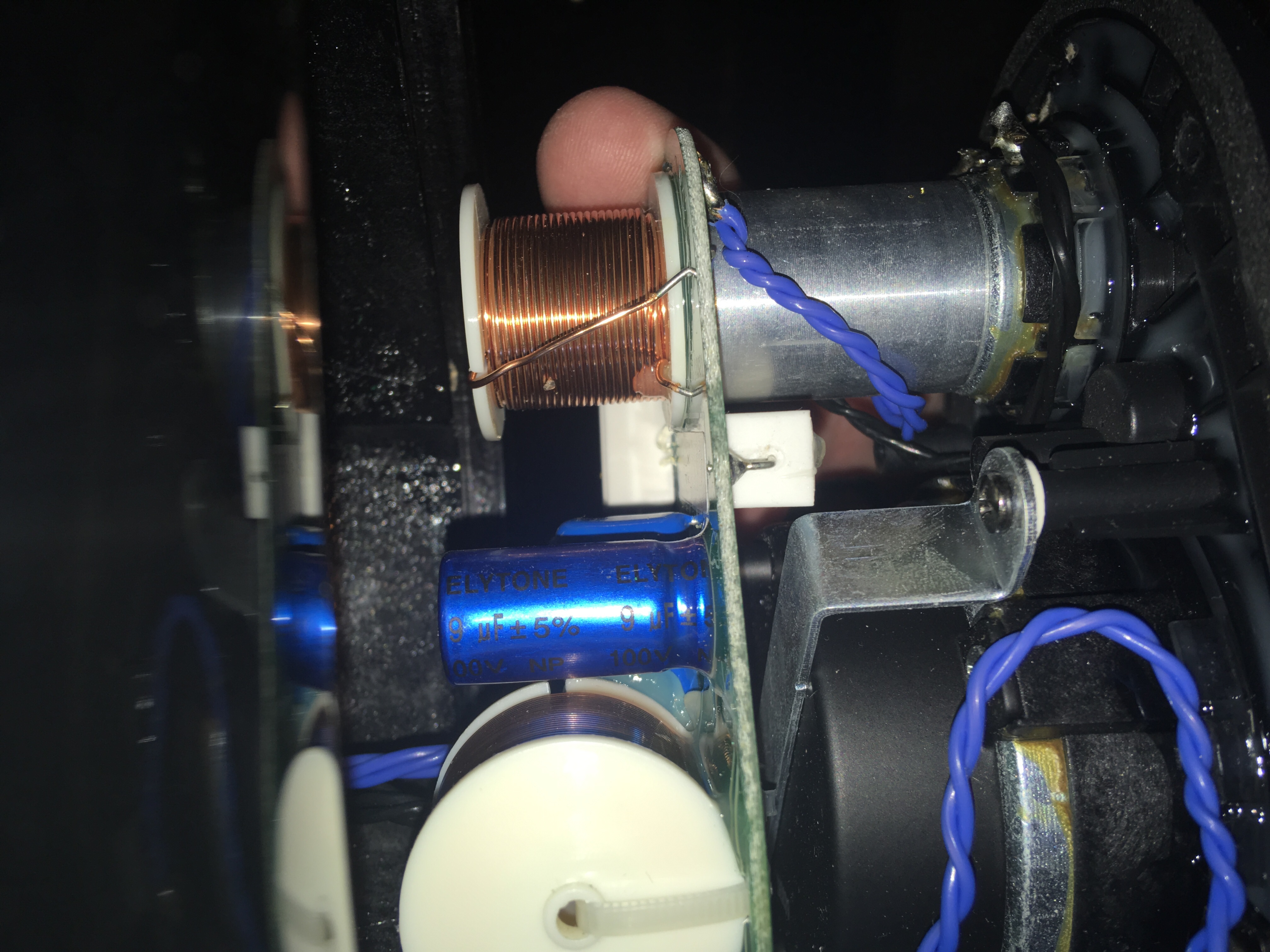

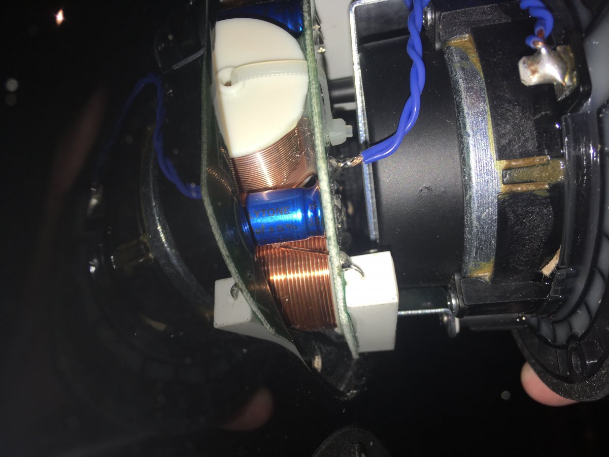

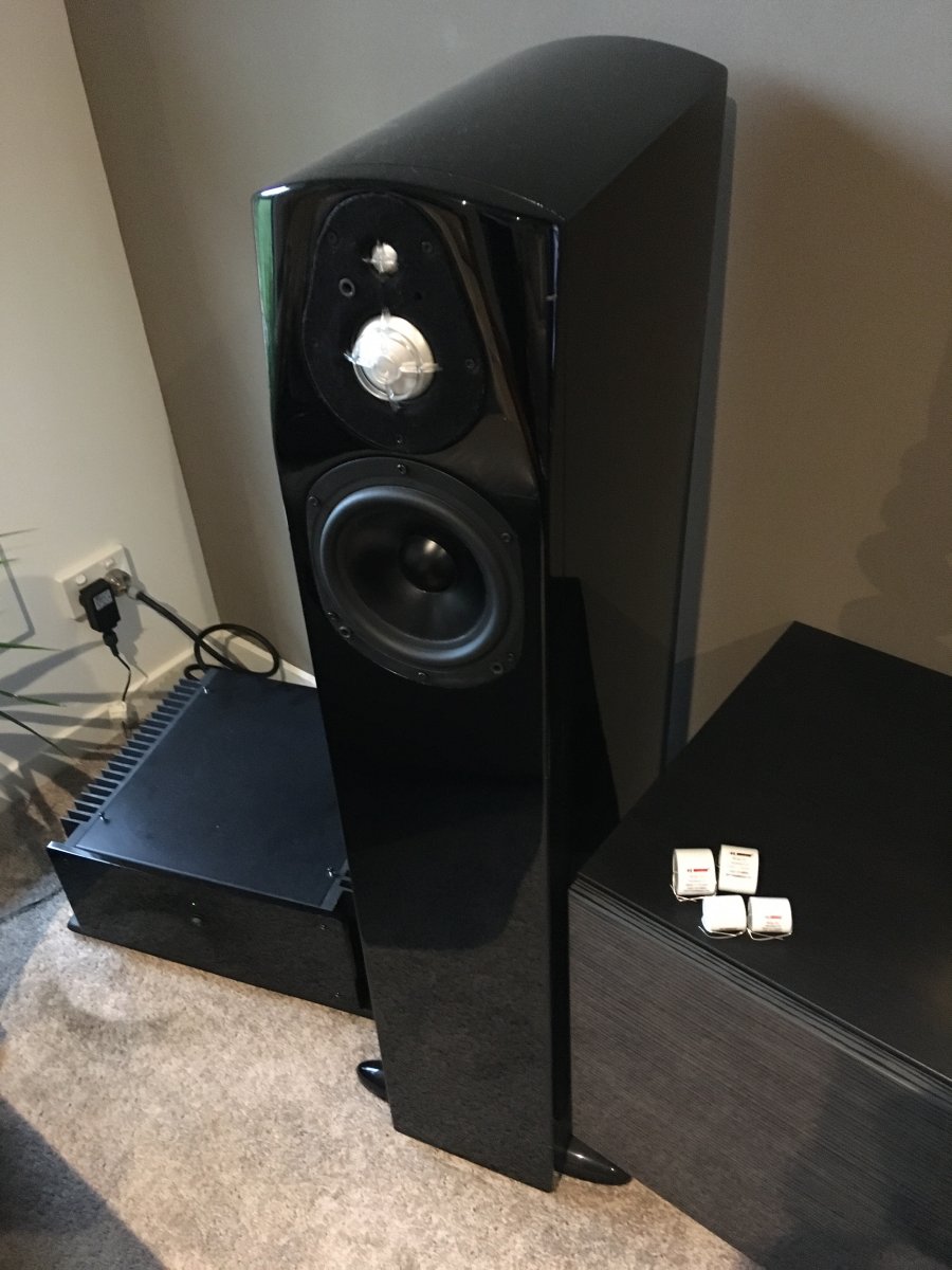

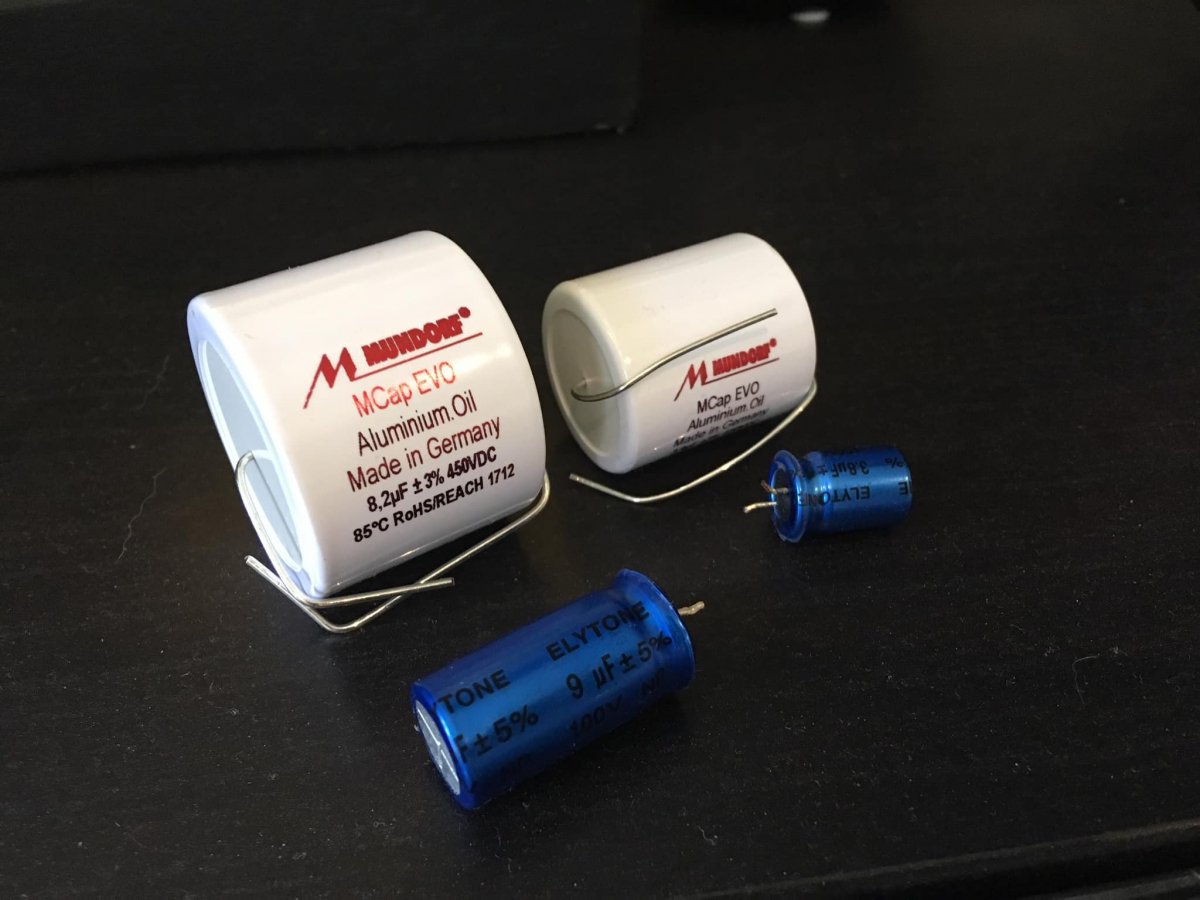

I also committed myself to modding my NHT Classic Four main speakers as so far they had cost me $0 (these were the speakers I found outside a neighbour's house during hard rubbish collection week last year) and they were showing great potential after an internal rewire with Kimber 4TC. Plus, I love their deep and prodigious bass (even when pulled out from the walls). These speakers use a 10" alloy woofer in each speaker and they have a large flared rectangular port at the bottom of the rear baffle which means I have not missed my ported sub.
Yesterday I decided to remove the factory crossover electrolytic capacitors for the midrange and tweeter and replace them with Mundorf's new Aluminium metalized polypropylene and oil caps.
I was expecting improvements to the sound based on previous improvements I'd made with standard Mundorf M-Caps in my Aurum Cantus Leisure 2 SE. These were a new cap though and so I wasn’t sure what to expect.
Not ideal speaker placement as the room and floating cupboards were originally planned around the little Canton satellites on the walls. The next house/unit/apartment will be much more conducive to better placement.
3.jpg.f65bd0f4e17c6f40f051d943113f2151.jpg   4.thumb.jpg.9ddbcdfa86720fb65b2ca85ff7b78e95.jpg
I may yet source a 0.8uF cap to parallel the 8.2 to better value match new vs factory. I figured given the tolerances between new and old could negate any real need for an absolute match. We'll see...
I’ll admit to some disappointment when I first powered things back up - the stage was vague and performers were well back from the plain of the speakers compared to before this mod. It was almost as if the performers were getting lost in the mix. It was a bit of a mess.
I left them playing some jazz and we went out for a few hours. When we returned, imaging had improved significantly and performers were in greater relief against their background. These speakers never had a harsh midrange and treble sound but now the sound is liquid and delicate and layered and clear.
Today the fruits are slowly revealing even more of themselves further and I’m liking it very much. Lead performers are back at the front of the stage and stand out more clearly from the back ground. The stage is also much deeper, in fact, almost cavernous. The wall behind the speakers has disappeared.
Word has it these caps need many more hours on them yet and so I am sure nuances will continue to show as time goes on.
I'll move onto doing the cap(s) for the midbasses next and will probably leave things at that as far as cross overs go. I also have some 6mm galvanised steel stock, alloy cone footers, metal thread inserts and stainless spikes I'll use to make up wider rear outrigger feet/supports and spike directly into the cabinets at the front. The factory supplied outrigger feet do quite a poor job at stabilising the speaker as they're plastic and flexible.

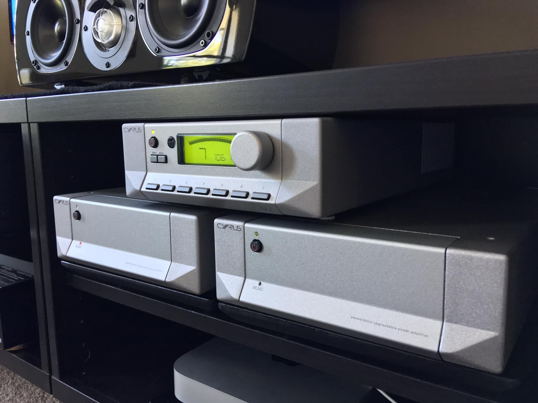

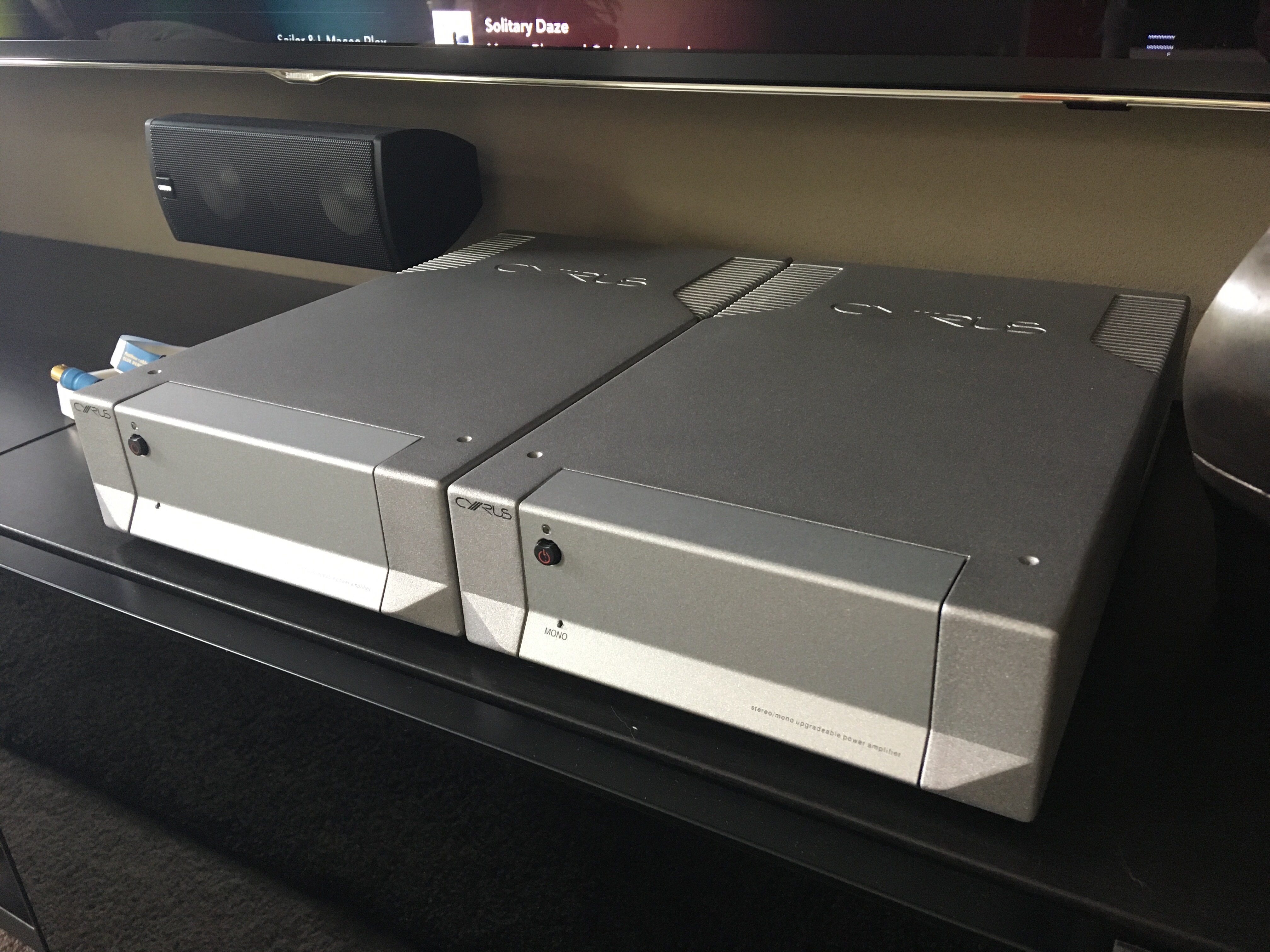

On other matters, some more toys turned up today.

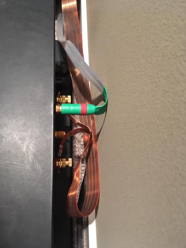

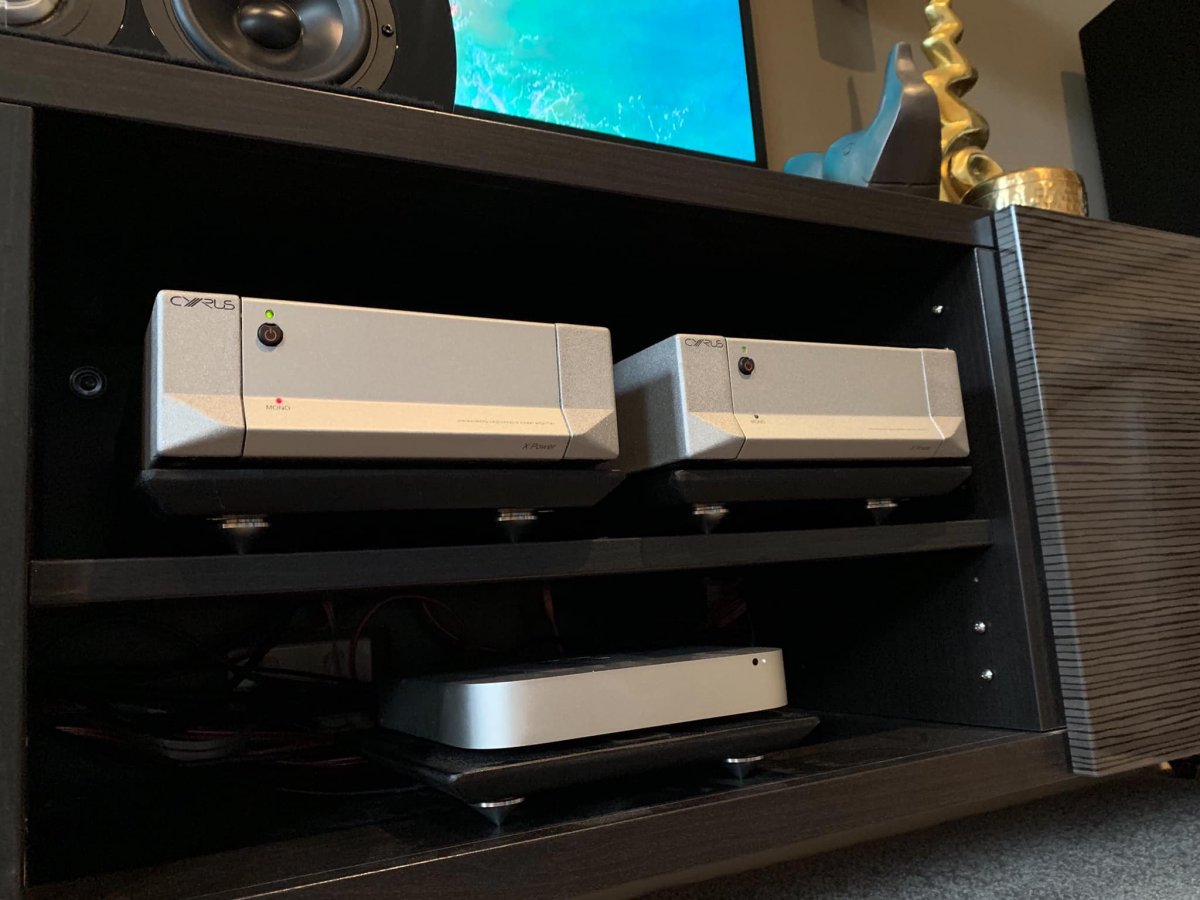

Two Cyrus X Power power amps; One for the centre channel (will be bridged for this) and the other for rear stage. These were cheaper than a couple of Nuforce STA-100 power amps I was going to grab and they are bridgeable (the STAs aren’t).
My family used the distribute Cyrus in Vic in the 80’s/90’s, I’ve sold Cyrus at retail and even tried it in my home in the past but this is the first product of the brand I have actually purchased for my own use. It’s a shame they’re not for my front main L&R channels but I don’t think they’ll come close to outperforming the Benchmarks.
I’m running Nordost Blue Heaven interconnects for all three front channels. These turned up y’day for the centre.
I’m just waiting on some Flatline Golds for the rear channels to turn up now.

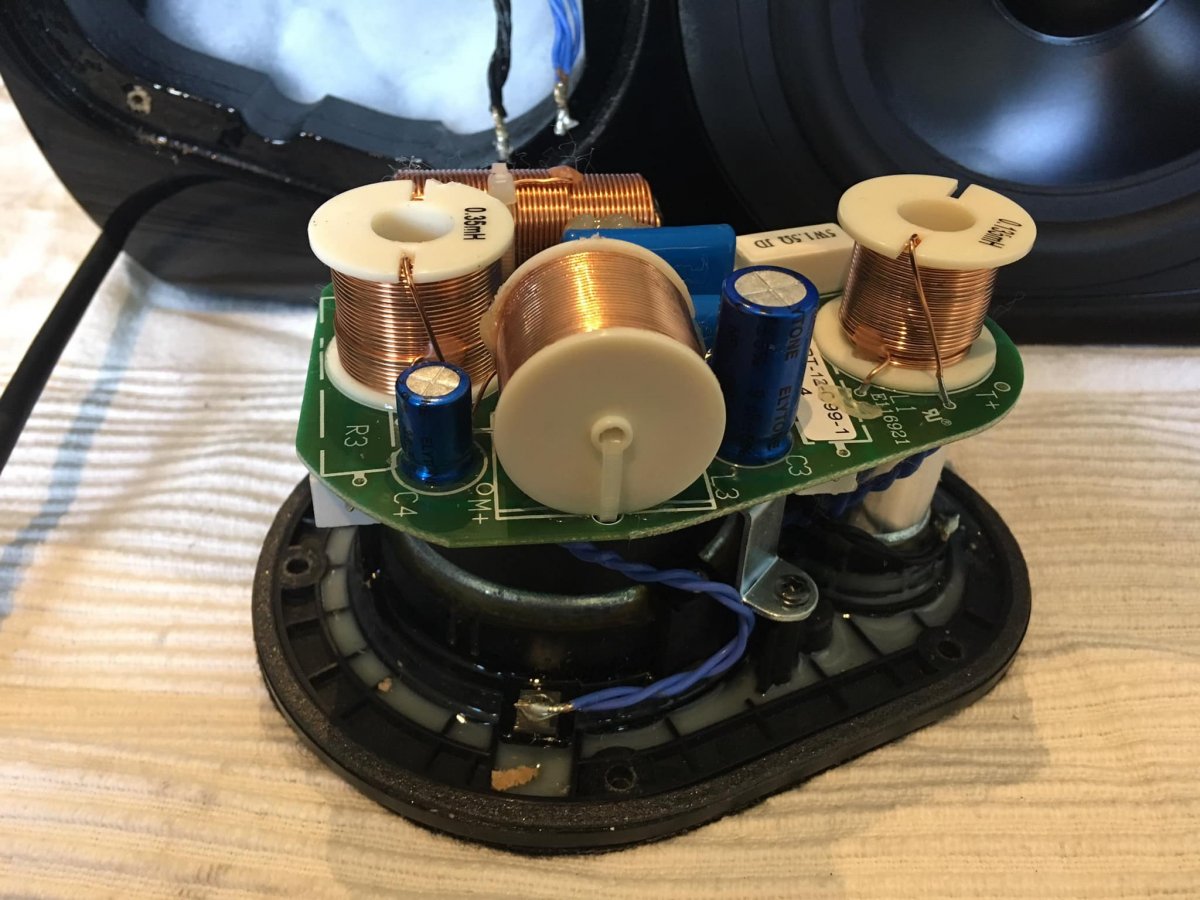

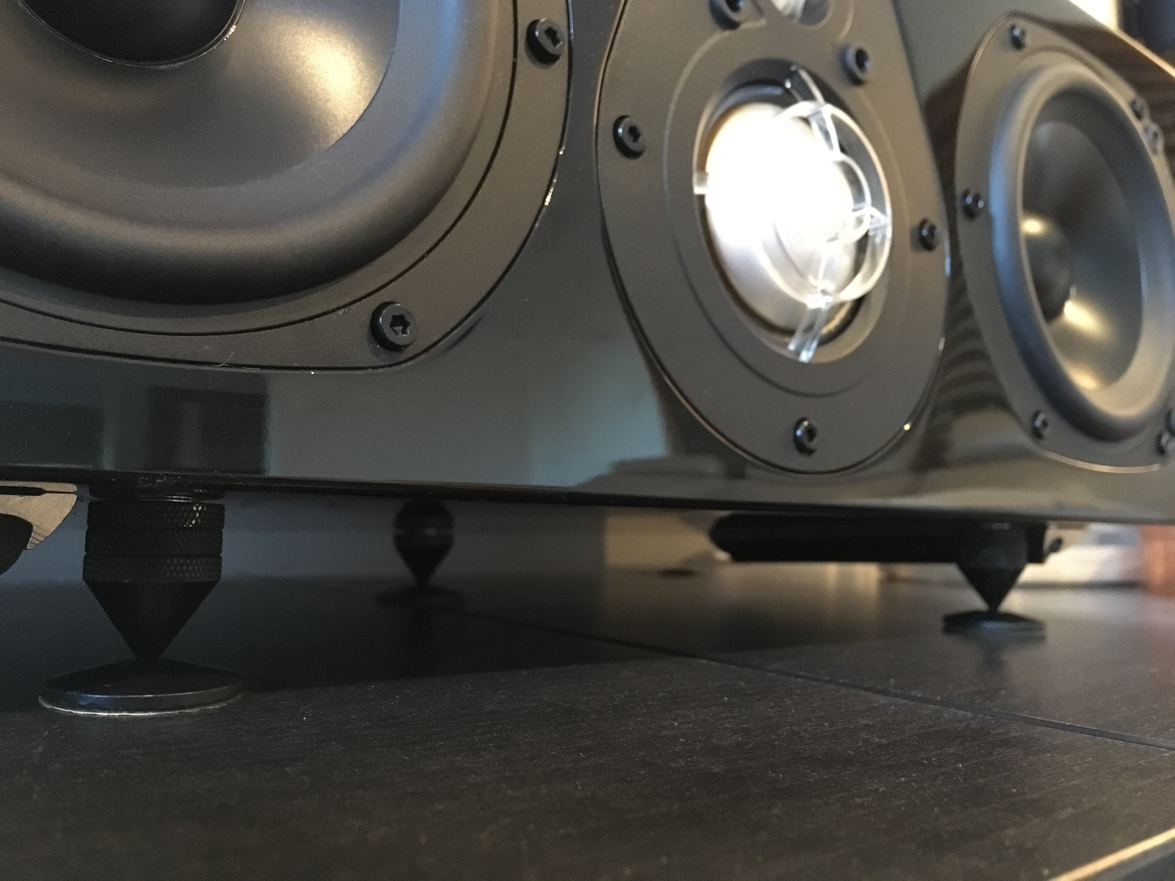

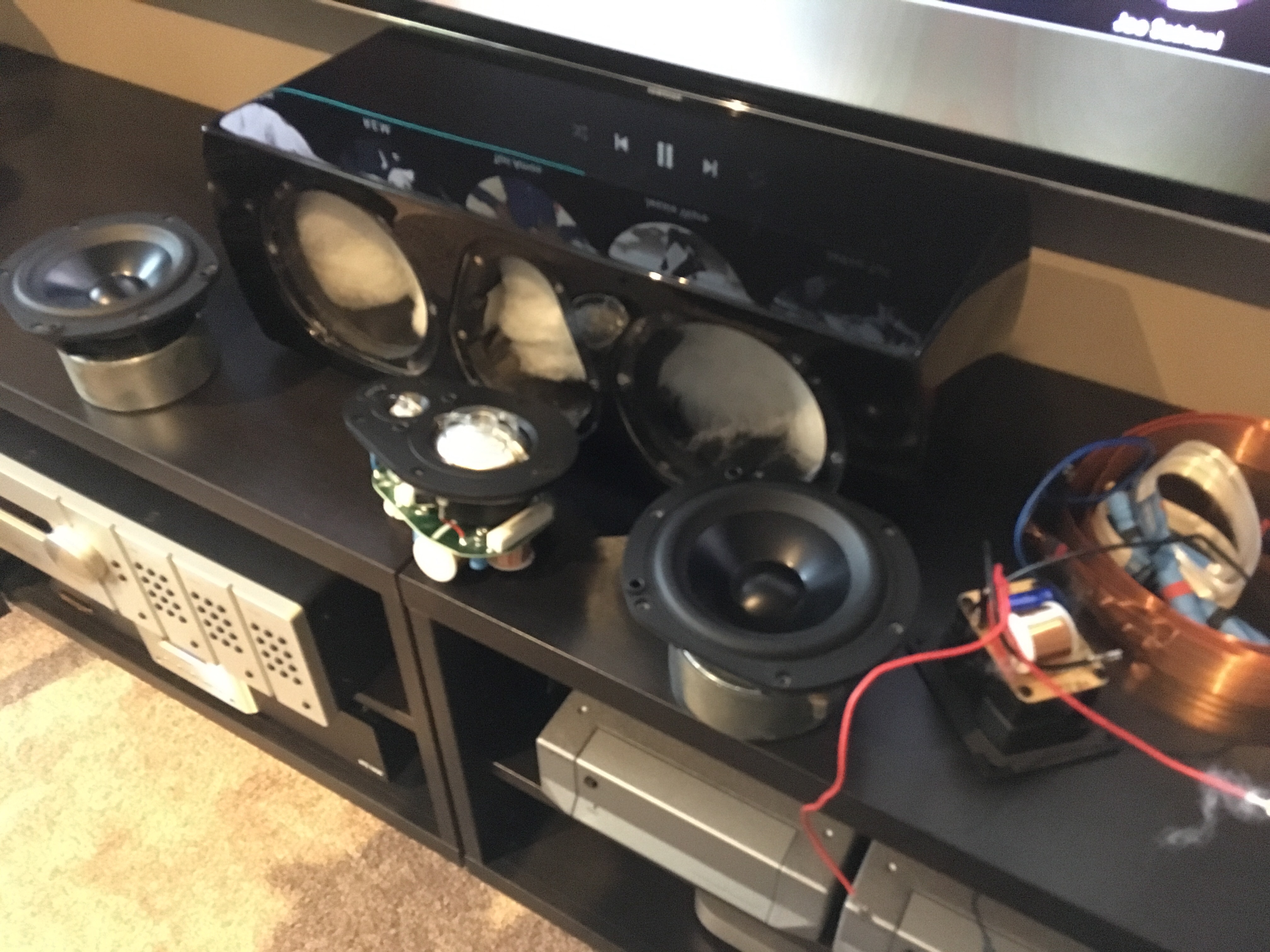

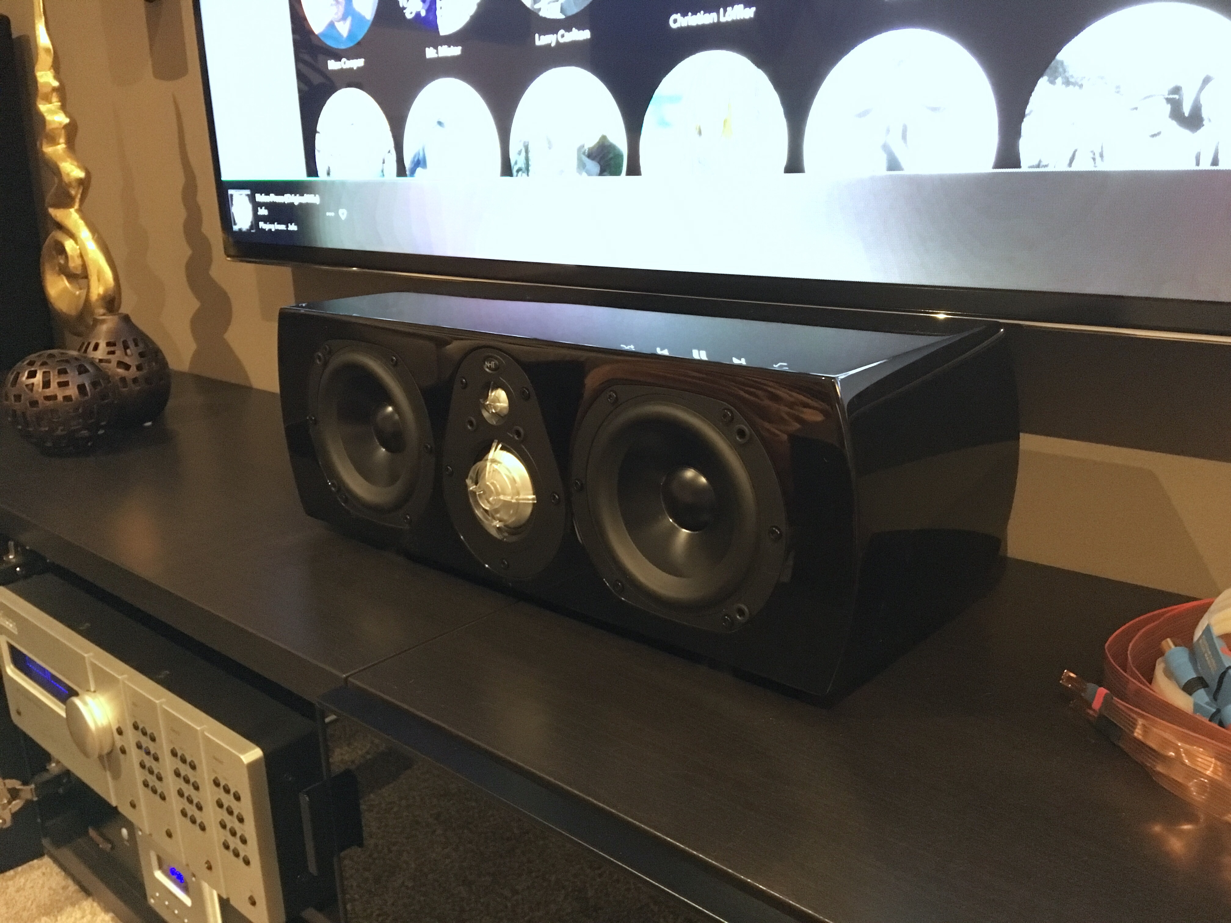

A key part of my system turned up today - the NHT Classic Two C centre channel speaker.
I would have loved a 3C as the drivers are all a perfect match to those in the Classic Four towers I have but this one was BNIB and cheaper than a used 3C if one was was available to me on the used market. I still end up with alloy mid bass drivers and the all important matching tweeter/mid pod.
It was out of its box no longer than 30 minutes though and this happened...
I’ll pull out my spare Kimber 4TC tonight and order replacement Mundorf caps this weekend for an upgrade of internals.

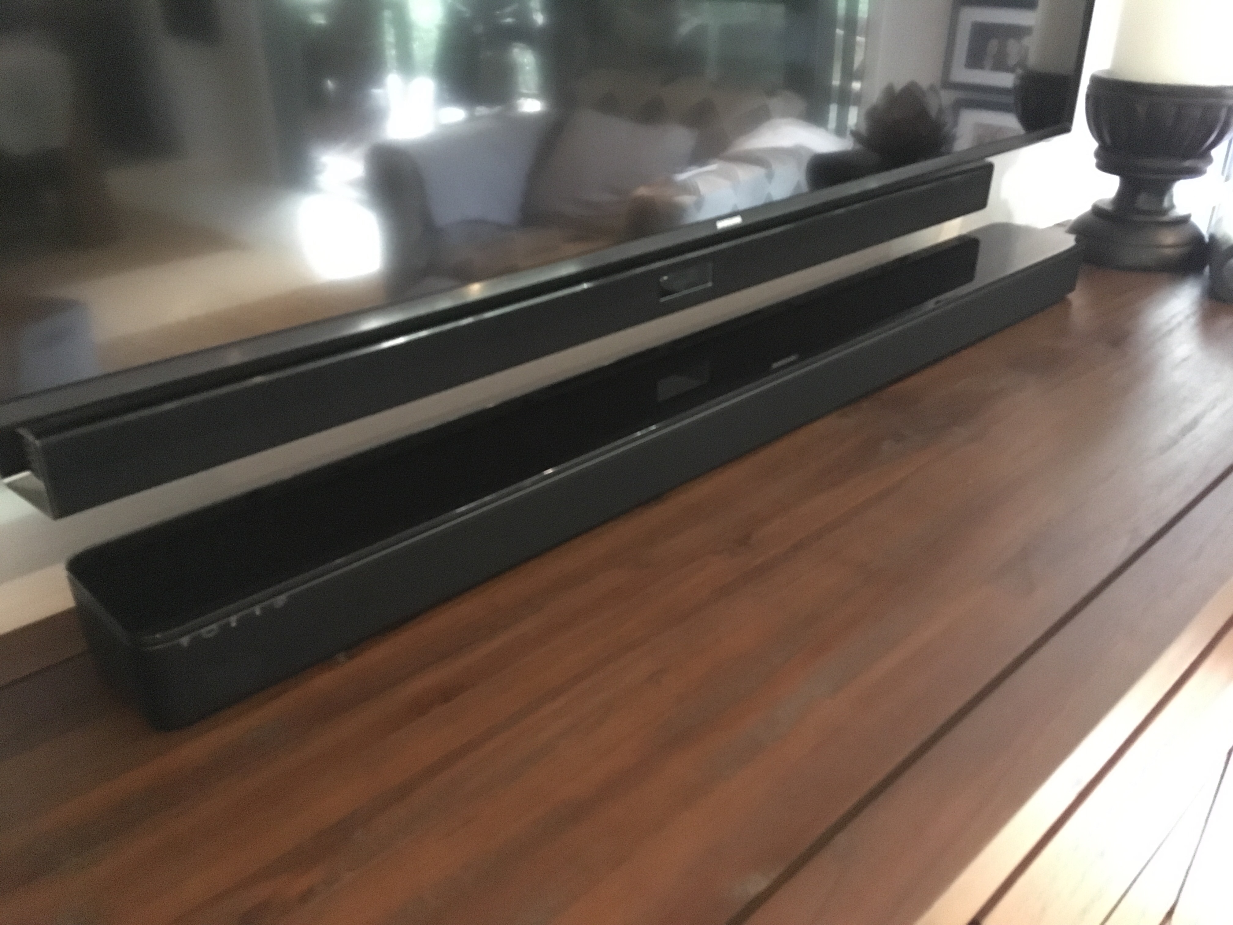

Over in the family/dining room, the wireless connection between our little Samsung soundbar and its matching sub had stopped working. With only the soundbar working, the sound was not much better than just using the TV’s speakers.
So, I arranged for this to turn up today;
It’s a Bose SoundTouch 300 soundbar. They sound very good as is (much better than the Samsung even when it’s sub worked) but when funds permit and the right deal comes along, I’ll grab the matching Acoustimas 300 wireless sub.
So this weekend I’ll be rewiring the centre and wall mounting the Bose.

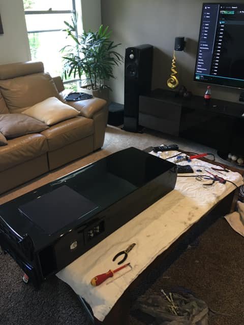

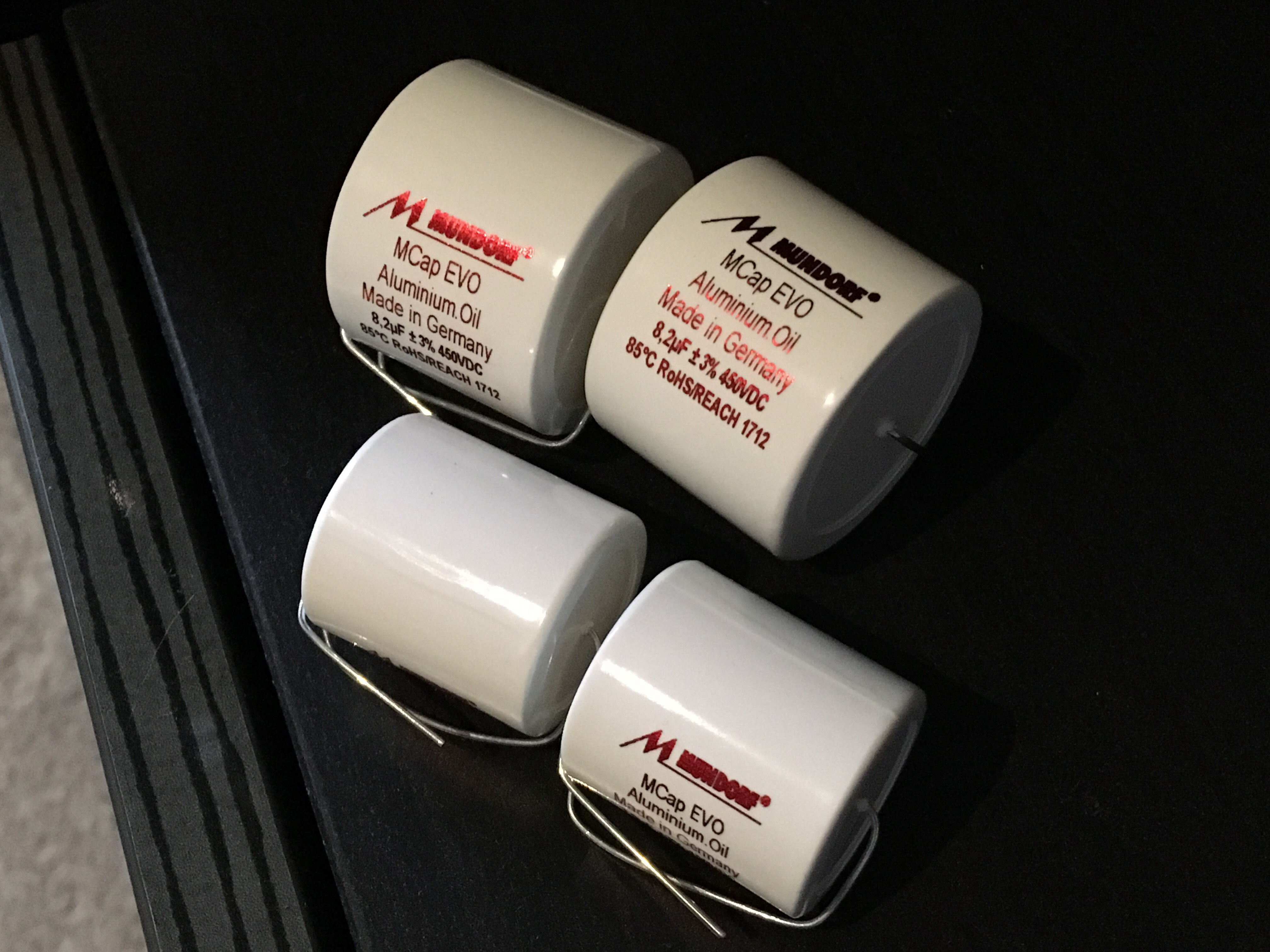

I just finished re-capping this puppy tonight. All caps were replaced with Mundorf M-Cap Evo Oil for mid/tweeter pod and standard M-Cap with Evo bypass on woofers. Thanks goes to Soundlabs Group in Sydney for good pricing, good stock and quick shipping.
This is a sealed centre but it can certainly kick and it goes low. I’m quite impressed and it’s not even run in yet.

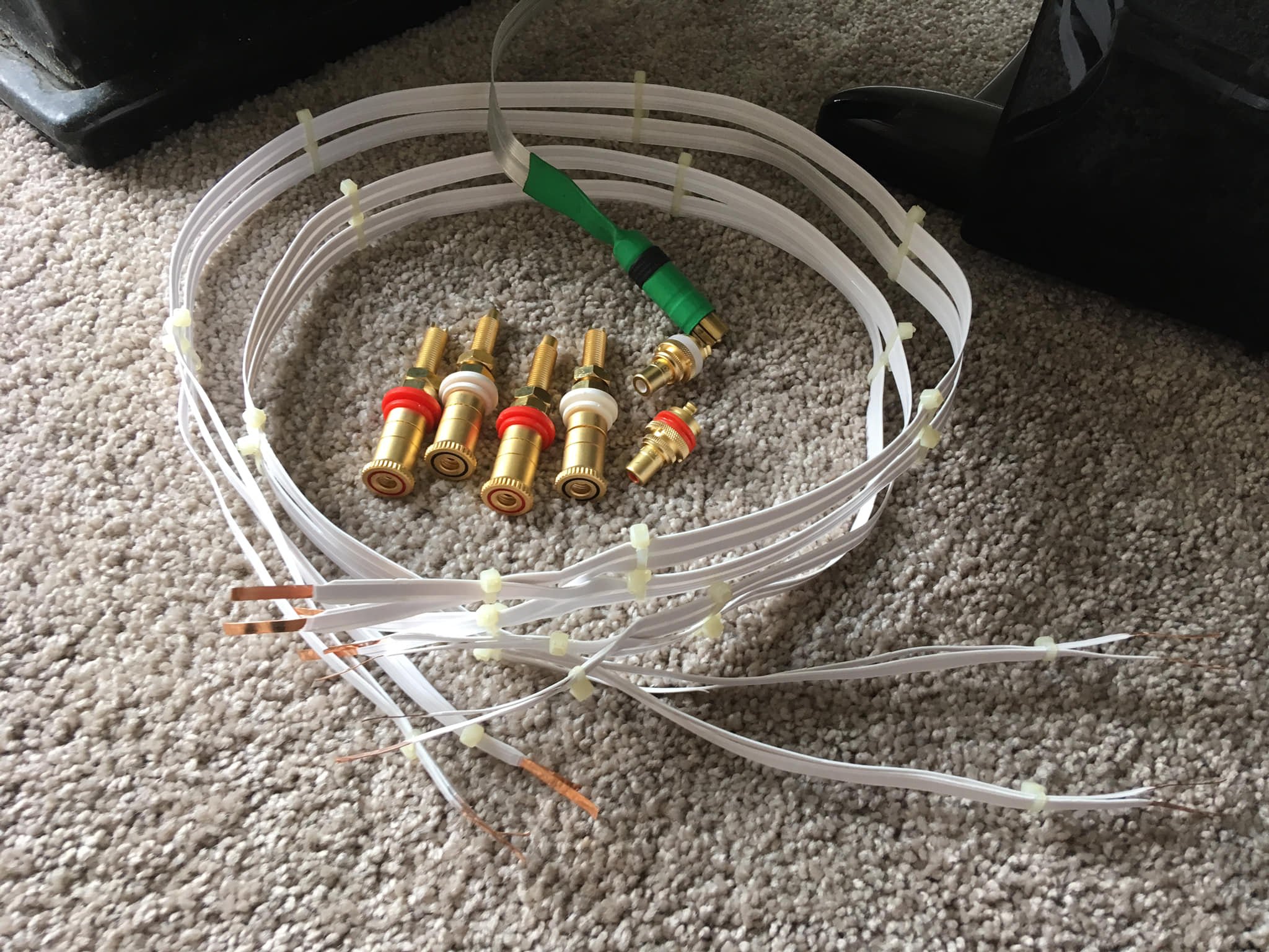

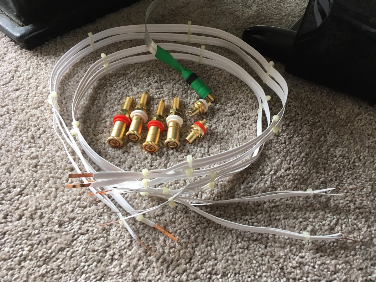

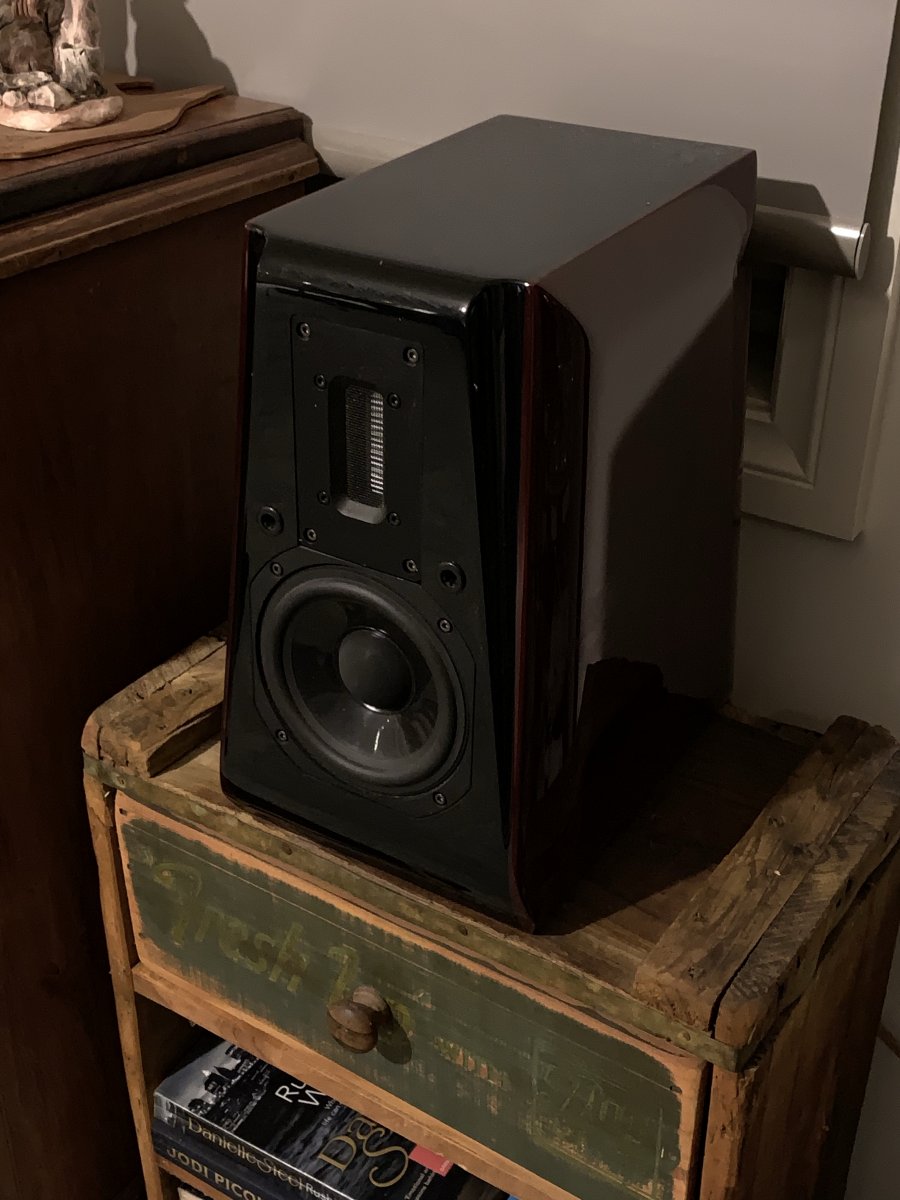

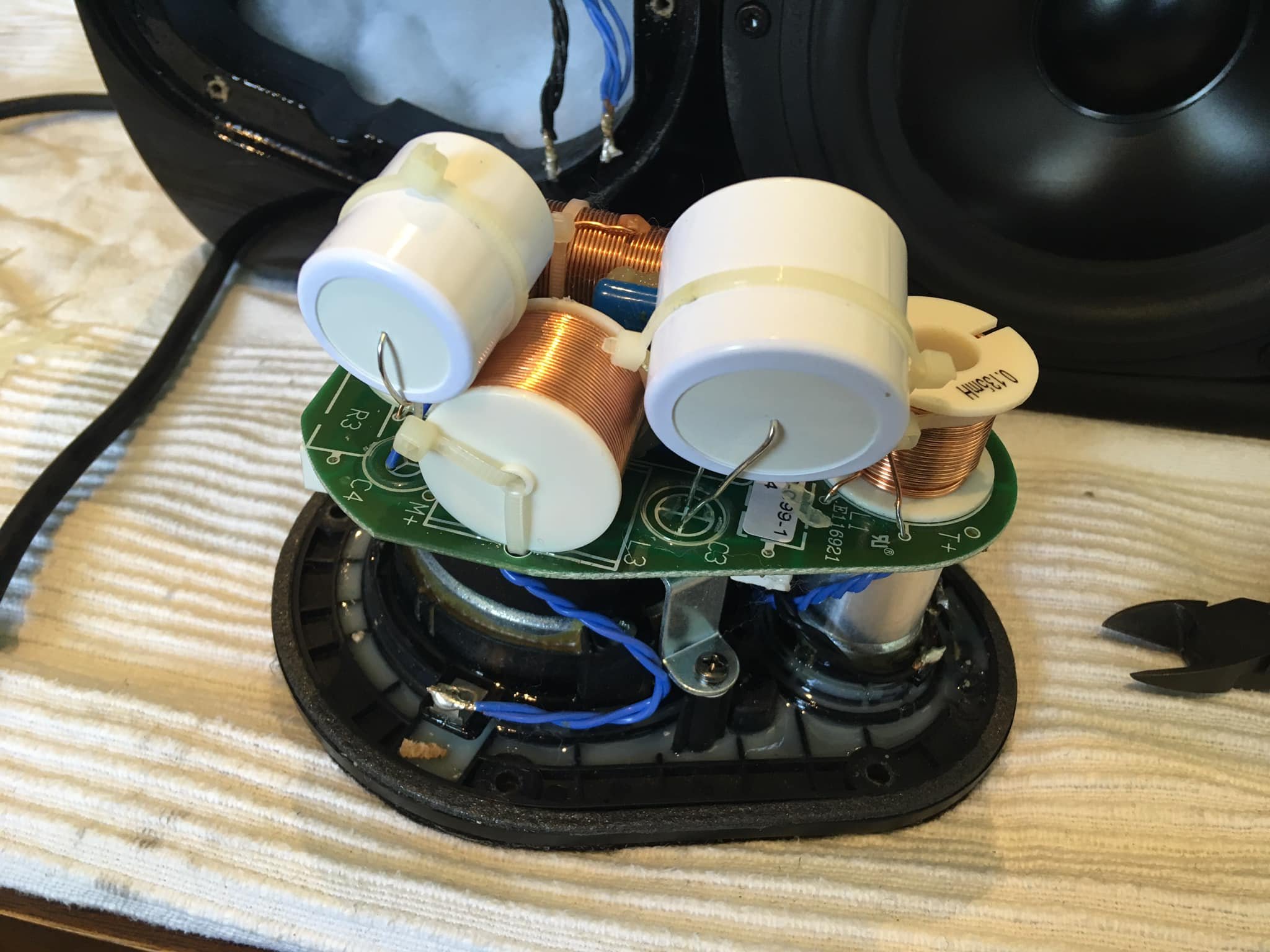

With the caps and cables in my main and centre speakers replaced, I needed another little project.
I decided to replace these
with these
I cut and shaped the 6mm steel bar myself and the cones are nickel plated brass from Dayton Audio.
They are much less flexy than the factory two piece plastic ones. They’re also wider.
I have some nice knurled and nickel plated thumb nuts and threaded spacers coming for the tops.
Edited by Winno

I finished the outrigger feet for my NHT Classic Fours y’day.
I prefer the look when compared to the factory supplied feet but, my goodness they improve the sound significantly.
The factory feet are some sort of plastic with M4 spikes and come in two pieces. Getting the speakers coupled to the floor properly with no wobble was difficult with them. These speakers are heavy and it was difficult to tell if any wobble was due to foot flex or if a spike needed adjustment.
With the new feet and large brass cones, the speakers are locked solid in place now with noticeable improvements across the whole audio band.
Today I took a few minutes to also spike my centre speaker with some spare brass cones. These screw into countersunk metal threads.
This is a brand new speaker so taking a drill to the lovely gloss lacquer on them was a little daunting. Still, the insides have already been well tweaked so why not.

Next project;
Rough cut and beveled Prolight and Corelight boards.
More to come...

My little platform project is done. I now have these under all my electronics, including the Benchmark monos (the monos have longer stainless spikes on them as they need to pierce thick carpet)
This was a low-teck project that raised the level of performance of my Theta preamp some months ago when I made my first platform.

The newest edition to the system; a Cyrus FM X tuner.
I listen to a couple of classical music stations sometimes when I'm driving and thought it would be nice to have FM at home again. I made sure to connect it to the roof-top antenna and the results are fantastic. It's another eBay purchase and for $180 with pick up a couple of suburbs away, why not?

  • Author
Update;
Lexicon is gone (into a box in the garage).
Cyrus AV Master 8 is in.
57338887_10217839580997856_6756408041110765568_o.thumb.jpg.3a5cb031a1683a5df801889f11f25551.jpg
56685640_10217839579837827_226383426909896704_o.thumb.jpg.2c3100850b932086ed0c02b52f9d2a58.jpg
57104193_10217839580037832_7774967901953458176_o.thumb.jpg.b31da52aebbb6913c85227dc8e48abaf.jpg
The aesthetic is important to me and there's no denying the four Cyrus shoe boxes look better than the mix I had previously.
Performance wise, the Lexicon was better - more transparent and a little more dynamic. But, I have plans to grab a Cyrus DAC XP preamp at some stage and it'll integrate nicely with the AVM8 and provide a significant improvement for 2 channel listening.
I still have my Benchmark monoblocks in the front corners of the room. They're lovely and have endless amounts of power. It will take at least a set of Cyrus X300 monos ($$$) to better them (maybe) but that will have to wait for now as discretionary spending is delayed until after the house is sold.

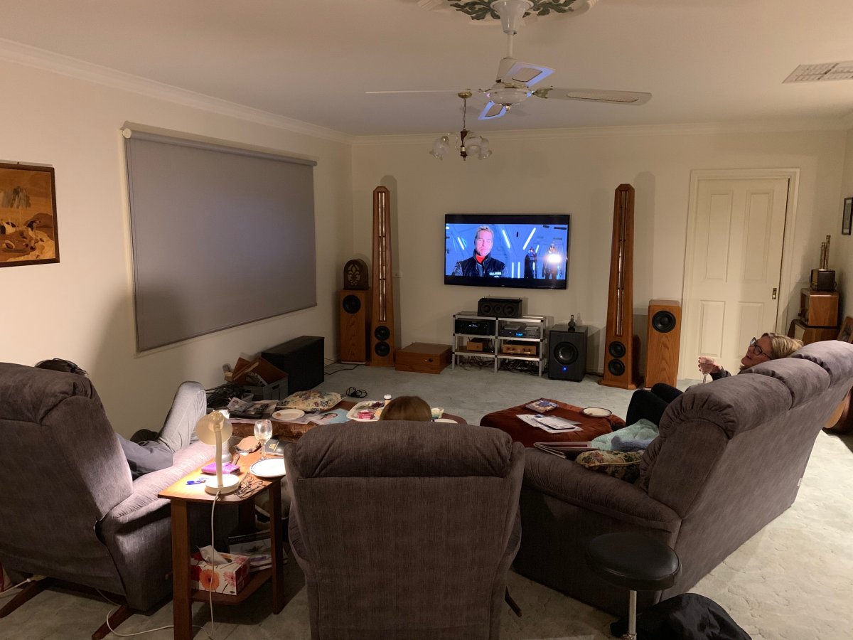

I flew down to Bendigo in sunny Victoria late last night and spent this afternoon wiring up some of my father’s eclectic collection of audio gear.
Sources are Cambridge Audio DVD player and Apple TV.
Processing is a Marantz SR6005 receiver.
This outputs main left/right to a custom made 2 box valve pre which was made in Tassie.
The speakers are 6.5’ hybrid ribbons/dual 6.5” mids . The woofers are 2 x dual 8” dipole transmission line enclosures.
Power amplification for the mains is DC battery powered with active cross overs. The Marantz powers the centre and rears (Aurum Cantu’s Leisure IISE).
A couple of spare Redgum power amps may be swapped in to power centre and rears shortly.
The centre and sub are garage sale specials. They’ll do for now.
The room is 12m x 5m and the system sounds absolutely fabulous.
