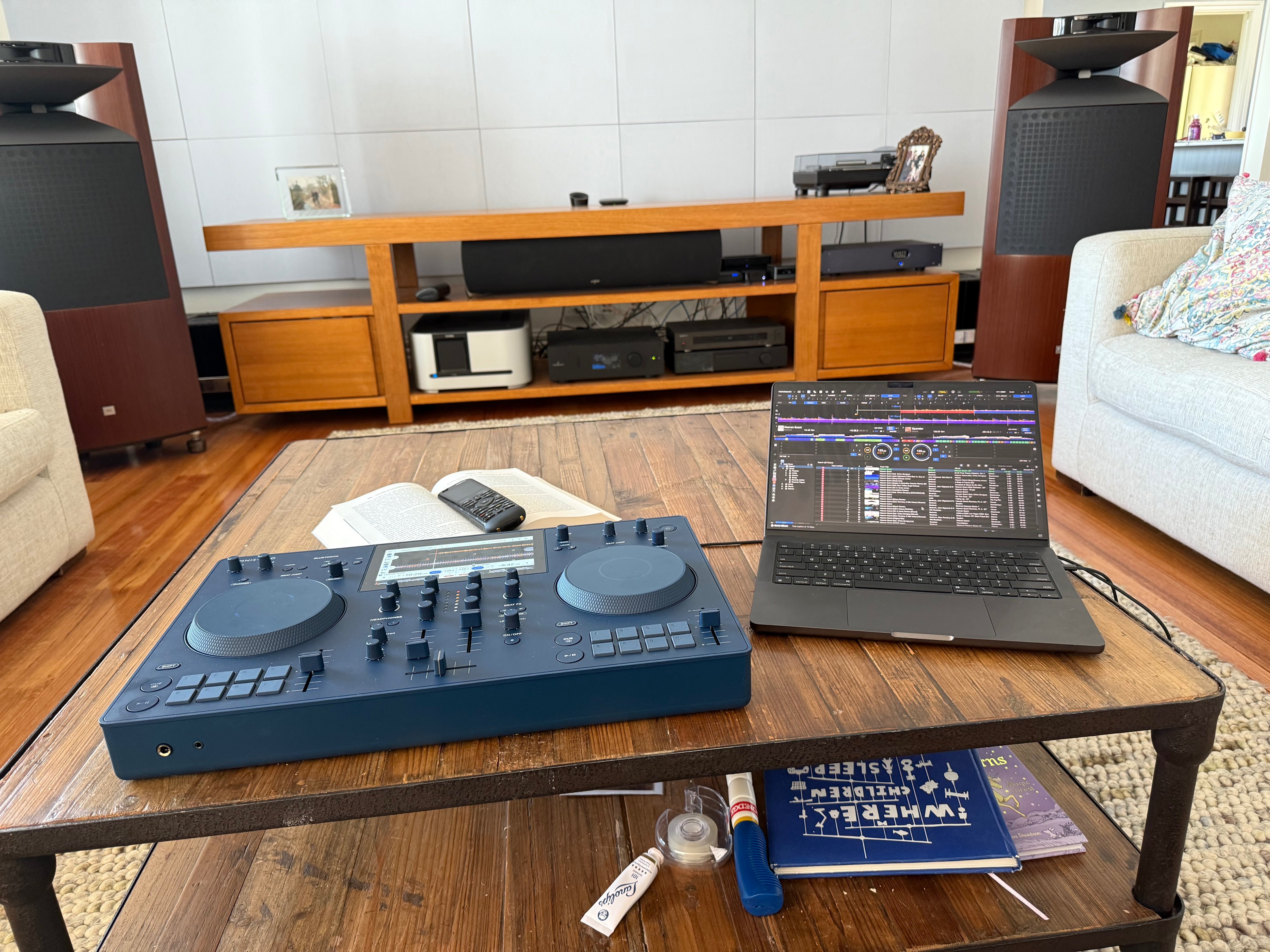

BugPowderDust Posted Friday at 11:53 PM Posted Friday at 11:53 PM Not quite what the OP was discussing, but Rekordbox‘s latest release now supports Apple Music alongside beatport, Soundcloud and Tidal as streaming sources for DJ work. Tracks can now be loaded into relordbox over the air, analysed, tempo, key and phrase sliced for mixing. i recently bought an alpha theta omnis duo and have it hooked up to my system via Bluetooth for a totally wireless and battery powered dj setup for my lounge room. It works surprisingly well. There's a little bit of latency if mixing without phones, but totally manageable. Not having to run xlrs out from my main system over the floor makes this a whole lot more likely to be used on an ad hoc basis. It's got about 6 hours battery life and my laptop has 10 so very functional. Late night lounge room dancing sessions will now evolve to a whole new level 1 2
