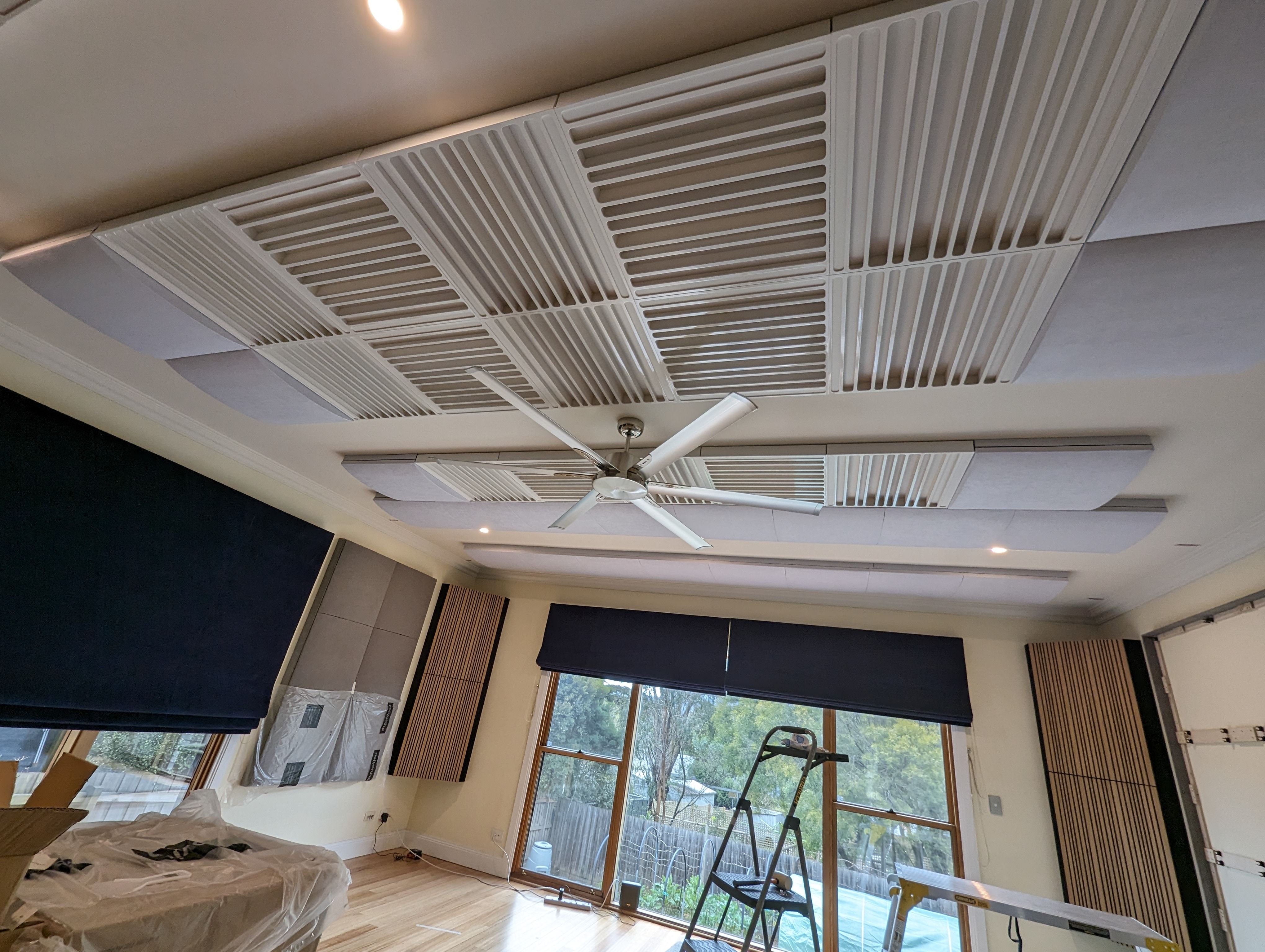

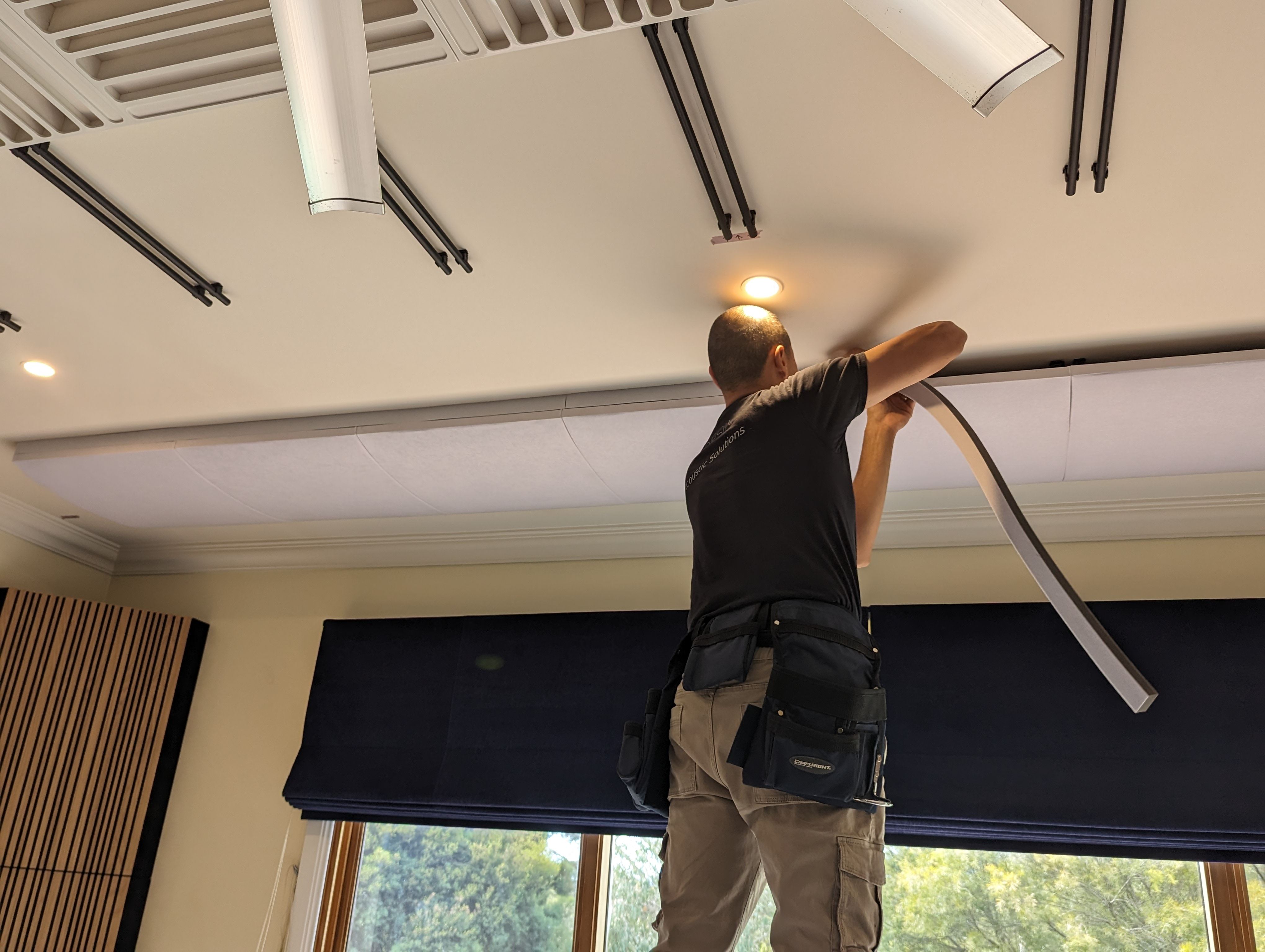

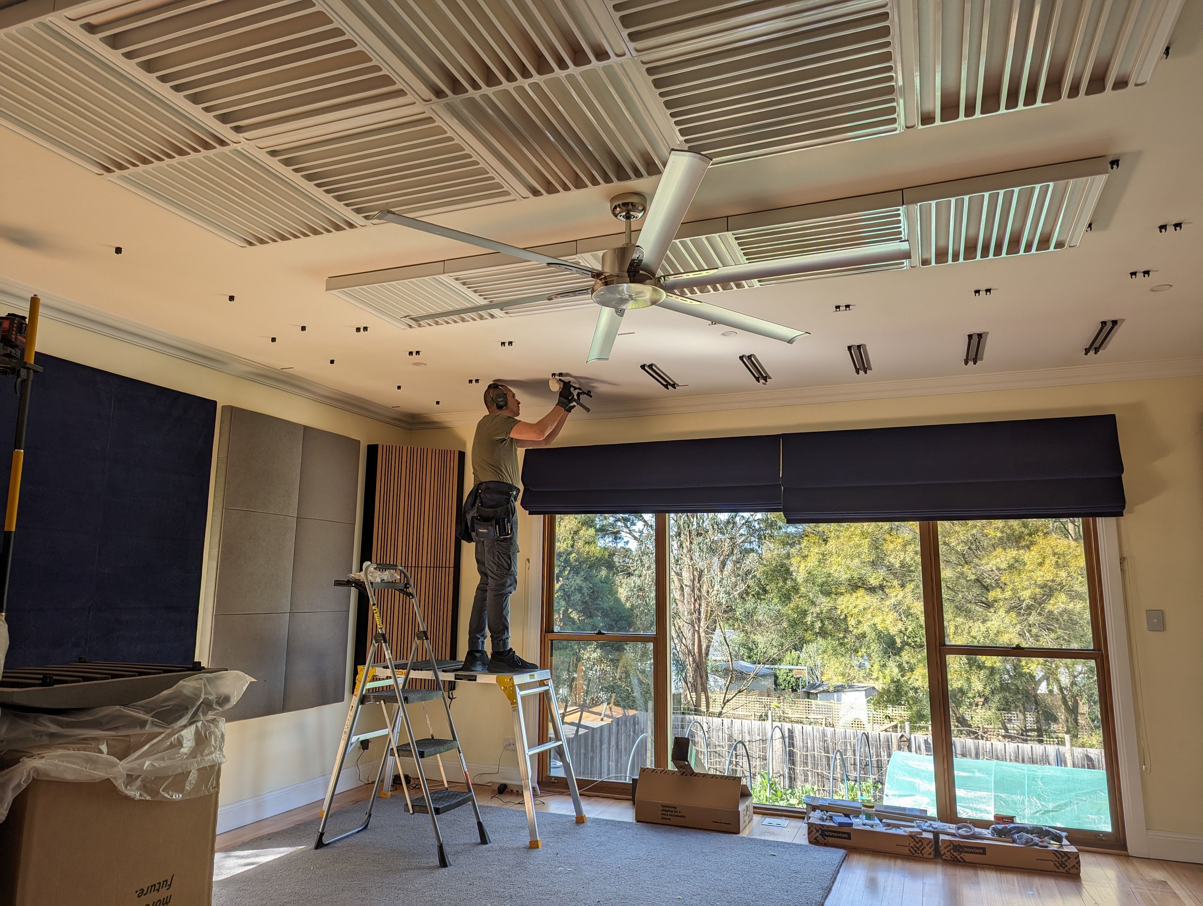

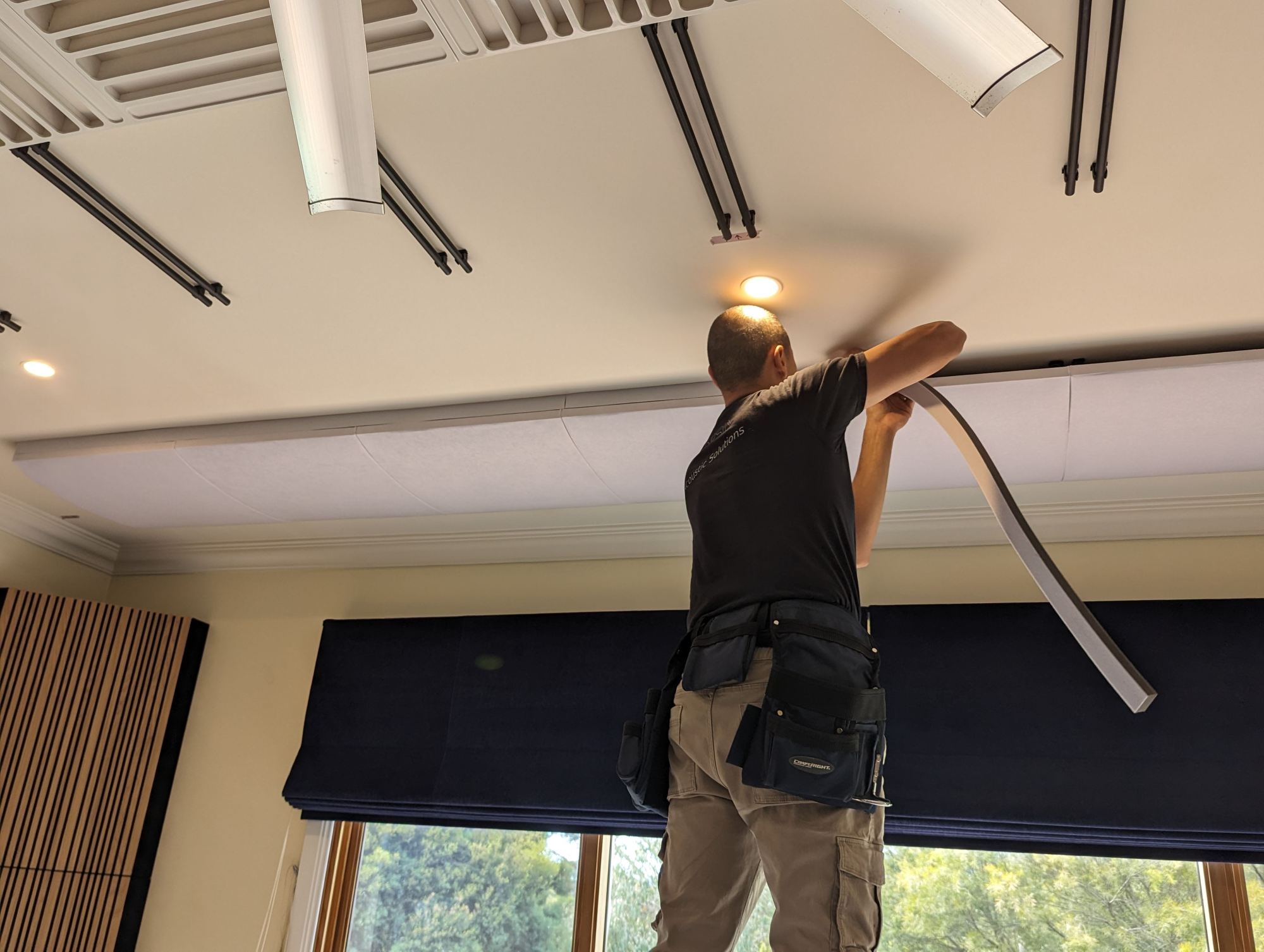

Sorry for the delay. It's been mental the last few days with having to go for bone density scans and other leg-related stuff, so I haven't been able to do interim updates on Christian's installation work.

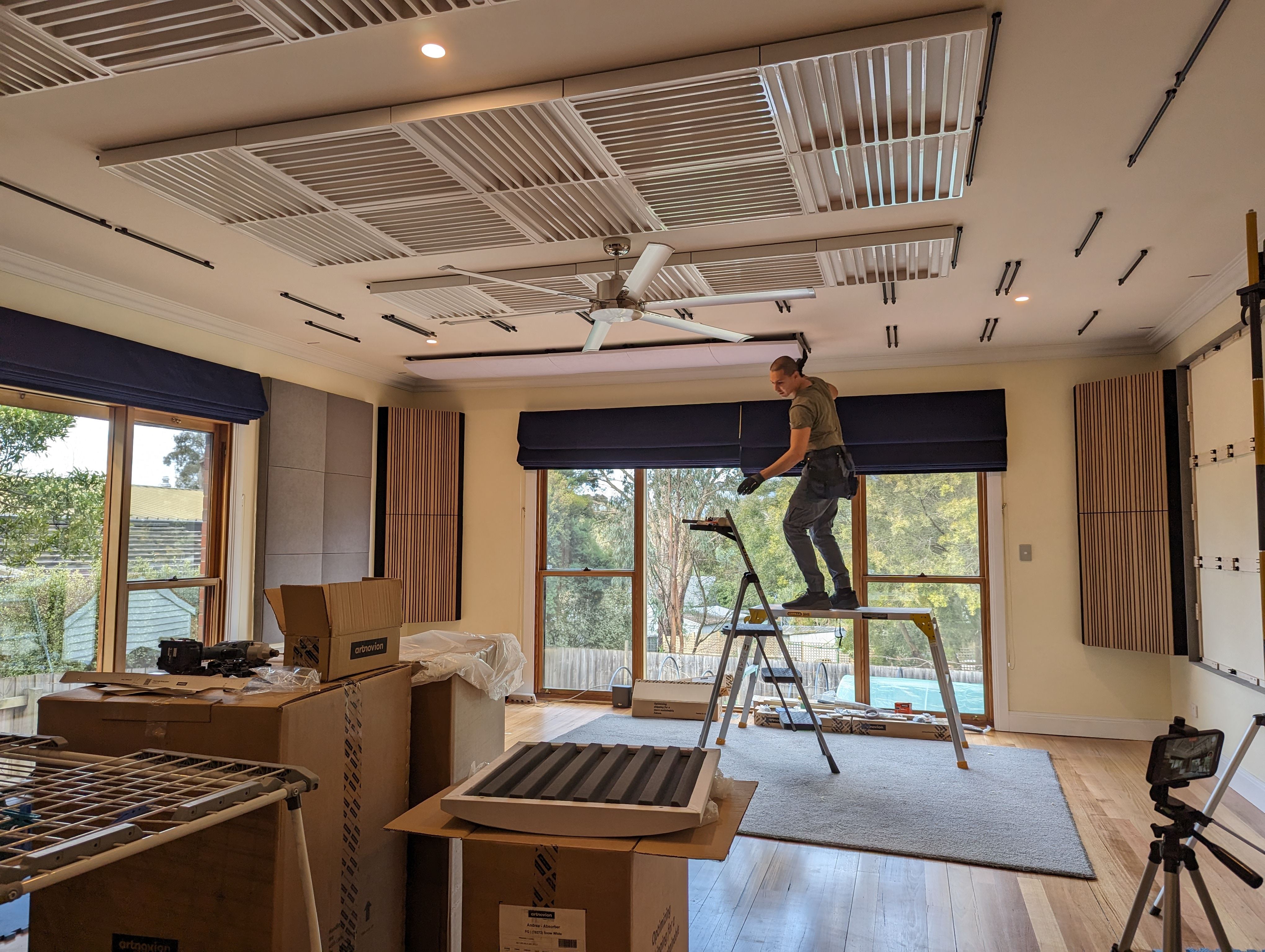

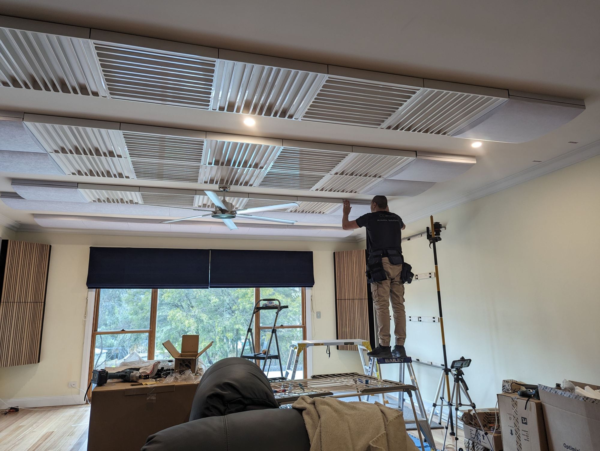

Well, let's look at what happened after the ceiling diffusion panels (Lagos white) were installed. Here is the tube-fix system going in to support the ceiling absorption panels (Andrea white) and the first of the absorption panels going up:PXL_20230906_034059168.jpgPXL_20230906_045904356.jpg
The absorption panels had a matching white edge piece to run around the perimeter of each row to seal them up properly and increase their efficiency:

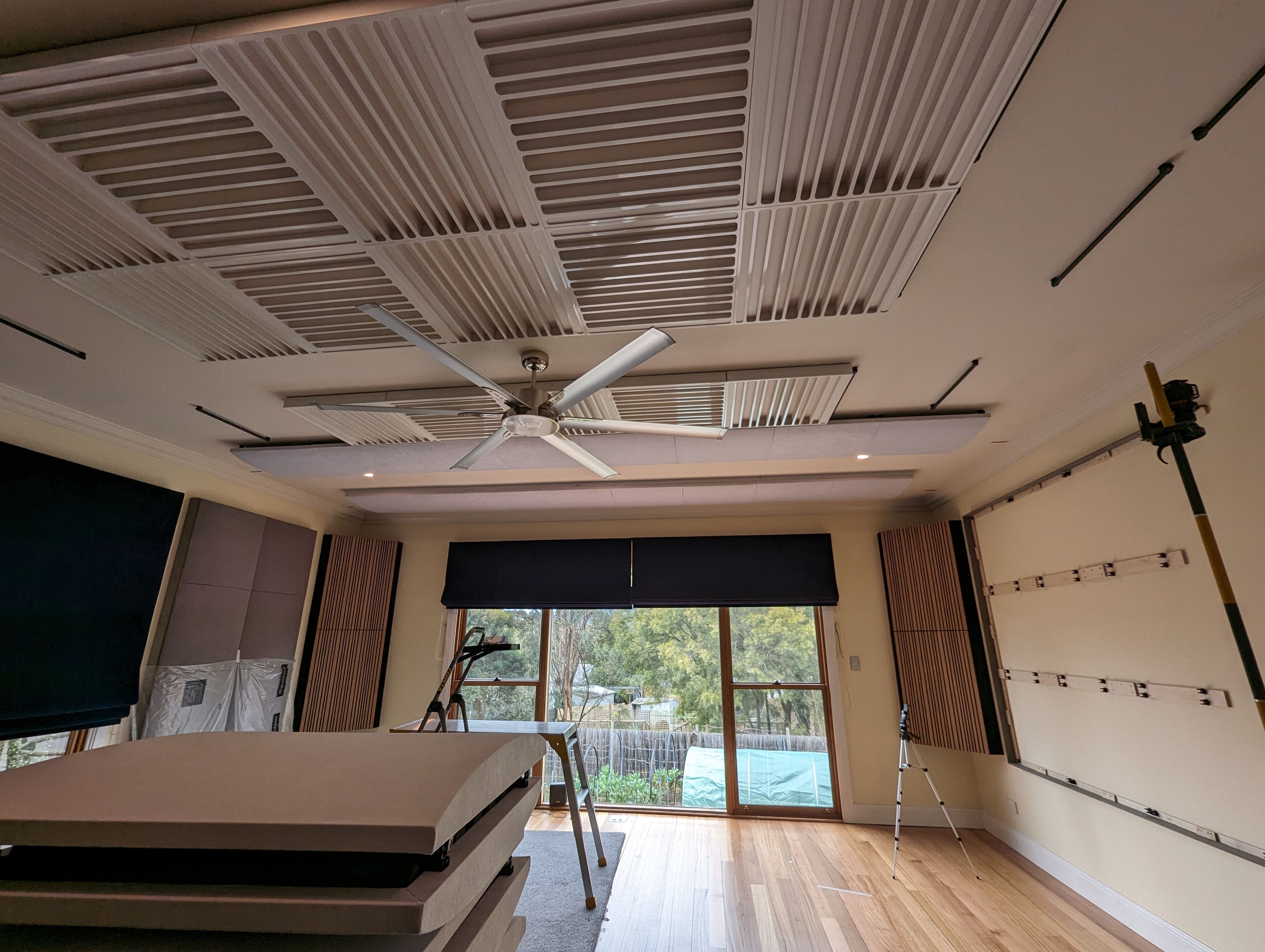

And here is the sequence showing the next row, plus absorption panels at either end of each row of diffusion, then more edging work:

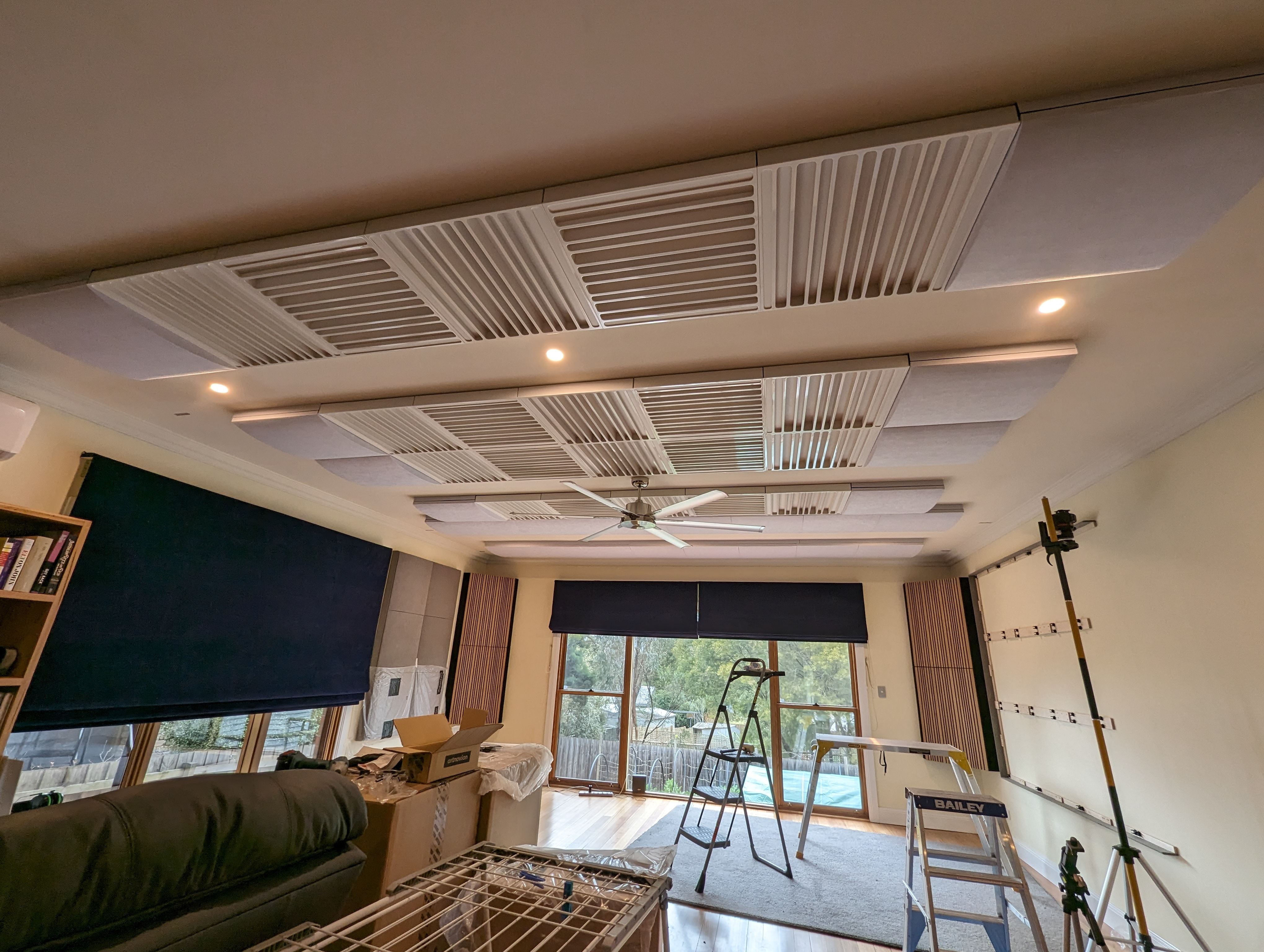

And here is the full ceiling completed:

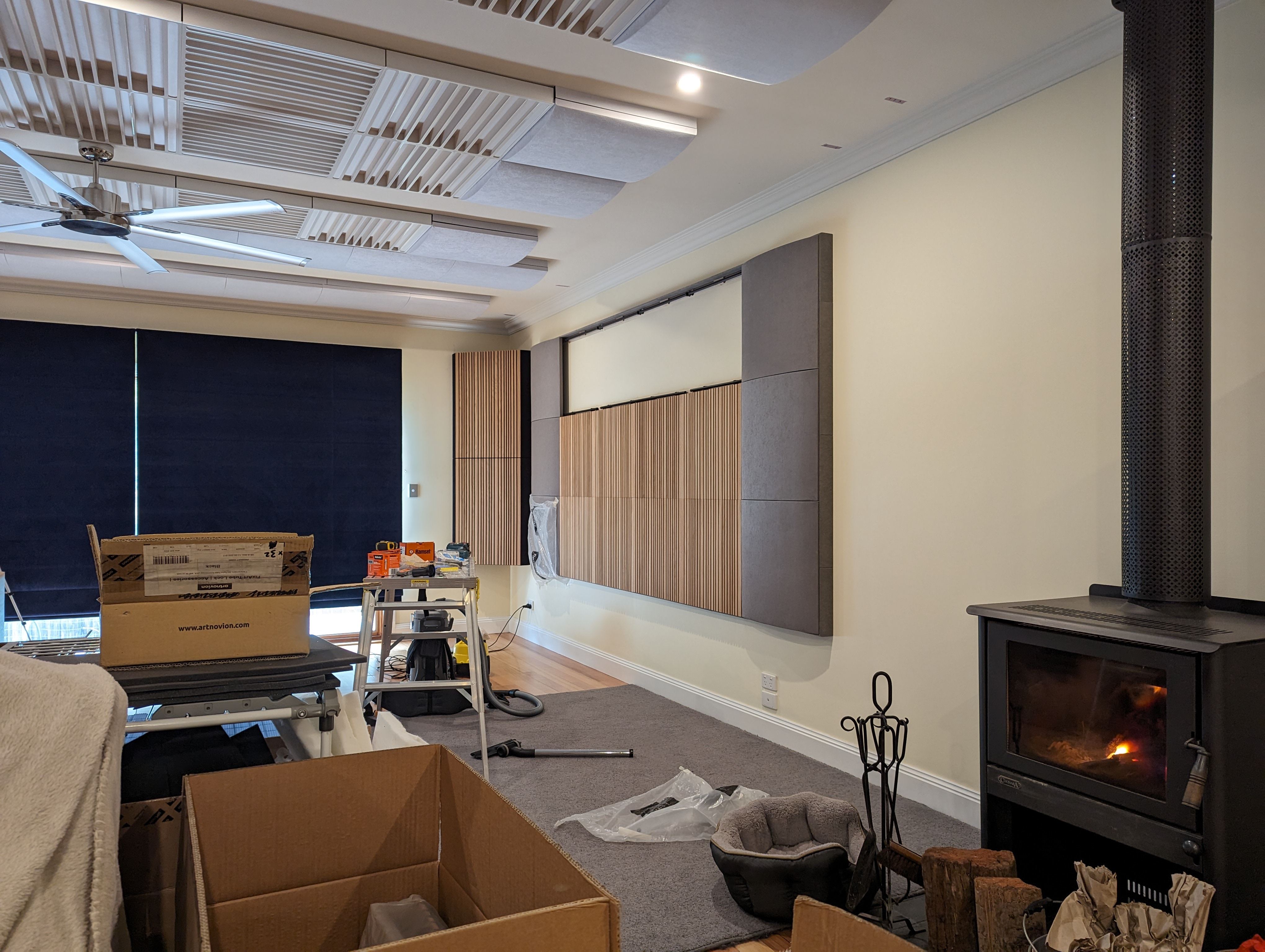

Now the final piece, the mixed absorption array on the right hand side of the space, this time grey fabric Andrea panels (ceiling were Andrea White) and Siena Oak Natura absorption panels to match the Oak Natura finish on the four corner sub traps. The last row of Siena panels about to go in and then we hit the finish-line:

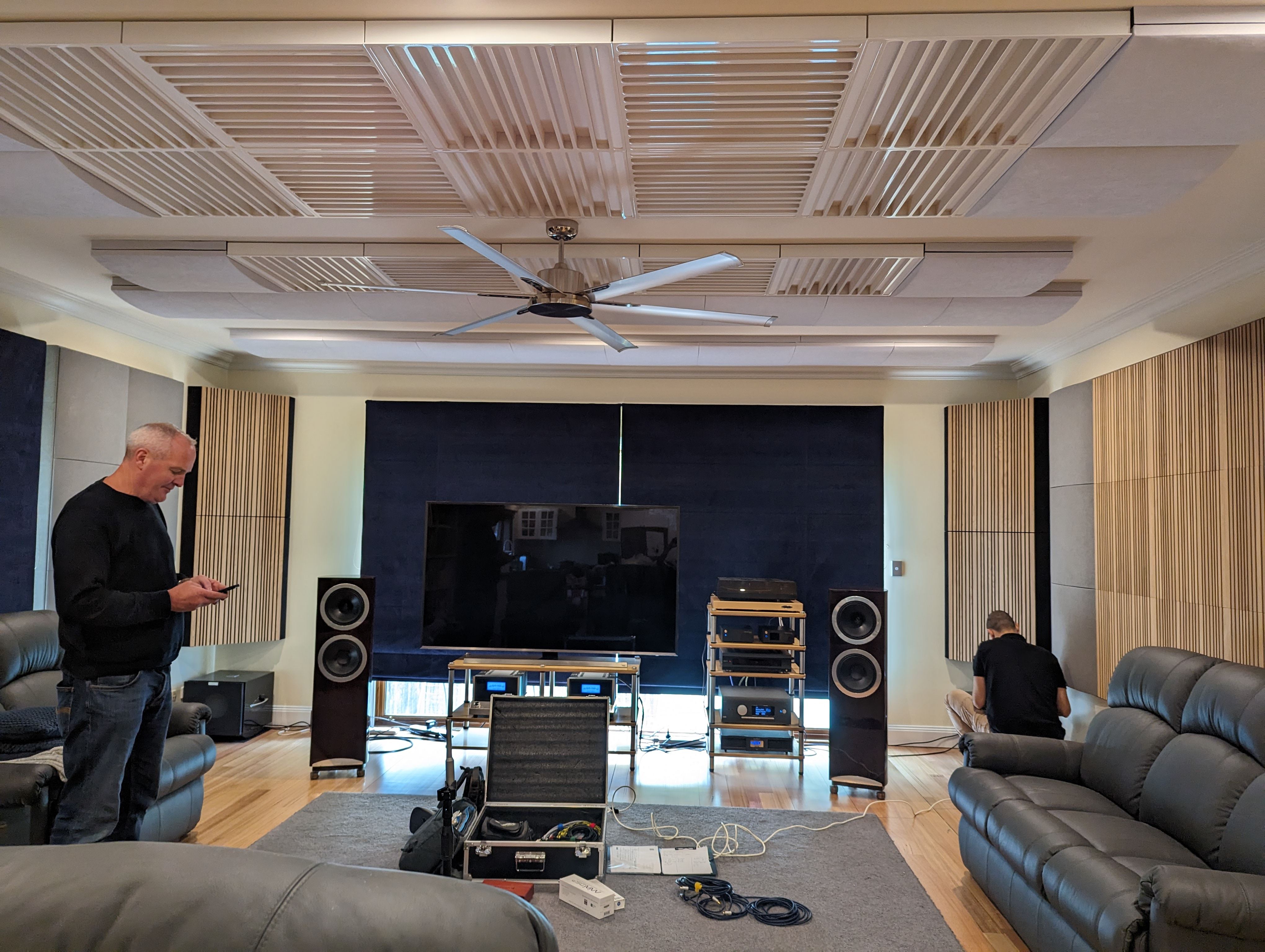

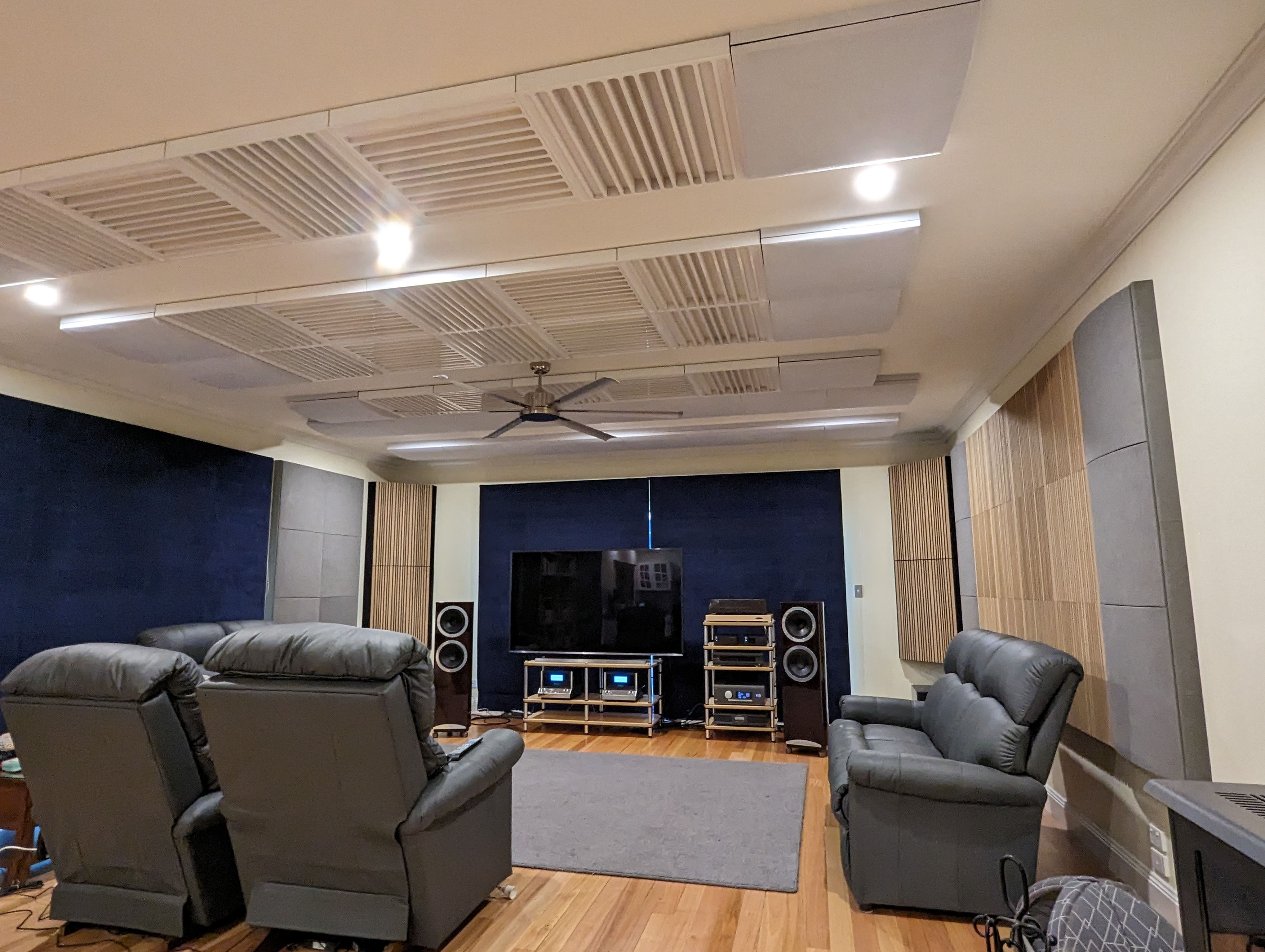

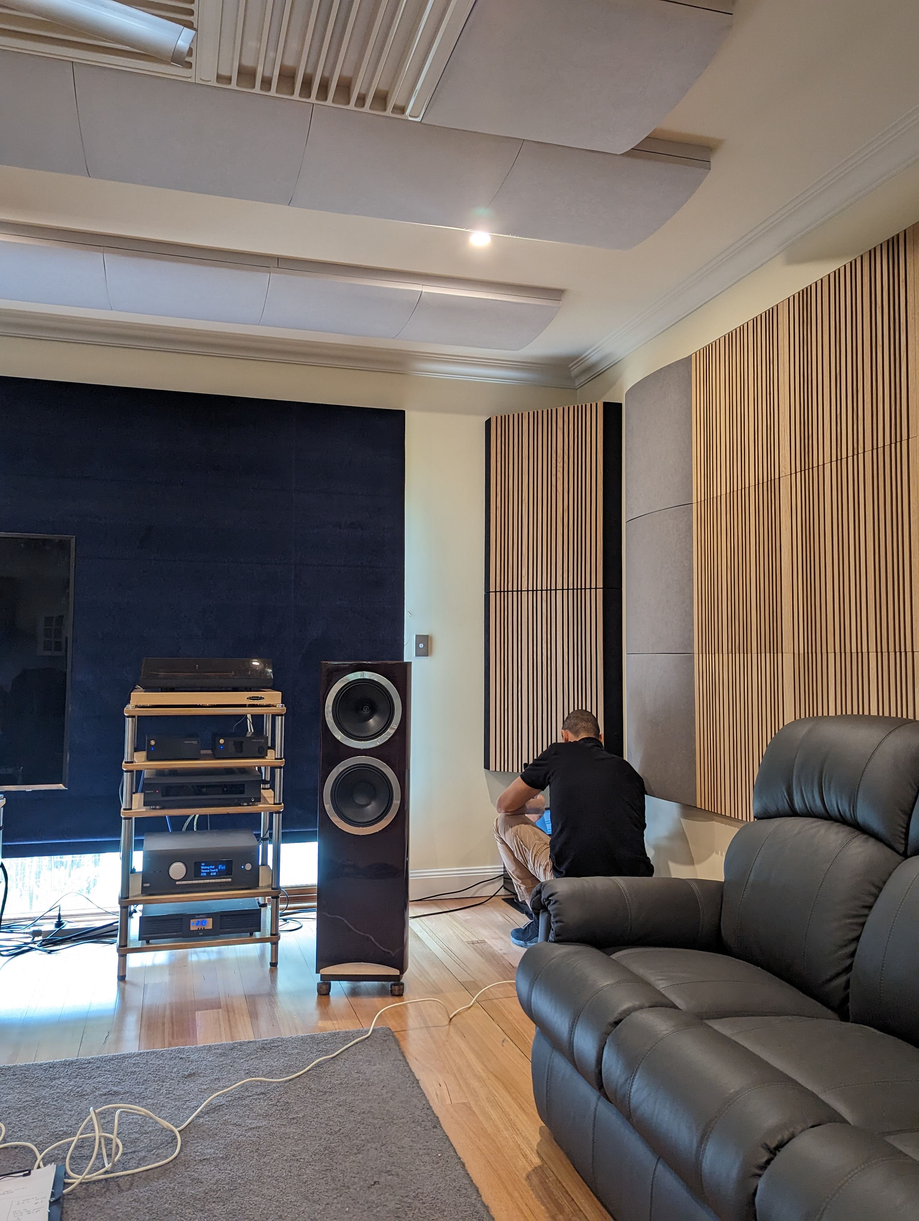

So onto this afternoon, with everything finished and the legendary powerhouse known as @BugPowderDust showed up to lend some muscle and help get the furniture and the system back together (I'm still bloody useless with the leg etc - thanks Craig, very much appreciated and glad we could do a quick listen once Christian left). Then Christian could take his "after" measurements (more to follow on that once I receive files etc). Craig impersonating a busy executive on the left, whilst Christian preps for testing in the corner:
Christian's sweeps resulted in the appearance on his face of something between a wry smile and maybe a touch of Italian smugness or at the very least a little self-satisfaction. On a macro level, everything is tighter, better defined and way less washy on the periphery. Even though we only treated a 6m x 5.5m section of the whole space, we saw RT of 500msec which in an overall 15m x 6m x 2.7m space is nothing short of an absolute win.
Well it sounds like I know where my 30 large went. Bass is amazingly tight. It's clear from looking over Christian's shoulder at REW plots that we have a flatter curve than before. All of the frequencies between 300Hz and 800Hz are more focused with the surfaces no longer able to scatter artefacts all over the place. It's the sum of its parts with the sub traps, absorption and diffusion - difficult to articulate in a succinct way, but it boils down to clarity and tautness coupled with a more distinct and locatable soundstage.
Am I happy? You bet your bollocks to a barn dance I am.
