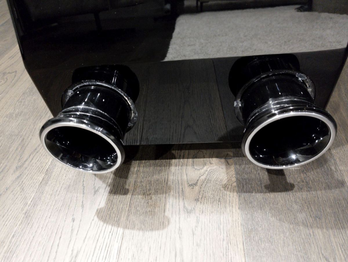

There's been a mid bass noise that's been bugging me and growing of late from the left side. I did some sweeps and pure tones and found the main left woofer is producing huge distortion that was nicely drowned out by the subwoofer until recently. I was worried there was something wrong with the woofer in the MBLs and I did some investigating. Turns out the bandpass ports were loose... completely loose after a bit of tugging on them and they just came out. Manually holding them firmly fixes the problem, but as you can see in the picture below they appear to have been secured by silicone which has come loose. The right one is completely unaffected. Now I'm not entirely sure of the history of these speakers to know when and how this happened, and if the silicone is the original securing glue so I'm reluctant to just re-silicone it. I've contacted MBL to hopefully provide some advice since there is no real place to service these (a disadvantage I knew when I bought them but still wasn't enough to stop me.)
Here they are with me having pulled them out:
gah, that's a pig. You can't see from the other one what they used? I can't imagine it would be silicon. It would have to be a read adhesive right?
Take a sample and put it through a gas chromatograph?
  • Author
I haven't got a clue about these things. Firstly it looks like plain old silicone to me, and secondly, I dunno what a read adhesive is.
Autocorrect. My old friend, how I hate you.
"read" should be "real"
Yeah, it's a total ducking aunt.
  • Author
I spoke to Stuart from SGR Audio and he was kind enough to suggest silicone would be suitable, so unless MBL get back to me, that's what I'll use.

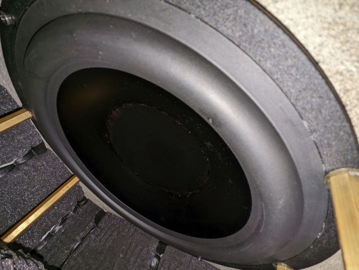

Out of interest, with the ports removed I could stick my phone in the hole and take a photo. Here's what the 12" aluminium woofer looks like within the enclosure. Remember the ports are actually in front of the woofer in their own enclosure, constituting an acoustic band pass; they are not bass reflex ports.
  • Author
And they're now siliconed into place. There is one huge advantage from this happening - to be honest I was aware there wasn't something quite right with the left channel when I first got these but overwhelmed it with the subwoofer to hide it. I'm now being even more judicious with the subwoofer crossover, allowing me to get better phase alignment at the same time. This means even better bass definition than before. 24 hours to cure.  Who would have thought I had room to improve? Bonus.
Fascinating photo… just don’t drop the phone!

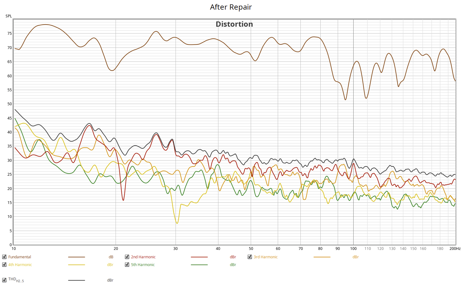

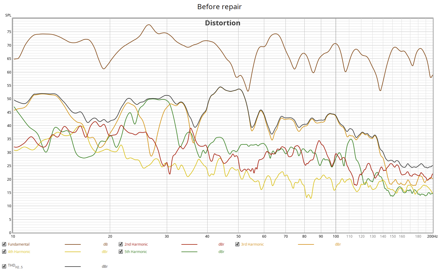

Here's what happens to distortion plots when you secure a completely loose pair of ports. Yes that is a frequency response to 10Hz, and the woofers cross over at 105Hz. This is an unsmoothed frequency response plot and the microphone was in a slightly different position so don't pay too much attention to the differences between those. Bear in mind this is after they'd gone completely loose so it had been getting progressively worse for some time, so if you came to a get together you probably didn't experience too much of the distortion, but it is still better than it was at the GTGs.
Wow, big change! That 40 Hz hump is just gone.
(and the 10Hz response is insane, btw)
Con, distortion is not a word that came to mind at the GTGs anyway! But good when you get a cheap win like this for sure :)
