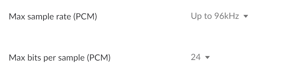

I just set my roon software as follows and have never had an issue with either of the ABBAS Dacs i've had

Same regardless of whether it went through the mutec or the abbas convertor (which didn't reclock).
