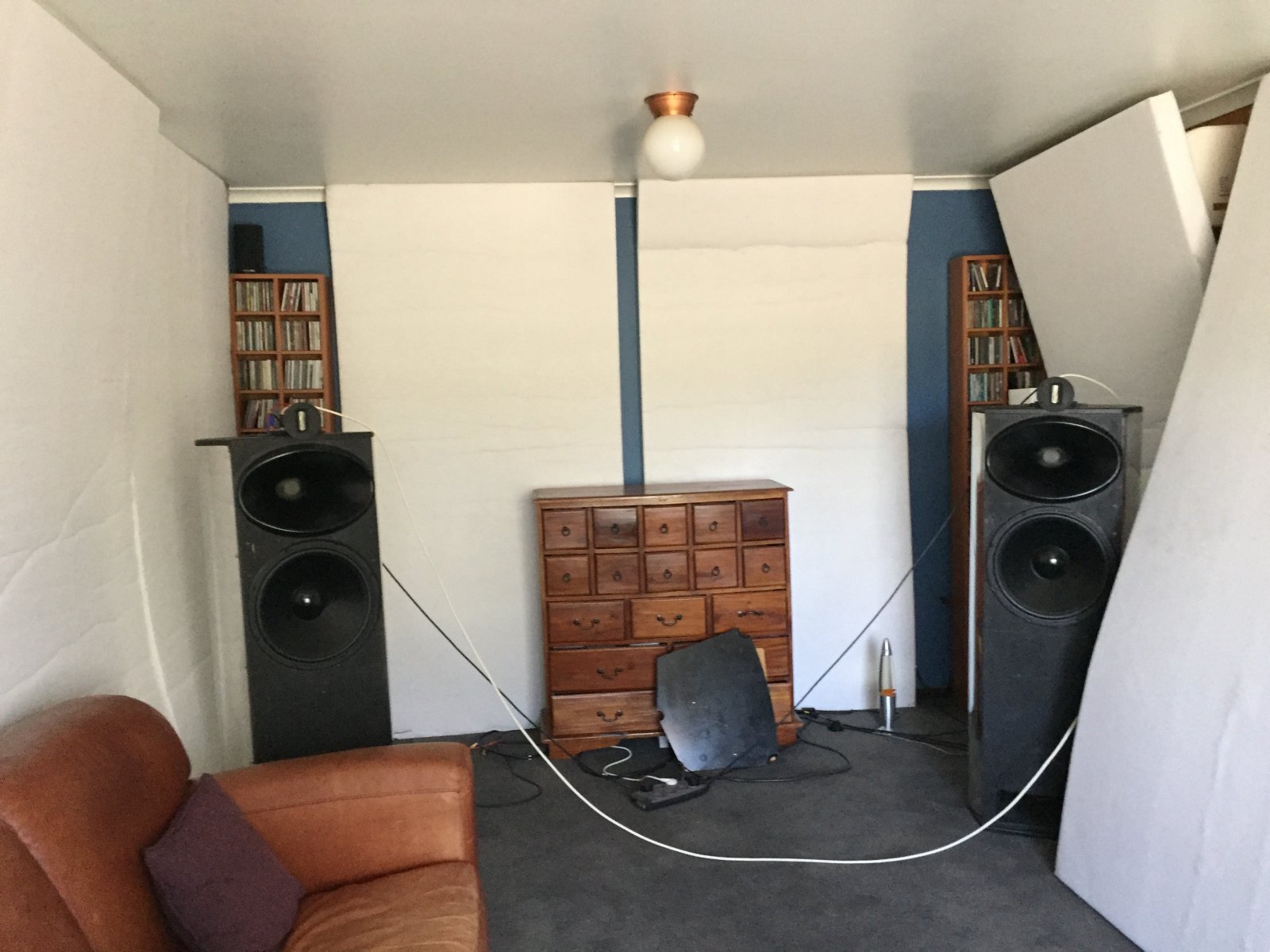

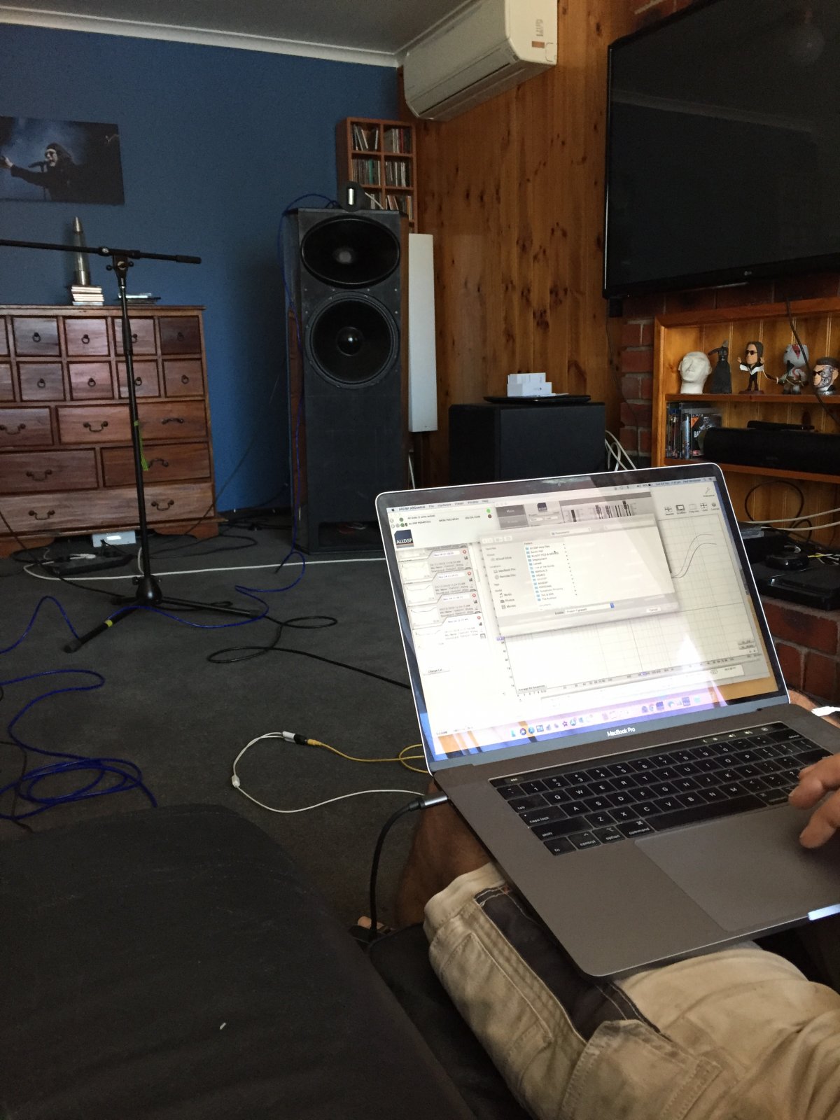

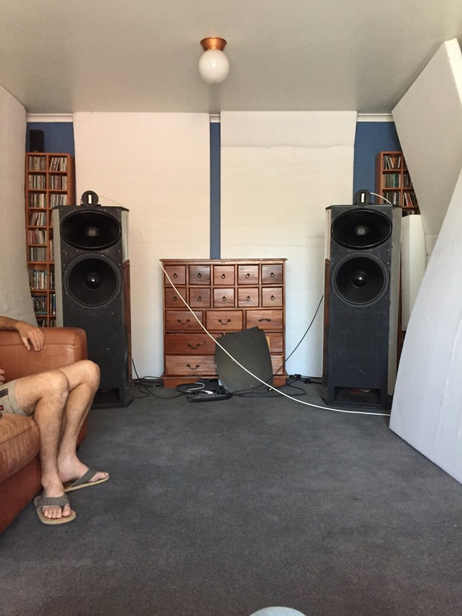

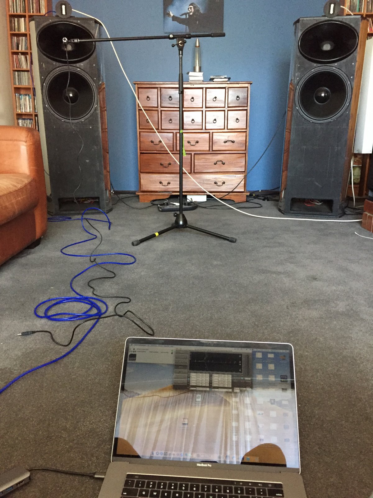

Had @Los come over to play with some EQ, placement and treatment. He did some sweeps and ended up changing some parameters to even some peaks out. This was locked into the dsp so that I can switch between the original setup to the new eq. We then loaded the room with some absorption material to see what happens. Finally we pushed the speakers further apart with a lot more toe-in. End result was wonderful. The bass is still thunderous but now it’s tighter and more detailed. Bass notes are more clearly defined. With the pull back of the horn mid, vocals have better balance in the mix and don’t feel shouty whatsoever at volume. Overall detail has dialled up and the soundstage has become wider with the speakers very much less apparent in the room. Instruments are more separated and seem to occupy their own space rather than being meshed together. The treatment together with the new placement has worked wonders. Listening to Dire Straits Making Movies was a revelation. These things just keep giving. Paul and John have provided the best sound I’ve ever had in my home. Next step will be fitting the treatment to the room and including the ceiling panels. The journey continues. Can’t thank Paul enough for taking the time to come out and set this up for me. Amazing stuff!

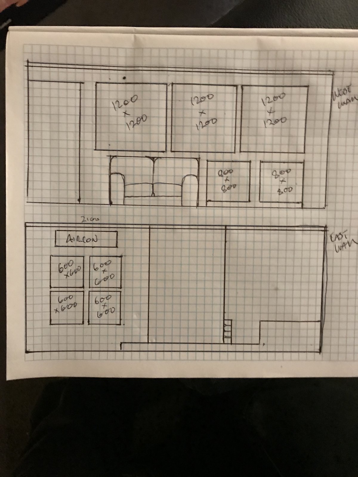

Ok. Enough of movie stars. Here’s a drawing of the projected acoustic panel array that’s planned. The rear wall (behind the speakers) will have full height batts across the width of the wall with a curtain in front. The panels in the diagram will be of colours yet to be determined. Ceiling panels are yet to come. All in all, it should sound great and still be aesthetically pleasing.
