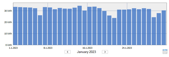

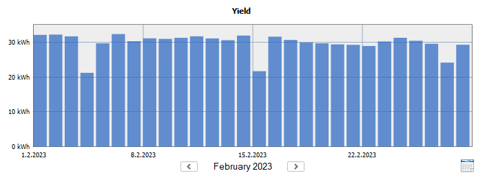

We went through Apollo Solar in June 2021 for an install using 13.32kw of premium Phono Sumec solar panels and a 10kw Sungrow inverter at a cost of $13,928. We had the inverter installed indoors under our stairs to reduce overheating/fire risk as overheated inverters can be a cause of fire.
