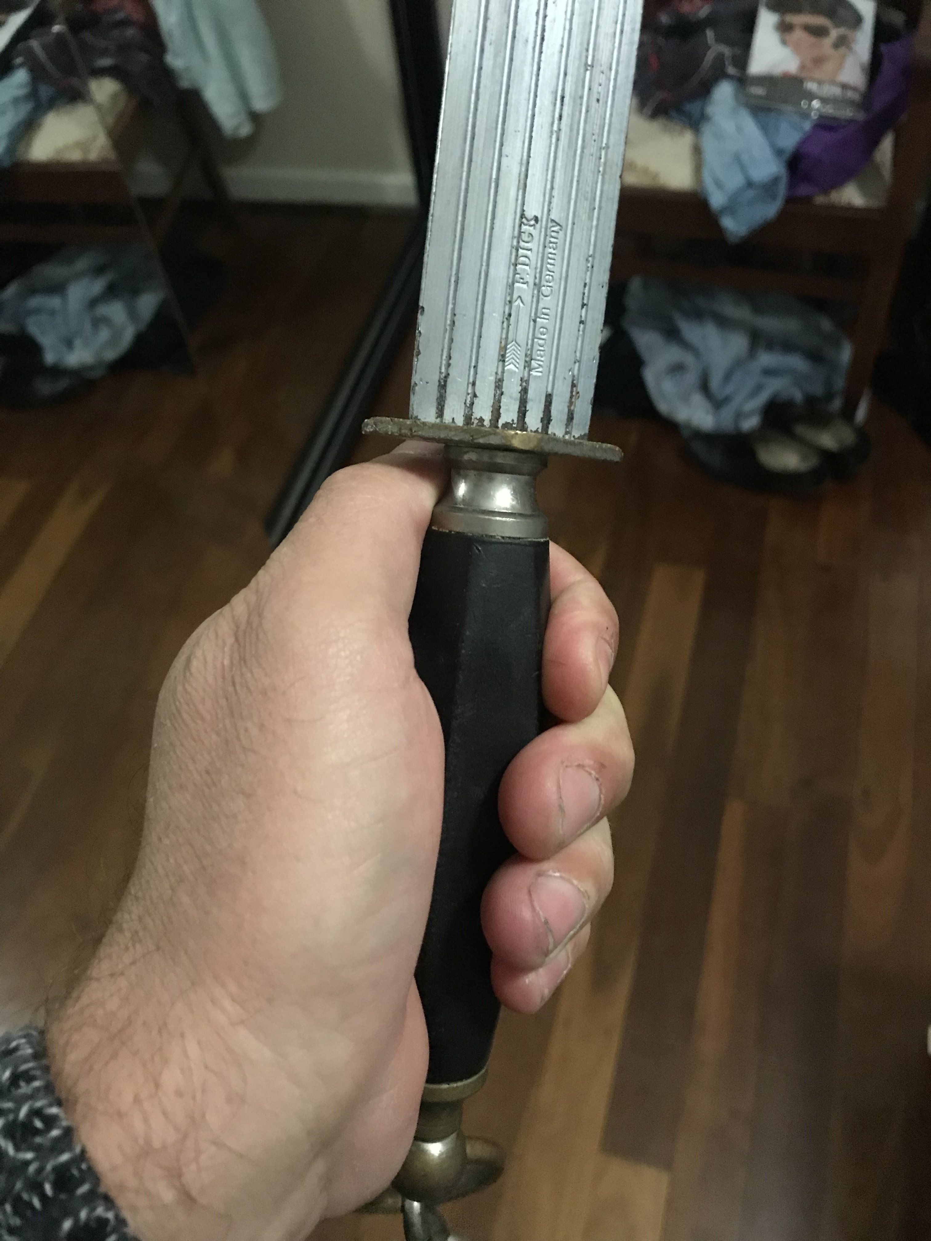

  • A proper steel has no guard. If you can't use one without cutting yourself then you should not use one until you can.   A blade steel is for  'honing' never ever for sharpening. You sharpen
  • I always hone towards my hand, as it seems more natural.   But I've put an extra guard on mine.
There’s a guard on the handle so the blade won’t go further towards your hand.

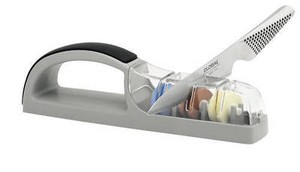

I always push away with the steel and use one of those ceramic 2 stage wheels for sharpening periodically . That said I really should send off my Globals to be professionally sharpened. I've had them for about 15 years and only had them done once... ?

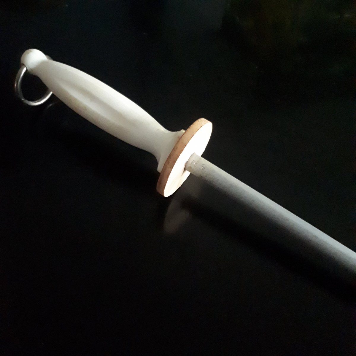

We got a ceramic "steel" last year, a vast improvement on the various other types I've used over the years.

Whereas a good steel with no guard whatsoever wielded by someone who can hear the music of blade on a steel will always, absolutely always, give you a blade that you can shave your forearm hairs off if you wish.
You get to a point where your strop is light and if you apply it a bit heavy with your dominant hand then you lesson off on the other hand holding the steel. You get a nice music happening and it's all in the wrist of the dominant hand, it's a precursor to carving up the Sunday roast here in Chez Luc. The kids grew up with it and I'm slowly passing the skill on to my big grown up daughter. My Dad and his father  schooled me in it. Not quite metronomic but there is a beat in there.
