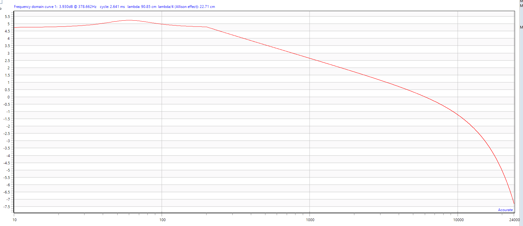

  • Author
The other thing everybody agreed on was that this target curve sounded the best:
I had a number of target curves loaded and we were able to switch between them with Acourate Convolver. It's a rather strange target curve with a slight 0.5dB bass boost between 50-80Hz, a pivot at 200Hz, -5dB at 10kHz, and -10dB at 21khz. I haven't seen this type of target curve before. It's not my target curve, it's Uli's. It sounded more full and had more body, but to me it lacks a bit of top end. Up till recently, my preferred target curve was a Harman-like curve, with a 3dB bass shelf to 100Hz, slowly tapering to 200Hz, then -4dB at 21khz. This is a neutral sounding curve which I like because it offers so much clarity, mostly because there is more treble energy. I am going to use this curve as a basis for further experimentation.
Look pretty standard if you squint at it.
If you "delete" the extra roll off above 10Khz, then it's the standard ....   ~ -4dB straight ish slope from 1khz to 20khz .... and then below 1khz there's a a boost of ~ a few dB.   In this case the LF boost begins up high (right up a 1khz)... but it's only ~1dB / octave.
