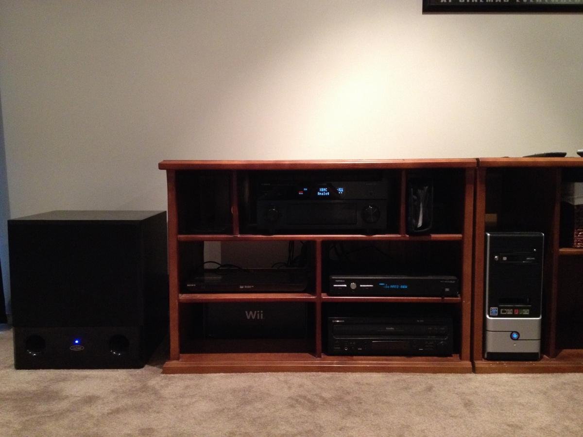

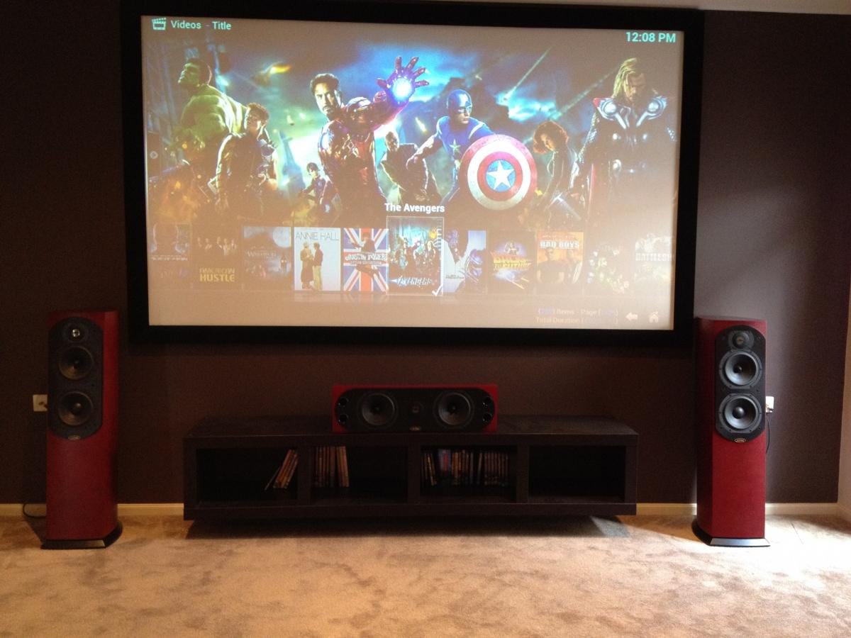

Thought I would share some photos of my Home theatre room.
I'm on a pretty tight budget so everything is DIY, helps when your an electrician but most of the gear is also budget conscious.
Speakers: Fronts: Richter Wizards Mk4 ex demo from Len Wallis last pair to be sold I think.
                Centre: Richter Unicorn Mk4 from Audio Junction runout model half price
                Surrounds: B@W DS6 the expensive item in room purchased before marriage
                Surround back: Wharfdale $200 from grays I think
                Subwoofer: Richter Thor Mk 4
Reciever: Yamaha RXA 2000 refurbished model from Eastwood HiFi
Bluray Player: Sony  BDP-S790
HTPC running Kodi
Projector: Benq W1070

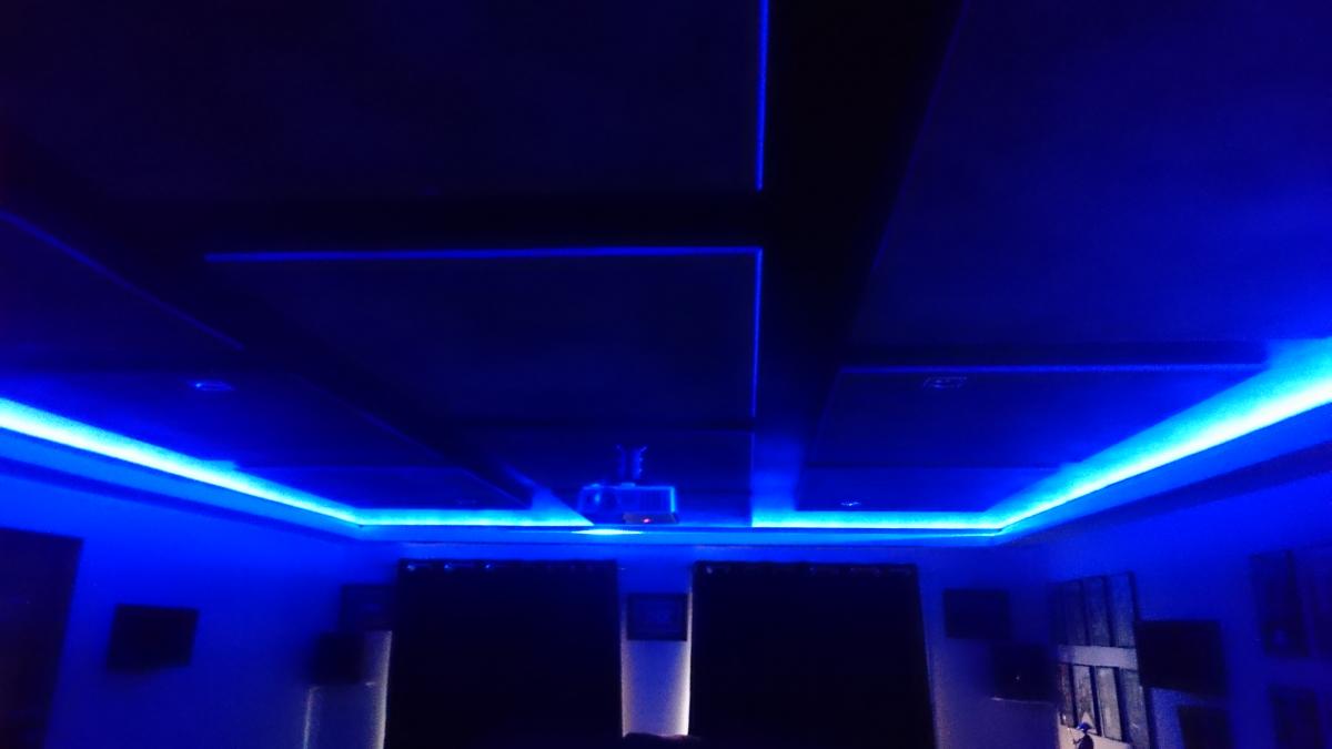

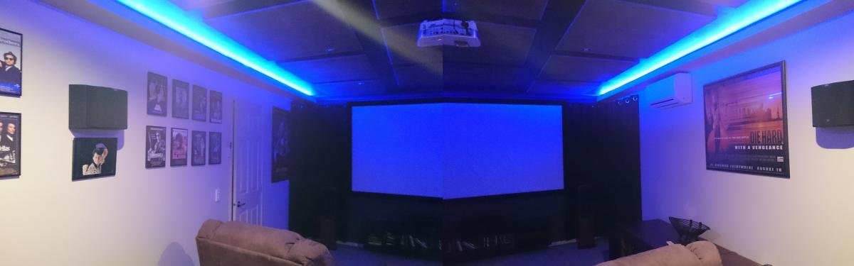

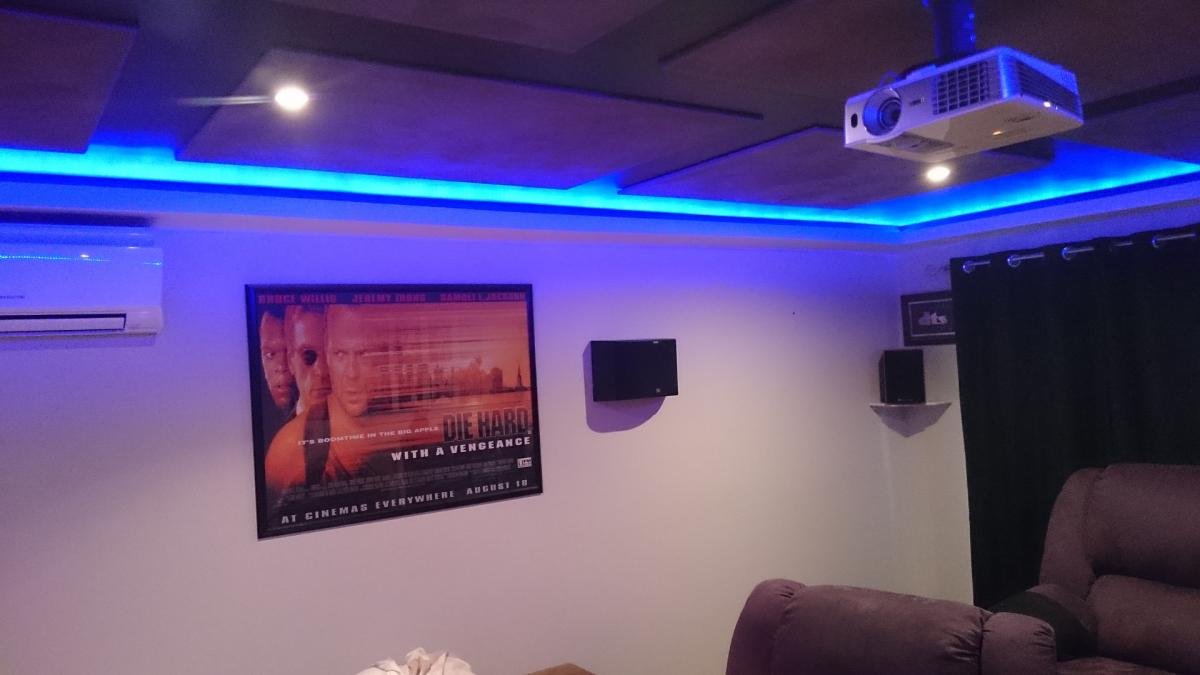

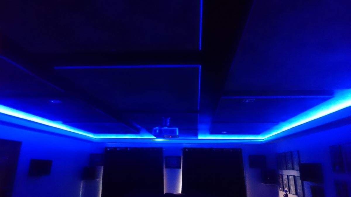

Ceiling was done by painting ceiling black first and than painting 12mm thick 1200 by 900 sheets of MDF with a stone textured paint and fixing to ceiling.
Fixed house frame timber sourced from building sites onto ceiling against cornice for LED strip lighting and then nailed 230 wide timber panels to that for the shelf and nailed 40mm by 20mm timber to that to hide the LED lights.
Led lights from bunnings at around $10 a roll.
Hooked up a 12v trigger cable from projector to relays normally closed contacts so when projectors turns on the LED lights turn off.post-113667-0-64745000-1445313572_thumb.post-113667-0-90224100-1445313677_thumb.post-113667-0-64478500-1445313719_thumb.post-113667-0-61332600-1445313884_thumb.

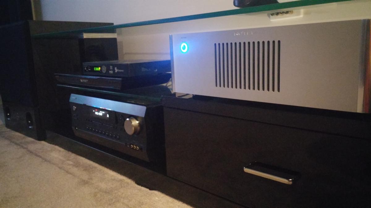

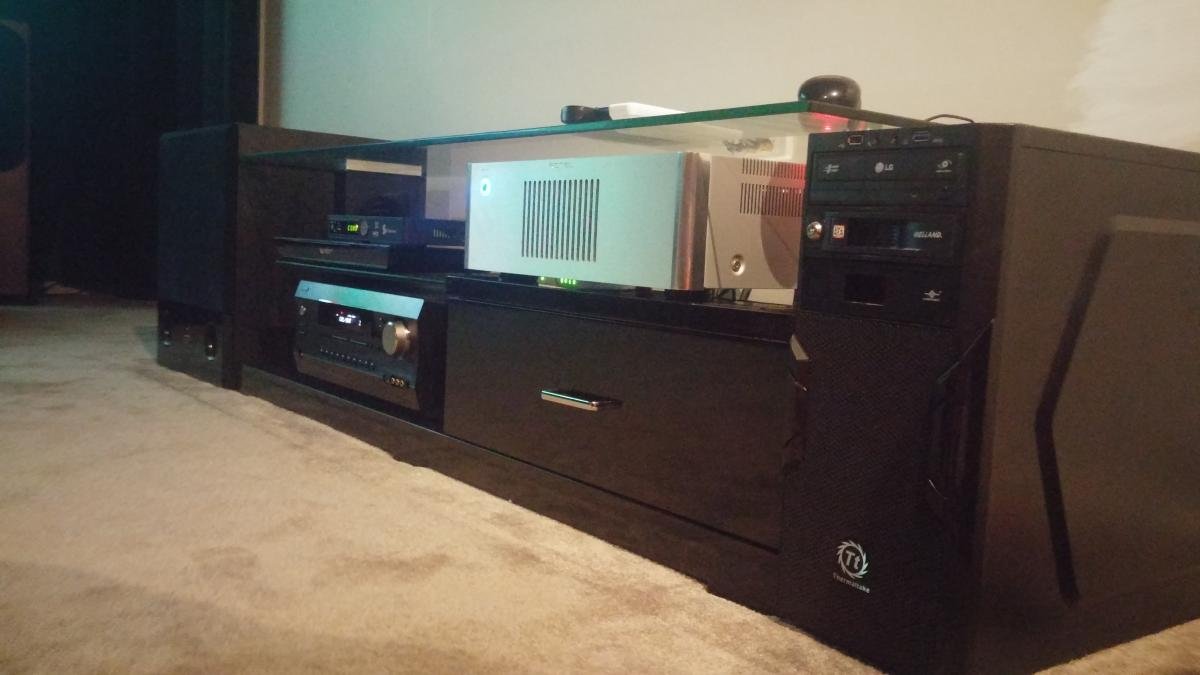

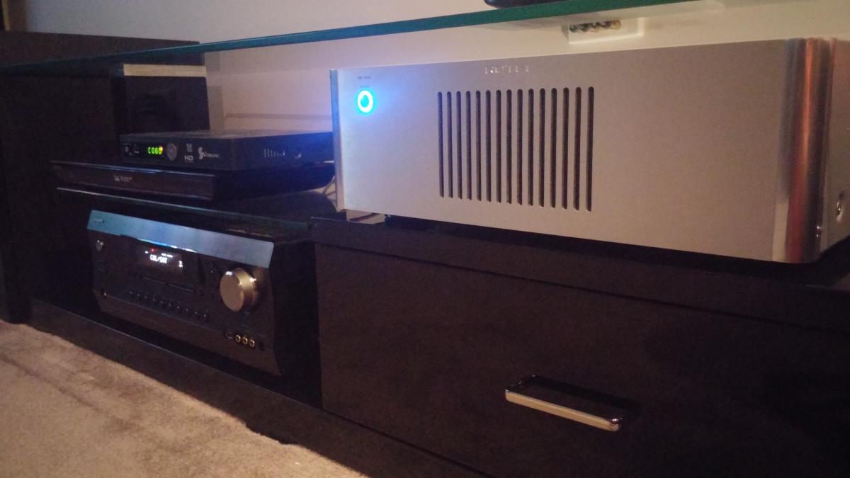

Update to System.
Integra 30.5 and Rotel 1552.
Thanks to Bruno28 for the Rotel. WOW! first time with separates and YES baby they do make a difference. Very happy. Was scared it wouldn't be an improvement over Yamaha Rx-a2000 but it kills it.

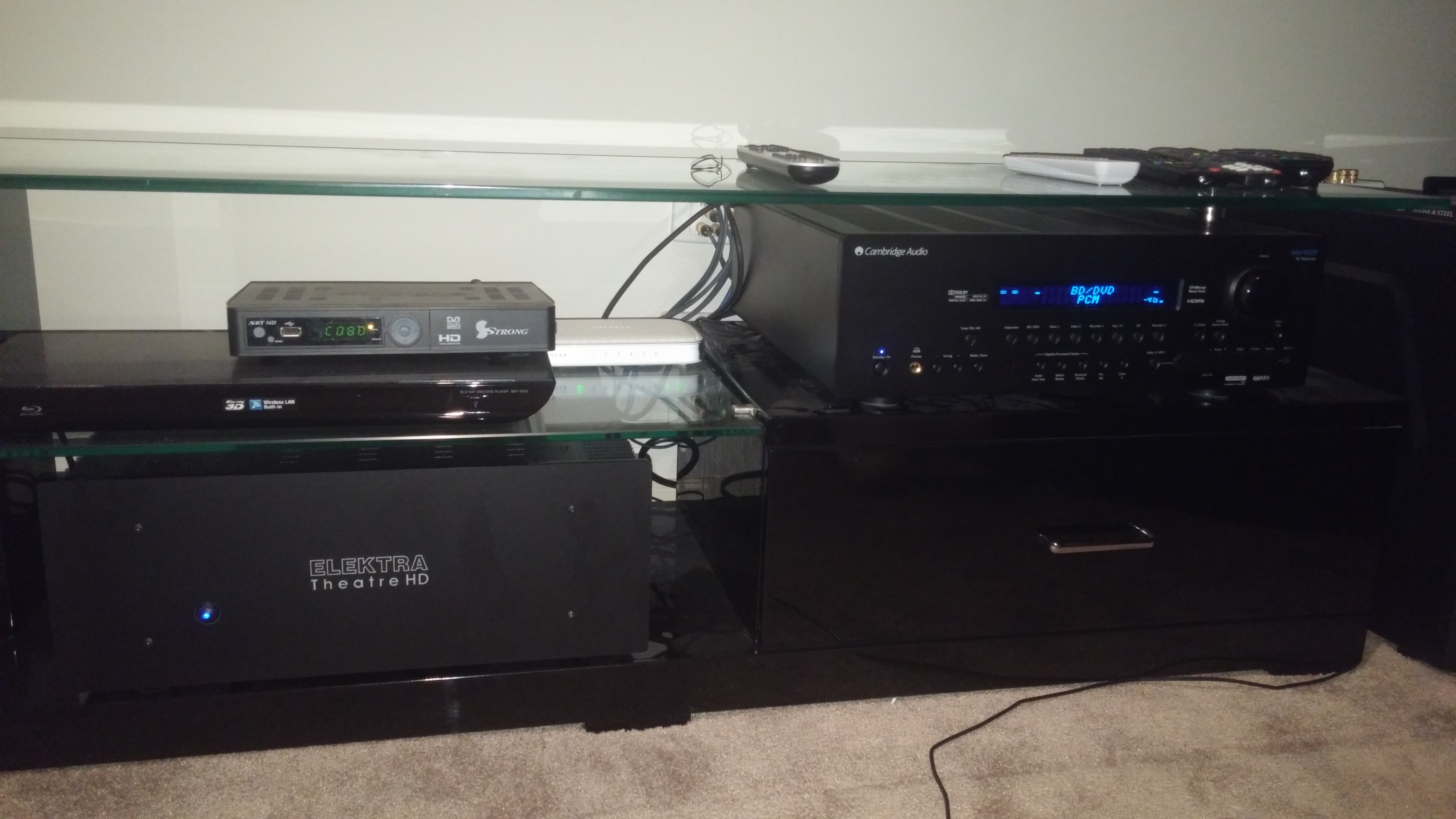

Have just ordered a Elektra 3 Channel from Bill McClean so exciting times ahead. Will be keeping the Rotel for Atmos heights speakers.

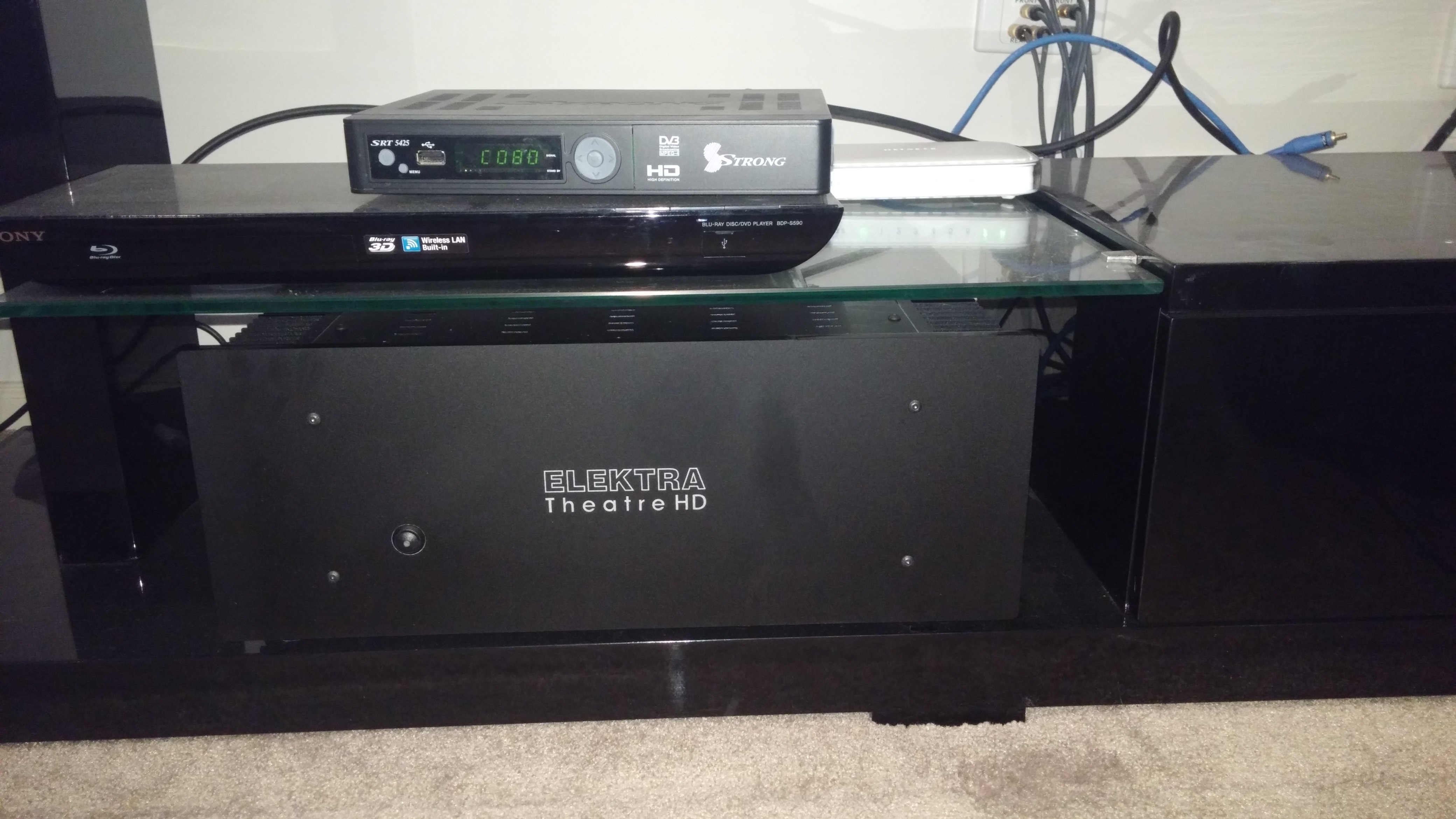

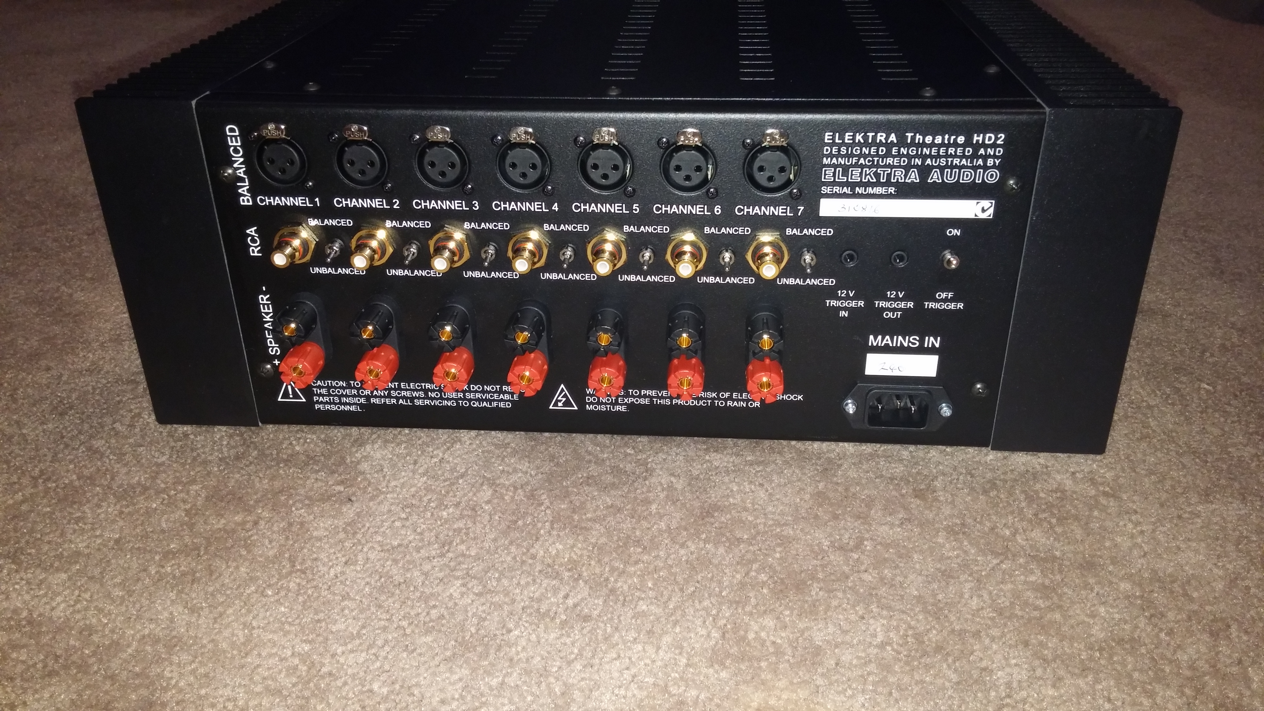

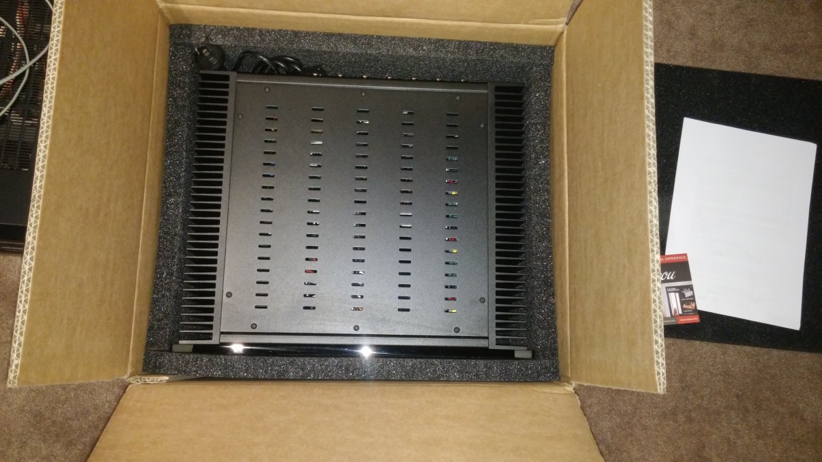

Getting ready for something else.
  • Author
Part 1 has arrived now waiting on Cambridge 651R.
Silly me got excited and I thought they gave me a 7 channel one but upon opening case realised it was what I ordered a 3 Channel.

I can sure bet unpacking that elektra had you going all ooh and ahh... sure has had me even on the 3rd time ! :D  never fails to amaze and thats before plugging it even in hehe
ps what ever you do, dont throw away the shipping box for the elektra. will come in handy down the track, if ever need to ship it to arthur...when want those extra channels :thumb:
