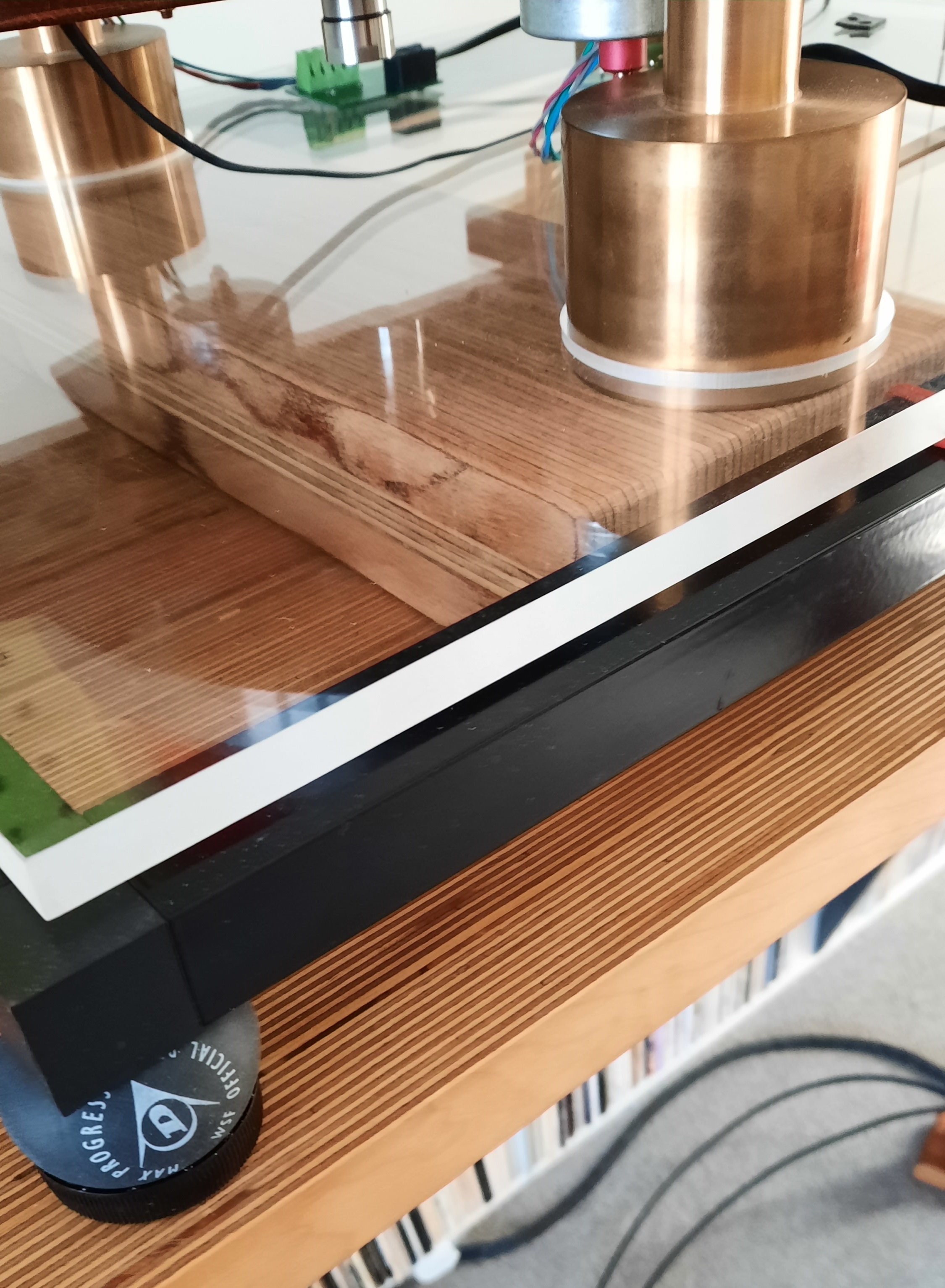

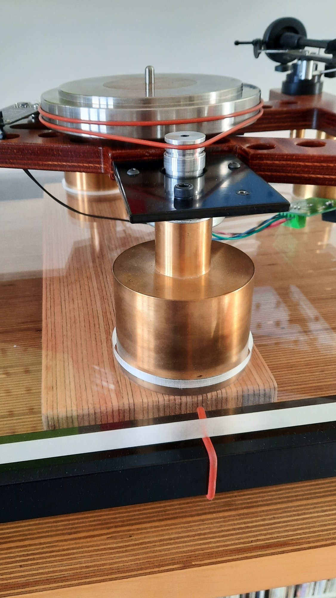

Well, an update on my October 20 post!
Here was the setup, then:
As you can see from the pic, the brass cylinders that form the 'motor pods' go through large holes cut in the perspex base - so they don't touch the perspex (and so don't transfer motor vibrations to it).  When the perspex base was resting on the benchtop - the motor pods rested on that too.  But lifting the perspex base off the benchtop meant that I had to provide a support for the motor pods - so I cut up a bamboo cutting board to fit across the Qubelok frame.
I thought this would do a good job of:
  • supporting the motor pods
  • yet - being bamboo - would not pass motor vibrations into the Qubelok frame.
However, I decided use a stethoscope on the perspex base, to check this assumption - and, unfortunately, could hear a noise when the motors were switched on.  :sad:
So it would seem that:
  • motor vibrations were exiting the motor pods, into the bamboo shelf
  • and were then being passed into the Qubelok frame
  • and - even though the perspex base wasn't sitting directly on the frame ... but was resting on 4x silicone O-rings - vibrations were getting into the perpex base.  :shocked:
So I got a mate with a drop-saw to cut up 3 pieces of ply which I happened to have lying around and glued them together ... to make an alternative support for the motor pods.  This rests on the benchtop ... not the Qubelock frame.  See pics:
Result:  success!  No noise through the stethoscope, when the motors are turned on!  👍
This suggests to me that bamboo may not be the isolation material that many people think it is!

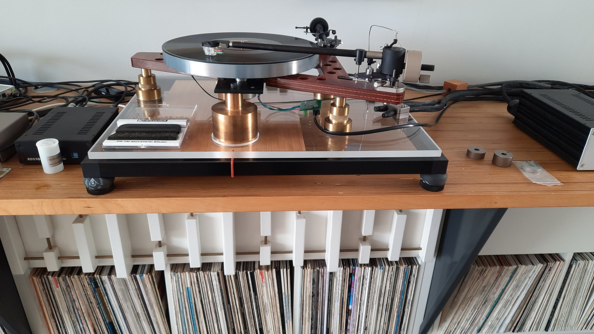

  • Well, today I finished re-assembling my SkeletaLinn - including installing a Karousel bearing in place of the Cirkus bearing.   With some trepidation ... I then performed the "motor vibratio
  • The flight deck — it's all way beyond my feeble understanding but it sounds excellent.
  • Well, it's time for an update!     The months since early May have been a type of purgatory in that I have had several different problems reveal themselves - and have been unable to sit down
Great work Andy! I did notice when I was last at your place that heavy footsteps was enough to make your TT skip grooves. I trust that is no longer an issue?
  • Author
Yes, Keith.  Changing from springs on the TT to Audio Silente 'silicone mushrooms' ... improved SQ - but left the TT vulnerable to footfalls.  :sad:
The isolation platform solved the footfall problem!  👍
The latest change has stopped motor vibrations from getting into the perspex TT base.  :smile:
Just to clarify, you are resting the Qublelock and the bamboo on the ply? The reflections in the photo confusing me a bit.😉
My experience after trying numerous bamboo cutting of various layouts and thickness, is that they have different impacts on the sound. The Myers’s store lady who facilitated my trial was very interested in the outcome! 😂
Some I liked, more than others and some didn’t like. Must have different resonance characteristics rather than “isolation”.
I found the IKEA Apptlig butcher block, with separate bamboo layers in the block, the “best”, but now use it as part of a 3 tiered arrangement platform for “isolation” of electronic equipment.
  • Author
Yes, sorry ... the reflections are confoosing.  :sad:  The Qubelock frame (same as the Dekstand - except there is a lip front & back, to support a shelf) sits on squash balls ... which rest on the long, birch-ply shelf which supports all my equipment.
The cut-down bamboo shelf which I used previously ... sat on the front & back lips of the Qubelock framing.
Now ... the bamboo shelf has been removed and the ply block which I made up substituted - 'xept this sits on the equipment bench ... so doesn't make any contact with the Qubelock frame.
So the vibration path is different:
  • before: motor pods sit on the bamboo shelf - which sits on the lips of the Qubelock frame.  The perspex TT base sits on the frame - so, vibrations travelled from the motor pods --> Qubelok frame --> perspex TT base.
  • now: motor pods sit on the ply block - which sits on the benchtop.  The air suspension delivered by the squash balls prevents vibrations in the benchtop from getting into the perspex TT base.  👍
Andy

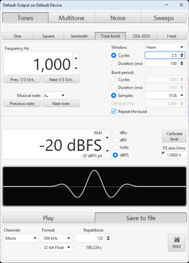

Testing whether there is clock drift or not would be really difficult because it only manifests itself after the clock drifts apart. If two DAC's have 25ppm clock drift in opposite directions, then the error is 50 samples per 1,000,000 multiplied by sampling rate. Since you are using 384kHz, then that's an error of 19.2 samples per second, or 0.05ms per second. After one minute of listening, that adds up to 3ms. After an hour, that's 180ms.
To test that, you would need to set up REW to send a periodic impulse, along with an interface that has at least 2 analog inputs. I would probably use REW's Generator and Oscilloscope function and let it run for a few minutes to see if the two impulses drift apart. The difficulty is how you are going to send the signal from REW to Roon. Maybe record a wavelet burst like this and play it over 10 minutes and capture the DAC output with the interface and oscilloscope.
