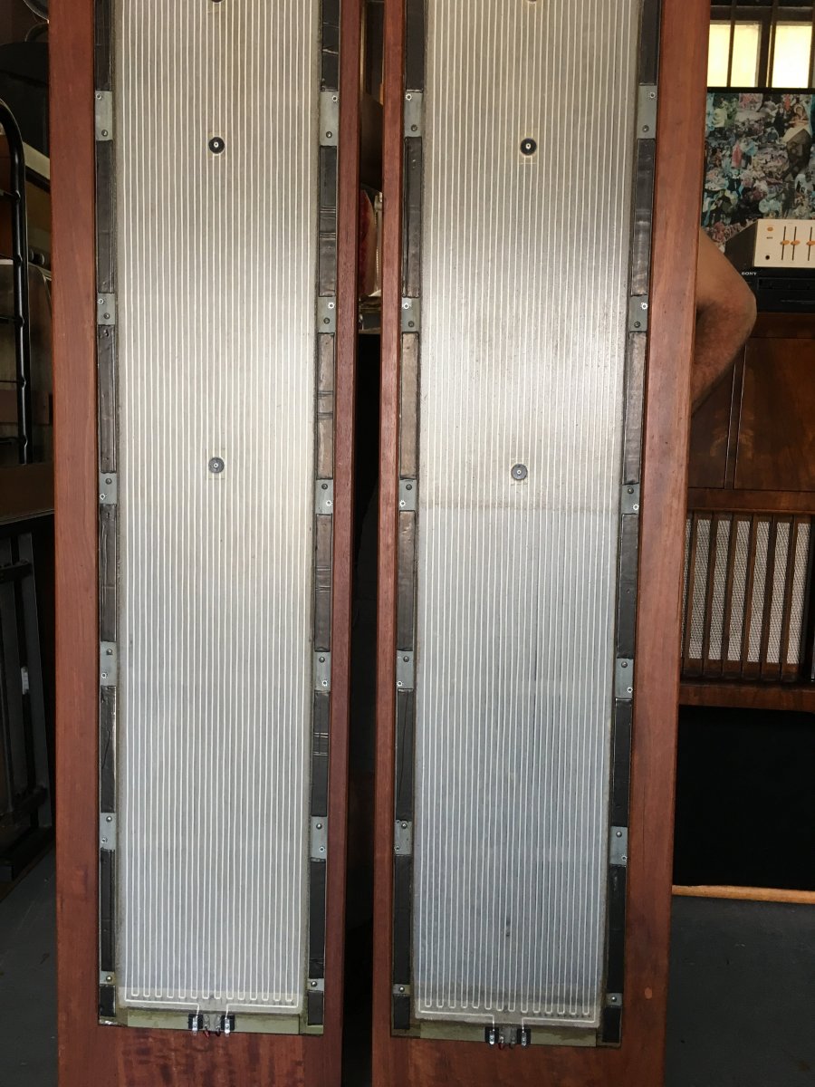

Well, today Bill sent me pics of my re-wired panels!  Will be sent back in the next couple of (work) days!  :thumb:
The foil looks really cool!!  :thumb:
He said the measured panel resistance is now >5 ohms - which is actually more than it was with the original round-wire.  Which is unexpected - but welcome!  :thumb:
Can't wait to hear the difference in sound.  :)

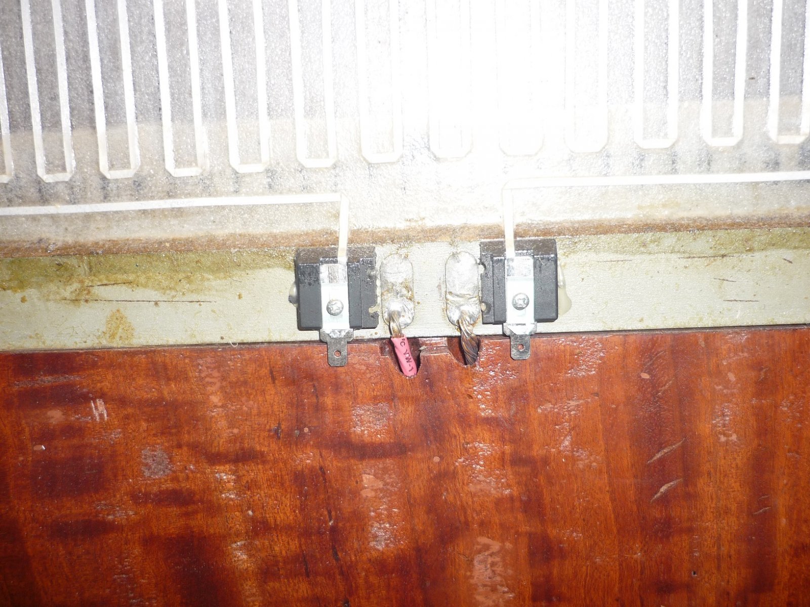

Well, unpacking the panels and having a closer look has revealed an issue that I am extremely PO about!  :(
A closeup of the pic above - focussing on the connectors at the bottom of the panels is here:
As you can see, the tech made a beautiful job of finishing off the ends of the foil with some 4.8mm spade lugs.  Trouble is ... as you can see, wires are soldered to the solder tabs which the previous round-wire was soldered to - and these wires connect to the banana sockets at the back, which take the spkr cables.
So I cannot just connect up my re-wired panels and start listening to music ... I need to f'ing well make a connection between my wires ... and the damn tech's foil spade connectors!  :(
There's an easy - and a complex way of doing this!  :lol:  The easy way is to use some right-angle 4.8mm spade connectors - which will enable me to simply:
  • unsolder my wires from the solder tabs
  • and bend them sideways to fit onto the right-angle spade connectors (called - for obvious reasons - 'flag' connectors).
After several hours of searching, I was able to locate some of these from Element14 (most flag connectors - from various mfrs - fit 6.3mm spades!  :( ).  So hopefully they will arrive tomorrow ... and I can see whether they will work as planned.
