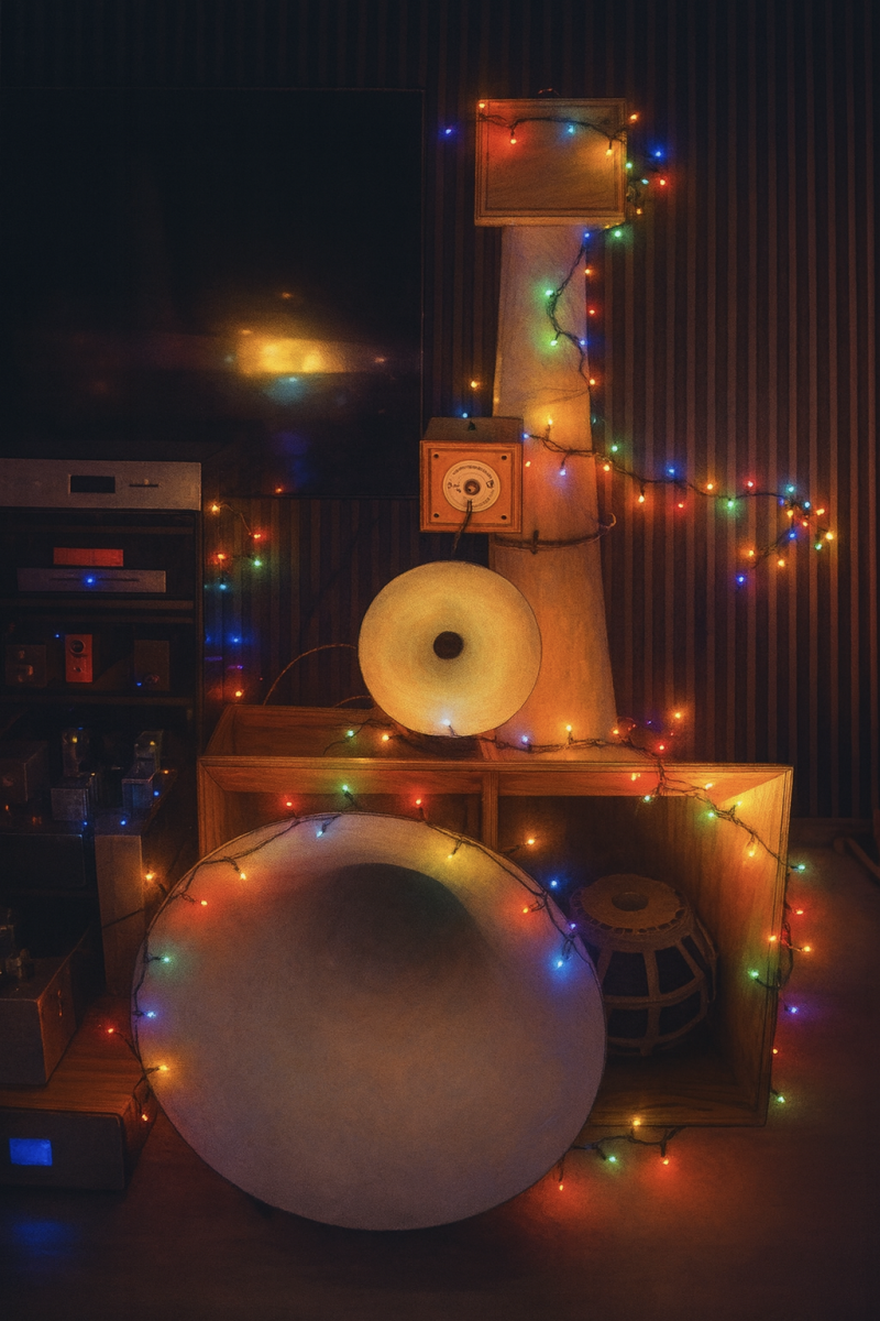

  • Current 4 way (5-way if include the tapped horn sub on the side of the room).   ElectroVoice 15” woofers in J horn bass cabs (<250hz), B&C 8PE21 with Azurahorn AH160 (250hz - 1khz), Radian 760N
  • Rullit Aero 8 field coil drivers paired with azurahorn 340s horns painting beautiful sonic colours through the morning light.

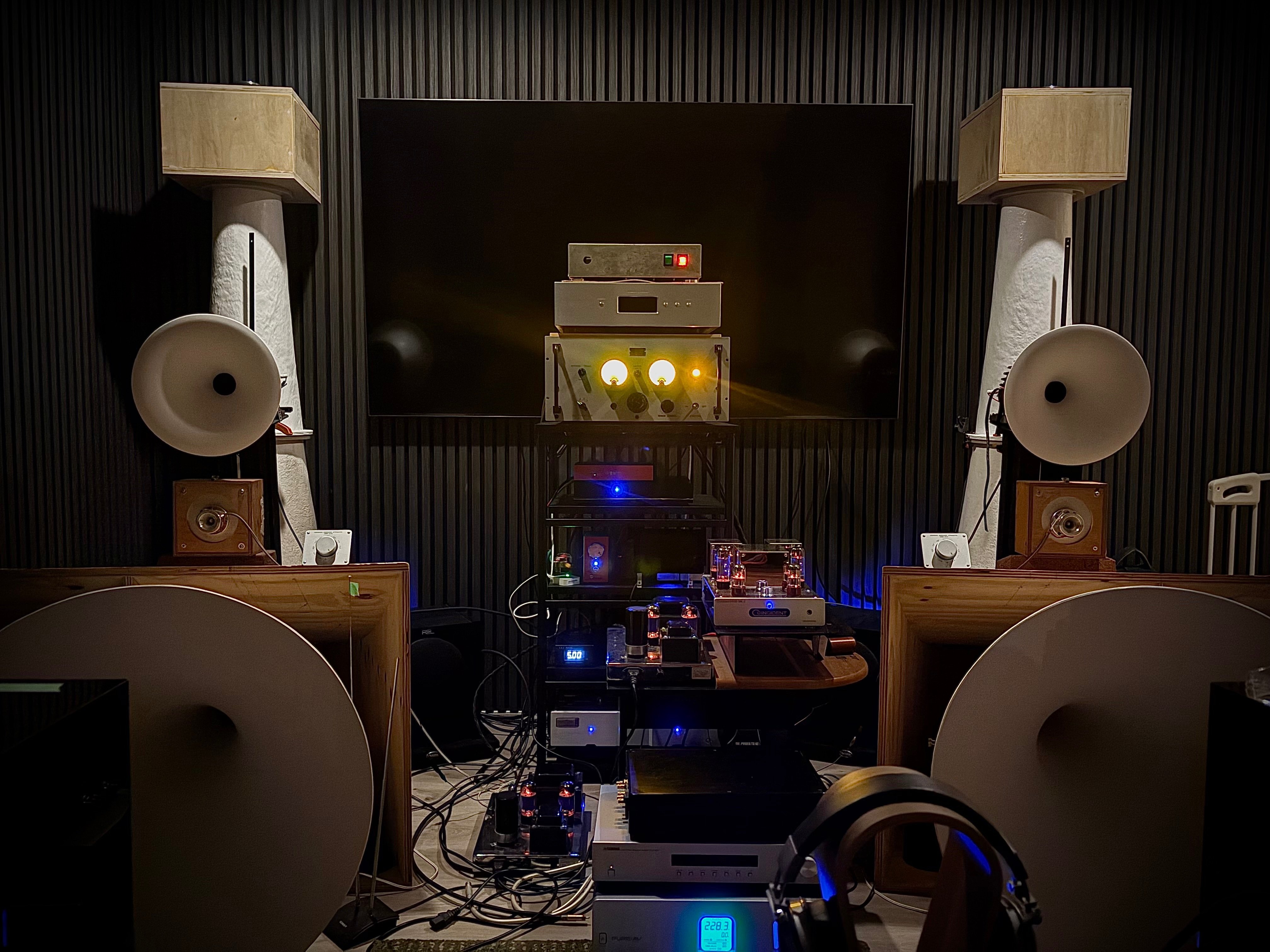

For me, I don’t know if there is a right and wrong when it comes to different types of horns.  I’ve had the chance to play with a few. Listened to as many as I can.  I find everyone listens differently.   there’s  fans and believers of every type..  even among the professionals…
My current take (in this forever ‘journey’) is front end pairing (mainly amp and pre) with horns is ever so more important… I have to eat my words about ‘no more tubes’, as currently have gone back to running a full tube setup including a tube rectified, tube output dac. 😂
I have also boxed up the 8” b&c woofer that is feeding the bass horn. Image and definition has sharpened up a few notches.  The bass energy isn’t deep enough and the RELs are doing an ok job but I would like to shift the rack to the side and put the big tapped bass horn in its place.  I think that’s next steps 😊

thanks mate.
using both the 160s and the bass horns.
>10khz - goto unit sg-160
>1.2khz <10khz  - tad td-4002 with 550hz azurahorn lecleach horn
>250hz <1.2khz - goto unit sg-505tt with 160hz azurahorn lecleach horn
<250hz - b&c 8pe21 mid bass driver with azurahorn 50hz bass horn
<60hz Couple or REL T3 subs managed by Velodyne SMS-1.
mainly all first order cutoffs

You been busy too , lots of changes since last time 🤙
 I like the look of the big Azura 160 residing in the ABH.
Cool new Tube amps and trick LM 129 Pre ☝️ stand out nicely.
Re your ABH  , if your top boxes allow for a 12” wide driver , you can try some of my spare JBL E120 , that go off from 50hz up , 103 db efficiency up higher in the bandwidth , to see if any good.
Sizeable  job in moving your Rack elsewhere ,  be nice if your cables length allows the move.

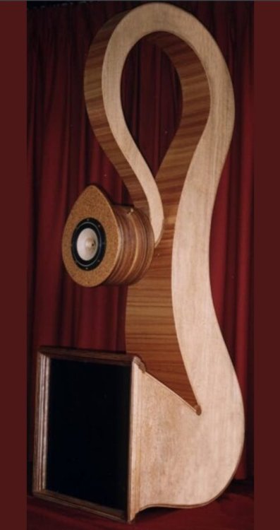

Is that Martin’s bass horn as well? It look as though the vertical throat is hidden behind the curtains. Good stuff
One of the best I ever saw / heard.
Unfortunately, only 2 pairs exist.
Yes, he's offering plans just contact him.
https://www.azurahorn.com/
similar one I believe can be seen in Azura gallery

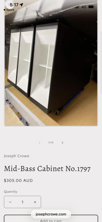

The bass cabs look like these - Joseph Crowe mid bass

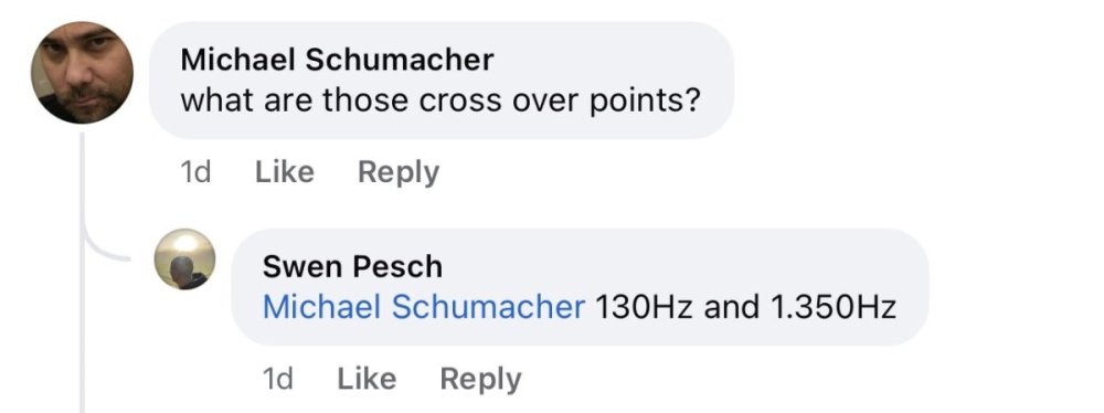

Crossover points for the big 3 way system above is 135hz and 1350hz, which is really quite different to how typically the giant WE15a horn is utilised (ie. let it run unfiltered, so it plays to around 8khz with the WE555 driver before starting to roll off).
With the setup above, the small center positioned high freq horn would be doing 1.35khz onwards, so my guess is it would actually have a more typical modern ‘Hifi’ styled presentation - focused and decent “imaging” (ie. not everything will sound big like the typical traditional WE15a setups that use the horn to play a much wider band). Personally does seem like a bit of a waste to use such a big snail horn for essentially such a narrow band (135-1350hz). Definitely not for the space conscious!
Rekon the Hornsolutions WE 15A upper limit is not chopped at all via their XO and is rolled off via Le Horn, just looking at the Ai guff on these.
Yes as you mentioned , otherwise 180 to 1350 hertz span for that big snail would leave you severely short changed.
My WE 22a hornsies seems happy from 220 hz > 5.6 khz / 12 db however bass below is retarded by 4.730 milli seconds to all align and dissapear and sound as one rather wonderfully.

Someone asked Swen who is owner/designer of hornsolutions re crossover points for the masterpiece setup, he stated those points below.

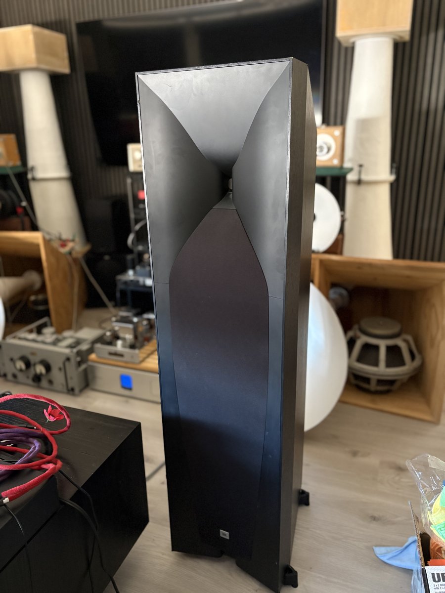

New home theatre speakers. JBL studio 590. Horn loaded from 1.5khz onwards. A really well sorted dynamic sound. Heard them ages ago at the aus melb Hifi show and was really impressed.
A local pair came up for sale so had to grab them!

Decent for the money....

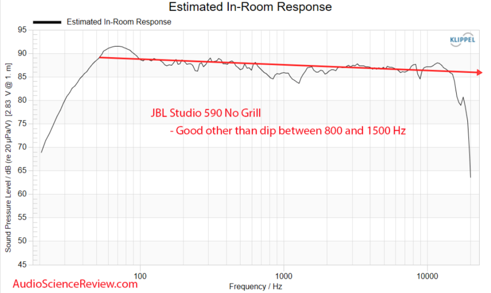

I listened to these a few years back.
For me the 1khz bell dip is quite audible, especially when you side by side the speaker.
That listening session stopped me buying a pair.
DSP linearisation would fix this though.
From ASR https://www.audiosciencereview.com/forum/index.php?threads/jbl-studio-590-speaker-review.47269/
