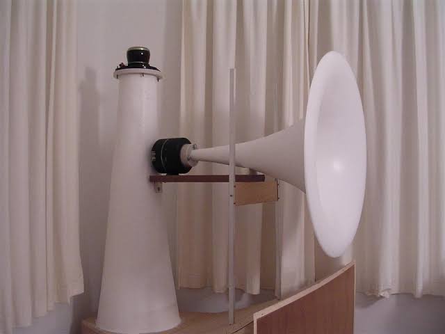

The pair that @Upfront and I had built maybe over decade ago were really great. Loved them paired with goto unit sg-38wn 15” woofers.  They did 50-350hz nicely. The thing I liked most about them was how well they integrated with the midlow horn channel.  I remember thinking of them as the final frontier to my multiway horn journey.
I foolishly disposed of the horn during my ‘leaving hifi’ phase.   But as we all know, the itch never goes away and here we are. 🙂  Reunited with Mick’s pair he had built.  I no longer have the goto unit woofers, but do have some other drivers that hopefully work as well (EV 15b, Altec 515b, JBL E140, PHL 5061m and yamahas).
Martin has also made some beautiful 340hz horns for the 8” rullit fcs. Not much horn loading going on with such a shallow profile for a 8” throat, more like a big waveguide.  Should be a nice combo with the azura bass horns.

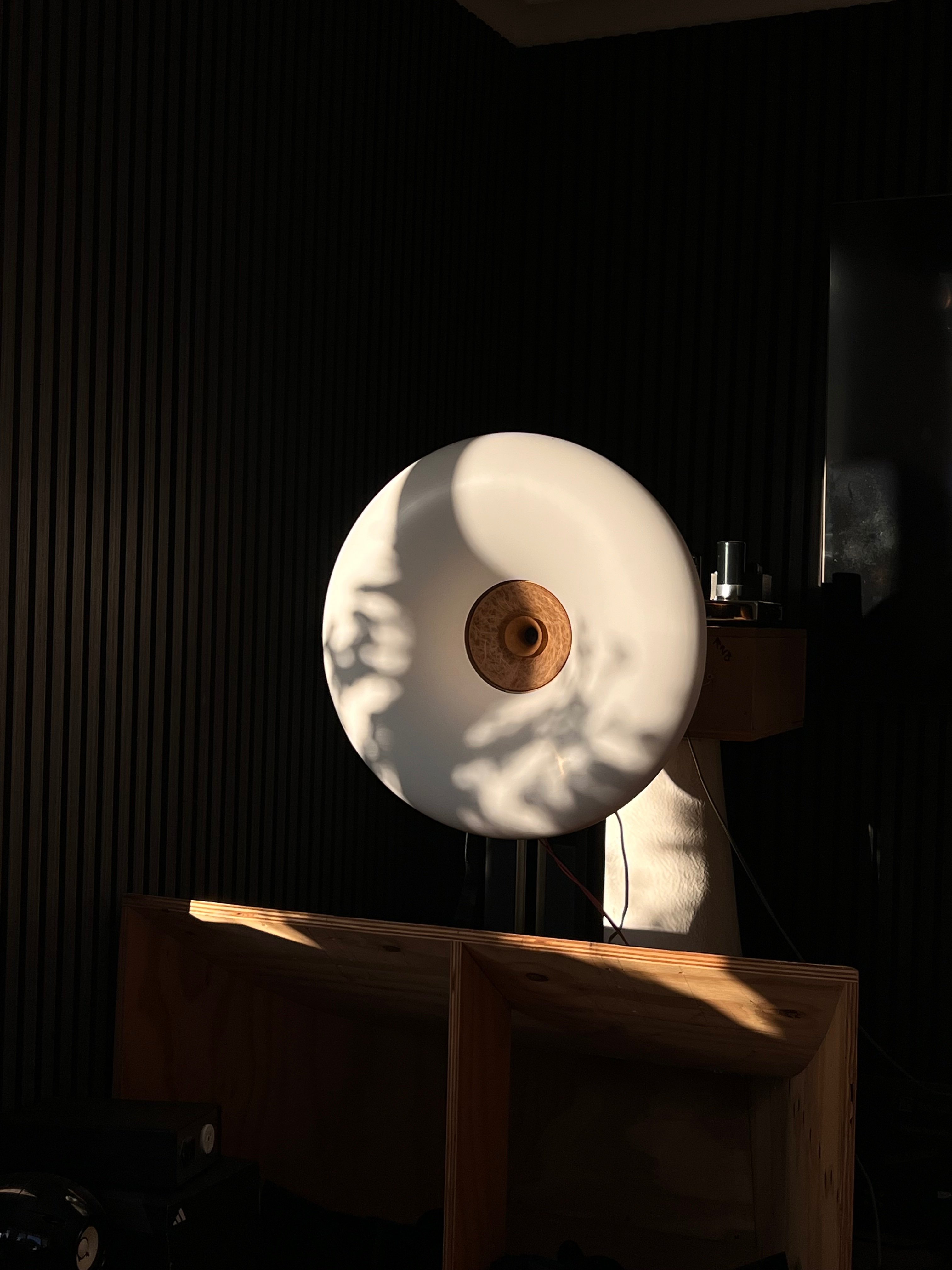

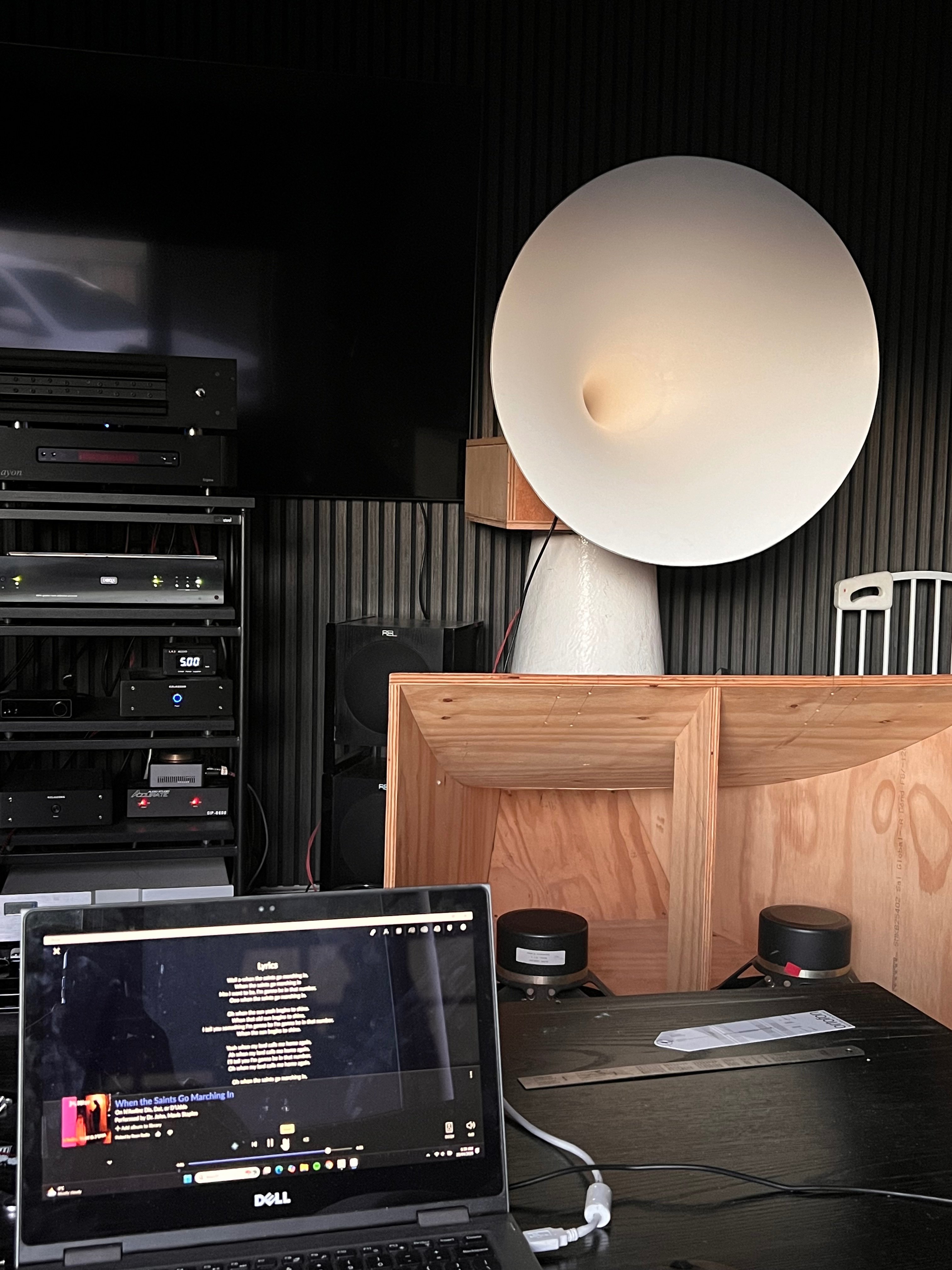

  • Current 4 way (5-way if include the tapped horn sub on the side of the room).   ElectroVoice 15” woofers in J horn bass cabs (<250hz), B&C 8PE21 with Azurahorn AH160 (250hz - 1khz), Radian 760N
  • Rullit Aero 8 field coil drivers paired with azurahorn 340s horns painting beautiful sonic colours through the morning light.

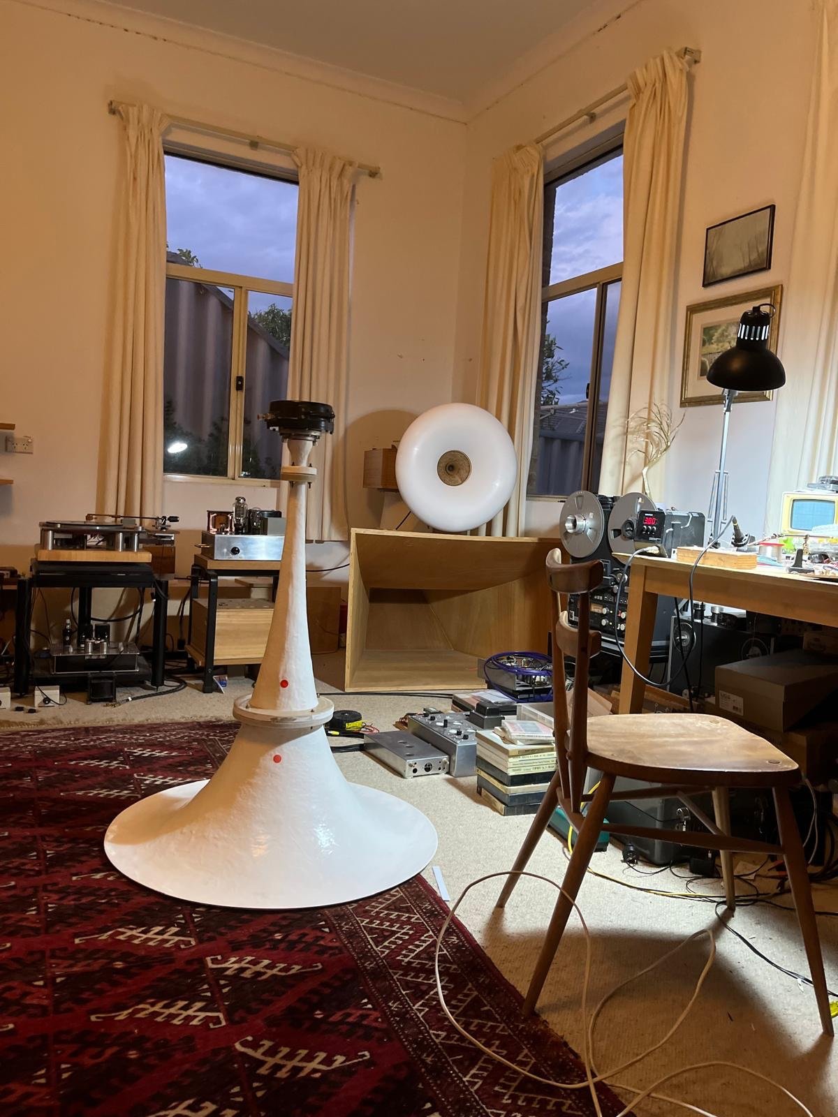

Hey mate,
that’s actually photos of Martin’s room that I have to agree is a great looking room. High ceilings, nice dimensions and has the relaxed/chill feel when listening to music (not too big/dark or over treated/sterile room feel).
he is running a garrard 401 and a modded lenco. I’m not too sure what arms they are but I know a couple of them are his own creations.  Spu and Denon 103 are his carts.    I only run a technics sl1500c with a AT cart nowadays. Basic setup.
I ran my rullit aero 8 on his 160 for a while.  I ran it full range (essentially a wide band driver) but needed bass and treble support (azura bass horn and goto unit tweeter).    I liked that setup but was a long time ago.    Horn loading the rullit with big 160 horn (no rear enclose) really skews the freq response to have too much midrange energy as compared to when running the rullit in OB or ported.    I’ve never heard the rullits in a the large floorstanding square front horns I’ve seen online before so curious on how you find them 🙂    There’s a few 15” fc woofer options out there now.   WVL, EMS Fertin, ESONIC from Canada, Rullits, GIP, Kanzen….   They all look really good. Interested to hear how you find yours!   Im Not sure what direction I will take re for bass yet. Currently running a JBL e130 in the bass horns.
What Martin has made for me now is a pair of 340hz profile horns for the rullits. Very shallow as the throats only go to an 8” throat.  More like a waveguide than that much horn loading happening.    I got the idea from Murat doing similar with his AER driver (https://www.diyaudio.com/community/threads/goto-6-way-timealigned-horn-system.282736/page-16).
sounded great in Martin’s system. I’ve yet to set it up on my setup.   Running a TAD 4002 be driver on the 160s currently. Enjoyable!
After all these years, I’m still completely addicted to listening and playing with horn speakers, even though my listening room keeps getting smaller 😂
hope you are doing well!

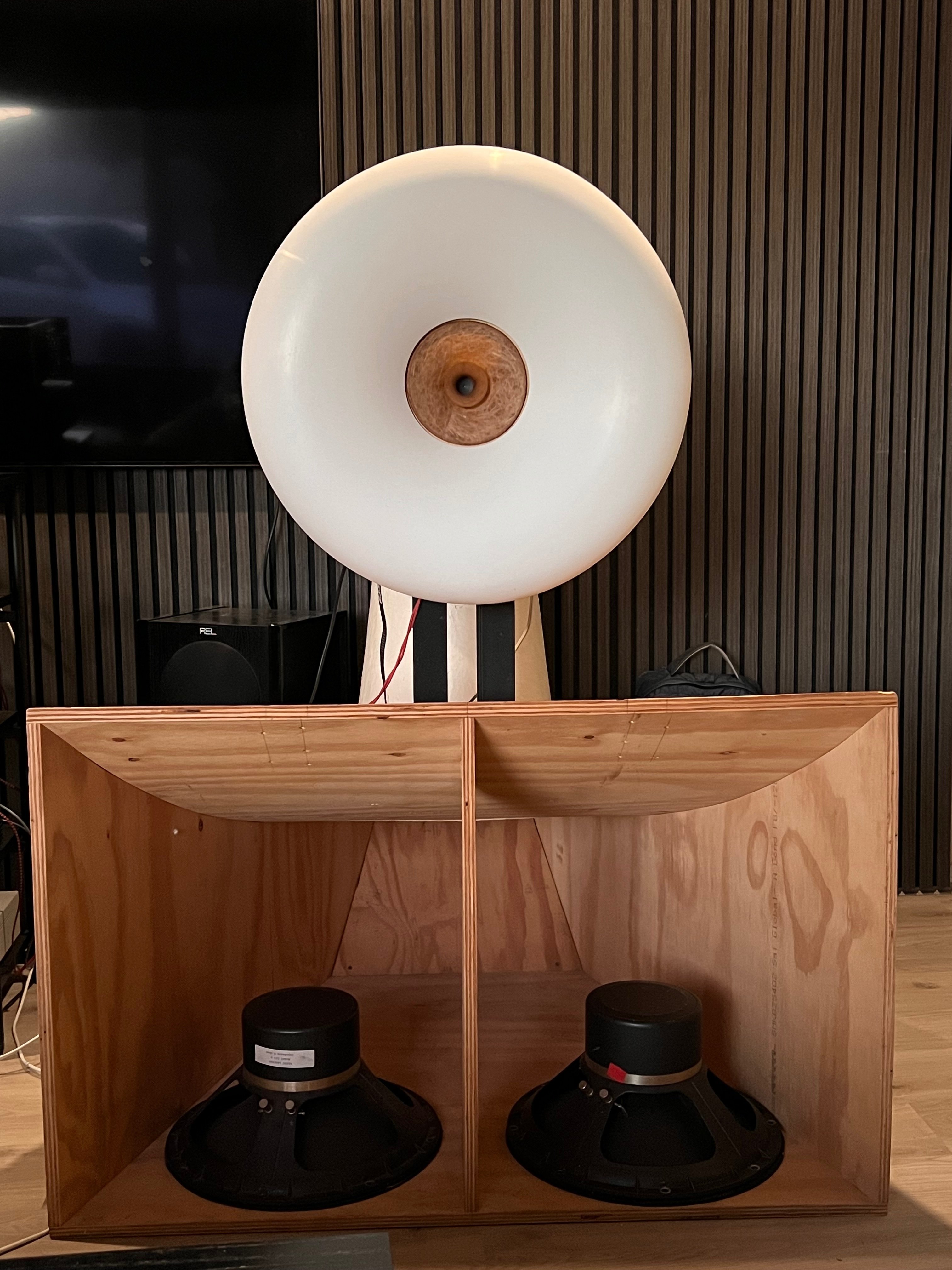

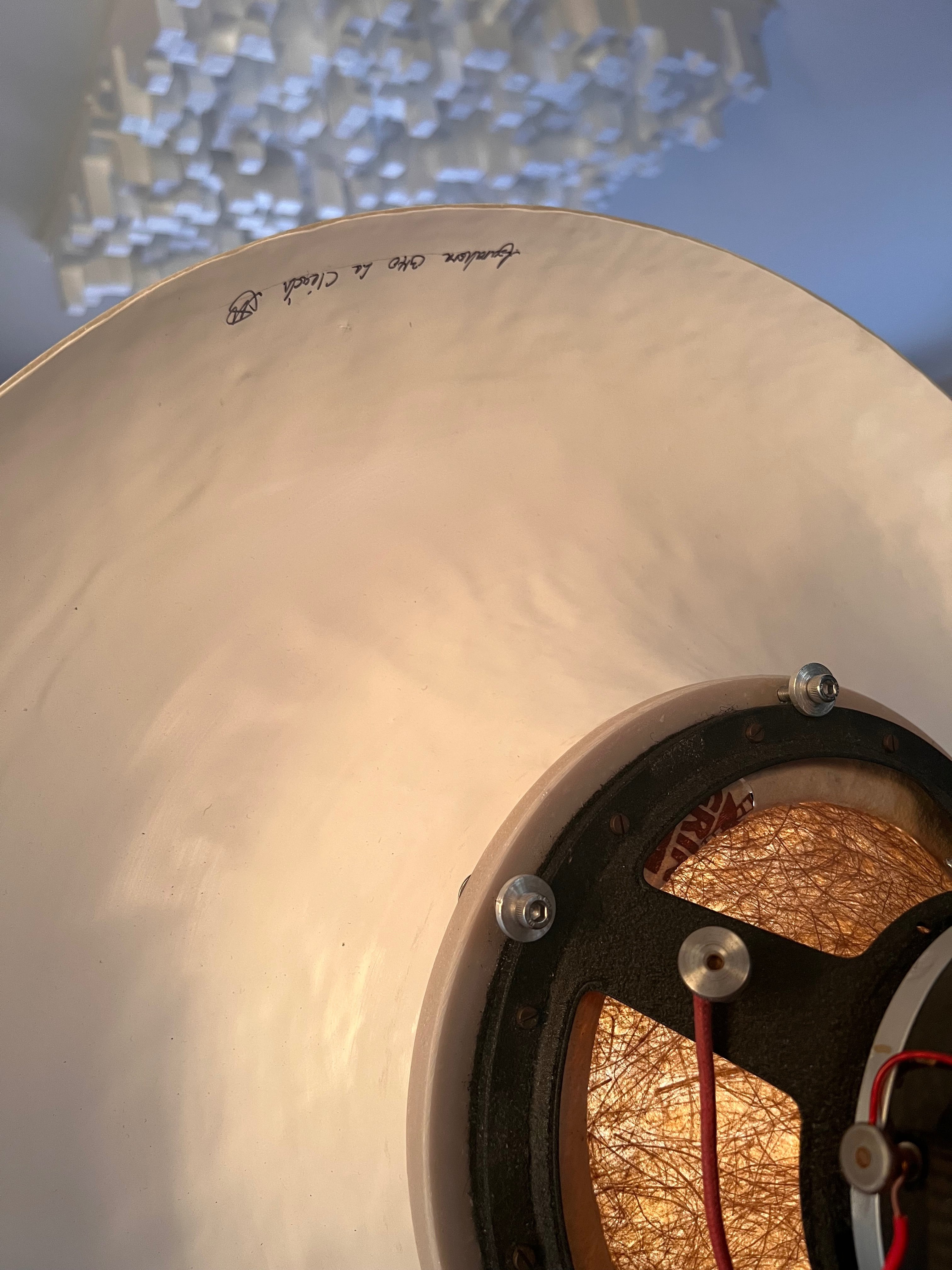

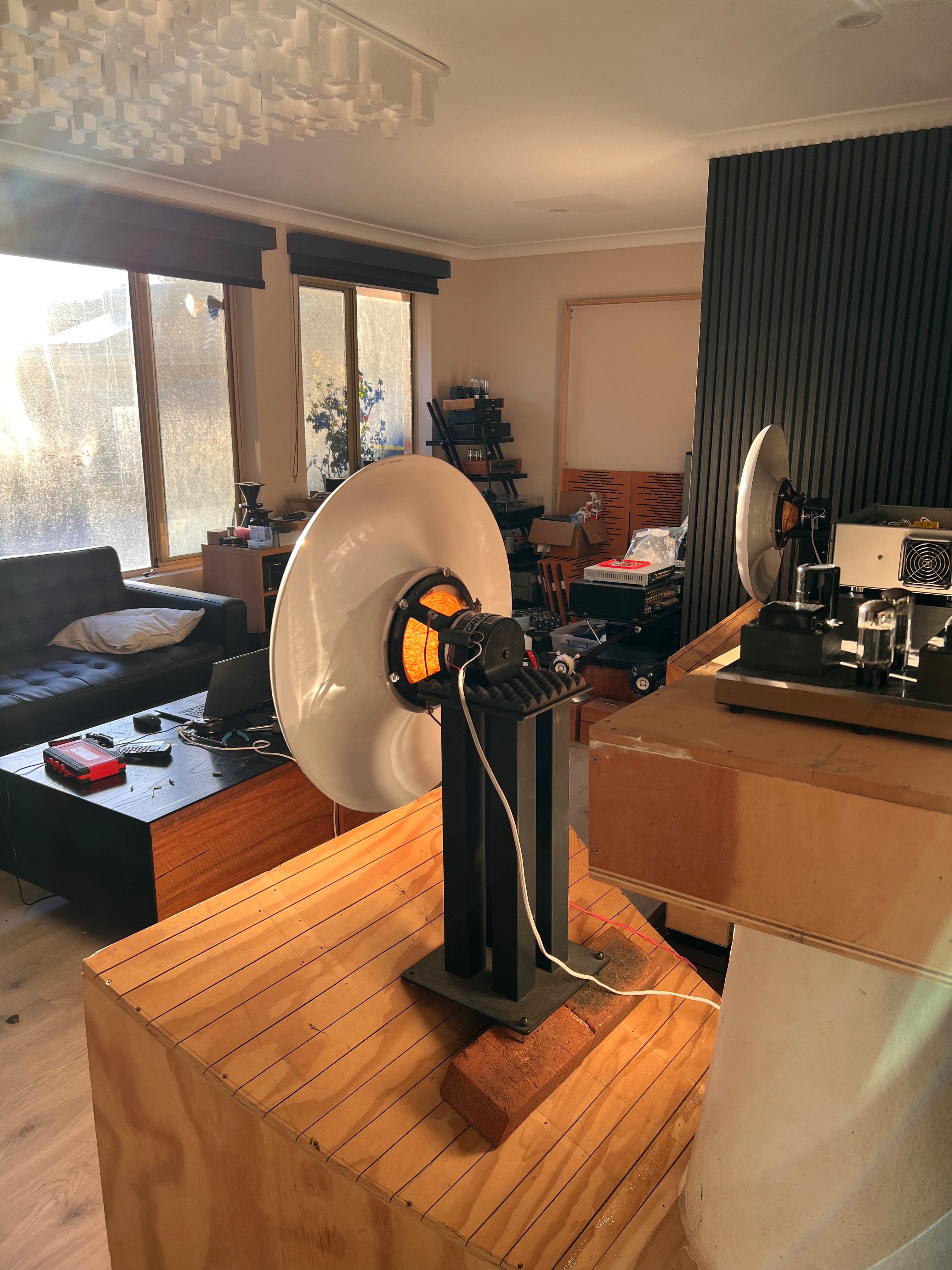

Yay I finally get to post in this thread 🥰.  These are my next horns.  Also my first and probably last horns.  Avantgarde Colibri crossed to 15” REL subs @ 75Hz via minidsp and Dirac applied.  Best sound I’ve ever experienced in my home.IMG_0163.thumb.jpeg.a92b6e6e8c3ce7986085de6193ca7a37.jpeg

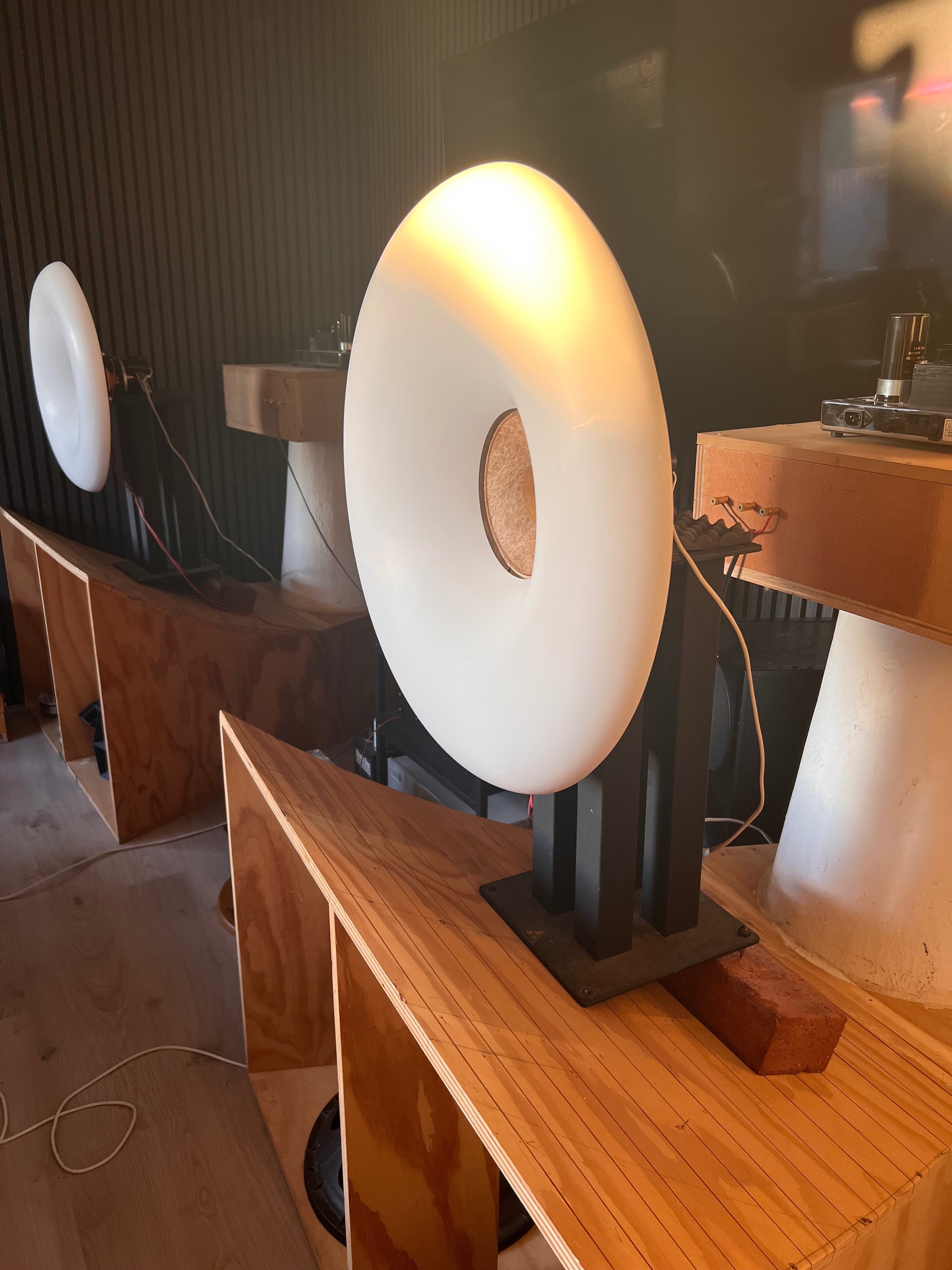

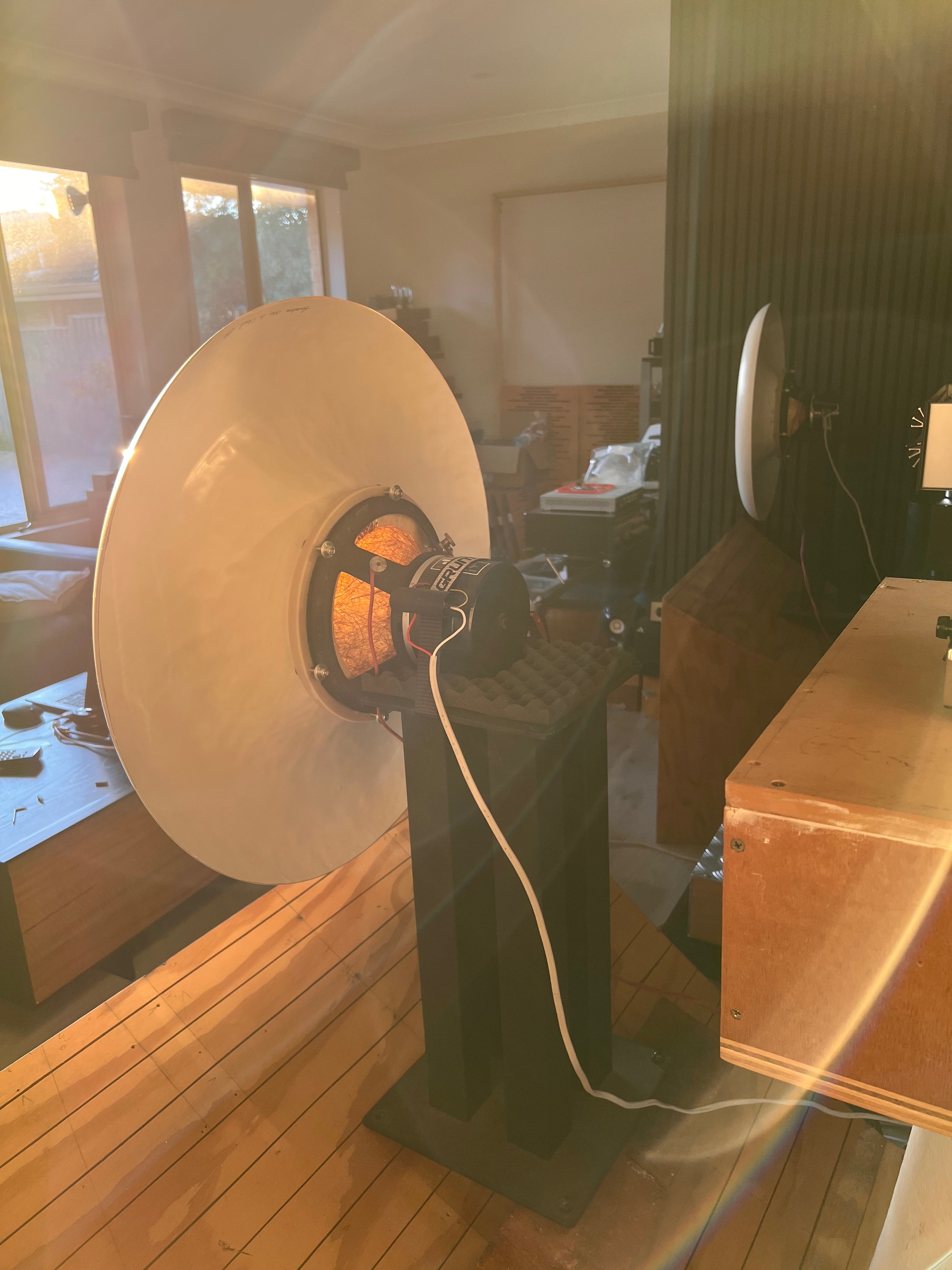

beautiful horns, drivers and set up Tuyen. With those images we can almost hear the magic. Good stuff! You have been busy lately.
Alan.
Nice use of the speaker stands

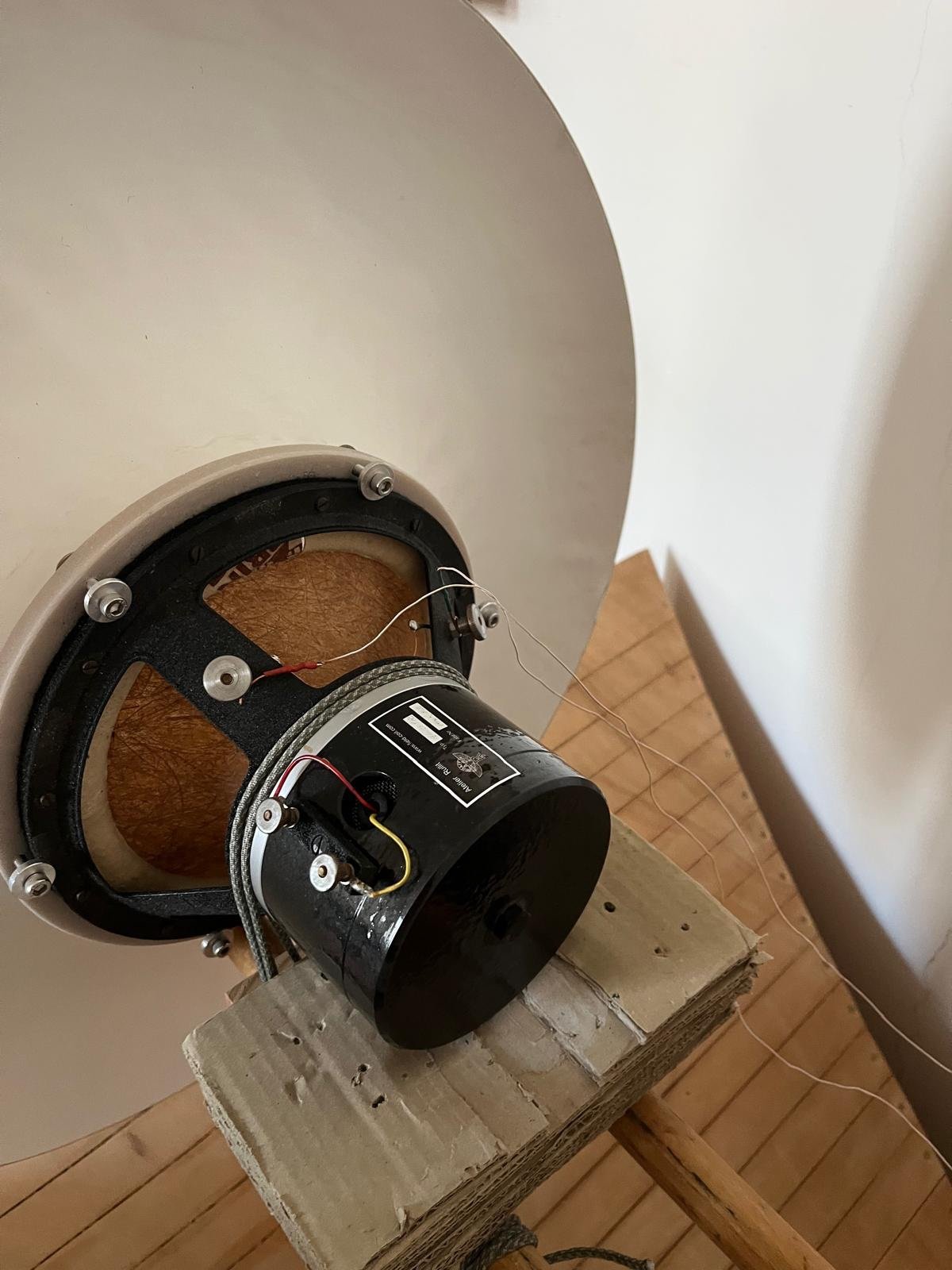

Amazing set-up Tuyen, what fabulous and exotic gear you have assembled, - and keep assembling. Would love to hear it all one day. Are the horn drivers physically attached to the stands in any way, can't see from the photo's. I reckon a big long tie-rap would be the order of the day if not, would be a great shame to knock one off someday.
 Thanks Ged.
Certainly welcome to come by have a listen and catchup sometime.  Have a few hours most weekends that I am free from daddy duties to chill and play hifi 🙂 I’ll msg you…
regarding the horn drivers, there is a pull tie down strap that secures the driver (most of the weight) to the speaker stand (very heavy as it’s sand filled).  Difficult to push it over but not impossible..

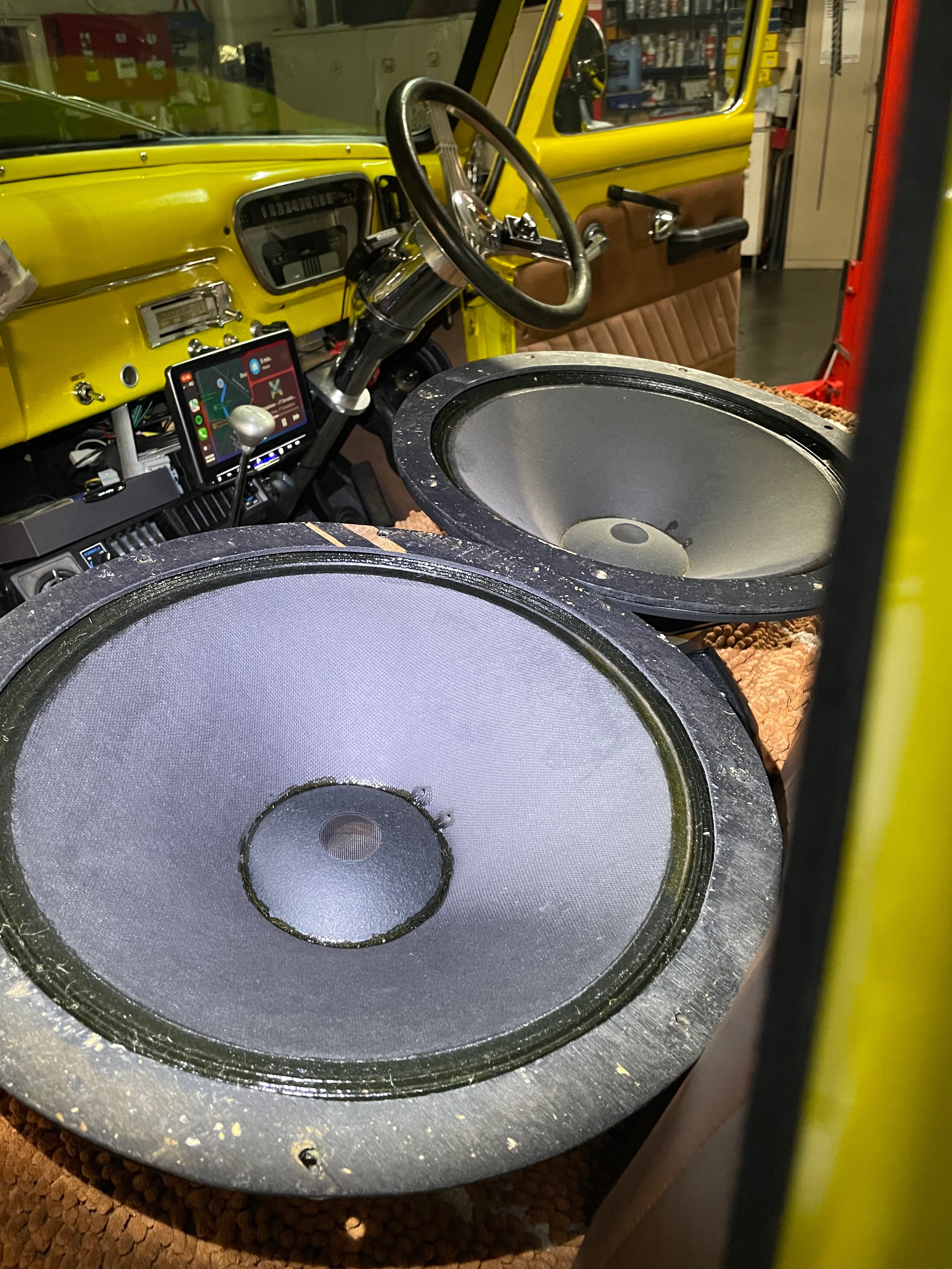

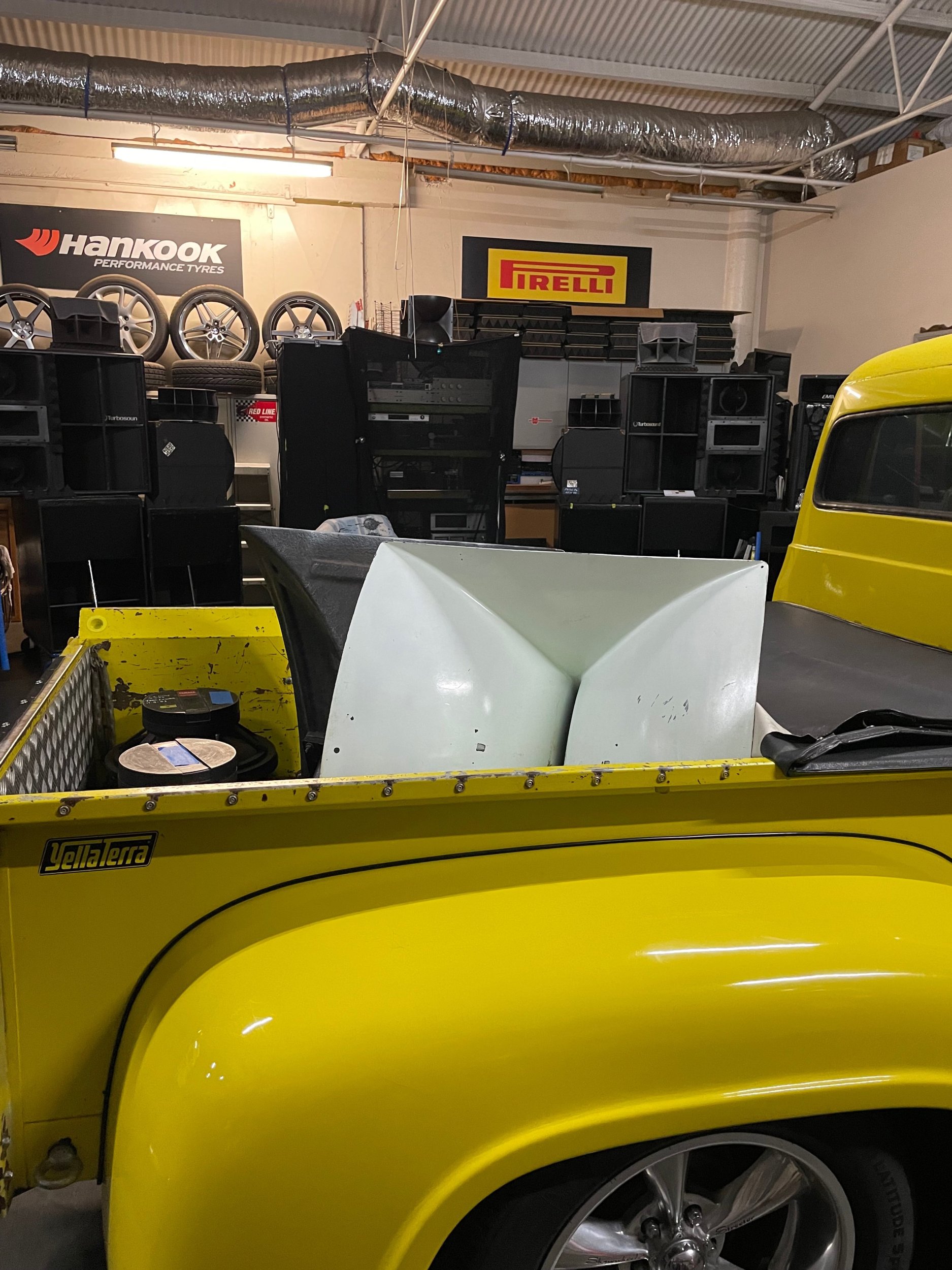

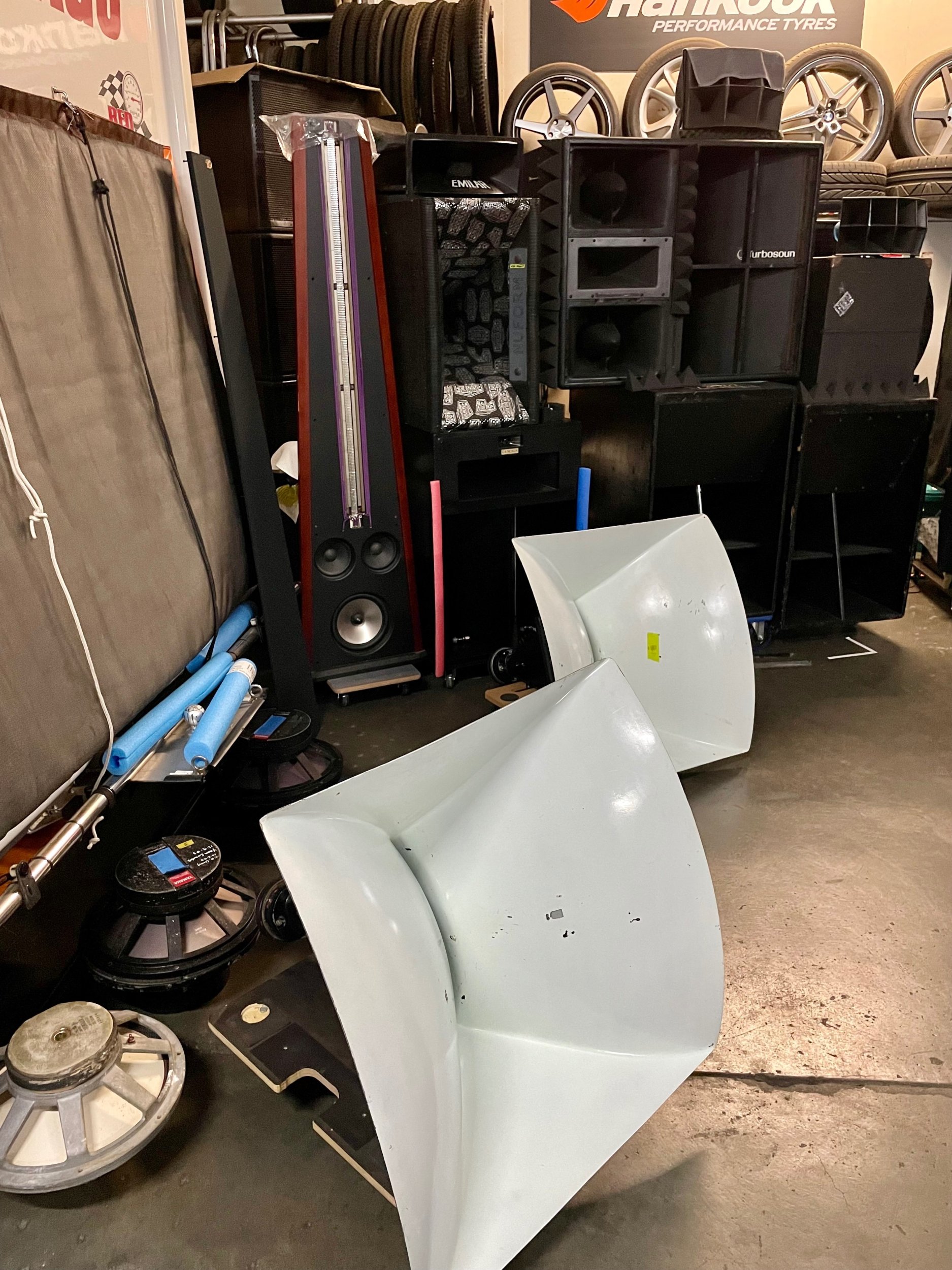

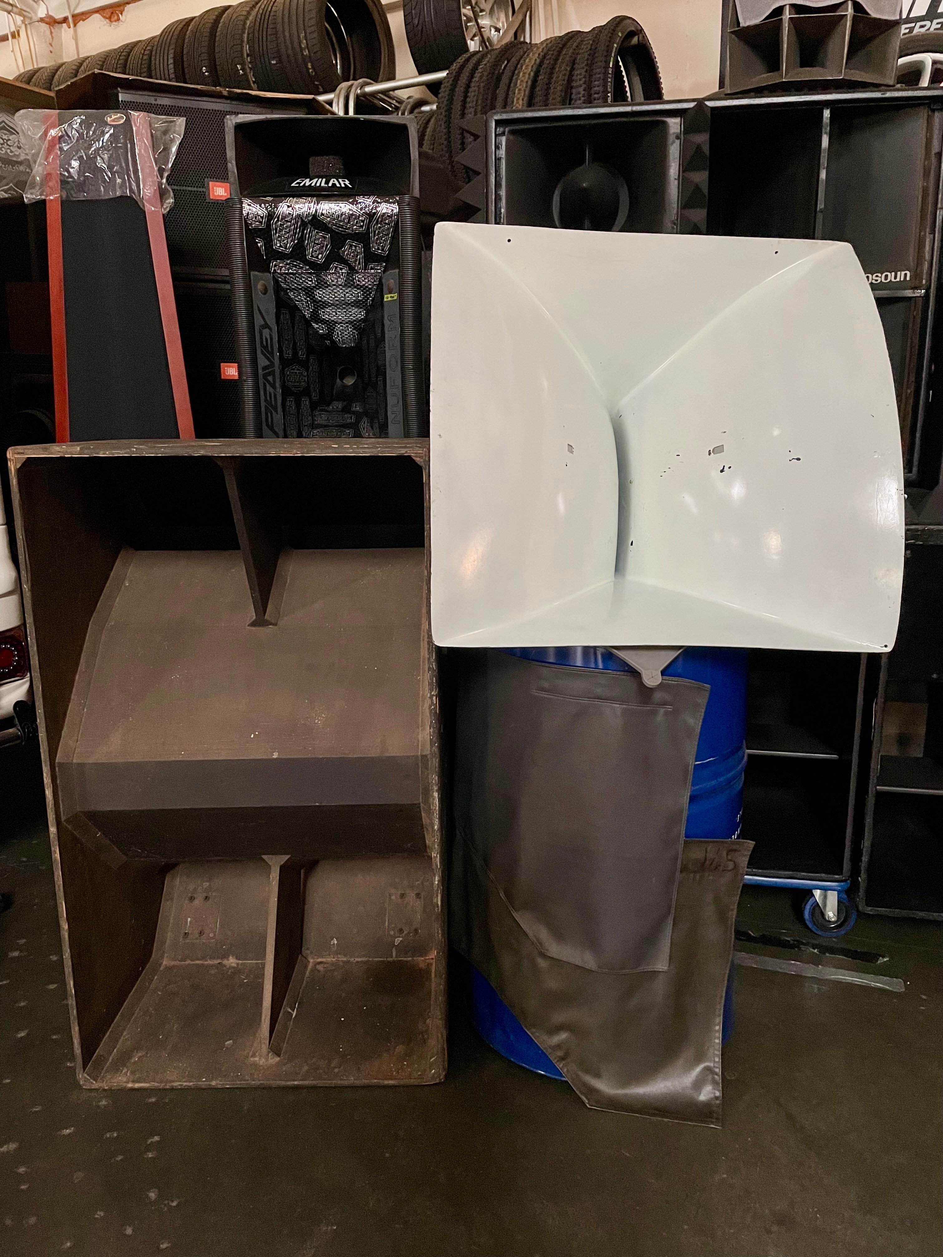

Excited to play with some newly acquired Vintage Relics , many thanks again to Tuyen.
Altec 515B 15” Drivers and the Micks ex monster JBL 2360 Horns.
Couldn’t wait for quick sound check , amazed at the 515a feel of their soft super linear suspension , bolted the Altec 515 woofers into the old Folded Horns from Altec model 1215A and sounding just beautiful, far exceeds the La Scala / JBL E140 bass bin sound.
Bolted on a spare  JBL 2240 comp drivers to the giant JBL horns ,  wow , also a treat to listen to as unlike normally being too shouty and in your face sounding , these horns offer a softer and far wider soundstage with a softer power projection , it’s  just huge and very easy on the ears. Similar tone to the Line Magnetic LM3 WE 12a mid horn in a way.
Lots to do but very promising so far for a rewarding new build. Thankful to have the available room to accomodate such massive units.
Happy Days… studio 23

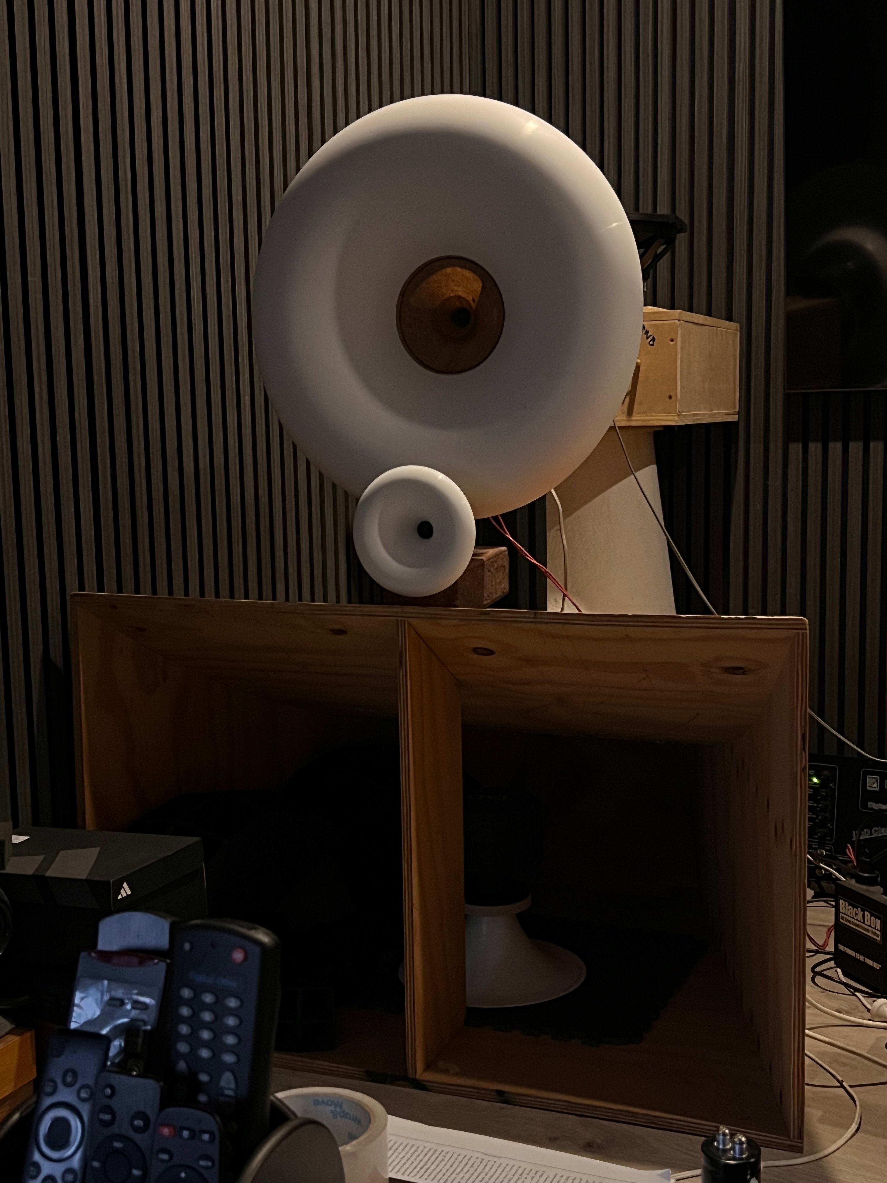

I’ve hooked in some horn tweeters with a 2uf cap (faital pro hf108r + azurahorn ah-1100) to add in bit more sparkle above the rullit field coils.  Be rolling in around 10khz.    All fun!

Those 2360's are real nice horns. They project deep and wide. Beautiful build design and construction too with the huge aluminium throat section.

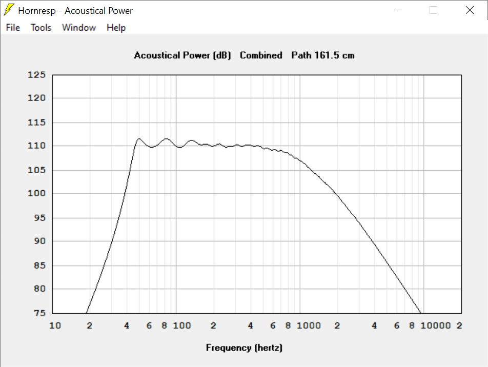

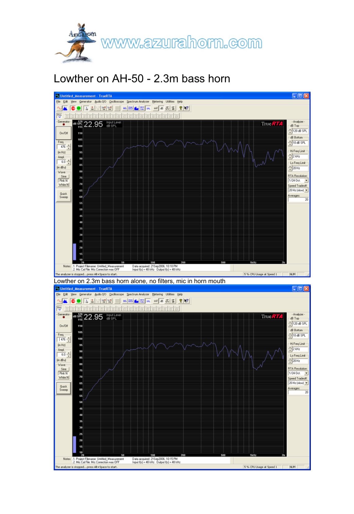

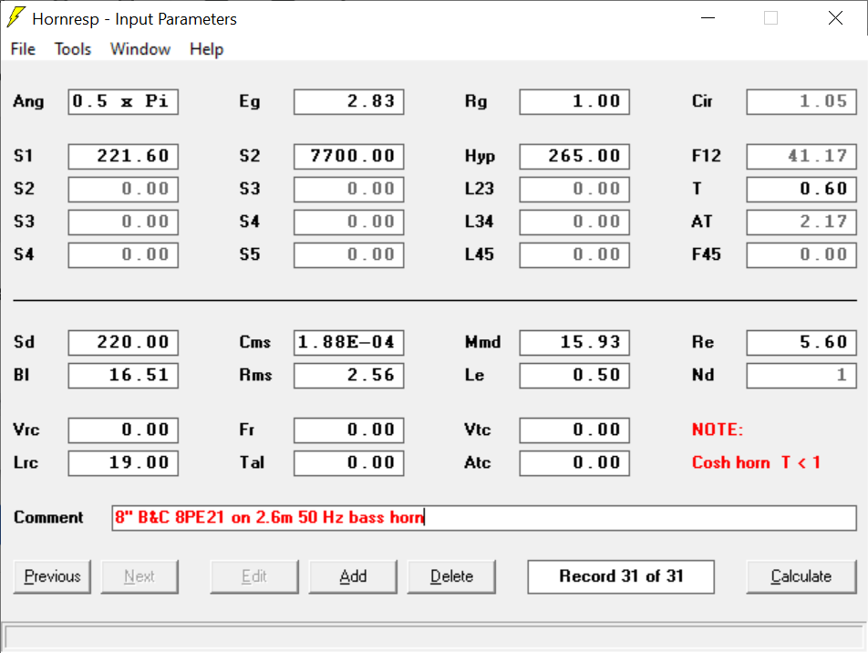

Martin (Azurahorn) currently working on a bolt-on throat extension for the bass horns to run a 8” driver (ie b&c 8pe21).  Modelling on hornresp looks like a good match.    Martin ran a lowther 8” fr driver many moons ago and the freq response looks very good.     It will certainly be interesting to hear how bass from a front horn loaded 8” driver with a much lighter cone than say a 15” woofer is…
Interesting! Would you then need another bass horn to cross below the 8”..?
What efficiency are you hoping for?
Testing the bigger is better theory! Good luck
Calculated output of b&c 8PE21.
A sub bass channel below the bass horn is not essential but it helps. I have a single tapped horn with a JBL 2225h 15”  that is tuned to get below 30hz with very little effort.  Also a pair of REL t3 in case there’s some gaps that needs filling.
