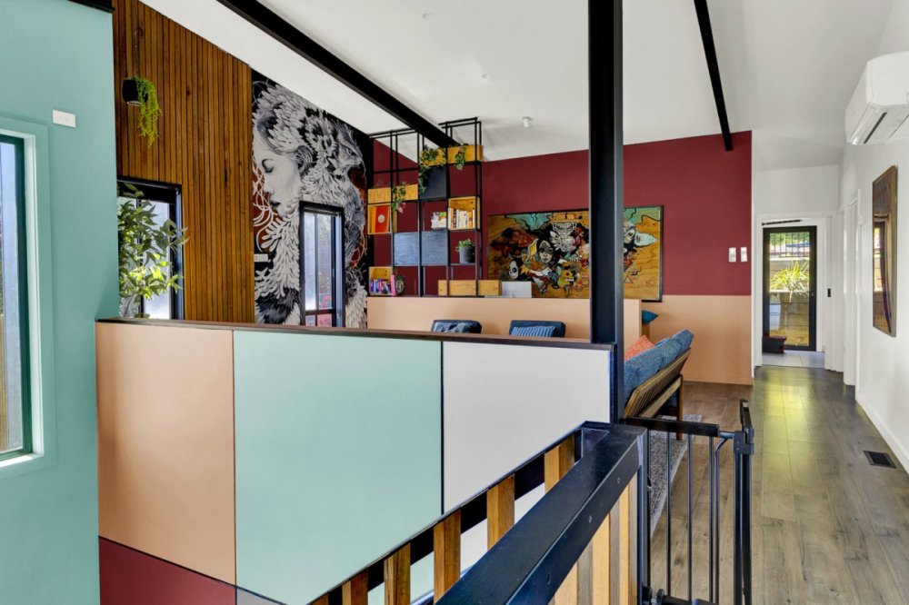

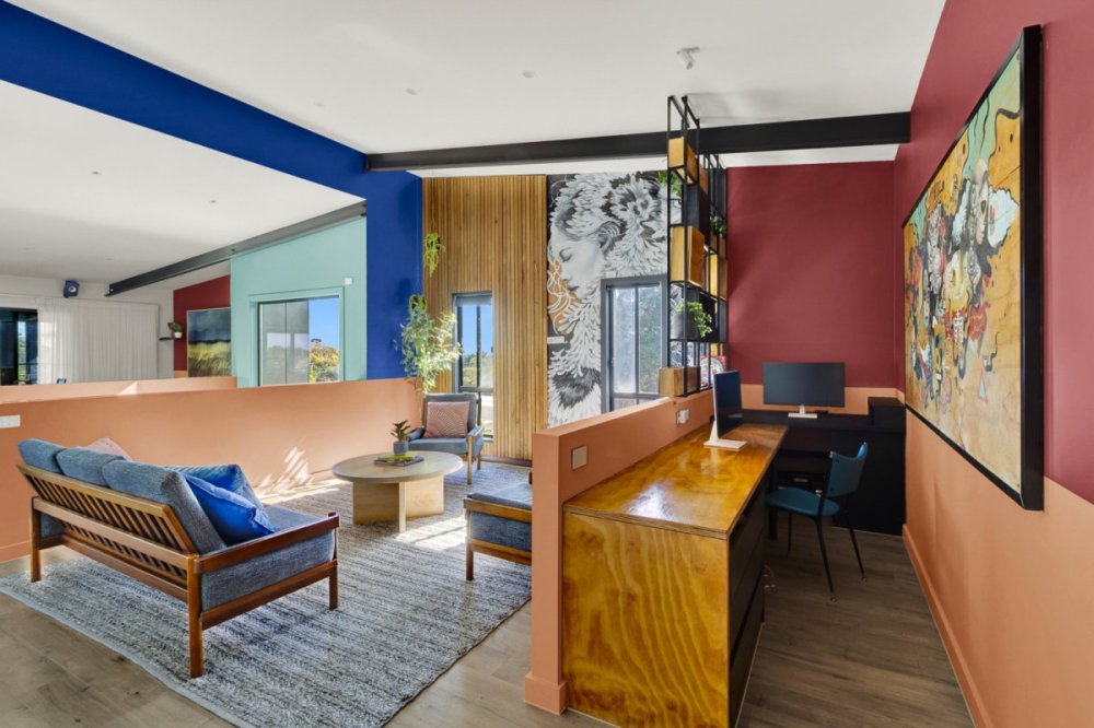

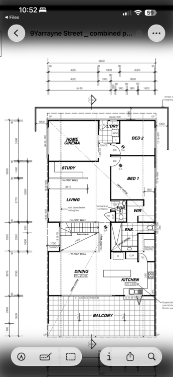

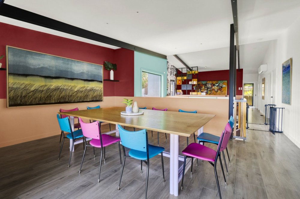

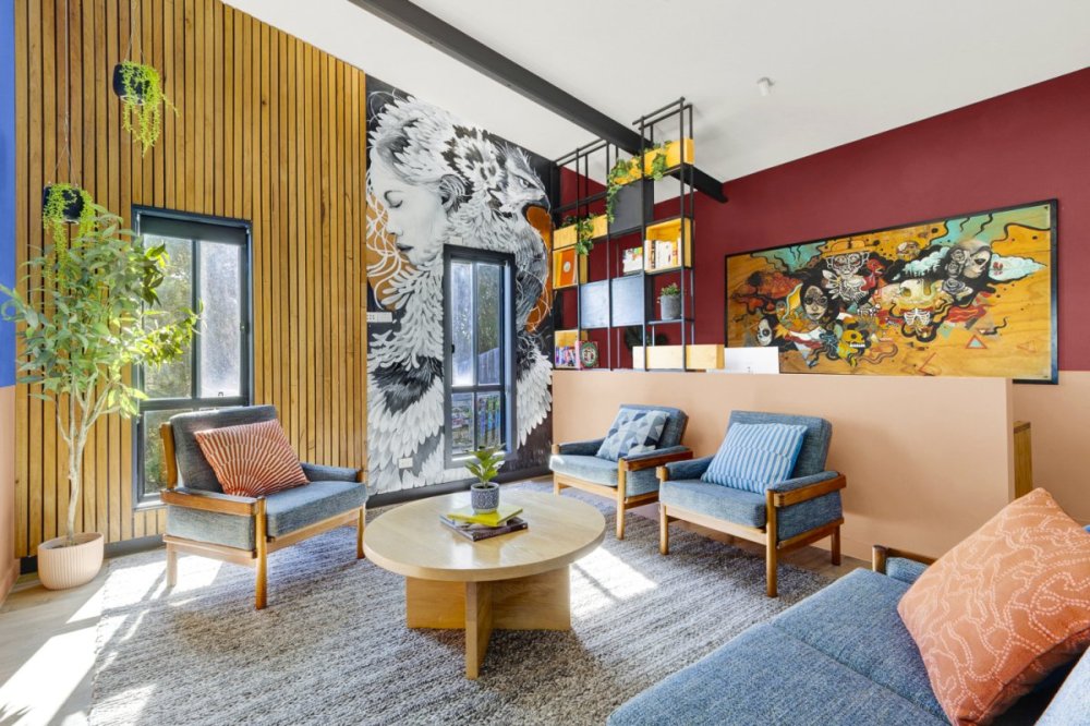

I have large holiday house on the mornington peninsula where we have a lot of family and friends over so it’s quite a social place and I’m trying to setup a wall as a library/bar/listening wall. Attached is the floor plan and some photos currently and it will the wall adjoining the cinema room. The study area will be demolished.
The wall is 4.4m x 3m and the area  im trying to setup is 5.4 m wide and 6 m long and that leads into another 7 x 5.4 m space with just 1 m walls in the middle so it’s quite a large open plan area.

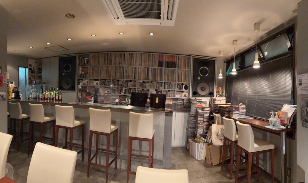

fwiw...imo.. etc...the retro JBL, black or blue front baffle, soffit mounted, large bass driver vibe would be most in keeping. Pref with high biased Class A SS or toob amps. And if possible predominantly physical media (rekkids and/or CDs) but also some streaming for when that is convenient.

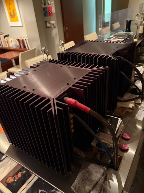

Quick pics below from a J visit last year, and oodles of inspiration in the Jazz Kissa magazines, or onlineIMG_5916.JPG
