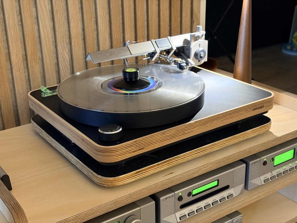

  • Here's mine - a Qubelok frame with squash balls under:       Air suspension works well!

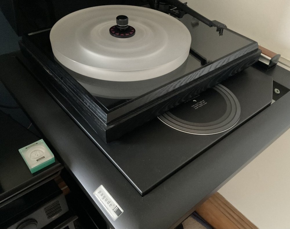

    Happy New Year from Scotland. My PT Anniversary deck has a very lively suspension and is highly susceptible to footfalls, the designated area in the living room is a suspended timber floor which no a
My PT Anniversary deck has a very lively suspension and is highly susceptible to footfalls, the designated area in the living room is a suspended timber floor which no amount of repositioning could take care of unwanted vibration.
The solution was to install a cantilevered Finite Elemente Pagode Master Reference wall shelf. This also involved fitting the shelf on an interior load bearing wall as the external wall is dry lined, a compromise but ultimately successful work around.
