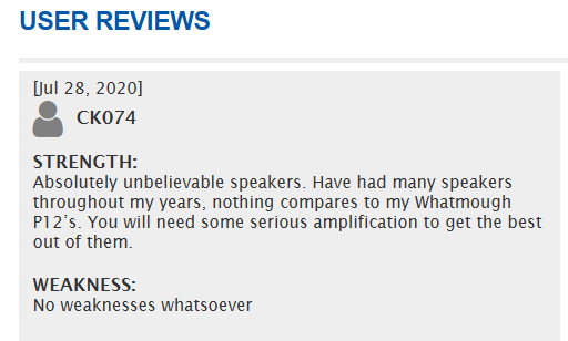

If you really were considering the EVO 150, S-M ... I note that it is 150wpc - whereas the PowerNode is only 80wpc.
Now the only info about your Whatmough P12s that I can find ... is that they are nominally 8 ohms.  But given this comment:
... I suspect the amp which has a bigger PS (so it can drive low-impedance spkrs better than an amp which has a small PS) - ie. the EVO 150 - will make the P12s sound better than the PowerNode.  But yes, it's more expensive.  :sad:

The label on mine say 150w and nominal 4 ohm
I think the Evo may have the power to destroy them with 250 into 4ohm?  Or at least I'm not yet sure at what point the amp gets to much for speakers.

Aah, OK - so they really are 'hard to drive'.  :sad:
