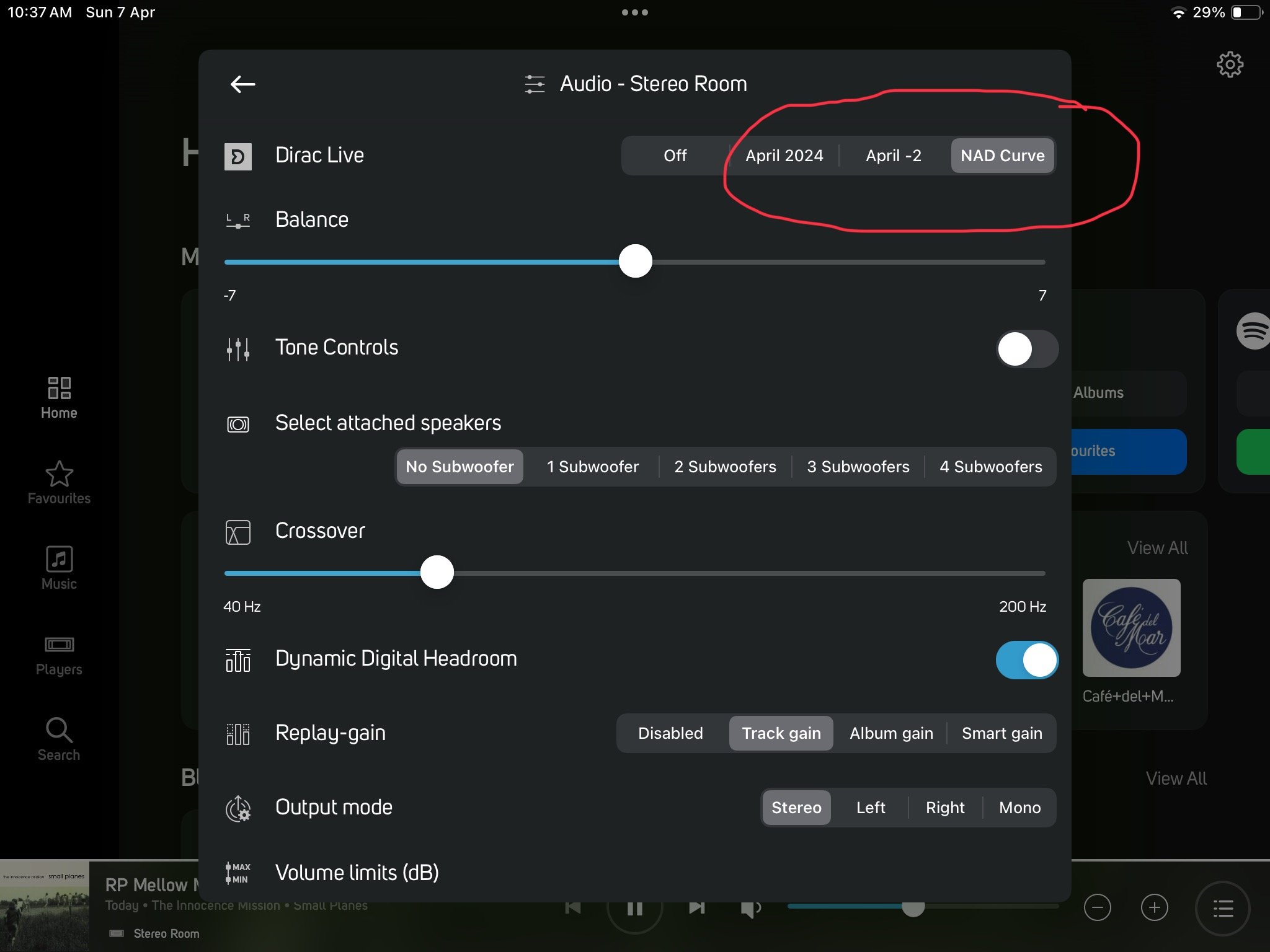

pcking Posted April 7 Share Posted April 7 (edited) Morning All, I did a recalibration, and it sounds better. I loaded the Dirac NAD Curve (I think ) . So I will switch between the 2 curves over the next few days. Thanks for your everyone. Edited April 7 by pcking 1 Link to comment Share on other sites More sharing options...

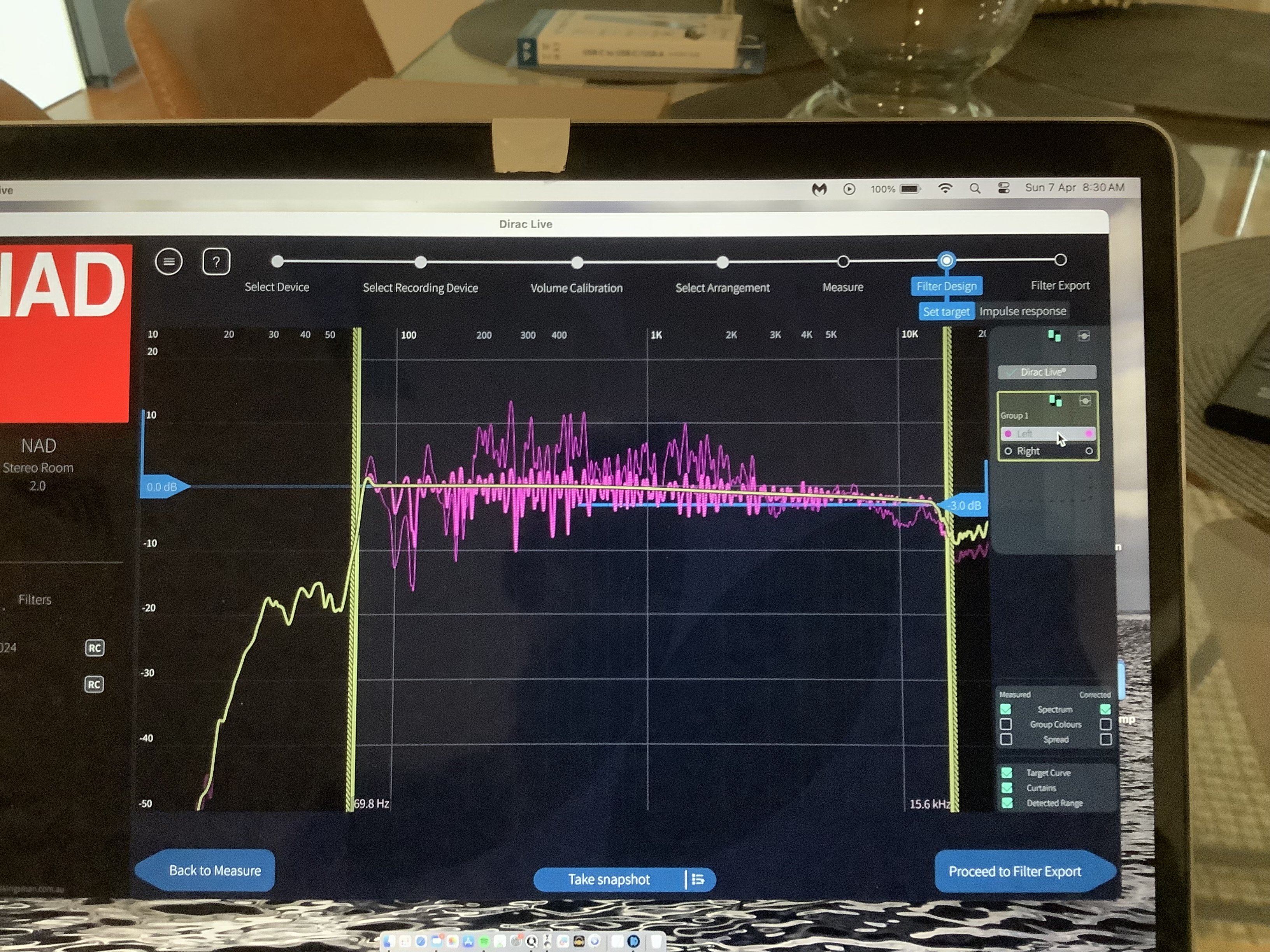

pcking Posted April 7 Share Posted April 7 I just realised my MacBook has a built in microphone ,so I hope it didn't do the calibration instead of the NAD Mic ? Link to comment Share on other sites More sharing options...
Hi-Fi Whipped Posted April 7 Share Posted April 7 47 minutes ago, pcking said: I just realised my MacBook has a built in microphone ,so I hope it didn't do the calibration instead of the NAD Mic ? If you click on to the measuring device section of your project now, it may show which mic was used? Not at home to check so may not work. but yeh you need to tell Dirac which mic to use at the start of the process. Link to comment Share on other sites More sharing options...
