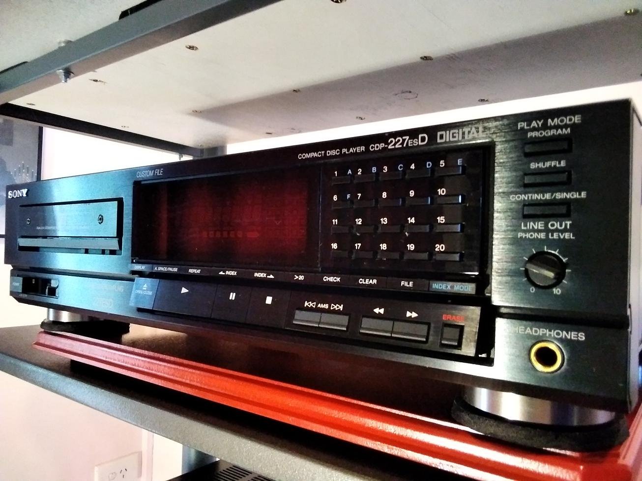

On 22/03/2021 at 9:30 PM, BuzzzFuzzz said:
This CD deck was also recommended by another member, from a different member...
Sony CDP-227ESD
This unit is quite well regarded, and benefits from some upgrade modifications.
It too has developed a static like sound during playback, and will be on it's way for repairs in Melbourne very soon...  hopefully upgraded at the same time, but, I'll have to wait and see on that one.
G'day Folks.
It seems to be a little challenging to pinpoint and solve the issue with this deck.  It's in Melbourne being looked at, as it emits a digital hash like sound during playback.  It's been serviced, but the problem is eluding us.
Can hear what sounds like digital hash on the outputs (and headphone) so ive tried tweaking some pots to see if I can get it to come good (in case it was tracking error) along with cleaning the laser assembly and the problem remained so ive taken out the main board and tested the caps. All appear to be good except one which ive replaced and the issue still remains so im running out of ideas on what to do.
Does anyone have any experience they could share here, please?

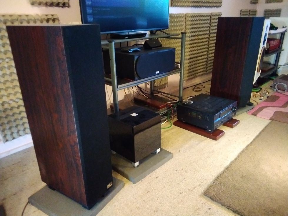

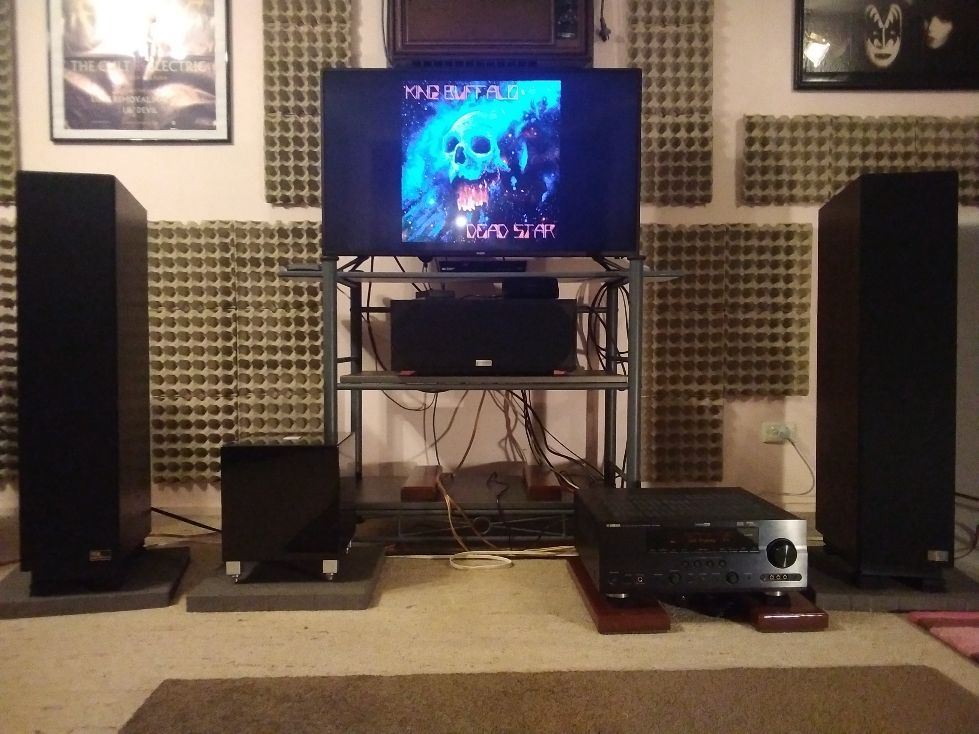

A few changes here, with a different line up after picking up a Rel T5 sub from @TheBlackDisc, thanks mate, always great to catch up.  A lovely addition to the household, paired with some TDL RTL3's as fronts, then supported by Mission 782's as rears, an Axis centre, and running off a Yamaha RX-V861.  I'm listening to lossless files through the trusty Philips media player, optical out.
The Yamaha came from another member a few months ago, waiting in the wings while I enjoyed the Denon AVC-A1 in Direct mode.  The Yamaha has HDMI inputs, the Denon doesn't.  I bought it to have my first experience with surround sound.  I've been putting it off for a while, until...  I'm ashamed and embarrassed to admit, I blew up yet another amp, the Denon, by rushing to wire up the crossovers before work, coming home, forgetting to check, and after 15 minutes playing I cranked the volume...  flash / bang / puff.  I'd wired one section incorrectly.
I wish I could offer some words of caution, or better yet wisdom, but it seems I don't learn some things.  Double check everything and don't rush.
The Denon is being repaired by a local tech, way out west, and should be home very soon.
While the Yamaha doesn't match the Denon, it was obvious straight away, it's merely different.  I prefer the Denon as it seems to have a bit more weight behind the music.  I always try to give any changes a good, few days of ear adjustment, and I'm enjoying the current set up.  The Rel T5 has an 8", downward firing driver.  I'm normally running a 10" Energy, front firing sub, and the first impression was the bass is not as big.  It's more refined and in control with faster attack, but not as 'big' in the room.  That's not a negative.  I like to have those characteristics in the bottom end, and I rarely play loud anymore.
Hey @Uncle Seth  Thanks mate.
I have a Mini DSP 2x4 and Umik1 to play around with soon, for speaker measurement.  I still haven't done any active room correction, I'm a bit of a slow learner.  I'm getting there with the speaker modifications, attempting to get the cabinets finished before measuring.  I know that once measured, tweaked and sounding good, it will be very, very difficult to pull them apart for finishing.
When my amps and other bits return from repairs in Melbourne & Sydney, I'll put the Yammy on the bottom shelf and close off the back of the rack with some thin, painted ply.  The Denon will go back in it's spot for Direct Stereo.  I can't use the sub in Pure Direct mode on the Yamaha, I can with the Denon.  I listen to music through 2 Chanel Stereo on the Yammy.  The RTL3's are set on small.
Quality recorded Vocals and Acoustics are sounding very nice.  While they have enough weight behind them, this set up of small drivers doesn't really pack enough punch for Heavy music, although Electronics sound decent.  Billy Eilish doesn't shake the house like the Energy sub, but there's more definition.
The TV and video has worked out well, using the Mission 782's set small and low, very close to my listening position, loud enough that the sound still comes mainly from the front.
Edited by BuzzzFuzzz

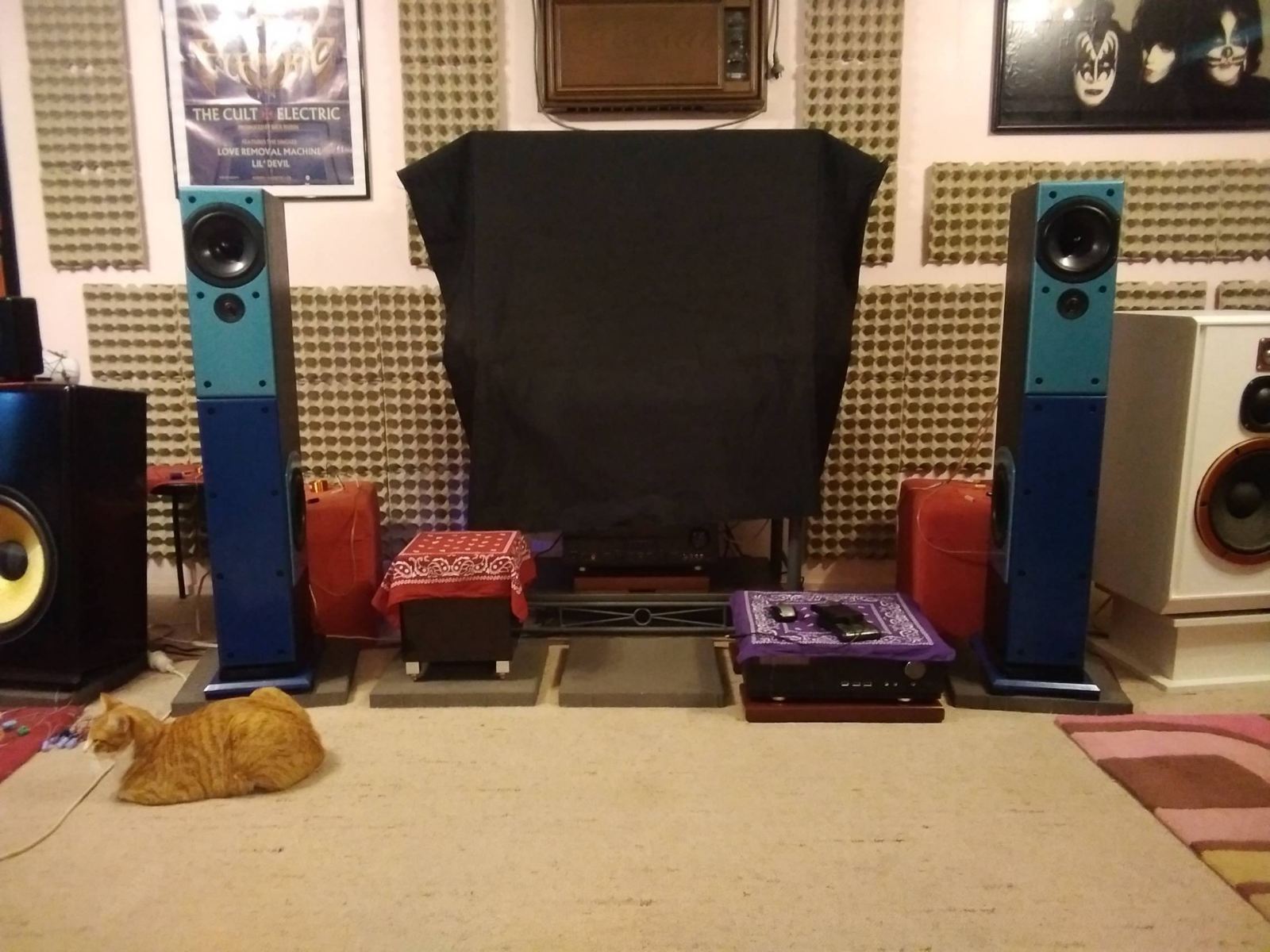

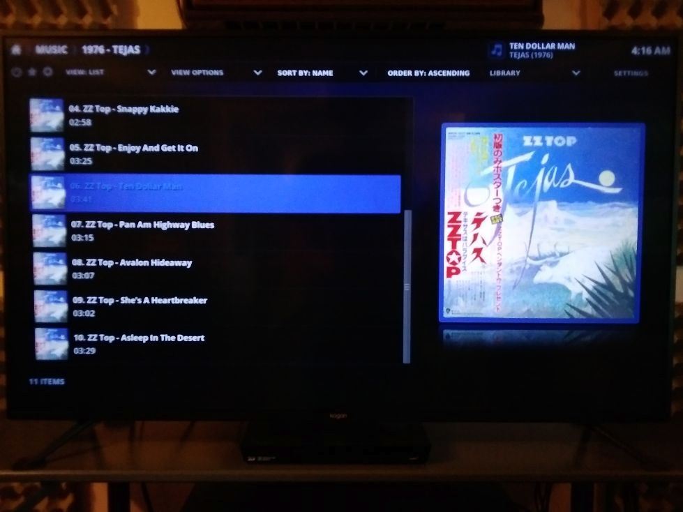

Still running the Yamaha, TDL, REL combo, with the addition of a Raspberry Pi connected via HDMI for now.
I have quite a few HiRez files I've been unable to play previously.  I was converting them through Any Audio Converter, to play on the Philips Media Player.
It doesn't get much better...  working on speakers while listening to early ZZ Top albums...
Currently listening to ZZ Top's La Futura for the first time...  yeah, fine form and great sound.

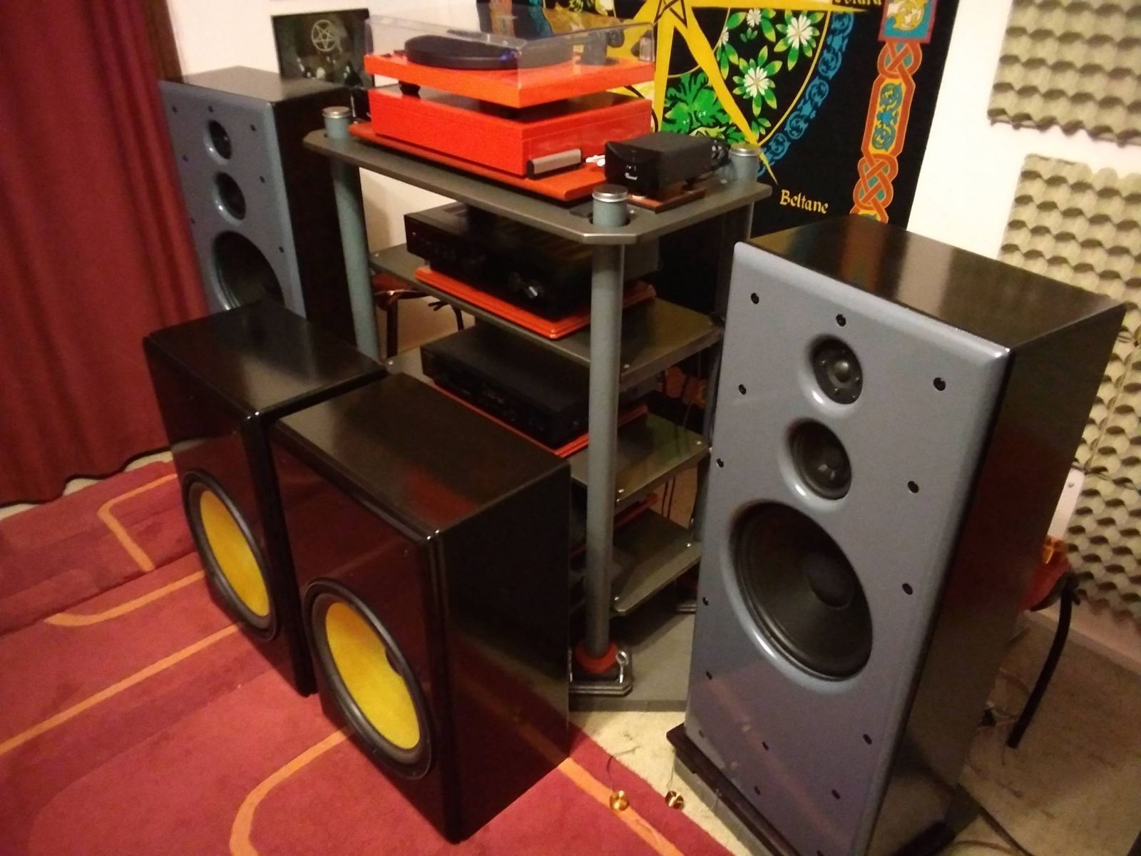

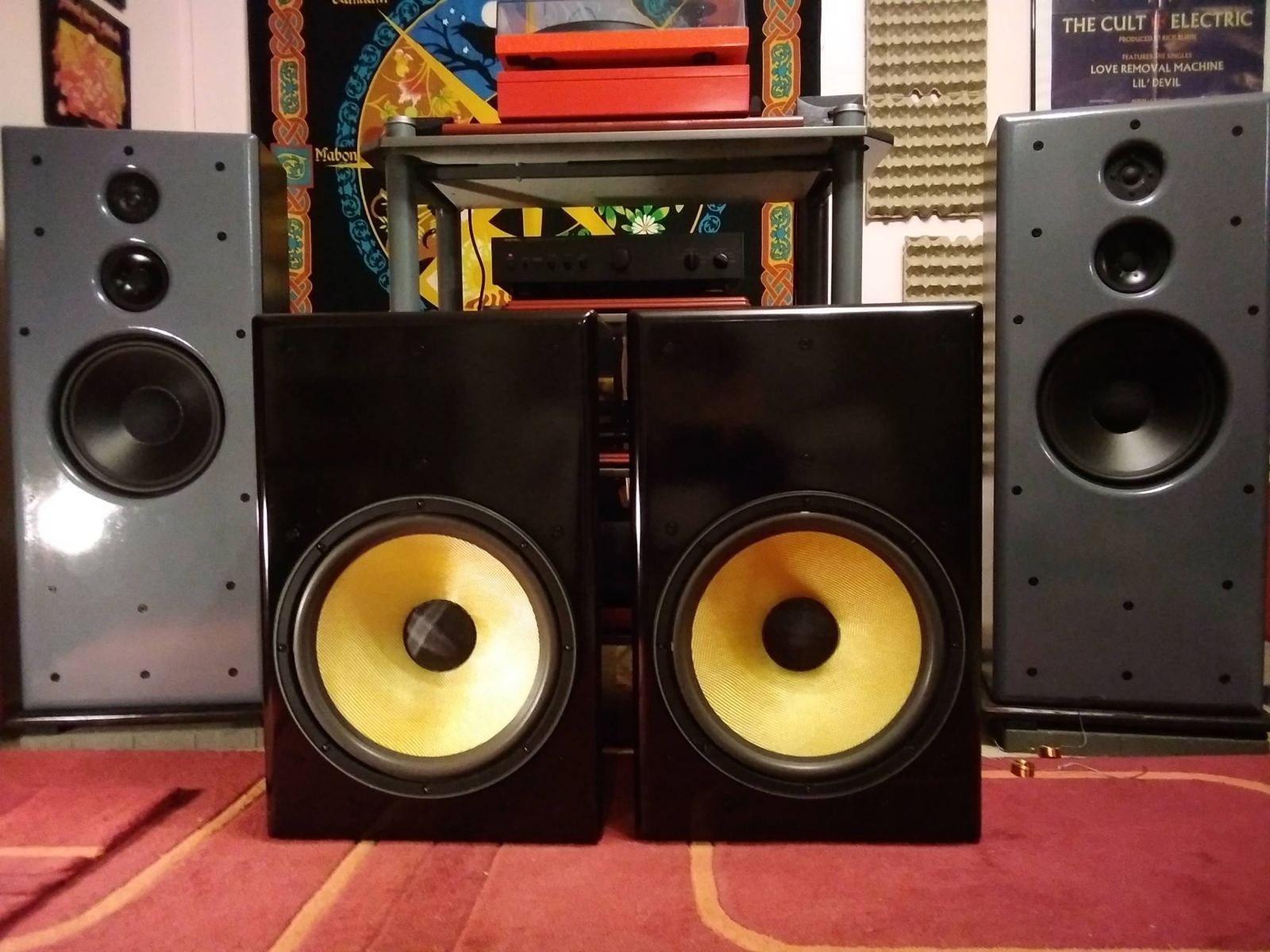

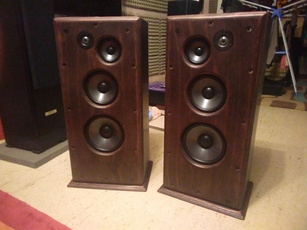

All my efforts of late have been modifying and restoring old cabinets.  I recently built four, small cabinets with a single driver in each, but they are on hold waiting for paint to arrive.  Instead, I've been stripping old Marantz, Sony and unknown brand speakers, and one pair of 'white van' specials.  I sure got well and truly suckered there.  These speakers would have sat around unused for years, or been chucked out.
I've rounded edges, braced internally, sanded the old vinyl veneer to get most of the scratches out, but not too far as I wanted to keep the look.  Most of the edges were banged up, so I rounded the edges with a router, and wasn't sure how to finish them.  I sanded them, gave each round some very fine filler, sanded back again and still wasn't sure how to finish the edges, or the veneer.
I had some Wattyl Rosewood stain left over from doing a mate's Celefs, and tested on the bottom of one of the cabinets...  you beaut!  Came up very nice.  Not only that, but some got on the rounded egde, which is smooth but still sanded back chip board, and that looked pretty good too.
So, I finished them all with the same treatment, and they're all different because the vinyl veneer was different.  They still looked a bit flat and I thought of a clear coat, but being a tightass, I had some left over Japan black stain & varnish I used on my Celefs, which came out very glossy.  I hit them all with that and they came up better than I thought they would.  You can see the imperfections in the the old cabinets, but now they have a beautiful glossy shell, it reminds me of toffee apples.
I've used new and second hand Dayton, Sony, Infinity, Jaycar, Peerless, Vifa and Peerless drivers and tweeters.  At this point I've done everything by ear.  I have the gear for measuring, but having a little trouble finding the confidence to begin.  I've been putting it off for a long time.  I am waiting to buy a DATS, which will be a while due to economics, and while not crucial to start, I have used a few drivers that I have no spec's for.
I'm very happy with the sound of all at this starting point, the only way is up from here.
I only have a few new crossover parts and they get swapped around with all the salvaged parts that still measure well.  I need to spend quite a few dollars there, and that will have to wait too.  But, the time is not an issue, I'm waiting on six amp repairs at the moment, and I know good things take time.  This is a life journey for me.
I got back into stereo five years ago, and joined here not long after.  Now most of my time is devoted to it.  My 3 way build will be my final speakers, but I'll probably move more into restoration of some more fancy, old speakers.
Here's a sample of the finished cabinets, although I'm not happy with the grey and that'll get another sand and coat, or two.
Sorry, they looked brighter on the phone.
Grey - Jaycar 12" & 4", Plessey tweeter.
Black - 15" kevlar reconed Infinty(?)  Not 100% confident there, but that's whay I paid for.
Both pair are sealed and weigh a tonne.  Running off the Rotel RA-971 MkII A & B speaker outs.
One of three near field systems in the room, waiting for the arrival of a lovingly restored Sansui AU-517.
Cheers for now, but here's a few more pics.

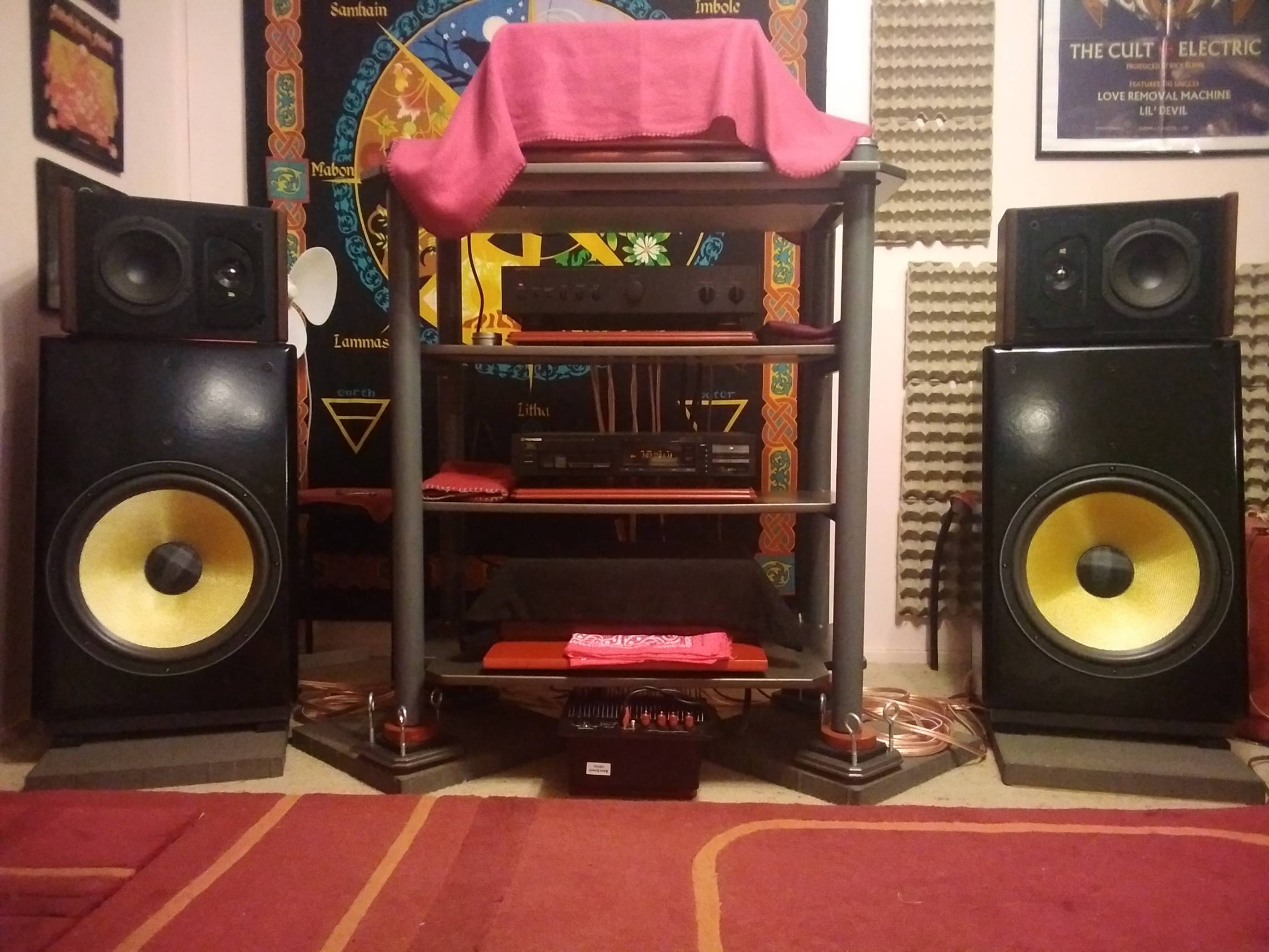

Not long until I have some repaired amps returning, for now I'm running the Rotel RA-971 MkII for stereo, and the Yamaha RX-V861 for AV.  I'm very enthusiastic about a Sansui 517 being repaired and updated by one of SNA's finest Sansui lovers.  That will be my No.1 stereo amp, for vinyl and CD, and the basis of my main, 3 way speaker build.
I'm also waiting for my 2 Optonica amps, one for my Optonica TT in the third living room system, the other is for a second Optonica system in the dining room.
The Denon AV-A1 should be ready in the next few weeks and returning to main AV duties.

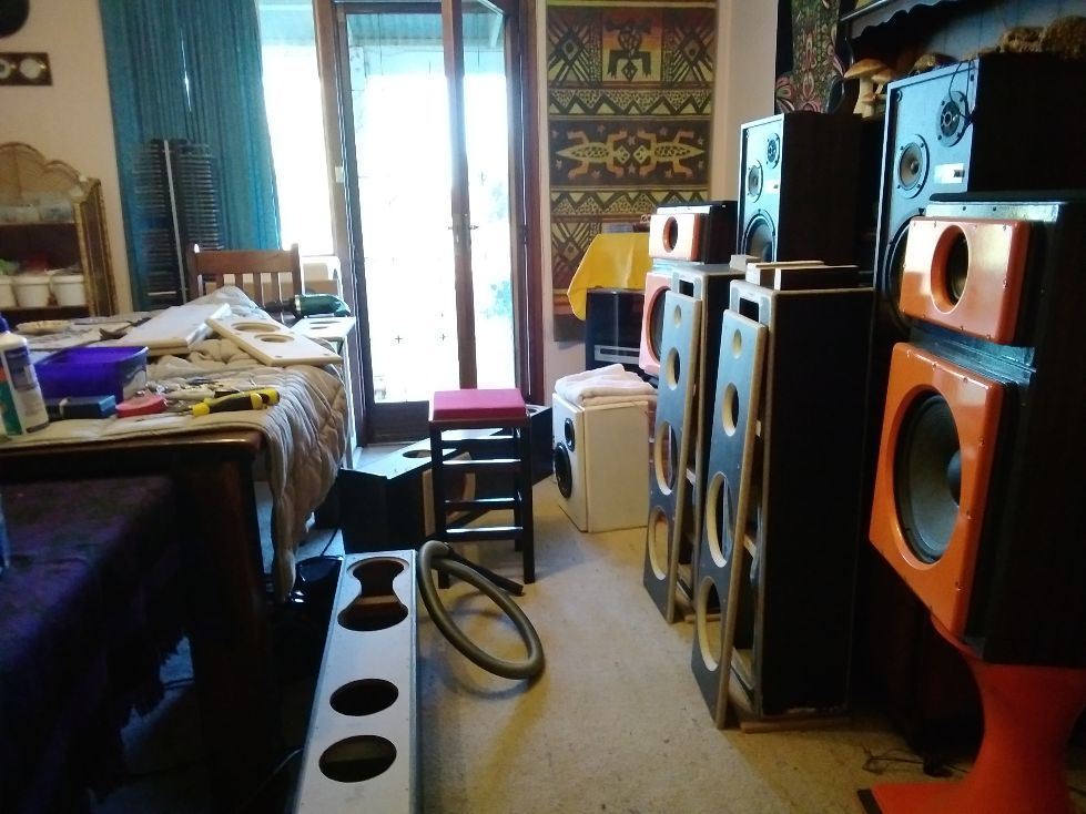

The next pair of speakers are now finished and set up in the AV system.
The cabinets were from a pair of 'white van' specials.  The drivers discarded and replaced with a HiVi 8" side firing woofer, a Peerless 6.5" mid, and a Vifa ring radiator.
The cabinets are dual enclosure, both sealed, fully braced with a new platforms added, and new baffles.

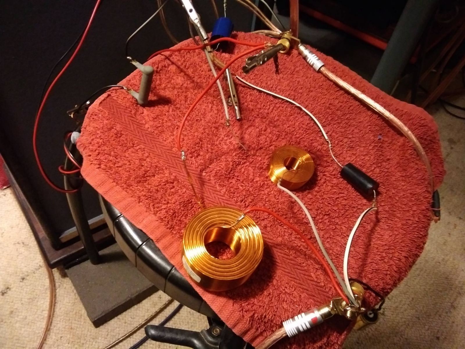

I've been listening for a few days now, and the crossovers have changed after fine tuning by ear.
Very happy with the unmeasured results and will listen for a few more days.
Im using the Rel T5 sub from about 100Hz down.

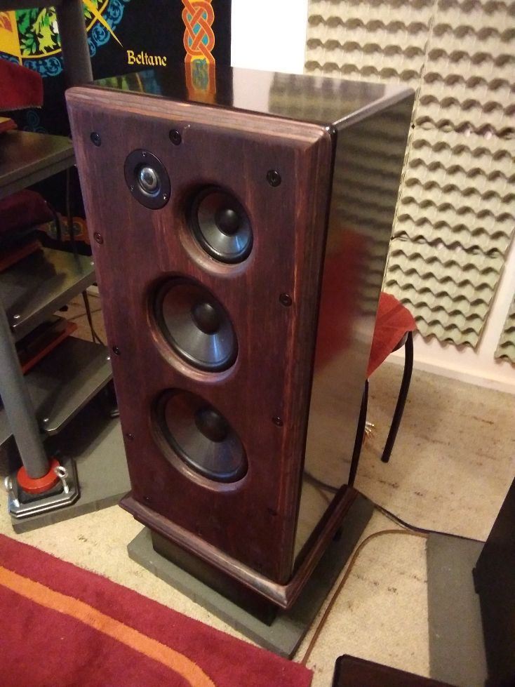

... here's a sneak peek at the next pair...
Oooo that sneak peek looks interesting, now following this thread :classic_ninja: ...tell more, tell more

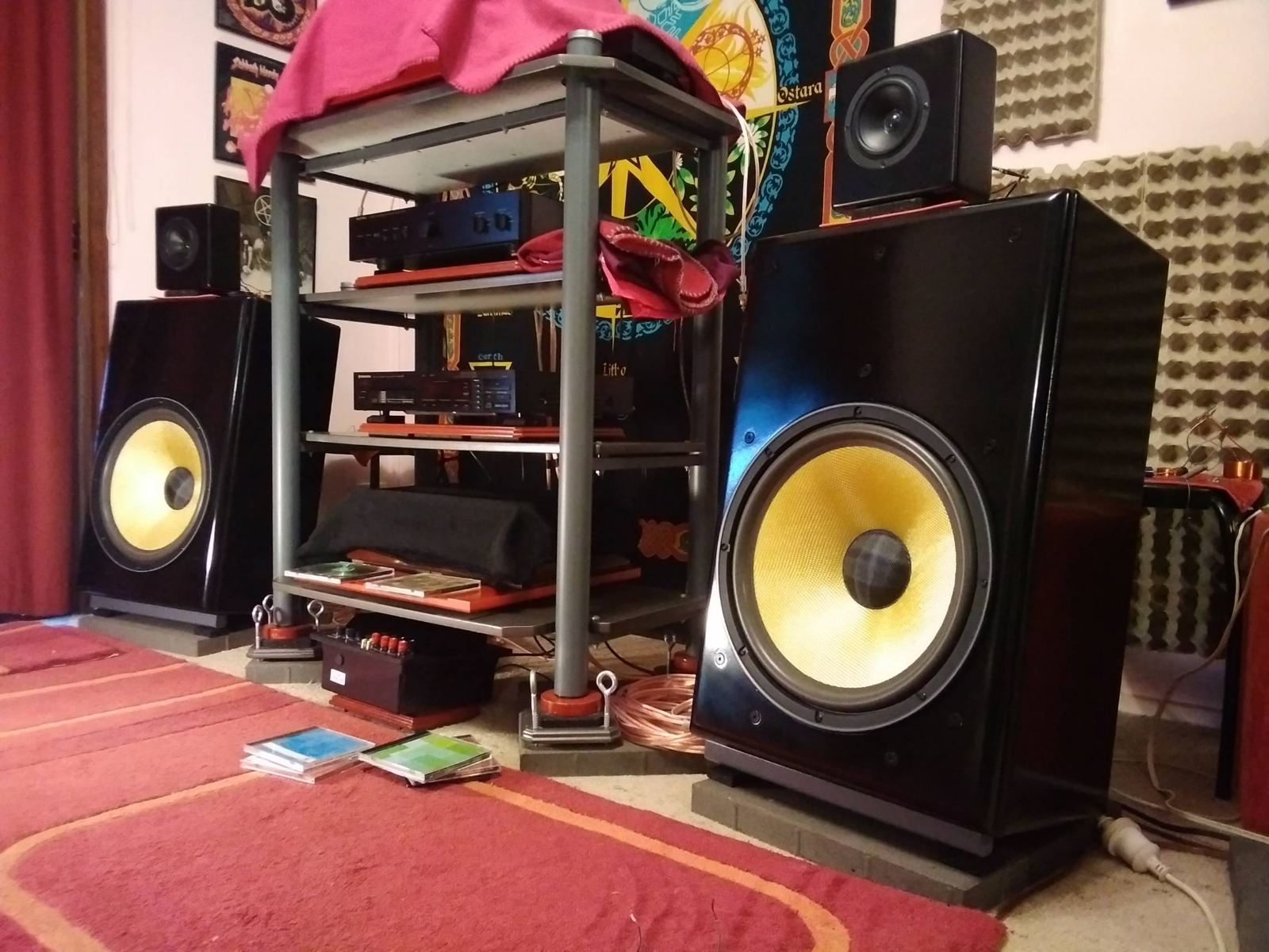

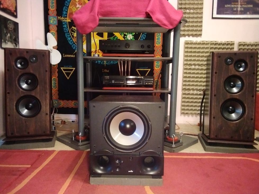

G'day Folks.
After a few combinations I've settled on this set up for a while.
15" Kevlar re-coned Infinity drivers in reconditioned Marantz LS-20, sealed cabinets.
Running off a Dayton SPA-250 sub amp, fed from a Rotel RA-971 MkII pre out, with the drivers in series, which does only give me mono bass.  Set about 100Hz at the moment, but I have been upping that to about 120Hz.  The Rotel is driving Acoustic Research AR TSW-210 bookshelf speakers which now have replacement Peerless woofers.
I'm using a Pioneer PD-M40 CD player.
