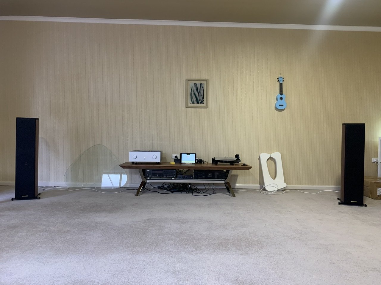

  • Author
Thanks for all the great ideas in this post.
With some negotiation with my wife and some acceptance from myself I have moved the room 90° to the right.
I don’t have the nice big picture window to look out of but I’ve been able to move the chair back and avoid the apparent null.
Still tidying up from the move but I’m so happy I found a way without extensive room treatments.
They look a fair way apart? Are you able to achieve a solid central image?
They do look far away apart and a bit lonely for the room
big room - you're very lucky!...but 6" bass drivers will struggle to fill it
surely the boss would allow a couple of 15" sealed subs, or maybe a sub hidden in a coffee table, sideboard etc?

  • Author
This is a good question. I’m still working on final placement but the null is gone.
It’s a bit expansive sounding now so now to experiment with toe in and maybe bringing them closer together.  But then I need to bring my chair forward and risk introducing the null again (assuming the equilateral triangle is best).  I have read that so long at the distance between speakers is the short edge of a triangle that’s ok too.
they do look a bit small in this room but they do now sound balanced much more balanced and I get plenty of level.
I wouldn't worry re toe in yet see if there is a hole in middle of soundstage or things on top of each other... find a happy medium in between...
re null... that is room related and how far speakers from front wall and where listening position is relative to front and back wall. where are you currently ? its to be honest very hard to make any comment as there is no bearing as to what the room actually is like in either dimension with sketch or where placing yourself currently :)
so easy to test - just bring your seat forward...or walk forward...and see how the bass is...
...bass changes significantly throughout any room - the amount depends on the rigidity of the boundaries and the amount of treatment in the room...the bass won't change as you walk around inside a tent, but lots in a concrete bunker - they're the extremes, your room is somewhere between...
Step the listening seat forward until the bass sounds good/balanced....further forward and you'll find another null...retreat backwards again.
It's completely normal in "typical" rooms to have bass peaks/troughs throughout the room...you just want the bass you want at the listening position...
...In  my room the bass is too loud when standing at the laptop changing songs/albums, but going back to the listening couch it's all fine...this is expected (ie different bass between the listening position and anywhere else in the room...your room my have less bass when you're changing vinyl)...good/clean bass at the listening position is all that matters...
Walk around your room and hear the difference in bass...put your ear close to a wall, in a corner,. crouch down into a tri-corner - the bass changes...it doesn't matter as long as the bass is as you like it at the listening position.
Depends on the room and available positions. The best balance for me (nulls, modes, and delay times of reflections) was to have the long side between the speakers and sit just inside of the point of the triangle with a bit of toe to counter sitting inside the triangle.
I needed the long side between the speakers so the speakers were closer to the side walls, which reduced the delay time of the side wall reflections. Room is 7m by 4.5m and due to door positions have to run across the room. At 6m your delay times could get reasonably high too.
Tuned speaker and listening positions in 100m increments until it sounded the best.
