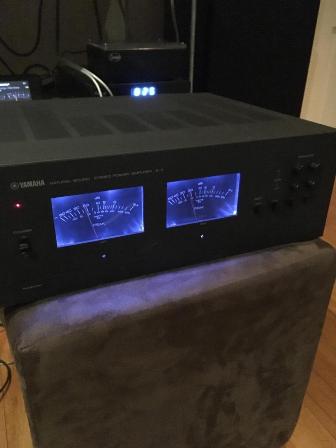

Guest jakeyb77 Posted July 25, 2016 Share Posted July 25, 2016 (edited) Just been advised that amp is fixed and running like a dream. Just got to pick it up. And the B-2 arrived today. The heavens are helping me Edited July 25, 2016 by jakeyb77 Link to comment Share on other sites More sharing options...
The Fez Posted July 25, 2016 Share Posted July 25, 2016 Just been advised that amp is fixed and running like a dream. Just got to pick it up. And the B-2 arrived today. The heavens are helping me B2 --- Link to comment Share on other sites More sharing options...
Guest jakeyb77 Posted July 25, 2016 Share Posted July 25, 2016 B2 --- GotPics1.gifA-2000 has been repaired. 3 days and a bottle of single malt later. Just waiting for it to get home. But.... Link to comment Share on other sites More sharing options...

Guest jakeyb77 Posted July 25, 2016 Share Posted July 25, 2016 Hmmmm. Ok. So totally enchanted with the B-2. Dire Straits Why Worry is beautiful in this combo. My soundstage feels huge that was the biggest shock. Mids and trebles do what other VFET reviews say. They just sound like they should. As for The A-2000 the left channel sounds beautiful. Right channel is as loud but distorted. Halfway there. Back to the tech or if not fixable I don't know where. I've swapped out everything back and forth and right output channel is problem with amp. We did say due to age this may be the case. I'll check the pre in the morning just to make sure. So as it stands the B-2 is winning. As for my first impression VFET impression is have to say they are different from anything else. A mesmerising different. Link to comment Share on other sites More sharing options...
Guest jakeyb77 Posted July 25, 2016 Share Posted July 25, 2016 Late night thought to see if "B" speaker terminals worked. Nope. But that left channel is still something. Now to get the right one the same. There is something magical also about the A-2000. Not surprising as both amps had these speakers in mind. Link to comment Share on other sites More sharing options...
