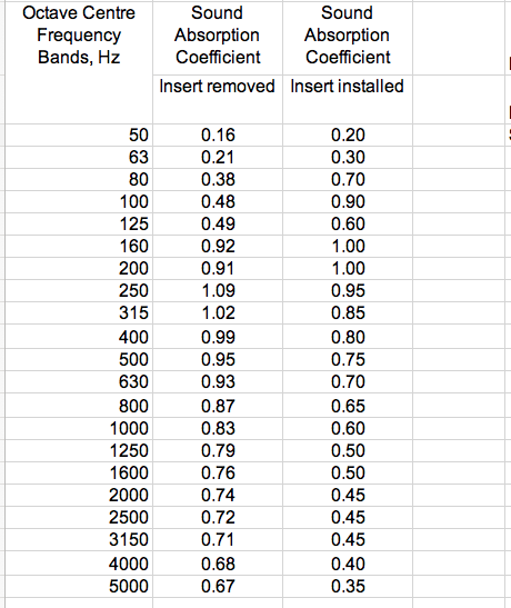

Sound Acoustics LF65 BEAR series.  With the insert installed they're effective from 63Hz -

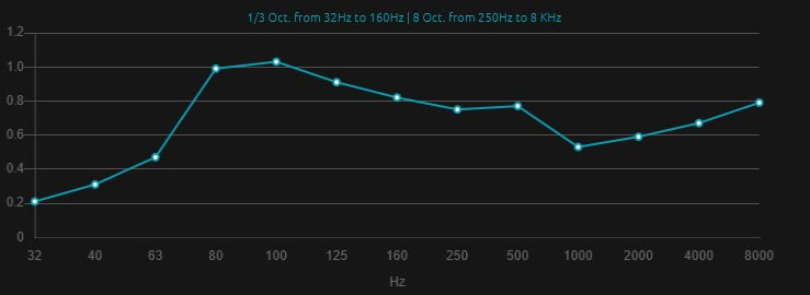

Artnovion Ulysses.  Data shows good effectiveness around 50Hz - 100Hz -

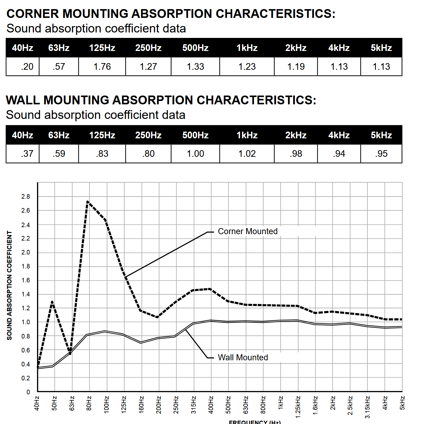

Primacoustic Full Trap.  Drops at 63Hz but still effective, and very effective around 80Hz -

I've got a couple of Primacoustic Fulltraps in the front corners and other people seem to think they look cool. 😎
If you are looking for something substantial I don't think any of these products do that. I think most of the products you've linked to do next to nothing under 100Hz and minimal under 200Hz. You need EQ under 200Hz to really make a controlled difference. I'm not saying don't do, but I am saying have low expectations.

I think it made a subtle improvement, just nothing that your non-audiophile will notice.
When I turn Dirac Live ON/OFF my other half says that the difference is huge and appreciates that bass sounds too loud and bloated without it.
I've since taken better notice and I actually have the place in the corner MaxTrap, not the FullTrap.
They are only made of particle board so I painted the inside and the edges with a sealant.

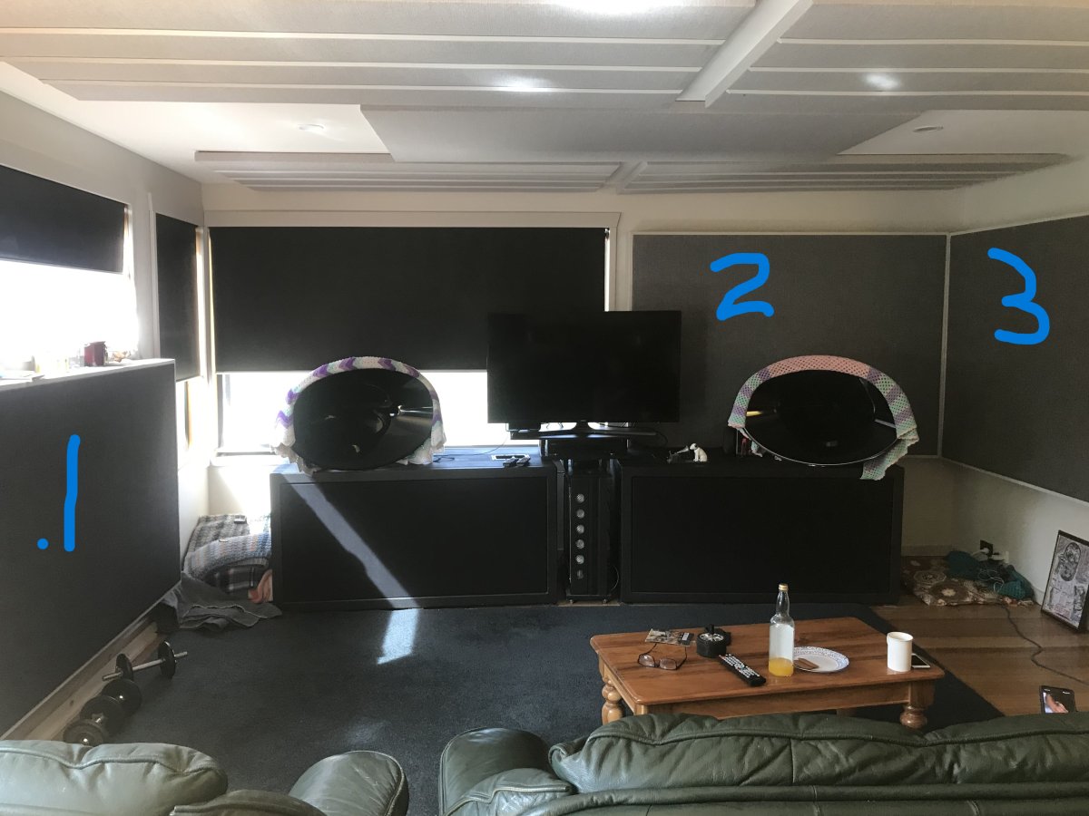

Had a go at building some passive "anti speakers" as I like to call them, but in fact are limp membrane bass traps for a lounge room I had just finished renovating, big ones, man sized 2 man lift.
Short back story
The job was an attempt to tame 2 pairs of 21" pro neo drivers in 650 liter ported enclosures, with an effective band pass of 23Hz F3 to 300Hz, first crossover point. Efficient at 99dB for 2.8v ,,,,
The room the speakers were housed, has double layers of plaster, ceiling and all walls, double glazing and partly enclosed heavy custom made roller blinds. The walls were built from the old 100 x 50 hardwood, clad in seasoned macracarpa 25mm thick boards on a layer of 10mm foil board, then the normal R2.5 wall bats. All that was an effort to partly sound proof the light weight suspended room,,,which it did, to some degree.
The caveat was a poor acoustic environment, measurements showed 10 to 20Hz leaked out of the room ok, however from 40Hz and onwards, with peaks at 55Hz, 120Hz, 210Hz, were significant room resonances, measured in REW, with a miniDSP UMIK 1. Beyond those frequencies and into directional radiation severe comb filtering was present, even with the constant directivity 2 way horn set.
What to do ?
Well after a few phone calls a Bloke offered me a 65Kg, 12m roll of weighted vinal with a closed cell layer of foam at 8mm thick bonded to the back of it. Underground truck cab liner apparently. Donated, for a favor.
I had some experience with limp membrane trapping in the past so decided to give another design a crack.
Without going into a lot of measurements, design, construction method, the job can be summarised, in saying a hardwood frame was bugle screwed (made part of the building structure) to the walls to house the limp membranes, which were air tight sealed to the wall and filled behind with CSR heavy acrylic bats. Essentially like a loose drum skin, sealed and damped. To get around the narrow operation band widths, which each membrane was sketchily measured at each trap has differing length dimensions and the largest, was a double membrane. I guessed in all practicality, but had done before and after measurements. I tried throwing a tennis ball at the traps and measured the response, a golf ball and some others :).
Directly in front of the membrane, was damped with 25mm CSR Acrylic sheets and covers of upholstery material as a primary trap for higher frequencies. Each membrane had a small still air gap behind it.
So, about 40 days of labour went fast and the things were on the walls along with some surface mounted, 40mm thick ceiling panels.
Cured the combing and made measurable effect in tuning down the room resonances a the targets of 200Hz and below
The photo is of the system how it was a couple of years ago, the only other treatment was to use Sorbothane all over the system, 12 under the 21" enclosures and also under the horn set.
The Sorbothane pucks made measurable differences at below 50 Hz and was the icing on a very nice set up, DSP tuned and calibrated over a full 8 channels.
Made the room sound like it was larger with the speakers sounding like they were further away, deeper soundstage, fantastic stereo image from the horns.
