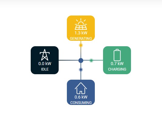

A lot of Cloud at the moment so little solar.
 This is what is a happening at the moment

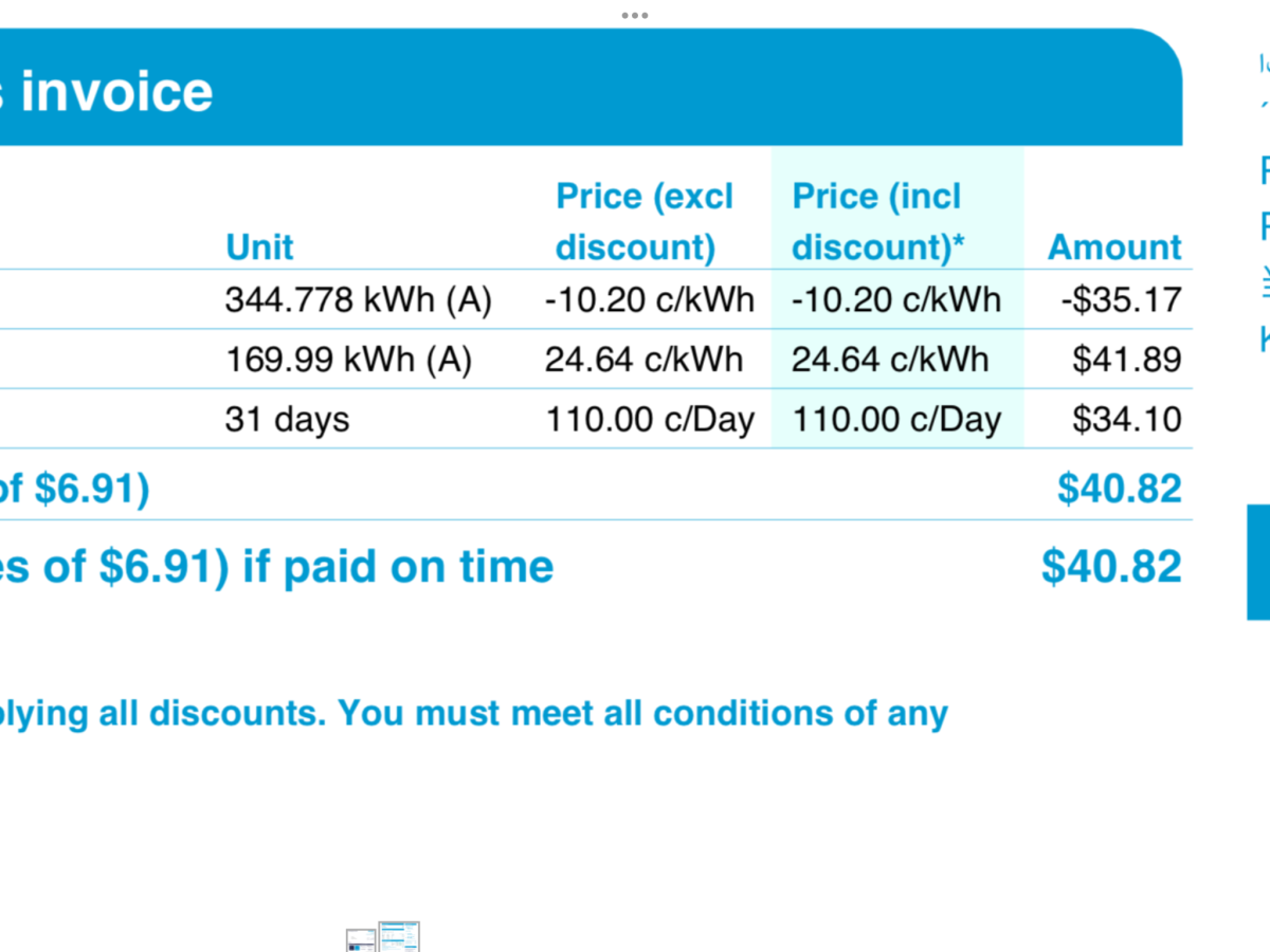

Check the market on a monthly basis, it varies considerably, I’ve change 3 retailers since I was with one of the cheapest until the Ukraine war started.   Even though it’s $40 on this bill,  I’m still not paying anything because I just signed up with this retailer,  and got a $200 credit from the the 1st retailer.   And I don’t even have a storage battery or a heat pump water service.   I’m predicting I’ll be back in credit even with these figures as we enter spring and summer.
