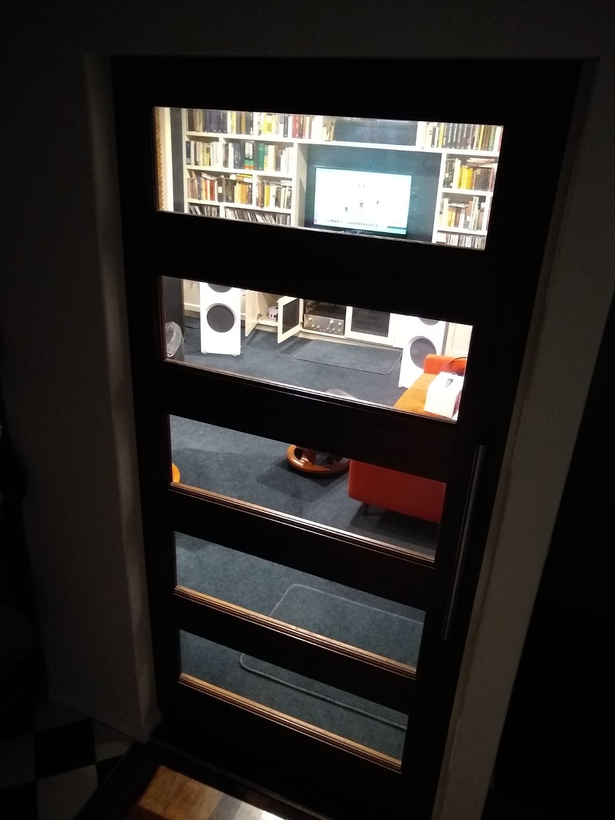

I had a bespoke door and frame made for my mancave and I went to the big glass manufacturer up here G.James Glass to get double glazed panels to put in it and the manager overheard my order and he said you don't want double glazing for acoustic benefits you need acoustic double glazing and there's a major difference between the two types.
The door mutes the sound escaping into the rest of the house to a dull muted sound, even when I have the wick turned up a bit.
The difference between the two as he explained and later sent the details, is that acoustic double glazing is made up of two molecularly different pieces of glass whereas double glazing is made of two identically molecular pieces of glass. Once the sound gets through the first pane of glass in normal double glazing, that's it, it'll just go straight through the next panel but that's not the case with the acoustic glass.
Edit: It's not cheap.
The door in question. It's a lot of glass but it works well and if whole windows were made out of the stuff I'm betting it'd work a treat but like i said, it's not a cheap option. The glass in the door was about $560 or so from memory.

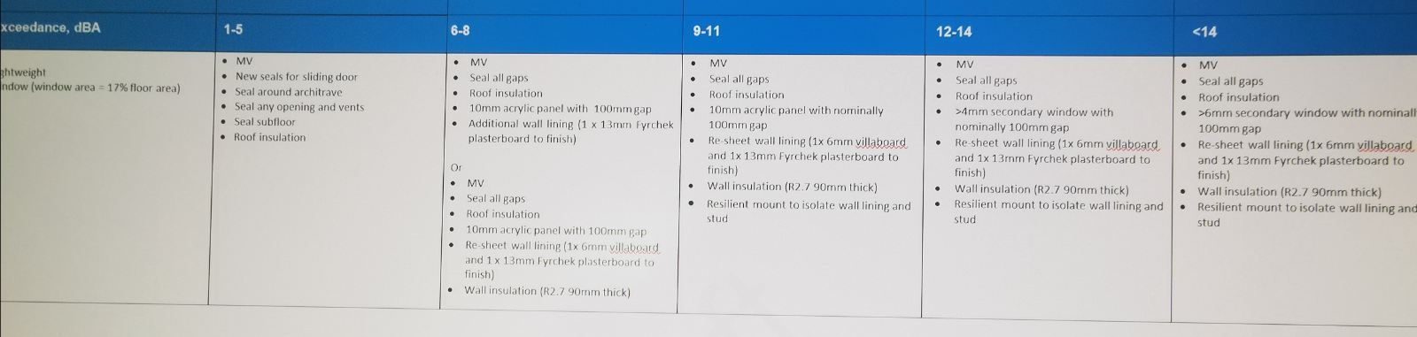

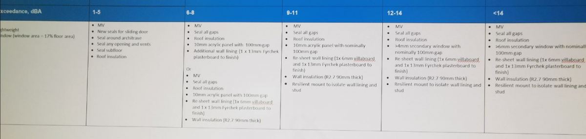

NSW Government policy was to not fund noise abatement to homes such as yours. The reason was that treating windows provided minimal noise reduction as similar amounts of noise come through the walls.
I changed this policy, it may still be in draft. Treatment was extended beyond just windows.
You are on concrete slab, a major plus.
Watch out for non airtight seals behind skirting boards and architraves. Best to remove and seal gap behind them. Can negate any other treatment you do. So can gaps behind cornices.
Here are the most cost effective solutions we came up with in government for lightweight buildings such as yours. Options for dB noise reduction. We did a trial on a couple of houses. MV is mechanical ventilation to get fresh air inside and to prevent mould with windows shut.
Individual results will vary, as it comes down to specific detail of your home which can only be known with an inspection and in some instances removing sheeting. And is highly dependent on workmanship.
Note wall treatments are additional to existing construction or remove and resheet as indicated. Windows are an additional secondary glazing system which is most cost effective.
