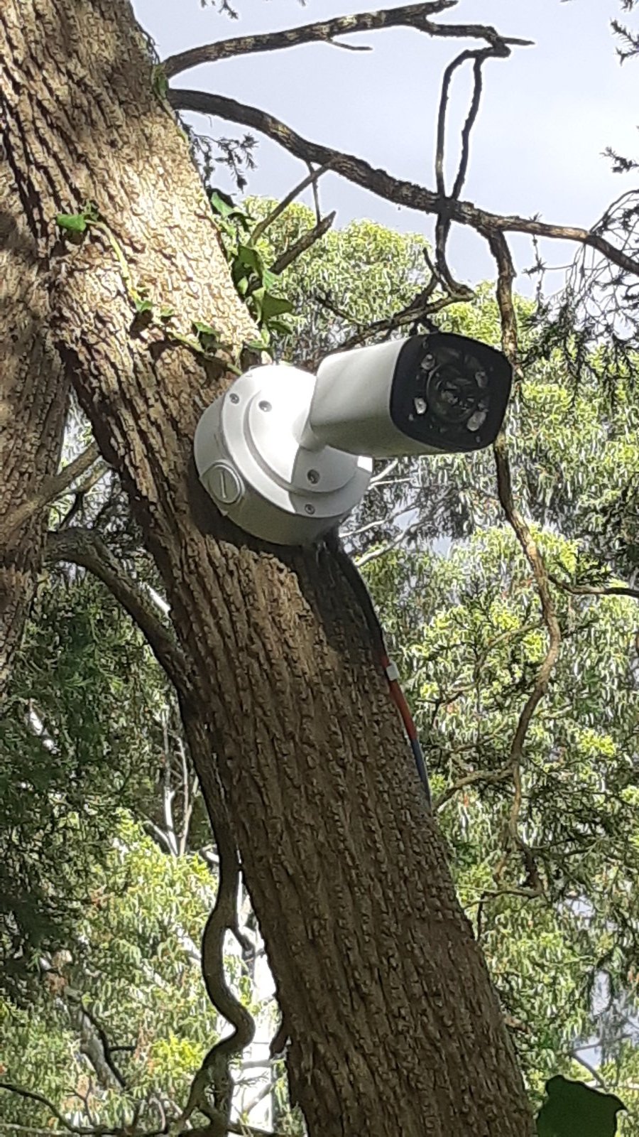

My Tree cam has failed due to corrosion, so looking for a tech who can repair and properly setup my system.
Currently have an Alhua unit.

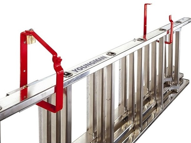

Locking your ladder in the shed when you're not using it is a good start, but there are a number of ladder security products that can make your ladder that little bit harder to steal.
Take our ladder storage hooks, for instance - one of the brackets is lockable, so even if an intruder manages to enter your shed or garage, they will struggle to remove the ladder without an additional key. The LadderLok device (pictured below) is another great option.

I had 4 - 1080p cameras installed, one above my car and work trailer in the tree.
Trouble is that the Balun connector to the camera, gets corroded and wet no matter how well I seal it up.
Around 2 connections l sealed in plastic cases with silicone and duct tape.
When I opened it up today,  half full of water, and RJ45 connectors are fried .
So only lasts a matter of months, before it fails!
I Might have to buy the crimping tool ,and learn how to replace the plugs at this rate - although I was hoping for someone with more expertise and tools to put his hand up! ?

there are many ways to waterproofing,  even plumbers don’t get it right and I’ve seen this 1st hand!   Most BNC connectors or any electrical connectors are not designed to be outdoors.   Most don’t last!  To ensure waterproofing you need to waterproof the waterproofed.... ensure even when it’s wet it doesn’t get wet!

Ended up buying a new 2mp camera and matching metal case/mount.
Siliconed up enough to run the hose on it!?
Just need to figure out how to get Wi-Fi happening with it.
Plus several other settings.
I need a geek badly around here! ?

try marine sikaflex (sikaflex 291) - wear latex gloves when applying as it can be hard to remove - trouble with the normal sealants is they deteriorate quickly in the elements
Got sick of sealing a few leaks in our veranda once a year with the standard outdoor stuff- used marine sikaflex and four years later still no leak!
