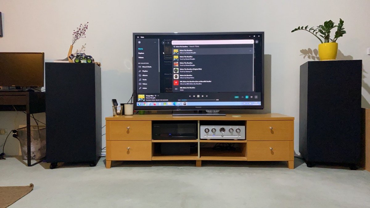

My updated system.
Figure i'm done updating my system for now, so may as well post up a pic/spec.  Very happy.
Troels Gravesen designed: Faital 3wc 15" speakers
ifi Zen dac (fed by USB from HTPC running Tidal app)
Vincent SV-237 amp
Bills cables on the way
We listen to Tidal exclusively for stereo (might go to Qobuz though), the system is used for movies etc too through the HTPC.
Picked up the Vincent amp yesterday, i can't comment on it's performance vs high end gear, but compared to my previous amps it's a significant step up in stereo imaging and grip - am very impressed.  The bass performance is wonderfully improved over the Rotel i was using.

Future updates:
A better quality dac would probably be the next item on the list.

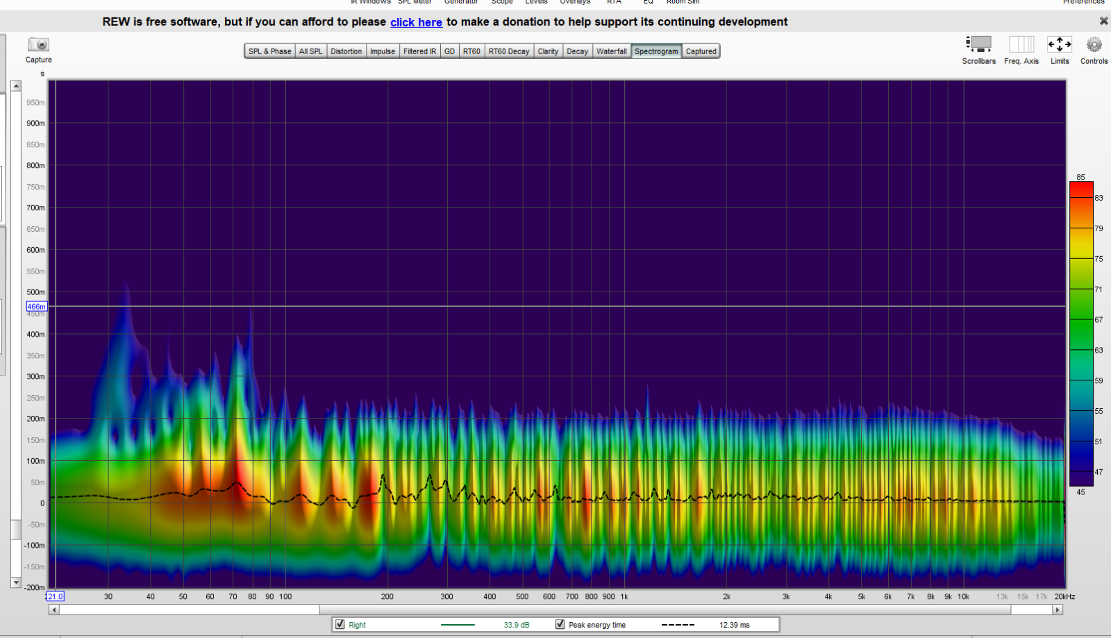

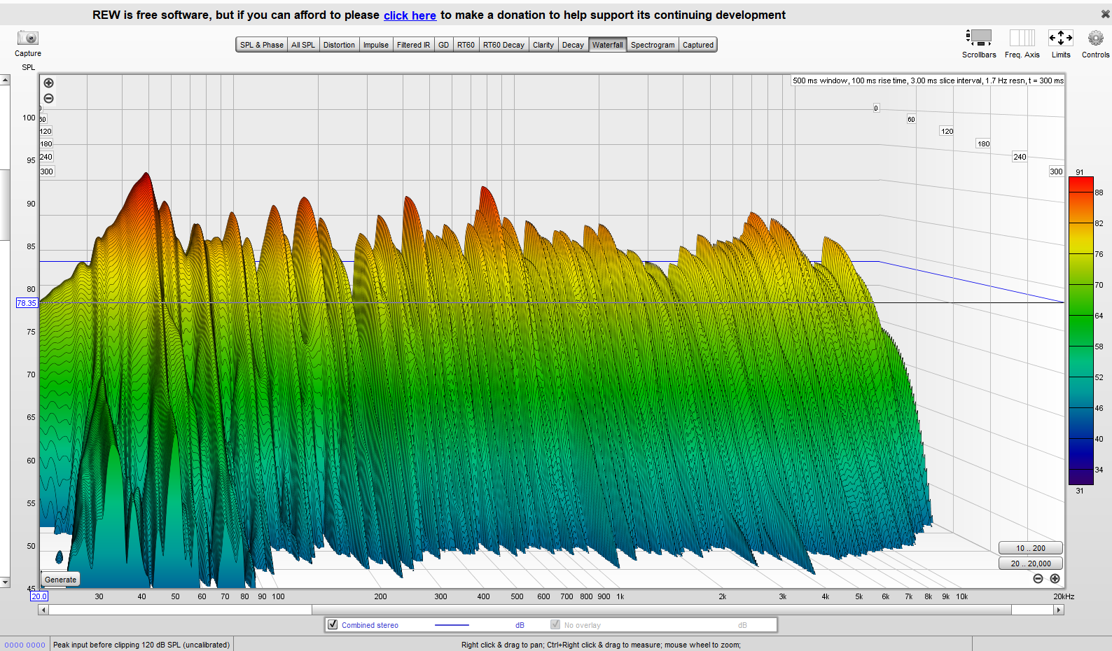

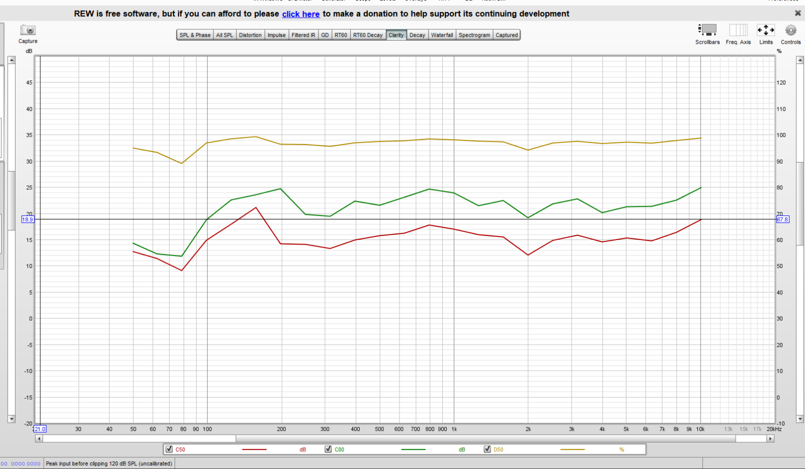

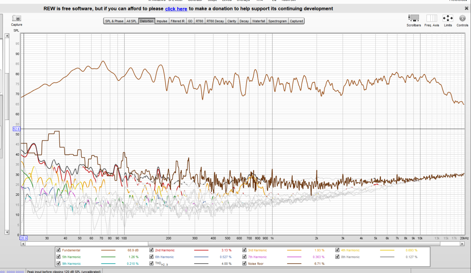

This is an example of the measurement information you could expect.
These measurement's are taken at my seated position, pre EQ.
Response and Distortion
Spectrograph
Clarity:
Waterfall:
