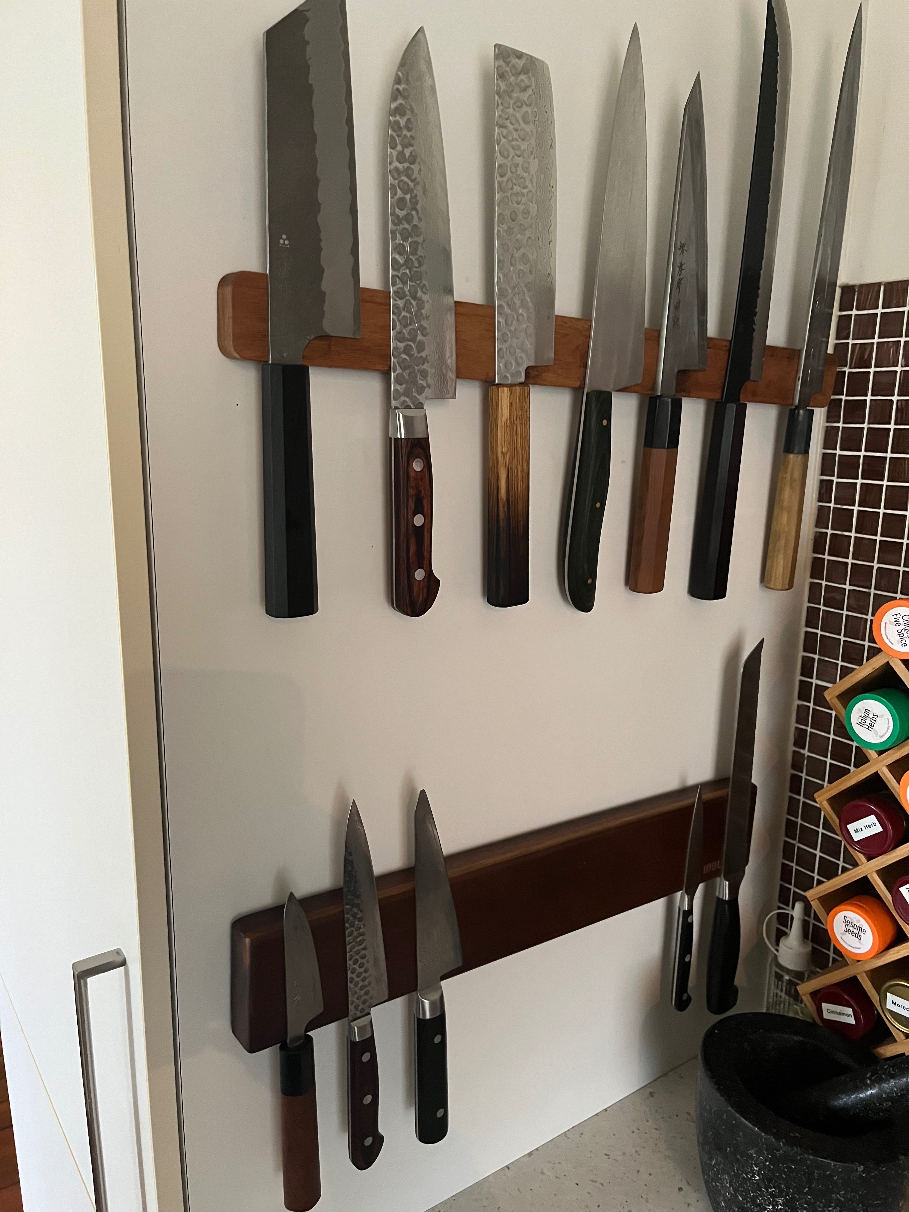

The knife thread.
Ok bit of an fetish
What’s cool about Japanese knives is I know  the name of the blacksmith and sharpener of all these knives ( other than the token German bread and petty)

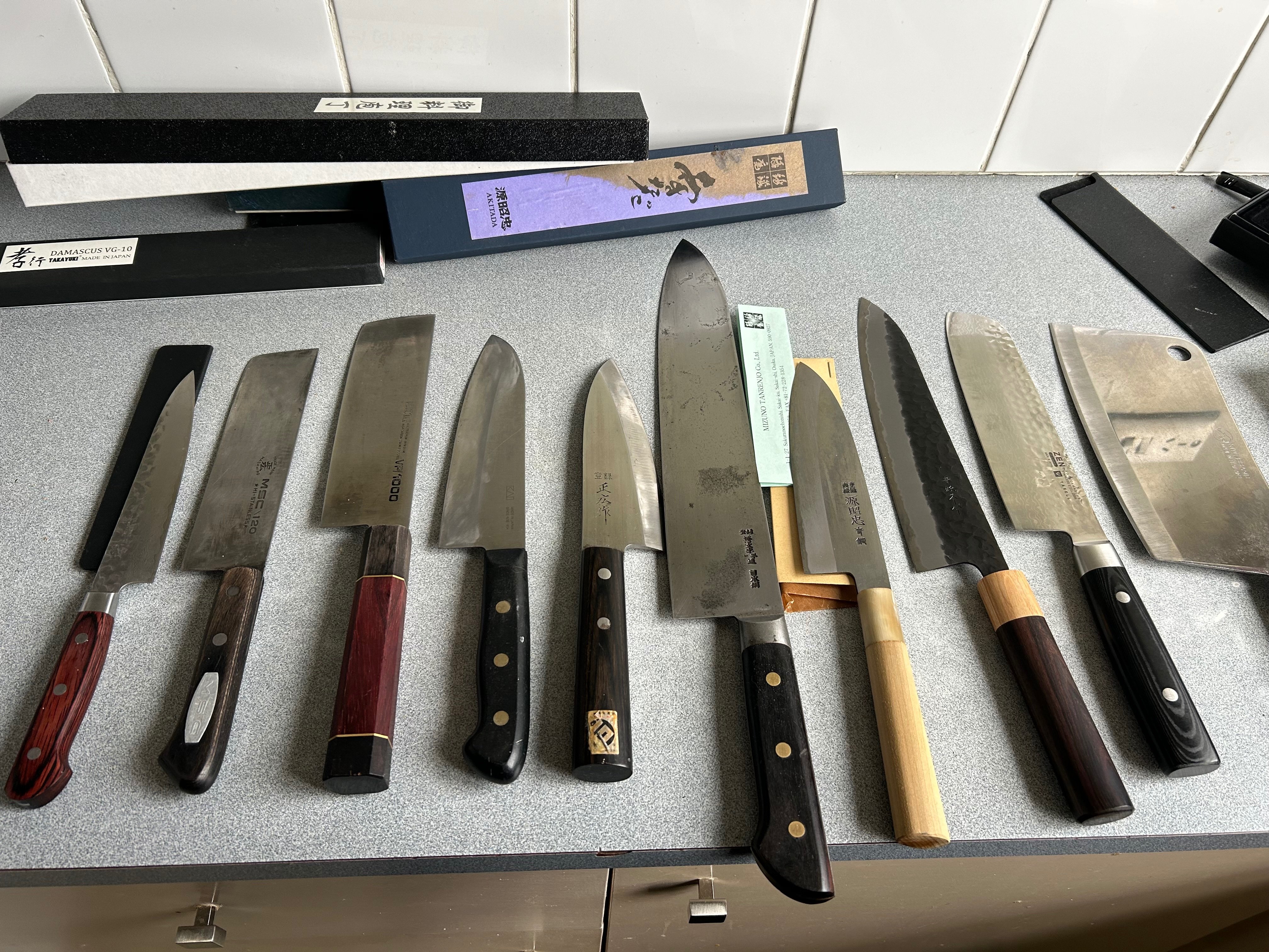

Here’s a few of mine. Funnily enough the cheaper ones are generally my go to. And you can’t go wrong w a few disposable Kiwi Brand choppers.  Never have to worry what you’re chopping through with those.

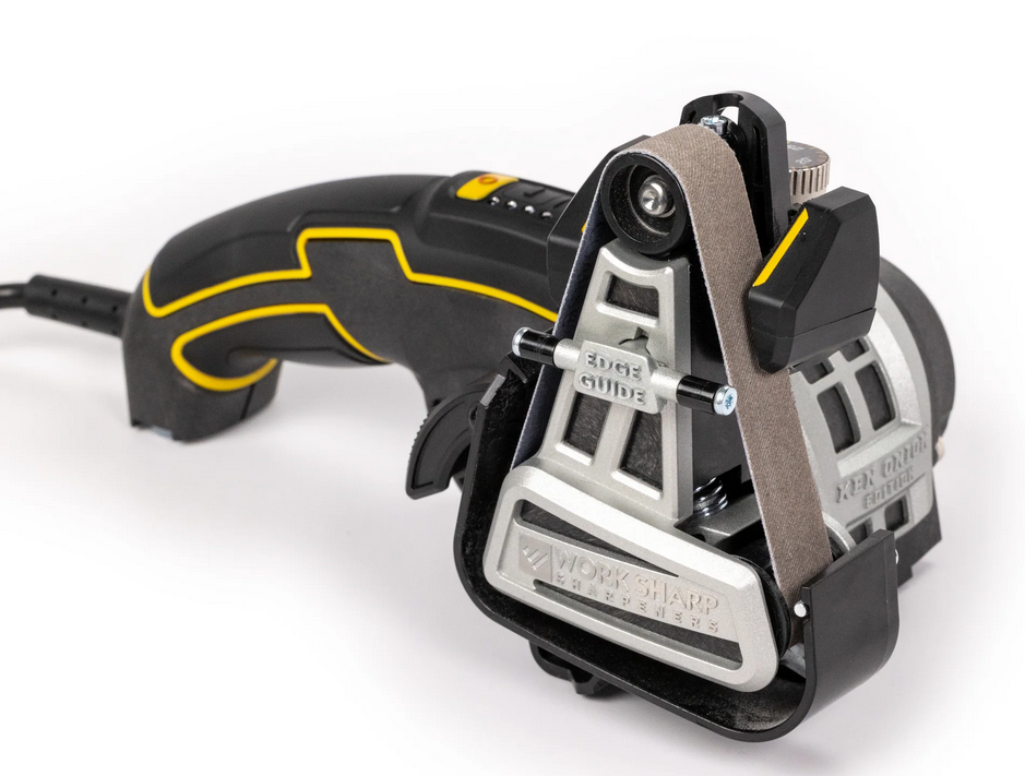

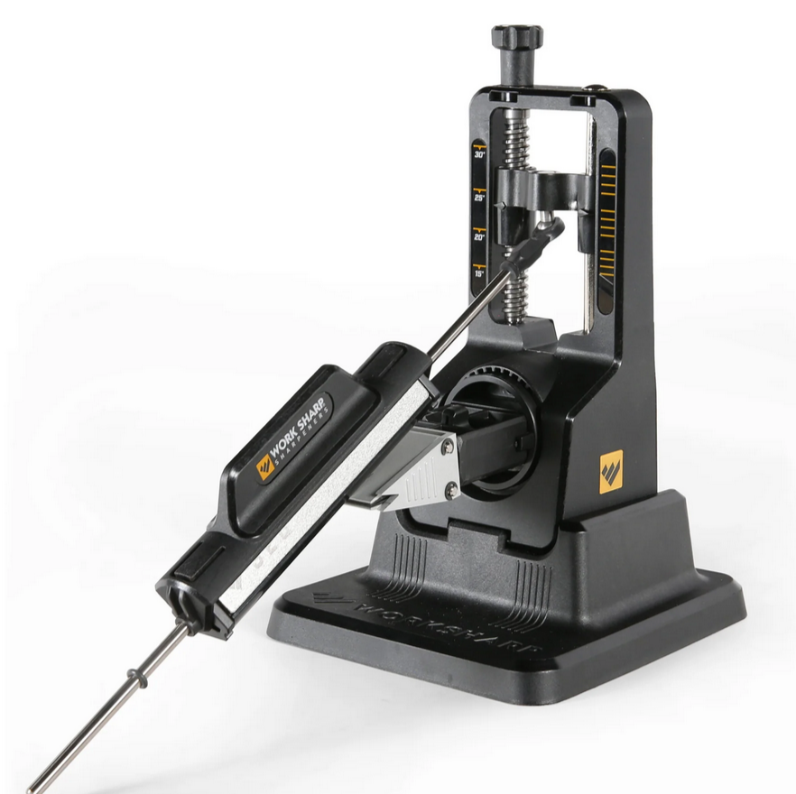

After a good period of time trying to develop knife sharpener skills, I only reached "mediocre" standard. Just couldn't get a consistent angle manually with a stone. So I ordered the "precision adjust" (below) from Amazon, to my surprise the "Ken Onion" was delivered! Works great. I'm now known as "the knife sharpening guy" by the neighbours and have little hair left on my forearms 🤣
https://www.worksharptools.com/products/precision-adjust-knife-sharpener
https://www.worksharptools.com/products/ken-onion-edition-knife-tool-sharpener-mk-2™
