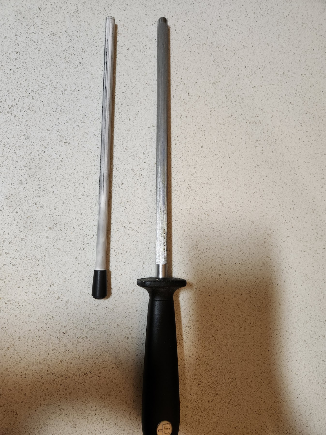

I use these. One is ceramic, the other is steel. I use them several times during cutting to quickly deburr the knife. That seems to be enough?
Honestly, I am not a knife expert. The reason I have 4 chef's knives is so that I don't have to sharpen them too often. In fact, I don't trust myself to sharpen the knife on the right (my most expensive knife). That knife has only been sharpened once, by Chef's Armory in Richmond, and I use it extremely sparingly.

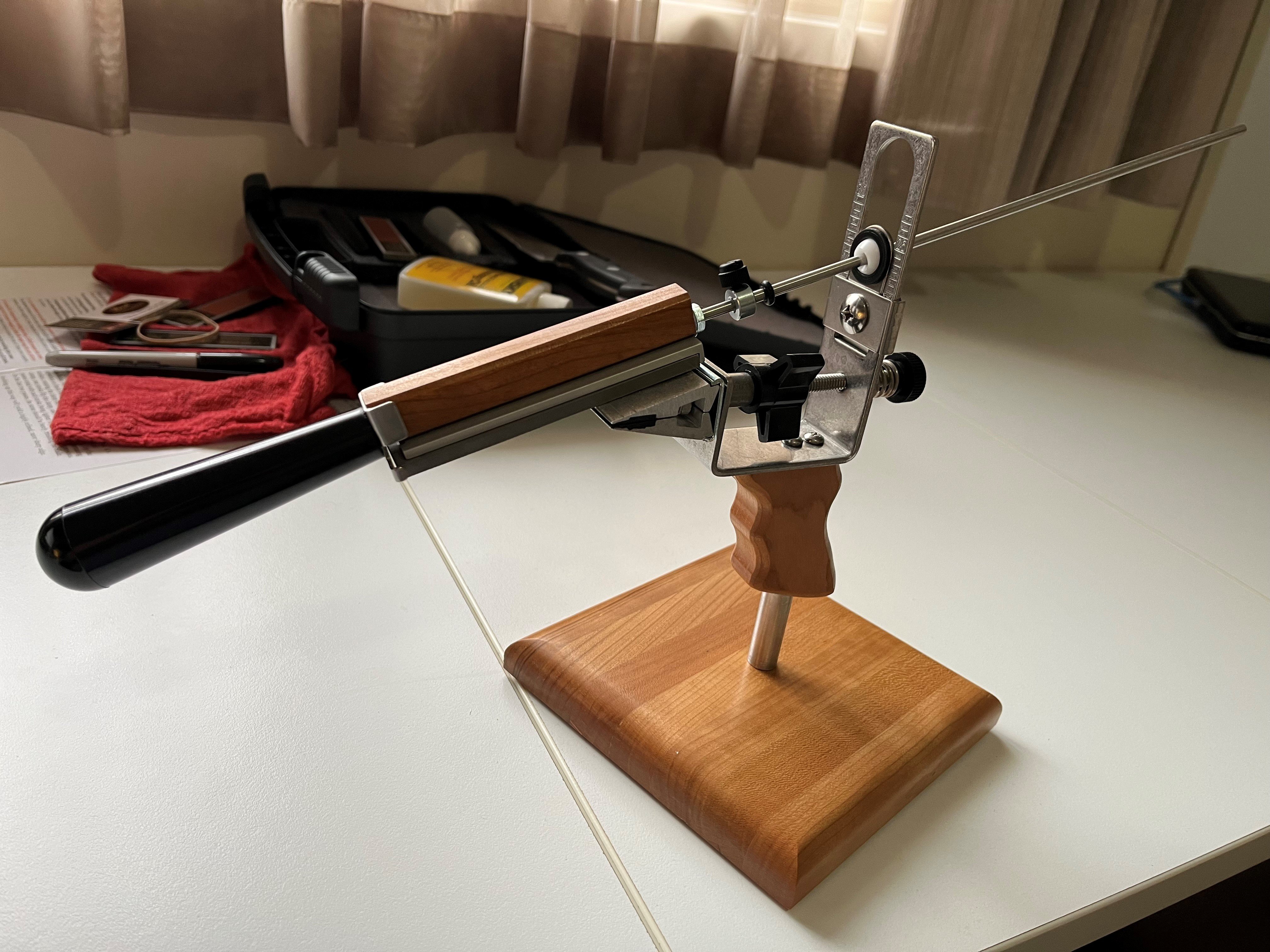

I used the KME with diamond hones and then super fine diamond paper. The convex edge was managed with a hand-curved rod out to the hones. Polishing was via a fine denim strop loaded with diamond paste.

Your best bet for all these materials is to DuckDuckGo or Google to get the lowest price.
KME sharpening systems are usually carried by online knife specialists. There are other more expensive and cheaper systems but, as @Keith_W mentions, get one where you don't have to re-position the knife as you change sides, and where you can keep your 'off' hand away from danger.
I got the diamond lapping paper (5, 1, .3 microns) from a sandpaper specialist, one sheet of each of the grades I wanted. Sorry, I don't remember the name.
Diamond honing media is available from specialist knife shops and is made for strops, but it is very expensive. The option I went with (probably not a good as the sprays and liquids) was small syringes of paste from a place specialising in rock and gem polishing materials. I think I got 5ml syringes which will last me for years or decades. The strops take very little and of course the diamonds don't wear out!
As a hobby allied to my pocket and small knife collecting it was all fairly cheap on a per-knife basis. For just a few cooking knives it would be much less economical. Also cooking is easier with the non-polished edges unless you're getting into fancy cutting. My cook knives get only a brief strop rather than a prolonged polish.
IMO cooking knives would be well catered for by one of the guided sharpeners and a cheap strop of denim (as I linked previously) with a cheap steel polishing compound (Autosol or ...). The diamond lapping paper and pastes are really overkill—for the obsessed.:)

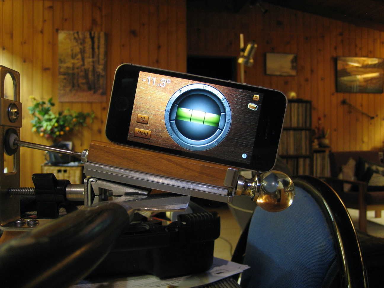

On 14/06/2023 at 7:44 PM, GregWormald said:
@Kaynin
Here you go. The crystal handle was a drawer pull.:classic_biggrin:

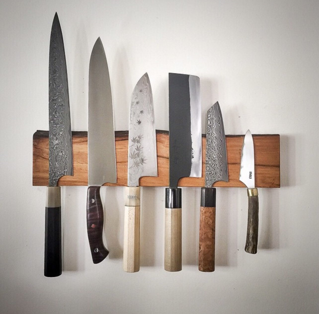

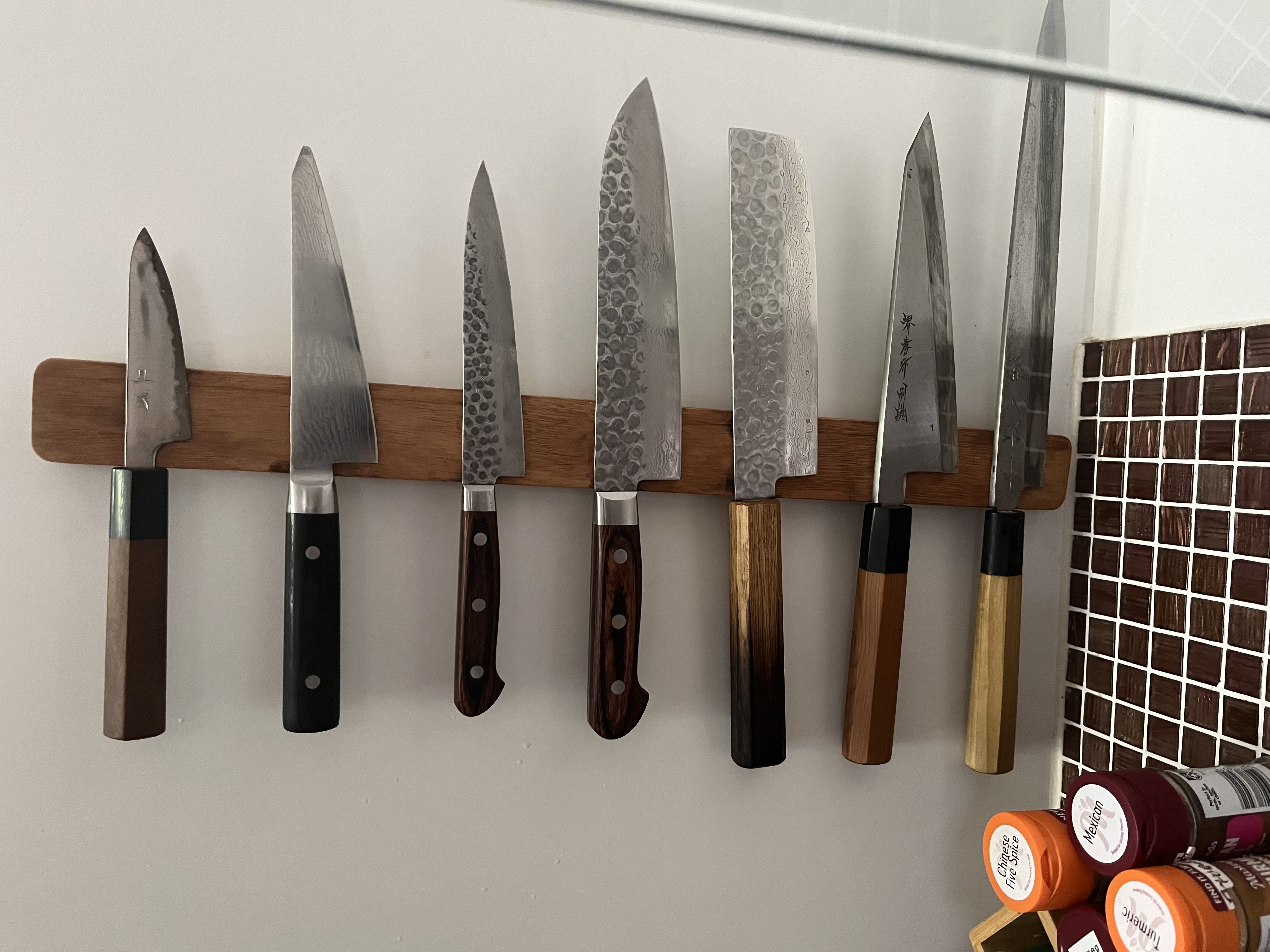

This what I use, all Japanese, most are V10 stainless, the paring  knife and two
single bevels are blue paper carbon steel.
all maintained with wet stones
left yo right
Paring  knife, old Honesuki for rough work, large petty, Santoku chef knife
Usuba vegetable knife, large single edge Honesuk, Yanagiba sushi knife
looking to add a Deba and Kiritsuke
Owning  and using quality hand made knives is such a pleasure and ultimately not that expensive ( the whole collection is less cost than one of my carts ) given I actually know the name of the black smith that made each one which such a rare thing in the modern world

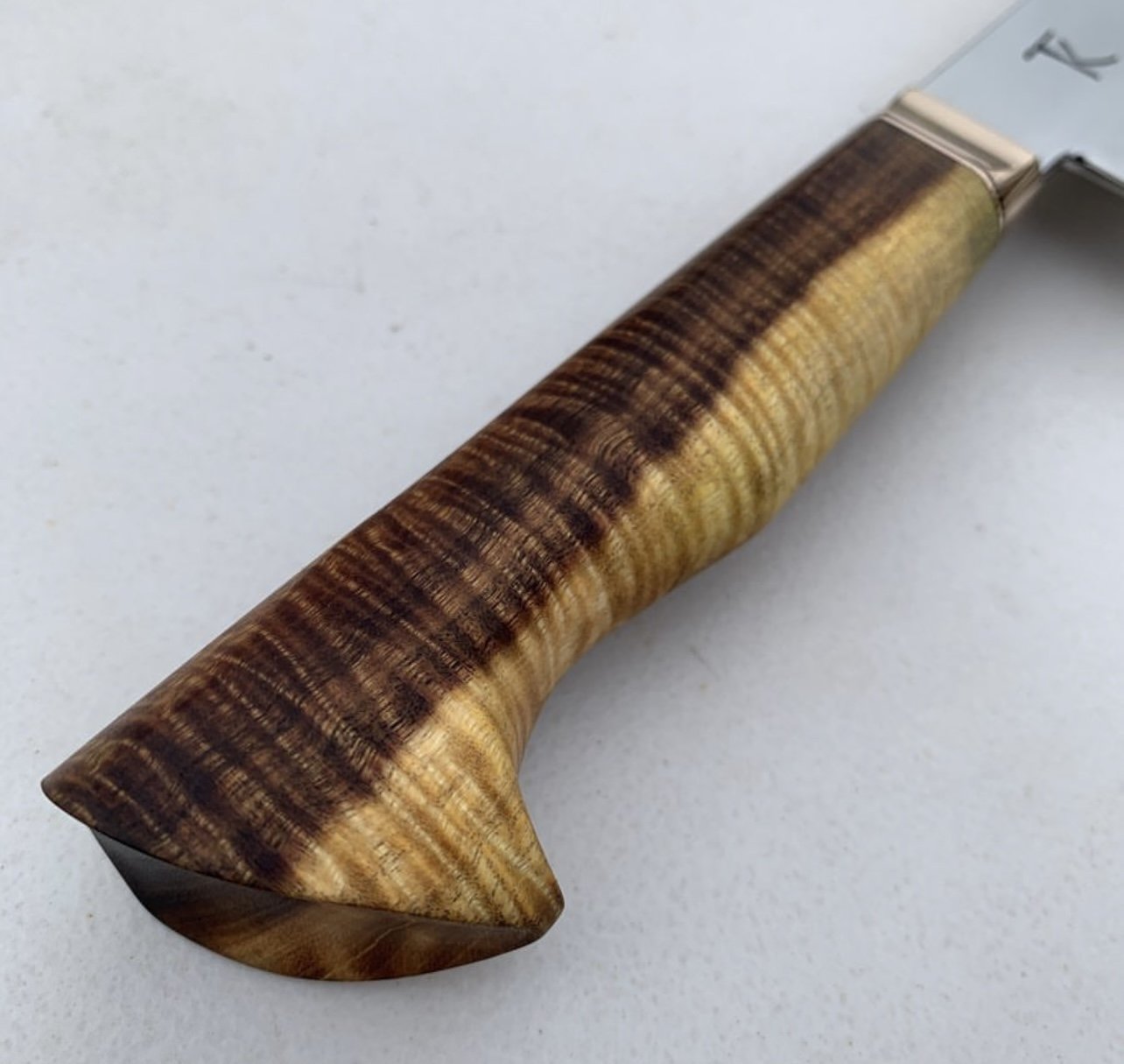

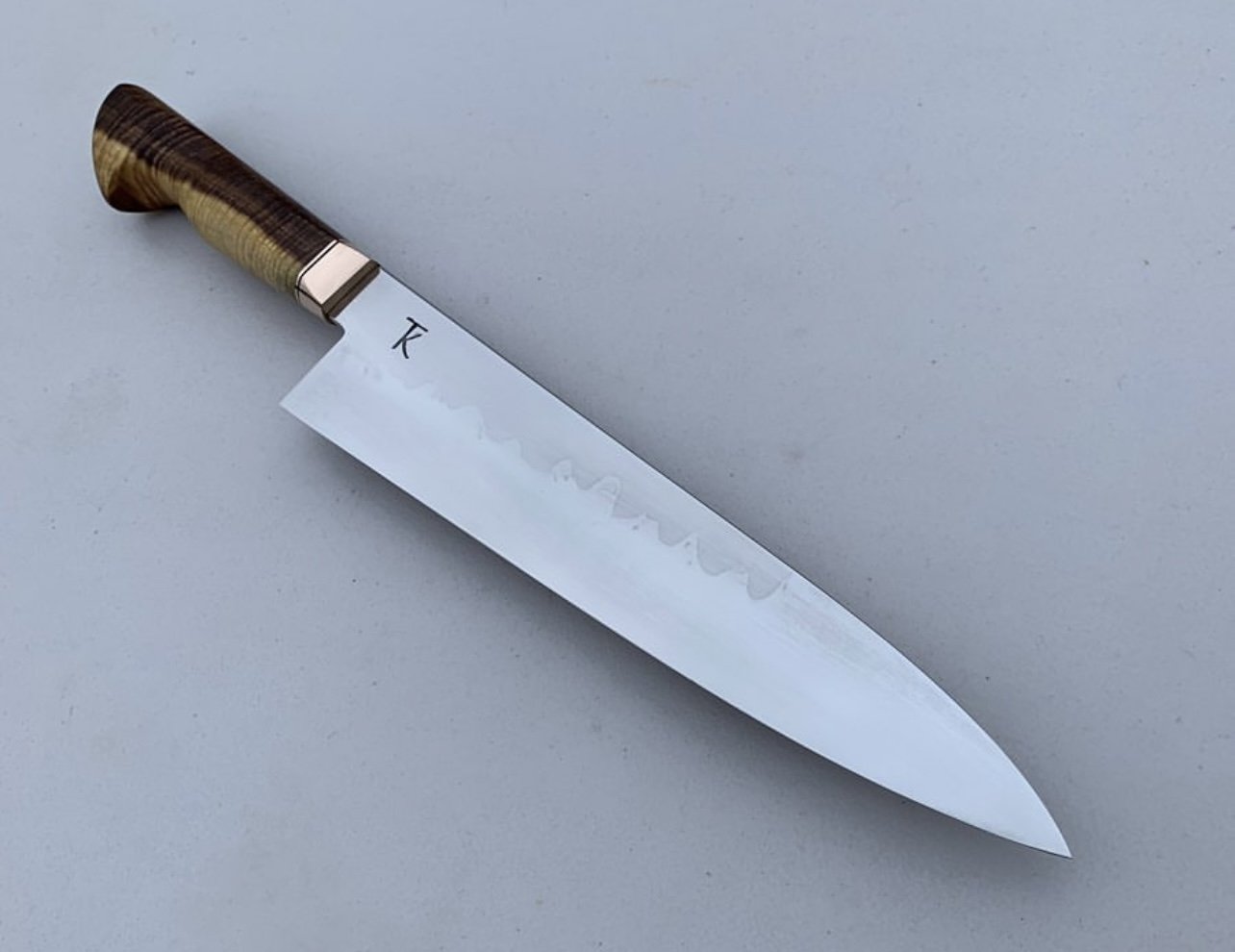

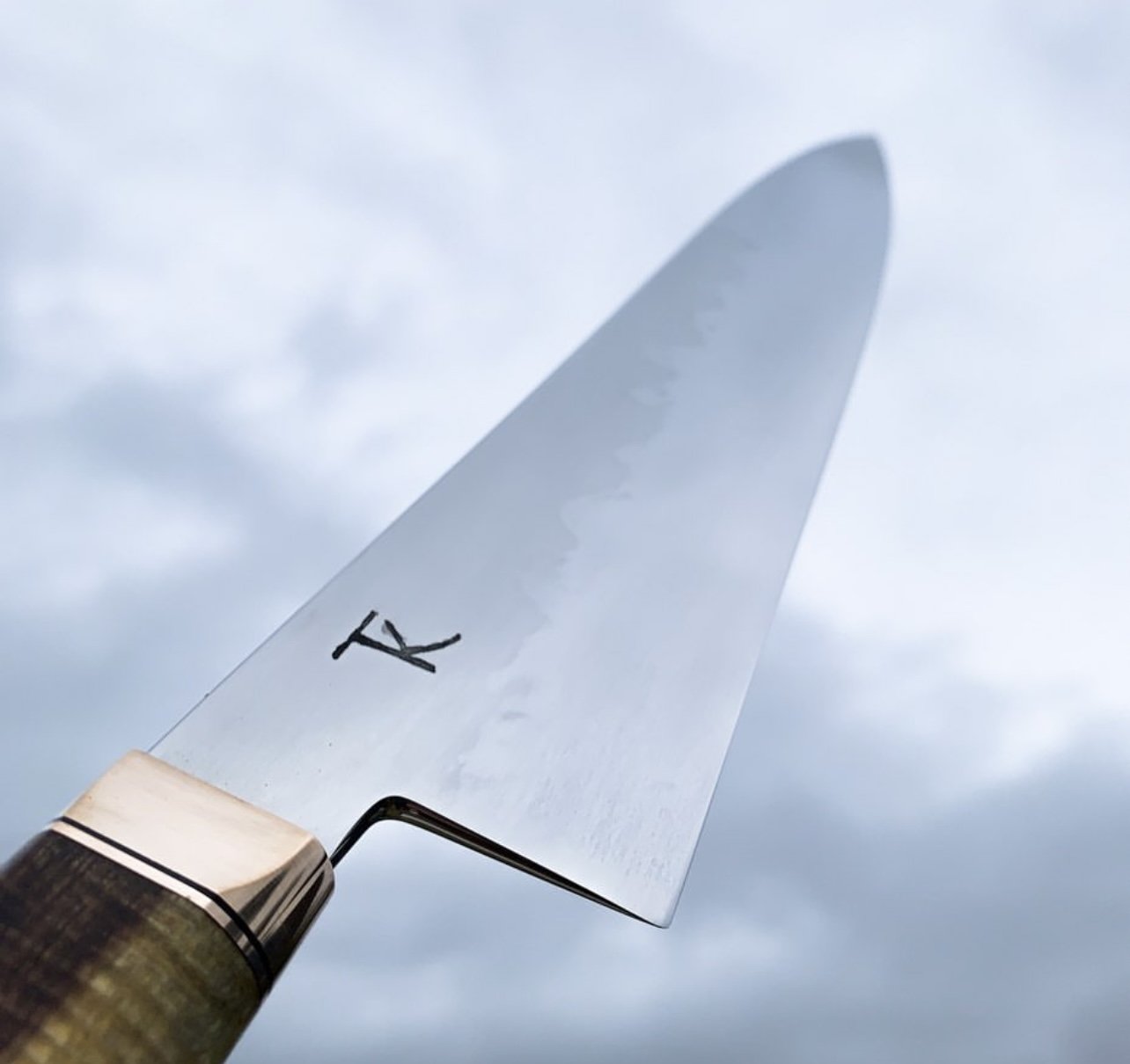

My small little collection accumulated since visiting Japan over ten years ago. I just use naniwa wet stones that I picked up from the knife store within Tsujiki fish markets before they shut down.
My favorite knife was one made  by Australian knife maker Mert Tansu. Below are the specs.
230mm honyaki gyuto forged from W2, gunome (wavy) hamon .
232mm at the edge, 49.5mm tall
Thickness along the spine 3.8 mm at the heel, 1.9mm midway, .9mm one inch before the tip, 6mm one cm before the tip. 196 grams in weight, Very thin behind the edge with great distal taper Handle is two tone one of the best gidgee I have seen with bronze bolster
