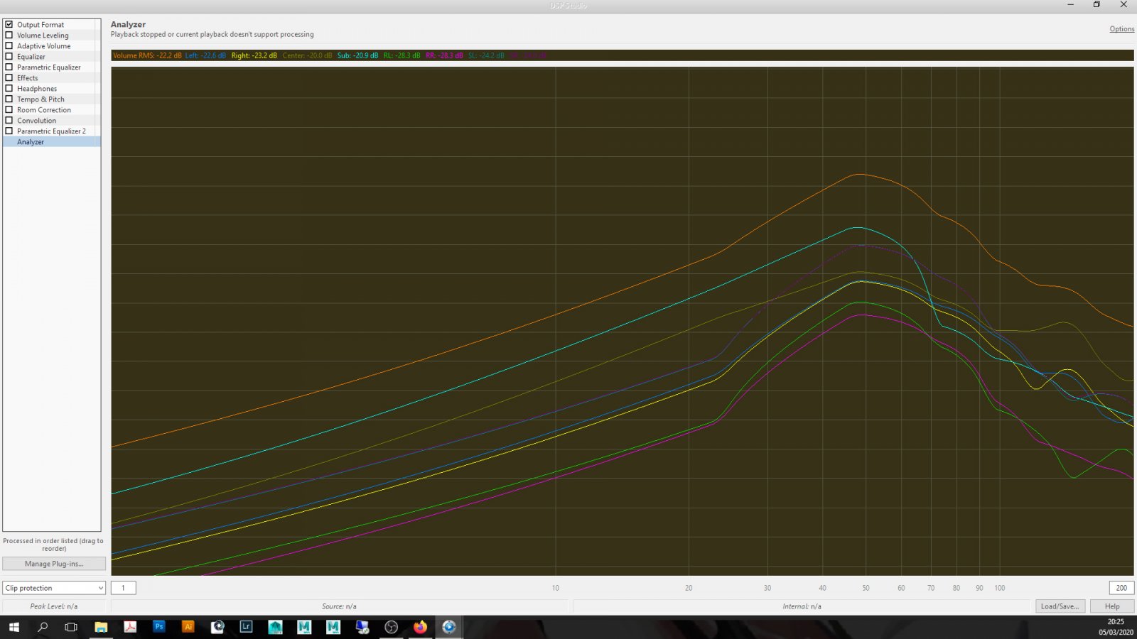

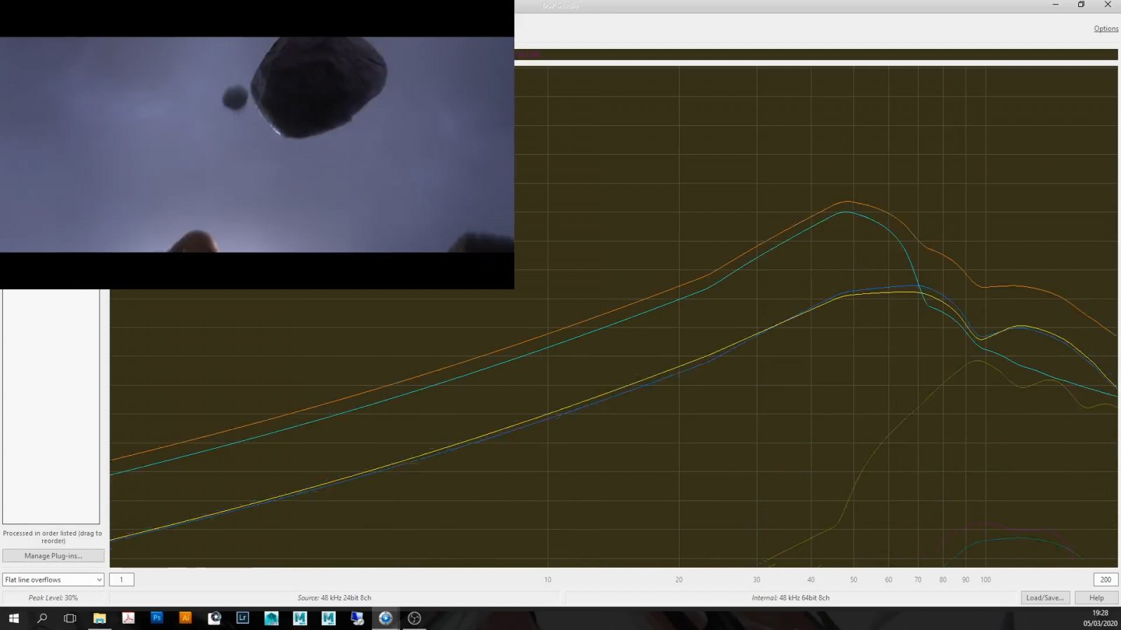

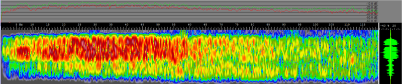

I can't really understand it either. I did an analysis of some scenes and there is nothing out of the ordinary. The third pic is the troubled scene, but the other scenes don't give me issues which is funny.
Bass Management adds about 7dB on top of the LFE and peaks at -13.5dB at my preferred volume setting at the troubled scene. When I playback only LFE at 100% volume the LFE channel peaks at -10dB and doesn't distort.
I am getting the idea that bass management is a bit funny and need to take another look at it inside JRiver.

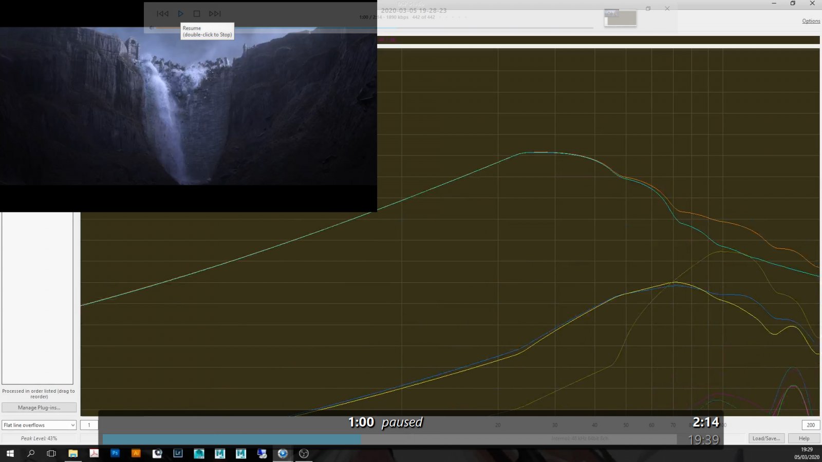

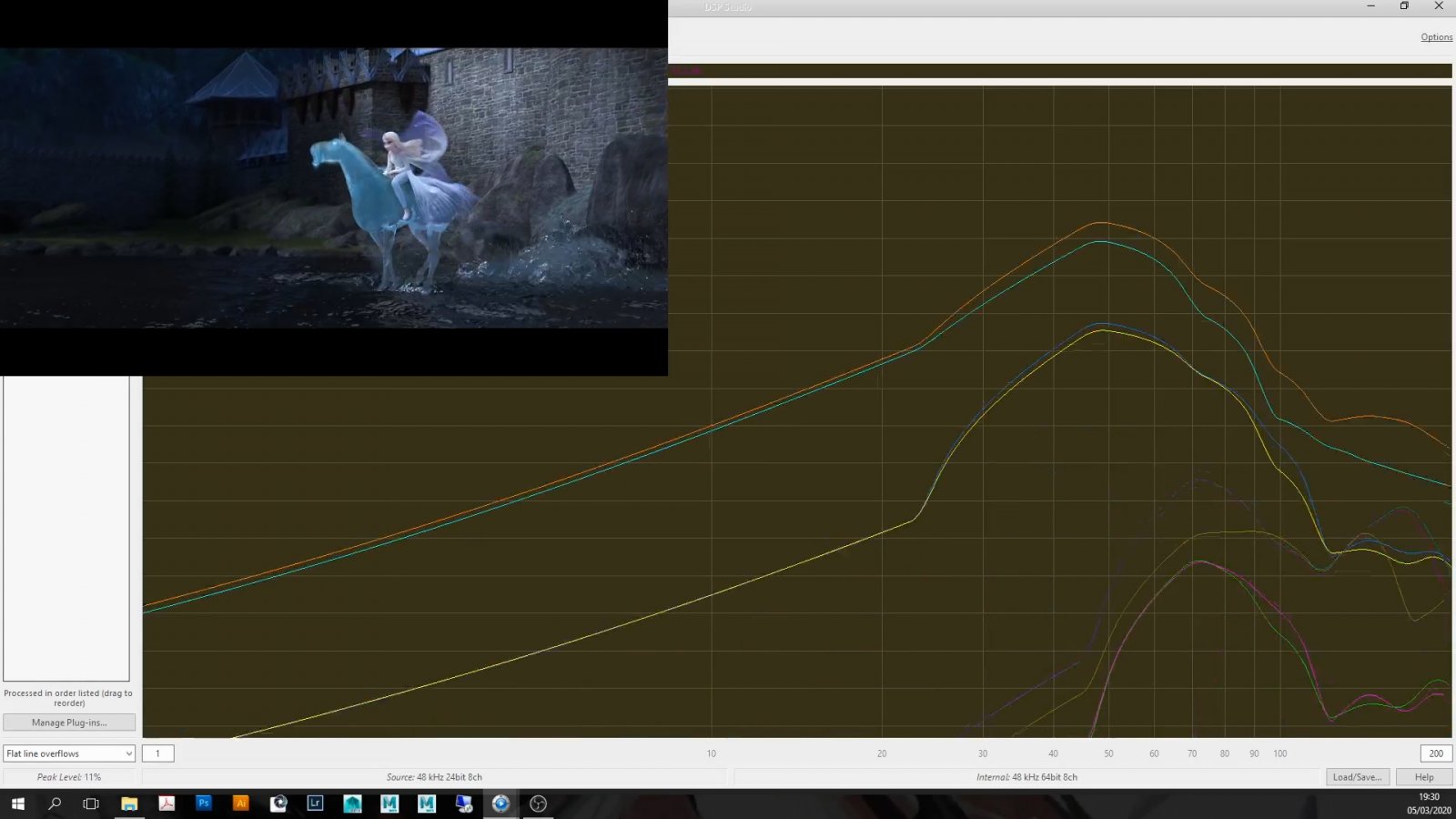

Check, Check, double Check. All scene are fine for my subs incl bass management. I had to adjust the low frequency roll off for the subs with the War of the Worlds scene as they seem to be hitting x-max. Still the frozen scene is a troubled scene for some reason. It is not the frequency that is the issue, it is the level send to the amp that is troubling. It is (nearly) driving the amp into clipping and it al just sounds wrong. Send bass management to a second pair of subs (testing with this option at the moment), and it all sounds a lot smoother and cleaner.
I think I might have found an indicator. The second lines ( on top of each other) below the cyan for Sub is the level for the Left and Right surround speaker. Their level is out of line with the surround back speakers, and louder than the main speakers. I'll have to check the setting on that.
