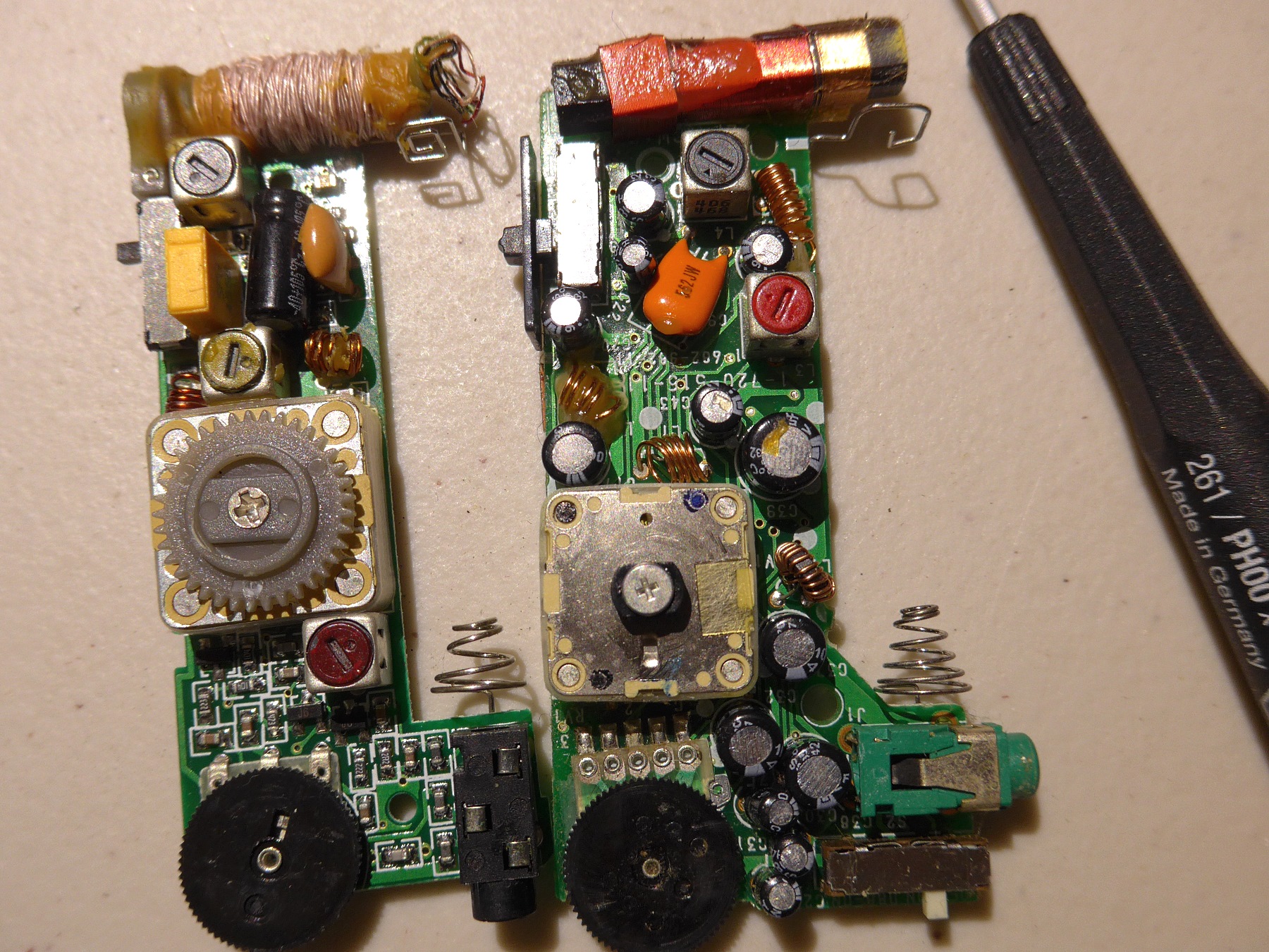

Stevesie Posted February 17, 2017 Share Posted February 17, 2017 (edited) Radio surgery time. Sony make great sounding radios, but their tuning caps are junk. Swapping one from a $6 eBay clone to get a few more years out of it. Edited February 17, 2017 by Stevesie 1 Link to comment Share on other sites More sharing options...
betocool Posted February 17, 2017 Share Posted February 17, 2017 Ehhhh.... which on is which? Link to comment Share on other sites More sharing options...
Stevesie Posted February 17, 2017 Share Posted February 17, 2017 1 hour ago, betocool said: Ehhhh.... which on is which? Sony on the right. The winding of the antenna on the cheapy is a bit rough. Link to comment Share on other sites More sharing options...

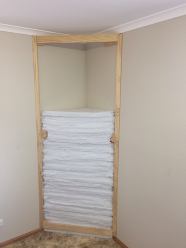

davewantsmoore Posted February 24, 2017 Share Posted February 24, 2017 I made a holder for all my white triangles .... still room to grow the collection. 3 Link to comment Share on other sites More sharing options...

davewantsmoore Posted February 24, 2017 Share Posted February 24, 2017 35 minutes ago, 125dBmonster said: this is all "ya got Mate" So far, I have what is in the photo (90w 45d, 2.3h) .... on the front wall I have a projector screen (acoustic transparent) which disguises a ~ 2.4x1.2 absorber, which is 150mm thick. When I get my finger out.... The ceiling is going to get ~4m x 5m, 300mm deep. Front speakers are going to be built into corner traps. Sidewalls, yet to be determined. Most of it (except the screen and speakers, of course) will have some sort of diffusion / reflection over it.... will require some experimentation. I did the obligatory "bring the entire stash inside, and chuck it anywhere" test .... and the result was quite dramatic for the LF. Link to comment Share on other sites More sharing options...
davewantsmoore Posted February 24, 2017 Share Posted February 24, 2017 Just now, davewantsmoore said: ~4m x 5m, 300mm deep. aka. lots. Link to comment Share on other sites More sharing options...

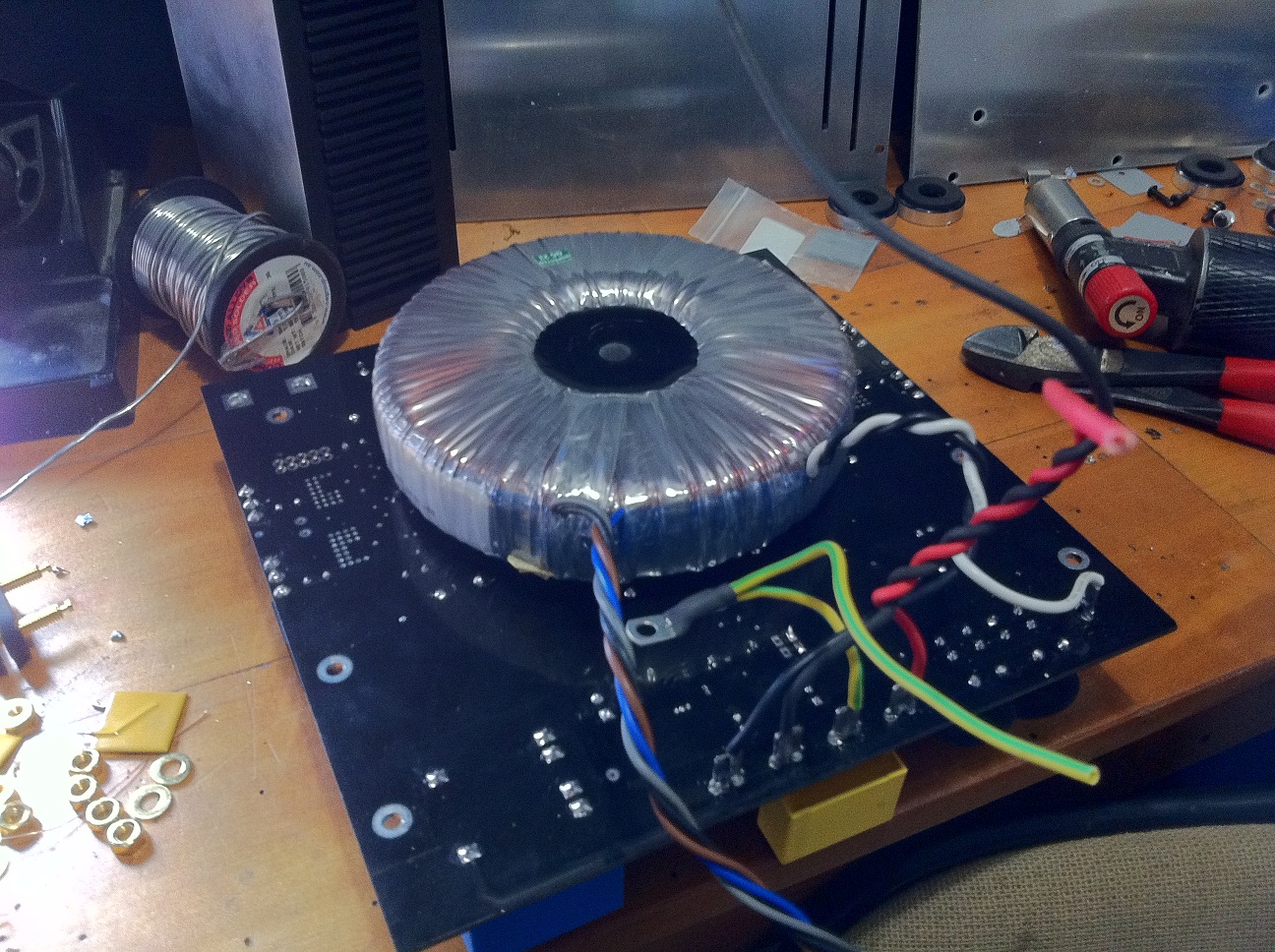

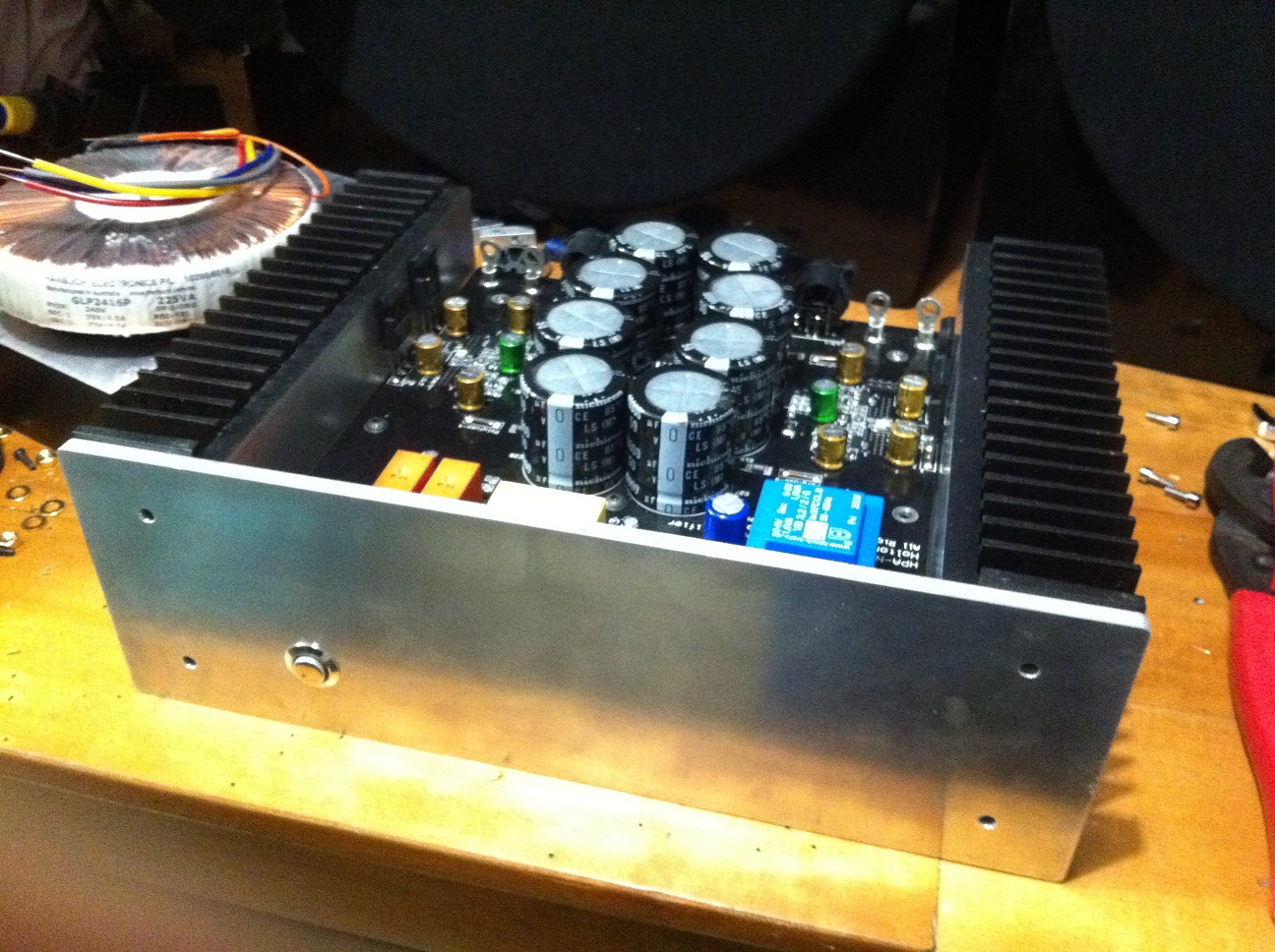

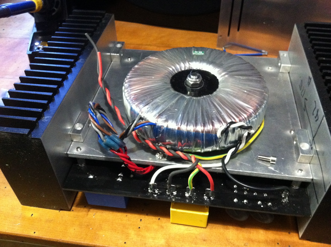

Guest Posted February 25, 2017 Share Posted February 25, 2017 Having a go putting this 50w x 2 mosfet stereo amp together over the weekend quite a few holes to mark drill and tap yet. Replaced some poly fuse devices on the module with copper wire bridges on advice as it has speaker protection via dc offset main power input relay Link to comment Share on other sites More sharing options...

Guest Posted February 25, 2017 Share Posted February 25, 2017 (edited) 9 hours ago, Upfront said: If only I could afford 3 of these and a monster!!! I'm doing 2 and I know of a couple of other modules ") make some thing to hold it together and get on with drilling the heat sinks there isn't much height in the case at 100mm outside Edited February 25, 2017 by Guest Link to comment Share on other sites More sharing options...
