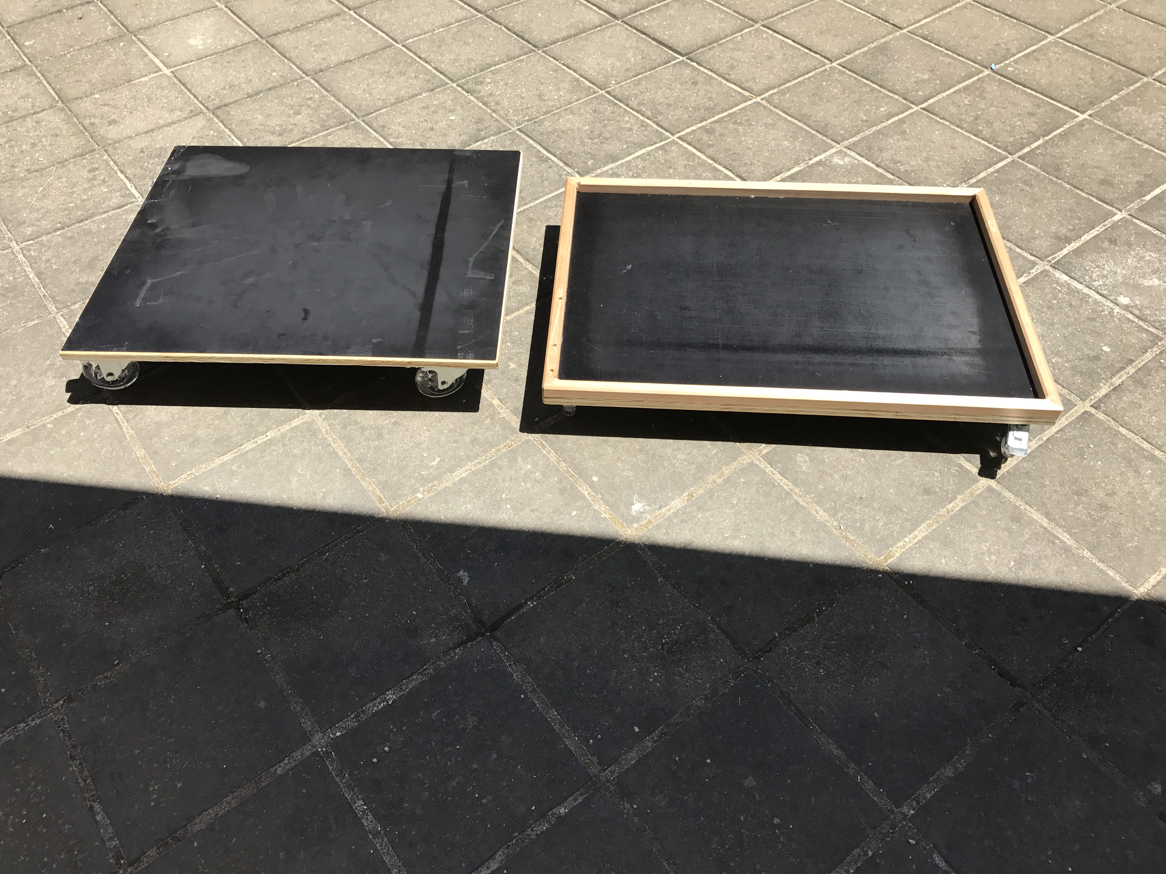

Sub Sonic Posted January 4, 2017 Share Posted January 4, 2017 I made something today I should have made a long time ago, a dolly for moving heavy speakers and subs around instead of risking injury. I got all excited and even made another one for the camping fridge (on the right). There is some leftover marine carpet in the shed which will probably find its way into the tops of the dollies. Oh yes, the kids have already asked but have been banned from using them as skateboards... 3 Link to comment Share on other sites More sharing options...

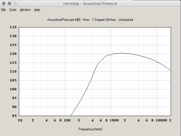

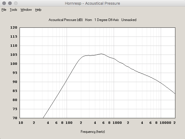

davewantsmoore Posted January 4, 2017 Share Posted January 4, 2017 4 hours ago, davewantsmoore said: I'll sim it for you when I am home watching the BBL tonight. The horn as it is now (220mm long, 25mm throat) with a 1" dome tweeter VS The horn shortened until the throat is 76mm (makes the horn 138mm long), and using the 3" TangBand driver Both the drivers roll off at ~6dB/octave above the mass point ... which is expected. The tweeter works well... where as the TB is a bit wonky and will need EQ. Becuase the horn only loads the driver down to ~1000Hz .... then excursion increases rapidly if the drivers are used below there. 1 Link to comment Share on other sites More sharing options...

Upfront Posted January 4, 2017 Share Posted January 4, 2017 I made something today I should have made a long time ago, a dolly for moving heavy speakers and subs around instead of risking injury. I got all excited and even made another one for the camping fridge (on the right). There is some leftover marine carpet in the shed which will probably find its way into the tops of the dollies. Oh yes, the kids have already asked but have been banned from using them as skateboards... Very very handy mate. Love a good dolly! 1 Link to comment Share on other sites More sharing options...
Upfront Posted January 4, 2017 Share Posted January 4, 2017 The horn as it is now (220mm long, 25mm throat) with a 1" dome tweeter VS The horn shortened until the throat is 76mm (makes the horn 138mm long), and using the 3" TangBand driver Both the drivers roll off at ~6dB/octave above the mass point ... which is expected. The tweeter works well... where as the TB is a bit wonky and will need EQ. Becuase the horn only loads the driver down to ~1000Hz .... then excursion increases rapidly if the drivers are used below there. Thanks for the sims mate. Will be interesting to see how it goes. At the very least its been a bit of a laugh to build. 2 Link to comment Share on other sites More sharing options...
davewantsmoore Posted January 4, 2017 Share Posted January 4, 2017 (edited) Here is the ScanSpeak dome tweeter sim from Linc paper horn with a series capacitor added. Edited January 4, 2017 by davewantsmoore 2 Link to comment Share on other sites More sharing options...
Upfront Posted January 4, 2017 Share Posted January 4, 2017 Here is the ScanSpeak dome tweeter sim from Linc paper horn with a series capacitor added. What about a different 3" driver Dave? Like the Faital pro 3FE25? Link to comment Share on other sites More sharing options...
davewantsmoore Posted January 5, 2017 Share Posted January 5, 2017 It will need a horn with a cutoff Hz around (ideally just below) the driver Fs. 10 hours ago, davewantsmoore said: Here is the ScanSpeak dome tweeter sim from Linc paper horn with a series capacitor added. People would often refer to a single capacitor between driver and amp, as a "first order crossover" .... but we can see that here it is nothing like that. The rolloff is much steeper. Link to comment Share on other sites More sharing options...
davewantsmoore Posted January 5, 2017 Share Posted January 5, 2017 2 hours ago, Upfront said: What about a different 3" driver Dave? Like the Faital pro 3FE25? For a horn which loads from (let's say) 2000hz upwards .... you need to drive it with a driver that also has around a that sort of cutoff. (ie. a tweeter). OTOH. If you want the horn to reach lower, it will need to be much larger. 1 Link to comment Share on other sites More sharing options...

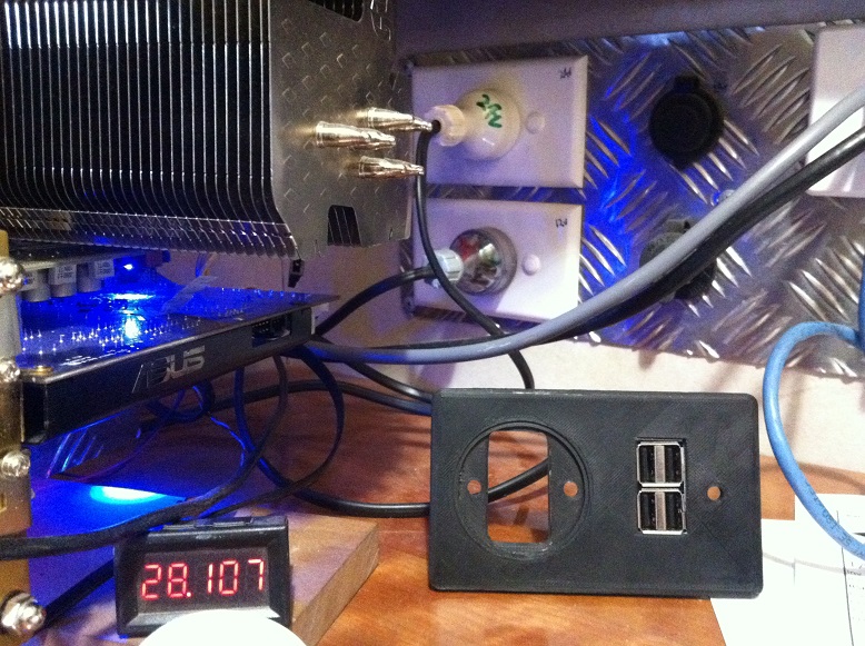

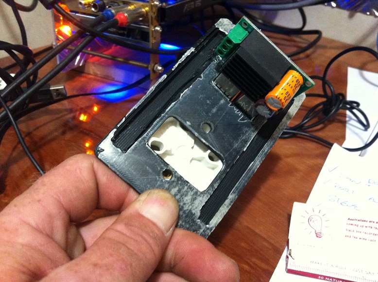

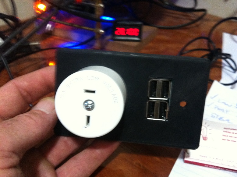

Guest Posted January 5, 2017 Share Posted January 5, 2017 Hot off the printer ELV + USB supplier "power point" that fits a standard Clipsal plaster clip or stud bracket. Designed to neaten things up a bit and take all USB supplied devices off the PC Supply rails. Link to comment Share on other sites More sharing options...
davewantsmoore Posted January 5, 2017 Share Posted January 5, 2017 29 minutes ago, 125dBmonster said: Hot off the printer ELV + USB supplier "power point" that fits a standard Clipsal plaster clip or stud bracket. Did you make this? (or is it bought?) Link to comment Share on other sites More sharing options...
Guest Posted January 5, 2017 Share Posted January 5, 2017 (edited) 19 minutes ago, davewantsmoore said: Did you make this? (or is it bought?) Made, except for the purchased bits, ELV Clipsal socket and 10A adjustable 5v supply Replaces one of the either 12 or 24v outlets at the bush lounge power supply, not sure which yet. Plate is printed Capacitor will go in at the same time, for a bit more instant current Edited January 5, 2017 by Guest Link to comment Share on other sites More sharing options...
EV Cali Posted January 5, 2017 Share Posted January 5, 2017 Love DIY but you can buy them for $16.45 http://www.auselectronicsdirect.com.au/white-dual-usb-australian-power-point-home-wall-po?gclid=CNLT1q33qdECFQwmvQodpXAPdg Link to comment Share on other sites More sharing options...
Guest Posted January 5, 2017 Share Posted January 5, 2017 (edited) 8 minutes ago, EV Cali said: Love DIY but you can buy them for $16.45 http://www.auselectronicsdirect.com.au/white-dual-usb-australian-power-point-home-wall-po?gclid=CNLT1q33qdECFQwmvQodpXAPdg Wrong outlet volts, the PC, Monitor, modem, Internet Link, doesn't use mains in this particular instance. In fact the whole entertainment system may go totally DC. That plate is a one off and took plenty of hours to program into the PI/Printer. Takes about 6 hours to print. This set up is audiophile purist and literally a one off to show the value of running DC for stereo, particularly the digital front end Edited January 5, 2017 by Guest Link to comment Share on other sites More sharing options...
Guest Posted January 5, 2017 Share Posted January 5, 2017 (edited) Most have never seen a 32vDC ELV Clipsal Outlet, let alone used a proper and correct "DC Supply" Wall warts,,,,,,,,,,pfffffft Mate Try batteries rated in Kwh and caps rated in Farads Edited January 5, 2017 by Guest Link to comment Share on other sites More sharing options...
