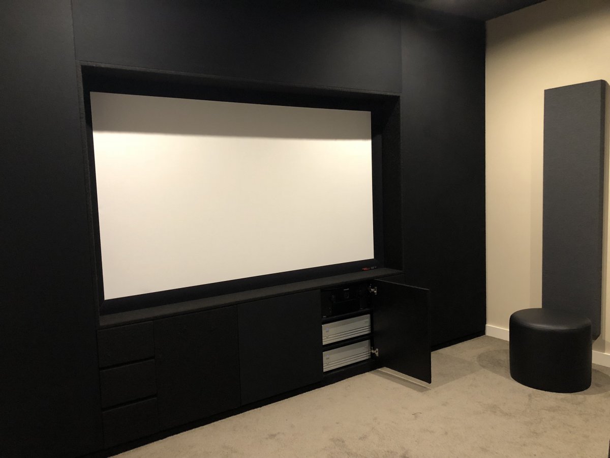

  • Big update.. it's taken many months, but the new custom cabinetry at the front is now finished to house the 2.7metre wide screen. All the equipment is now in roll out racks in the joinery behind a rem

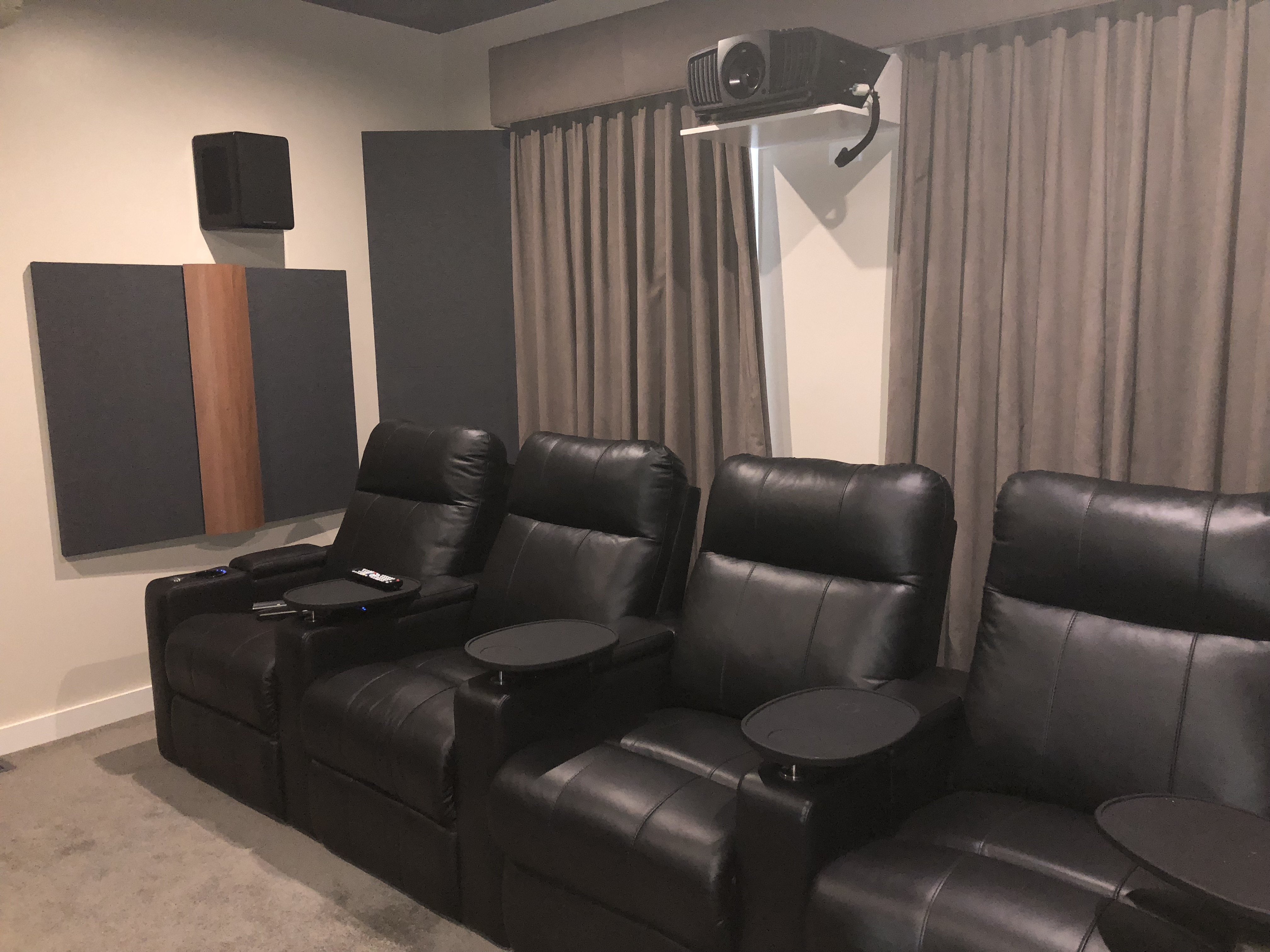

The projector platform really fits in nicely. Must be quite strong as the BenQ looks large.

The projector shelf is basically part of the rear wall. I think the house will fall down before that shelf....

The projector cables location is a hang over from my previous projector which was slung under the shelf on a bracket. I just haven't had time to re-route the cables to the new projector position.

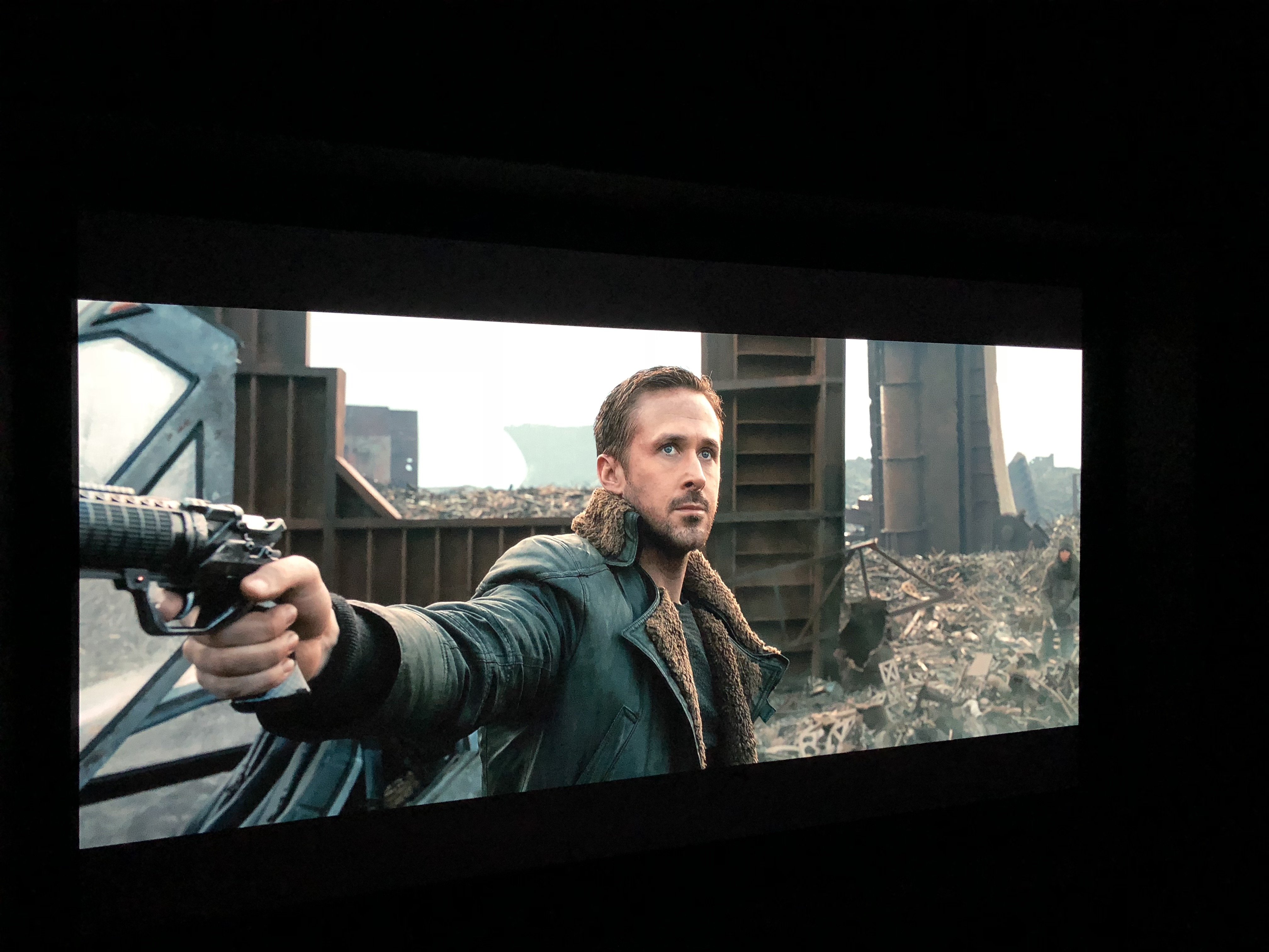

Here ya go - just an iPhone shot, but should give you the idea of it?
Edited by JoshH
The movie picture looks longer and narrower than the screen in the first pic, or is it an illusion?
Very nice setup.
  • Author
you are looking at a film with an aspect ratio of 2.39:1 on a 16:9 projection screen. So there are black bars top and bottom. Hence the picture is longer and narrower than the screen. If you look very closely at the photo you can see the difference between the black bars and the shadow box

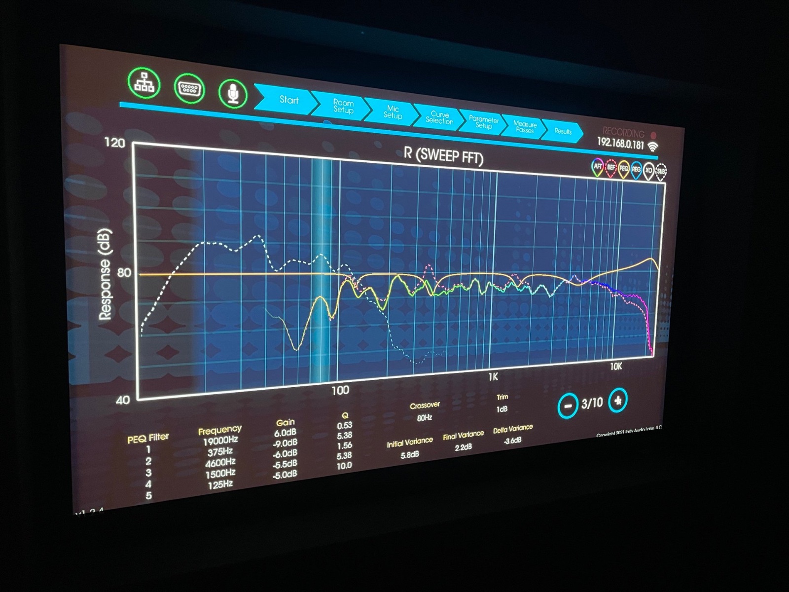

Just wanted to do a bit of an update: Since I posted this originally Acurus have released the brand new ASPEQT EQ system for the MUSE processor and I have now had a chance to do a calibration with the kit. This kit has been a long time coming and the results were absolutely worth the wait.  I wont repost all the images from each channel here - but they can be seen on my post on the AVS forum HERE: And a couple of samples below.
My initial impression post ASPEQT calibration was exceptionally positive - especially on the way the calibration seems to lift a ‘veil’ and greatly improve soundstage and transparency. The MUSE sounded great before the calibration. Post, its most definitely an immediate audible improvement. I really haven't heard a better sounding processor. Bang for buck, I believe the MUSE to be unmatched.
Just keep in mind that this pertains to my cinema and the equipment in my room. The room itself is extensively acoustically treated and was designed from the ground up as a dedicated cinema. From the results ASPEQT has given me you can clearly see that ASPEQT is making only minor adjustments and is subtle and not aggressive in those adjustments. In other rooms that are not acoustically treated ASPEQT would I believe behave very differently (as it should) with more aggressive adjustments to tame room issues.
With that caveat out of the way my feelings on ASPEQT results post calibration are exceptionally very positive. Overall the soundstage is larger with greater depth and is more integrated. Dialogue is clearer with ASPEQT clearing up the boundary gain from my centre channel very nicely. I would say that movie sound tracks feel more holographic (trying to find a word to describe how the speakers just sort of further disappear) than before and thats a great result.
What I like very much is that the results for each speaker channel give good detail on what adjustments are being applied. You can see from the screenshots I posted above exactly what is happening with each speaker. That is pretty cool and something I missed with Audyssey stand alone processors. I also appreciate very much that it is possible to restrict the frequency range that ASPEQT is working. Of course, the on screen GUI is gorgeous and clearly the best in the market. They really knocked it out of the park with the GUI.
If you are using ASPEQT in a treated room such as I am I would recommend starting with the gentle roll off curve. If you are in a multi purpose space that is not ideal acoustically then it is likely a steeper roll off curve will be preferred. I cant think of a reason you would want the flat curve, unless you were using some other device in combination with the MUSE and ASPEQT to do room correction. Or, perhaps if your room is just way over damped. Anyway, I guess its a good thing its there as an option.
The bass boost options are good to have on tap - but keep in mind, each bass boost jump requires a doubling of power. Some systems may not be able to cope with that. In my own room, using the gentle roll off curve with the lowest bass boost produces thunderous, powerful bass. Too much? Nah... its awesome. I am running multiple subs in my room and bass is tight controlled and has serious impact and slam.
From information received from Acurus directly, I believe there are more features coming to ASPEQT in future firmware updates that include the ability to customise curves. I also requested a THX curve be added and the ability to do A/B before / after comparisons more easily. We will have to wait for these, but its good to know that they are being worked on.

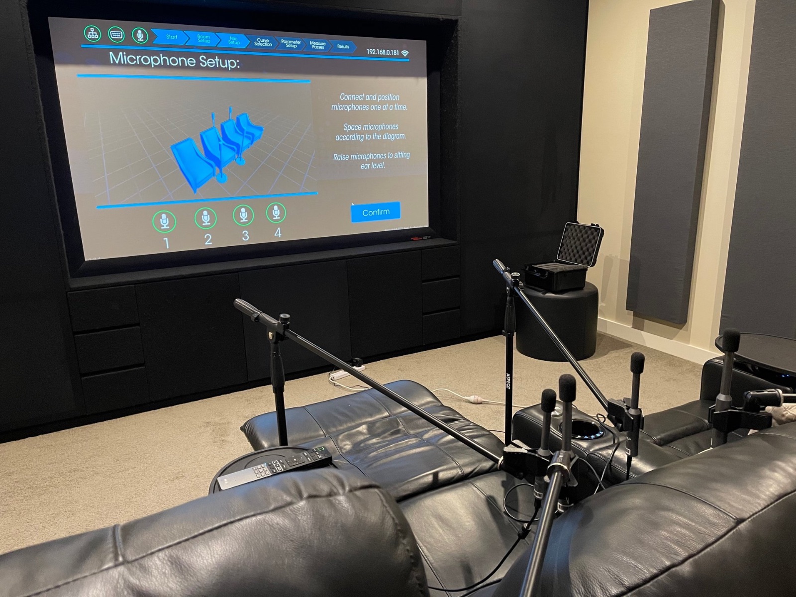

Another upgrade this week - one of the subwoofers has been upgraded to the new M&K X15+ THX Dominus.
Scott from the Digital Picture in QLD flew down and we spent 5 hours last night calibrating it. To say the bass is earth shaking would be an understatement 🙂

Some big updates to the cinema: New Screen 2.7 metres wide 2.39: 1 Severtson SAT 4K Acoustically transparent screen is installed and a new Barco Bragi 5K Cinemascope projector with the E63 Lens.
We need to complete the joinery modifications to accommodate the new screen properly, but it's up and running. Photos are to come once the joinery is completed.
