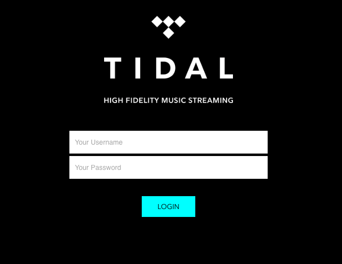

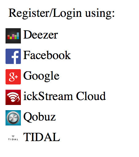

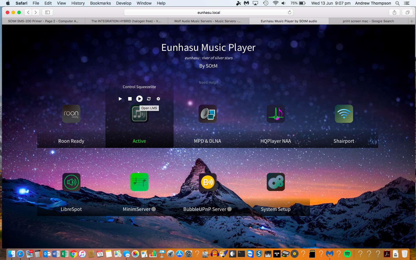

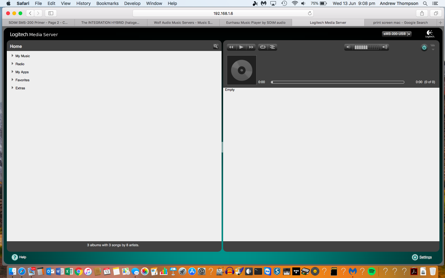

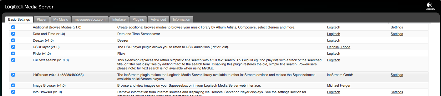

I just went through the process of installing Tidal via ickstream on my sMS-200. It's basically exactly the same as on your mac PC or Linux computer.
I notice Deezer can be installed the same way. I'll have to give Deezer HiFi a shot via Squeezelite!
Open LMS
Click on settings
Paste ickstream repository address
Agree to terms
In Plugins open ickstream settings
Click on Tidal
Login
I've taken some screen shots.
740724518_ScreenShot2018-06-13at9_07_18pm.thumb.png.63207b1dedc141e743c01b12888441f7.png
770895287_ScreenShot2018-06-13at9_08_01pm.thumb.png.3fa4db116670d0213556a92885d5c41a.png520362518_ScreenShot2018-06-13at9_13_53pm.thumb.png.a85cc59f8dd5558c0e7d51deee981445.png1628142320_ScreenShot2018-06-13at9_16_47pm.thumb.png.07a0e9c7de88a9b3c3b386a5aa652548.png863220778_ScreenShot2018-06-13at9_18_12pm.thumb.png.be785a62221946e6ec081defeea04a98.png1879145904_ScreenShot2018-06-13at9_23_12pm.png.8b5a7b839cf54451eadc9ab99c64ae3b.png373316004_ScreenShot2018-06-13at9_23_25pm.png.887b12d4e10a70068a5819170be080a2.png

25 minutes ago, a.dent said:
Open LMS
Got it! Thanks a.dent. I was actually opening a version of LMS on my laptop rather than opening from the play button in Eunhasu.
