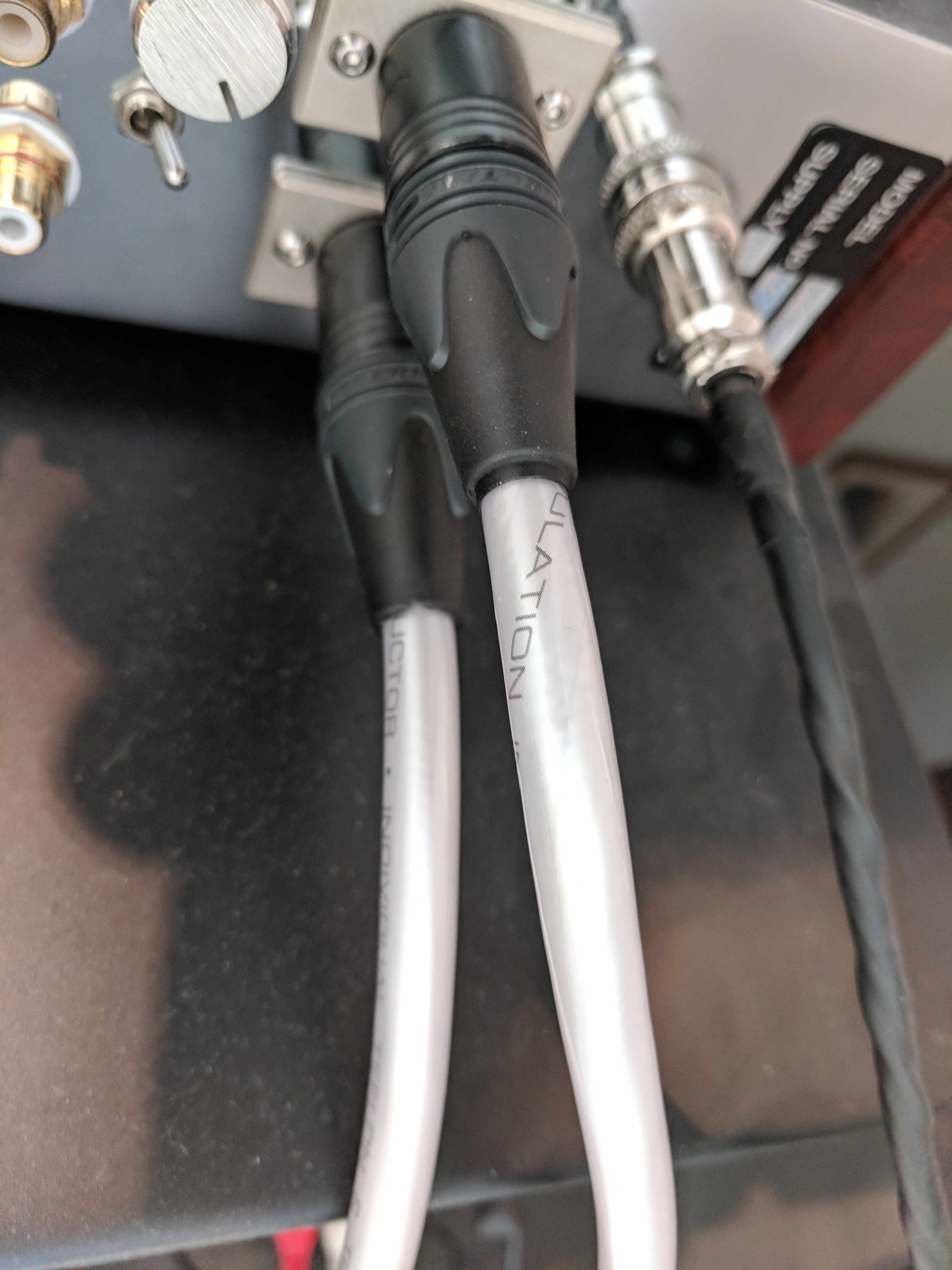

Still busily wiring up the interconnects. Unfortunately the cable doesn't fit easily into the neutrik XLRs I bought so there's quite a bit of grunt work and making everything fit. Will post more on my findings once I have replaced DAC to pre and pre to power with them.

First impression of the new interconnects: Quiet. The background to everything is just blacker, and it's almost like the volume has been turned down slightly. Consequently there also appears to be less overhang to notes afterwards as well, without affecting the air around instruments itself. Otherwise, tonally they're virtually identical to the WyWires silver I had in my system. The only other notable difference was a little more focus in midbass notes. So the lack of overhang in notes is probably the only detriment so far that I can recognise. The big question now: Will there be any burn-in? I've thought that I've heard cables burn in myself, and if it is - as I theorise - due to a change in the dielectric of the cable after application of voltage over time, then with teflon dielectric in these cables it could be 400-800 hours before they burn in. That's kind of good and bad since it means it should improve substantially (I hope) but bad because it could take forever to get there. Either way, there's nothing unpleasant about the sound, and if it improves from here it can only be good. One very nice thing about working with teflon insulation, though, is the lack of it melting when you solder near where the insulation is stripped up to. I was very happy with my WyWires interconnects but they were a bit short, limiting where I could place my preamp, so I figured I'd try my hand at making my own longer first before just buying longer ones, hence why I've ended up here.
So I'll give these a good run for a week or so before resuming experimentation by changing the internal speaker wiring. I miss aspects of the megatwistlan (21 pairs of separately insulated solid cores) I had going to the tweeters when I changed to cardas crosslink 1S and am hoping to regain that with the flat neotech cable.
And now if you'll excuse me, I have to go listen to Beethoven's 9th to help burn them in.
