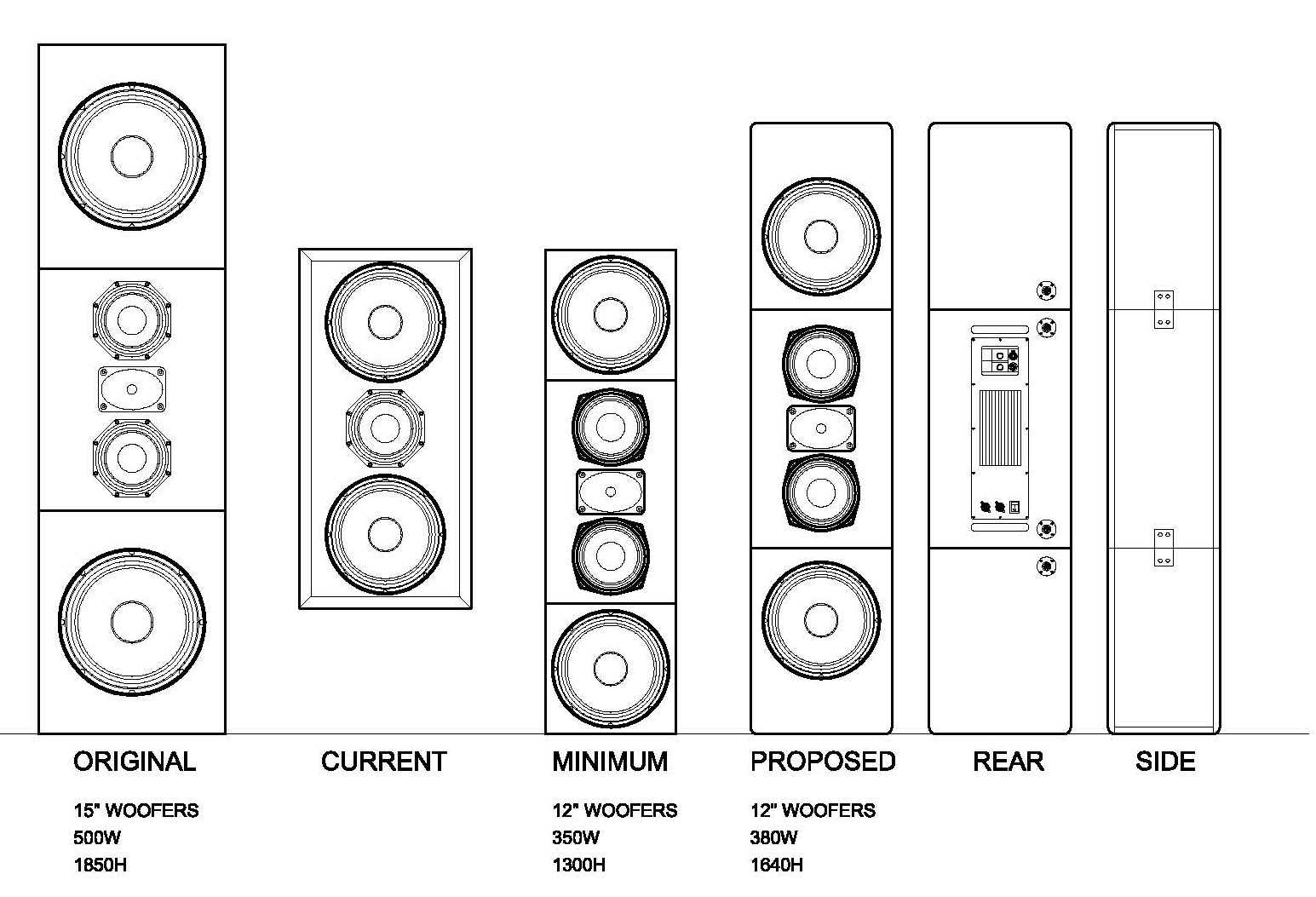

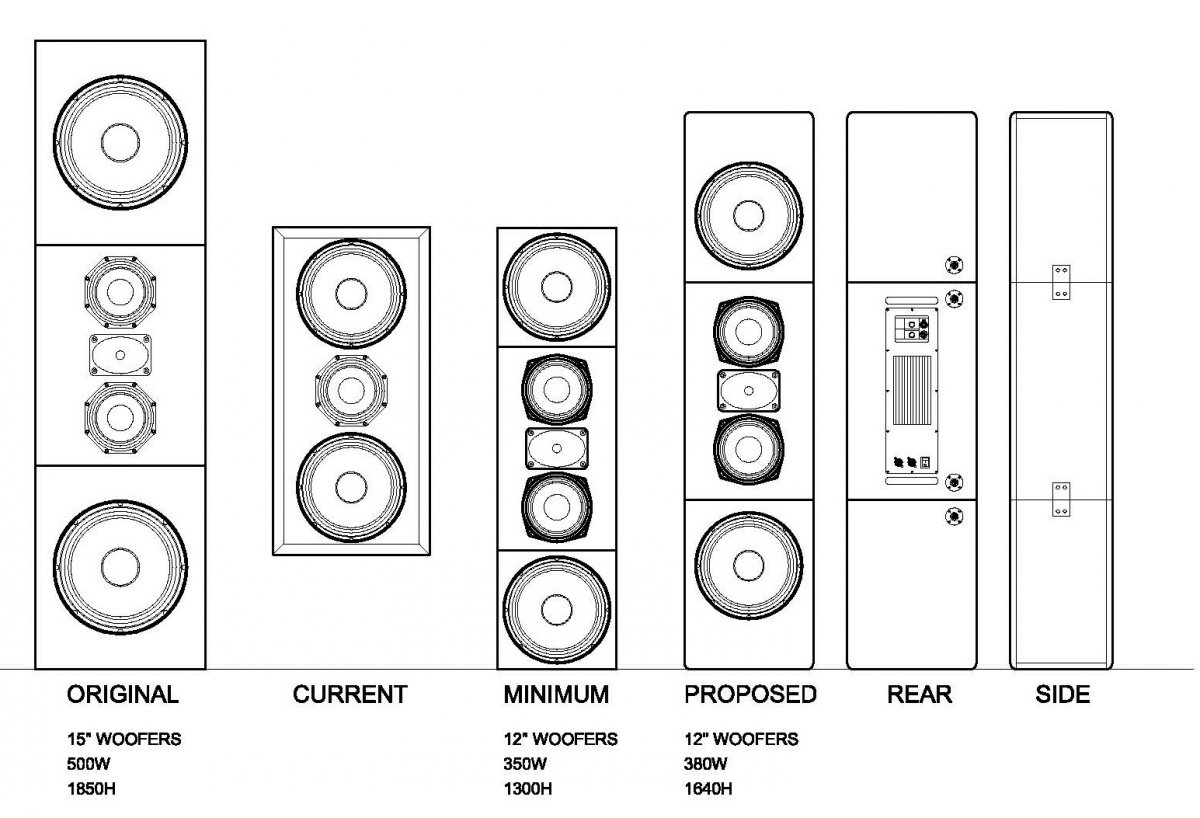

 Then we had many correspondences on the speaker concept. A cabinet design has finally been locked in. Below is a diagram of the design (including a previous one we considered).
Paul has also experimented with a number of different drivers/woofers/waveguides, and settled on a set he is happy with.

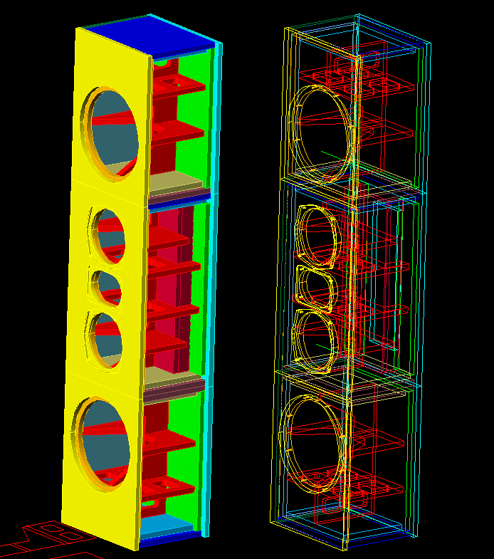

Paul is very meticulous, and nothing short of perfection is good enough for him. For example,  here is a 3D sketch up of the cabinet he developed as part of his design:
  • Author
As you can see Paul has a strong attention to detail, and this should translate into the quality of the final design.

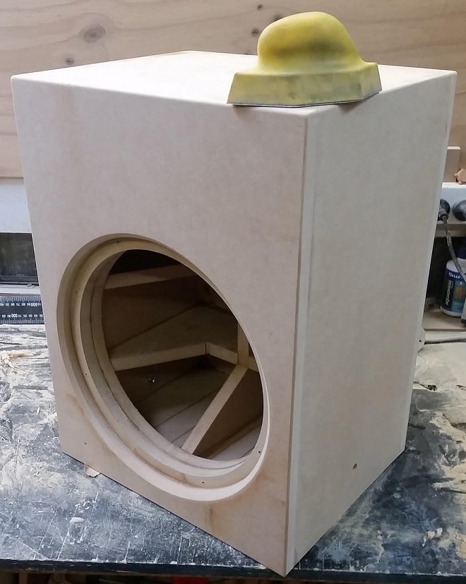

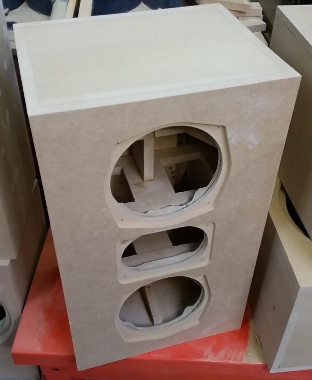

After some pestering, I got Paul to send me some pics of build in progress. Cabs in construction.
The woofer cab baffle is 3 layers thick! Not looking forward to moving this thing around....

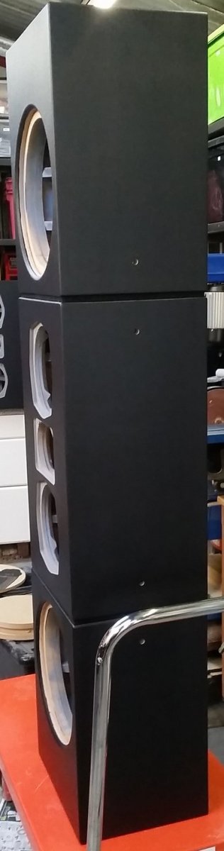

Build is progressing well. New photo of the cabs with 3rd coat of paint
  • Author
Also some feedback from Paul on the cabs:
"There is a lot of redundant strength in these cabs. The woofer boxes would quite likely support the weight of a car. Not that I would try it!
Cabs are looking nice now, the sheen and texture is bit like some car dashes. When you knock on them, they are a bit more like rock. It's almost like they are carved out of rock."
