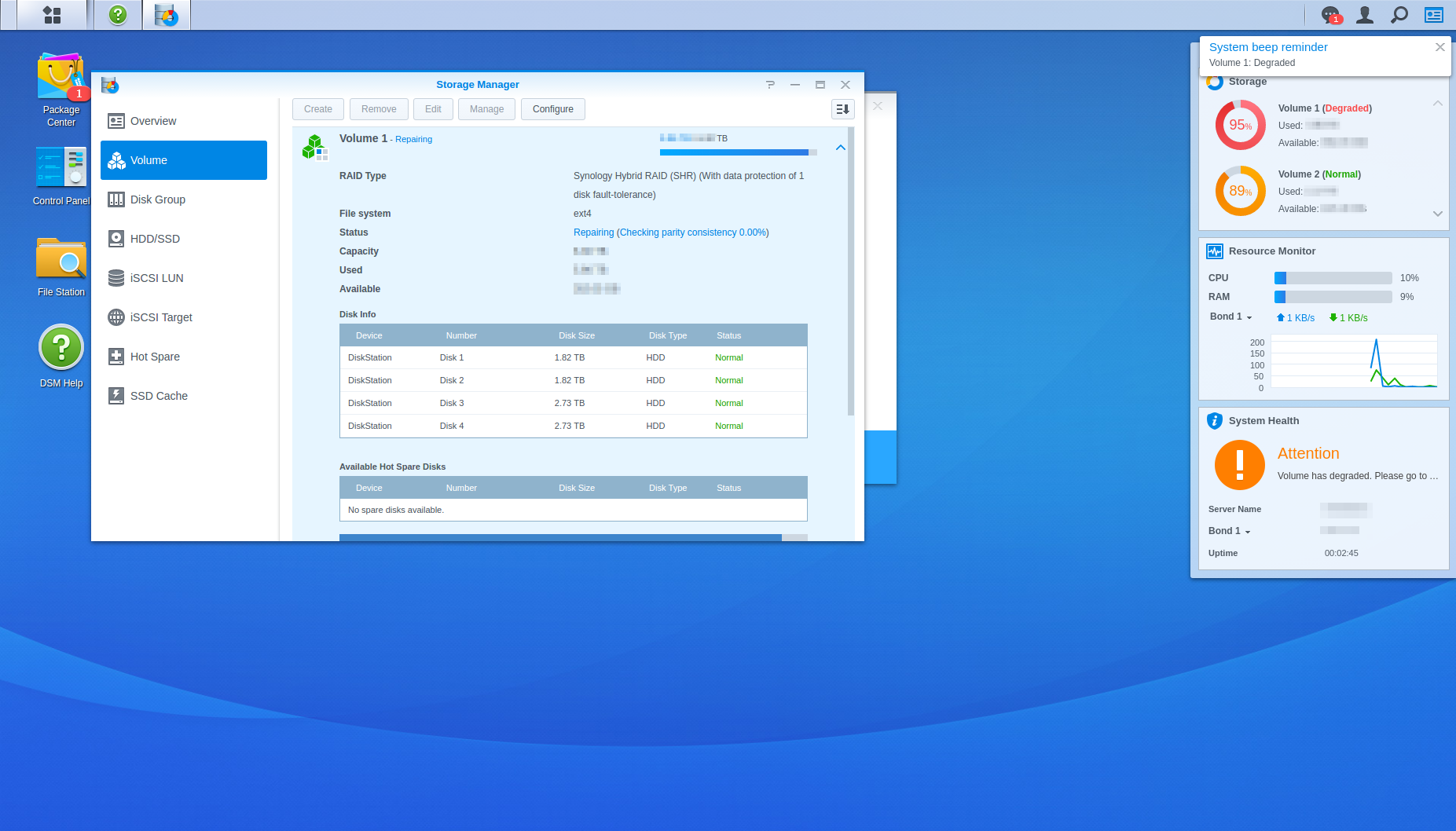

Guest rmpfyf Posted August 13, 2017 Share Posted August 13, 2017 (edited) OK, that was fairly painless, aside from the bit where I'd misplaced the key that locks the NAS drive bays, then swore at it a bit, then got beyond that with a screwdriver. Swapped the drive. Powered on. NAS boots up and beeps. Log in, greeted with 'Volume 1 is running in a degraded state'. Got into Storage Manager, clicked on the degraded volume, clicked Manage, clicked Repair. It asks which spare drive I want to use with this volume (there's only 1). Starts rebuilding the volume as per below. This is going to take a while, currently at 3.3% (needs to format the drive, then copy and verify). Unless I've got the process wrong (which might make for a fun follow-up post), in a few hours we should be up and running again with a healthy drive in place of the tired WD, and some info on what this IronWolf functionality means. Edited August 13, 2017 by rmpfyf Link to comment Share on other sites More sharing options...
Guest rmpfyf Posted August 13, 2017 Share Posted August 13, 2017 As it turns out, the 3TB Seagate Ironwolf doesn't have Ironwolf Health Management included. Booooo. http://www.seagate.com/files/www-content/product-content/ironwolf/_shared/masters/IronWolf_Health_Management_Manual_22717.pdf So whilst I get a nice Ironwolf icon next to the drive, I don't get any Ironwolf-ish behaviours per se. Nevermind, the aim of things was simply to get my volume back up and running. Which is now done. When my (very old) 2TB Seagates let go, we'll go 8TB there. Does it run hot? No, a couple of degrees cooler than the drives around it. It is a new drive though - if it turns out to be faulty (a possibility) I'll report back... right after the NAS does So there you go. One failing hard drive in a mirrored RAID identified, replaced, restored. All throughout my data was still available for use. Relatively painless. Get a NAS Link to comment Share on other sites More sharing options...

Guest rmpfyf Posted August 23, 2017 Share Posted August 23, 2017 Here we go again. So around 25 minutes ago there's a bit of beeping from the NAS' hiding spot and an email from the NAS. Volume 1 has entered degraded mode. It's not the new Ironwolf 3TB, it's one of the very, very old Seagate 2TB drives I spoke of a while back. Can't really complain here, these drive are really old and well out of any reasonable warranty or consumer expectation for their survival... this is simply the NAS doing it's job. Logging in and checking activity it seems the disk 'plugged out'. On the NAS physically the light indicating a disk isn't connected. I take the disk out, plug it back in and it lights up. However back in the NAS webh portal the disk shows up as being completely blank/uninitialised, meaning 'rewrite me if you intend to use me'. What does this mean: Either: A physical failure of the drives' controller, which is possible - it's not exactly new - and will show up again as it comes up to temperature if so. But it's silicon mostly, and not likely to quibble too much about life at 40degC or so, and/or Corruption of data in the first sectors of the drive where critical information (master boot record, partition table, etc) are held. Could be something physically repairable, could be a bad sector. The second is more likely. The disk can be used but we have no idea at this stage the nature of the fault, if it's limited to a few sectors that get hit quite often or whether it's a growing physical issue. It can be a bad sector or something able to be picked up with a recovery tool. This is not necessarily something that's picked up in S.M.A.R.T. tests (the drive is extended tested weekly and showed no faults). The simple solution: Assume it will get worse, replace the hard disk. The harder solution: Pull the drive and see if a utility (e.g. http://www.cgsecurity.org/wiki/TestDisk) can recover the partitions that were there, then monitor the situation. Probably go and get a spare disk anyway. Will work on this a little later. (Meanwhile, damn, the Ironwolf Pro 8TB went up in price and the non-Pro went down. Drat.) Link to comment Share on other sites More sharing options...
Guest rmpfyf Posted August 24, 2017 Share Posted August 24, 2017 So just to be safe and partially because I was curious, I purchased two new 4TB IronWolves to replace the 2x 2TB Seagates. Stopped at 2x 4TB on cost reasons. The drive that unplugged I've pulled and discovered it was made in 2011... a good innings so far. Here's the 4TB IronWolf showing up... And here's the IronWolf health status. If this was a Pro, data recovery would be included. So I decided to see what was recoverable on the drive that dropped out - put it in a caddy and connected it to a PC (this is Ubuntu's usual Disks utility). I was all ready to see a blank disk needing initialisation, when lo and behold... up come the partitions it's supposed to have. Sticking it back in the NAS, however, hadn't done made the NAS suggest that it was in a good way. Hmmm. Seems the partitions are there, and the drive is reporting one failed attribute only. Digging into the smart data shows that the drive had run hot beyond threshold conditions once in the last few days, which seems to have caused it to shut down and self-protect. I've no idea why - there's a new drive next to it that runs cooler than that it replaced. As we can see below, it's still in pretty good nick - no uncorrectable errors (some of this data is raw and the 'Value' column looks bad - just keep an eye on the 'Assesment' column). Long story short - the drive is OK, and simply rebuilding the array would have saved it. Looks like I'll have a 2TB RAID spare shortly. No regrets on spending the money - this particular volume has the local mirror of some important data - better safe than sorry. But hey, good news - looked after properly drives can last a long time. Link to comment Share on other sites More sharing options...
